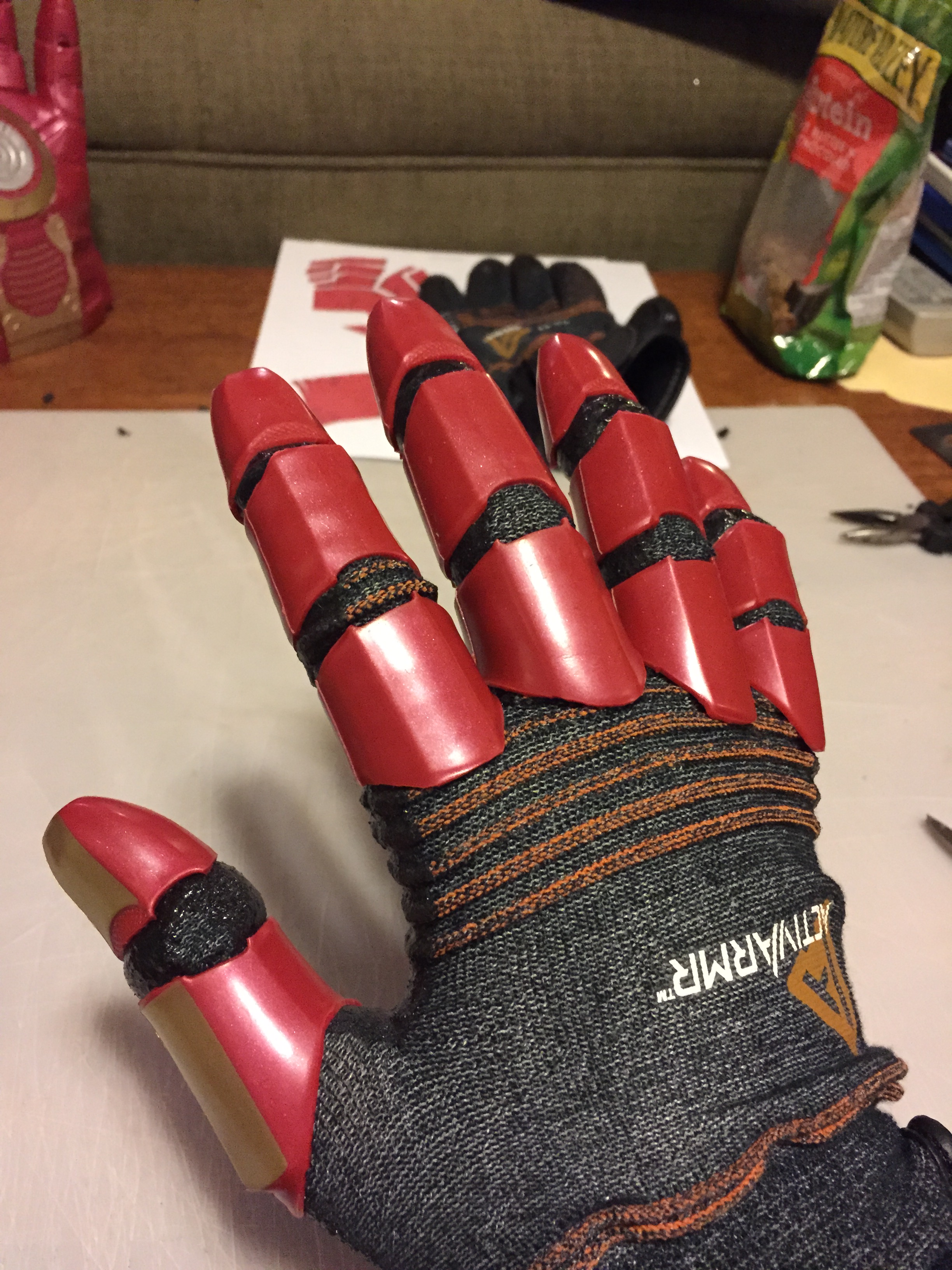

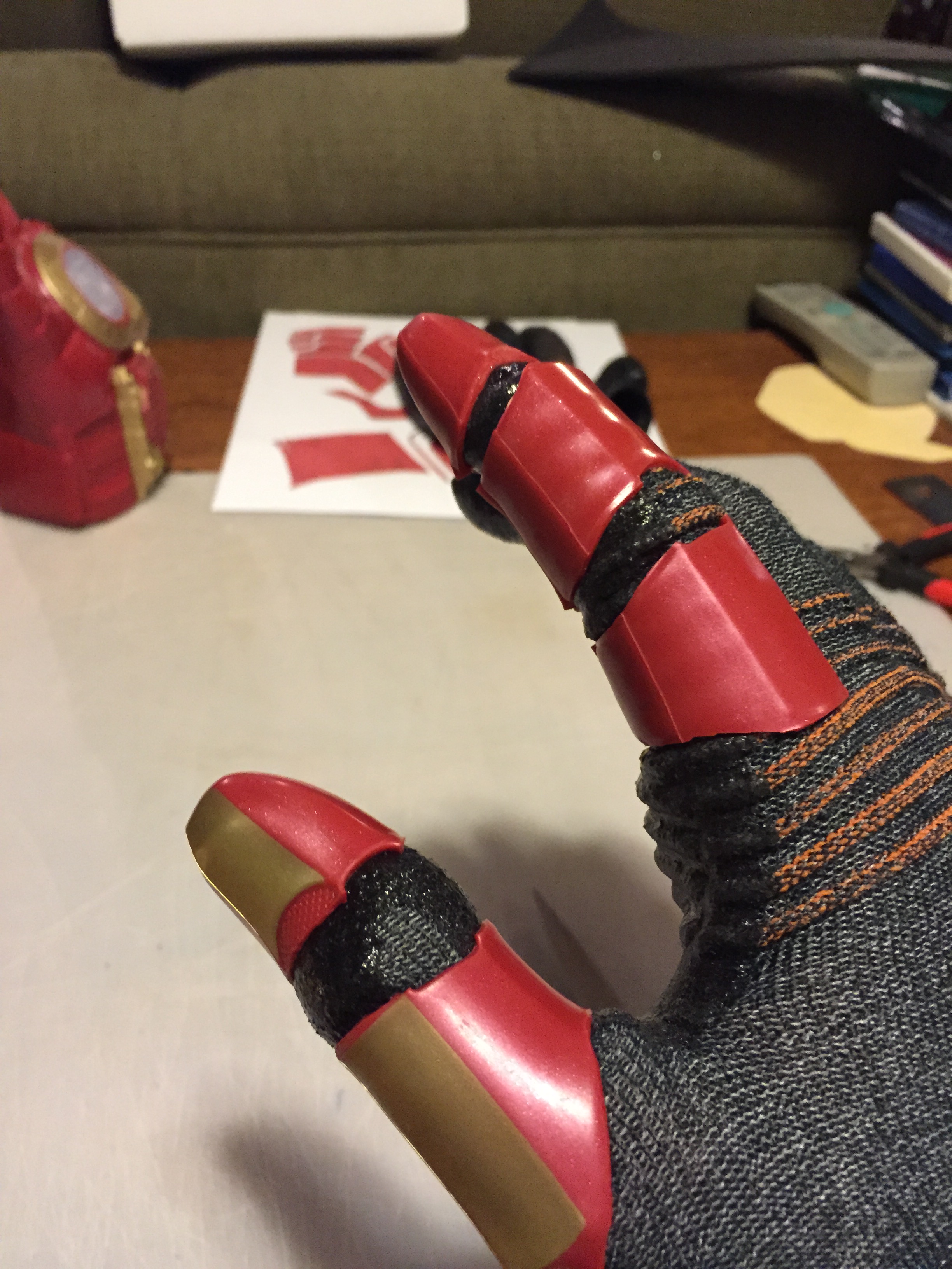

They are too small and inflexible out of the box. That is why I an cutting them into smaller pieces and attaching them to these gloves I found the other day. They even have built in ribbing!
View attachment 461444 View attachment 461442 View attachment 461441
The cut pieces give good mobility and the time I saved is wonderful! They also have a light and sound feature that make repulsor sounds based on the position of your hand.
Hand Down - Light is off and "power down" sounds
Hand Up - Light is on and "power up" sounds
Shake or Thrust Hand - Light blinks and "firing" sounds

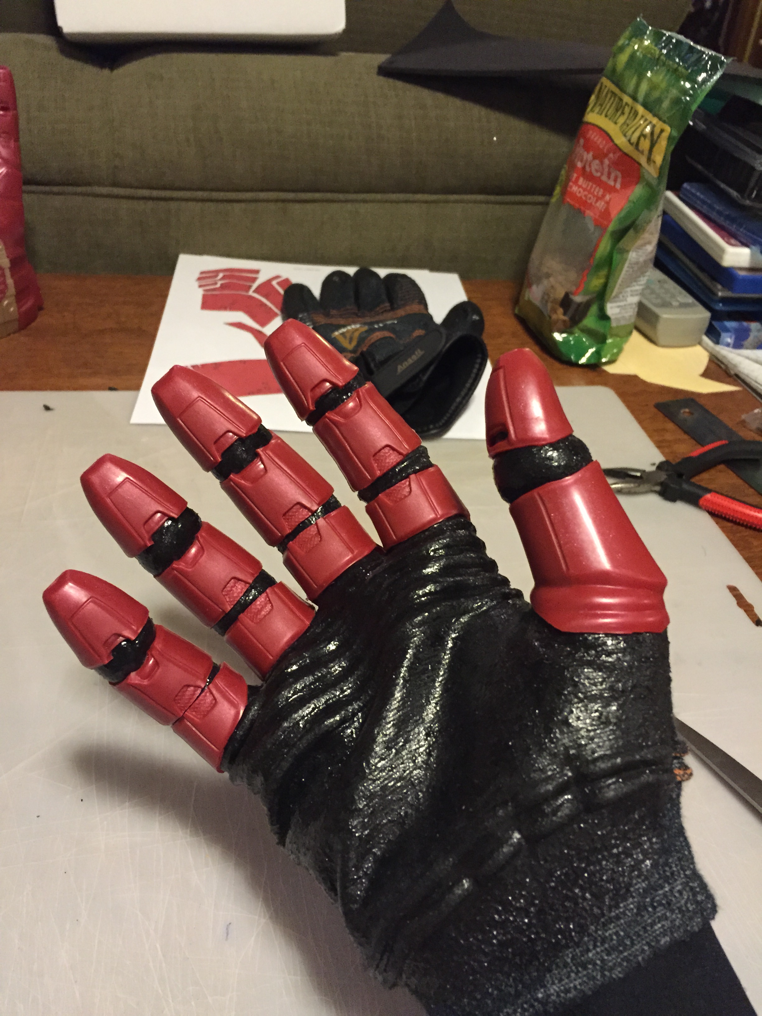

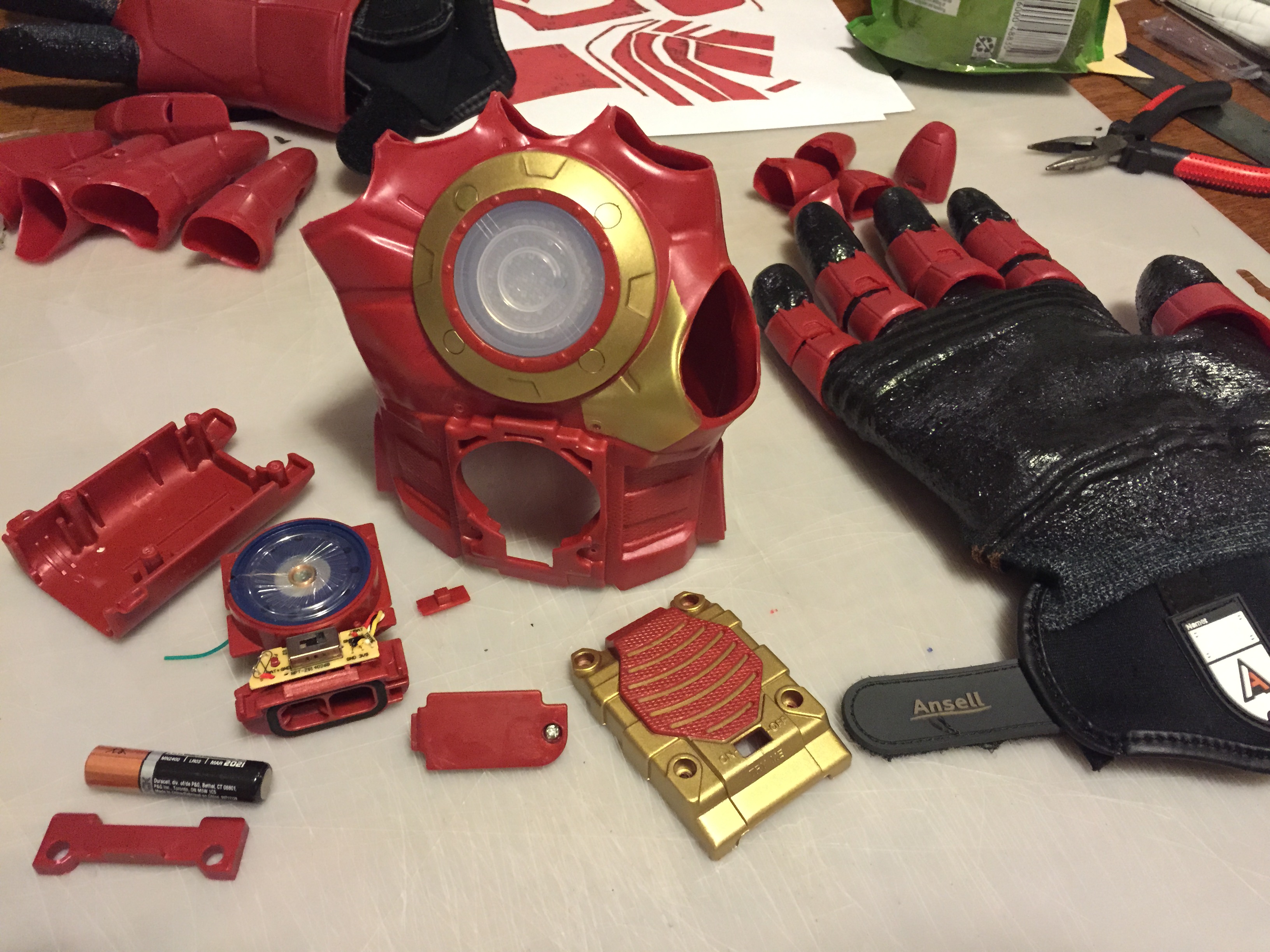

View attachment 461439 View attachment 461440
I am going to leave the light in and build up a bit of foam detail around it and then relocate the battery, speaker and switch to under the handplate.

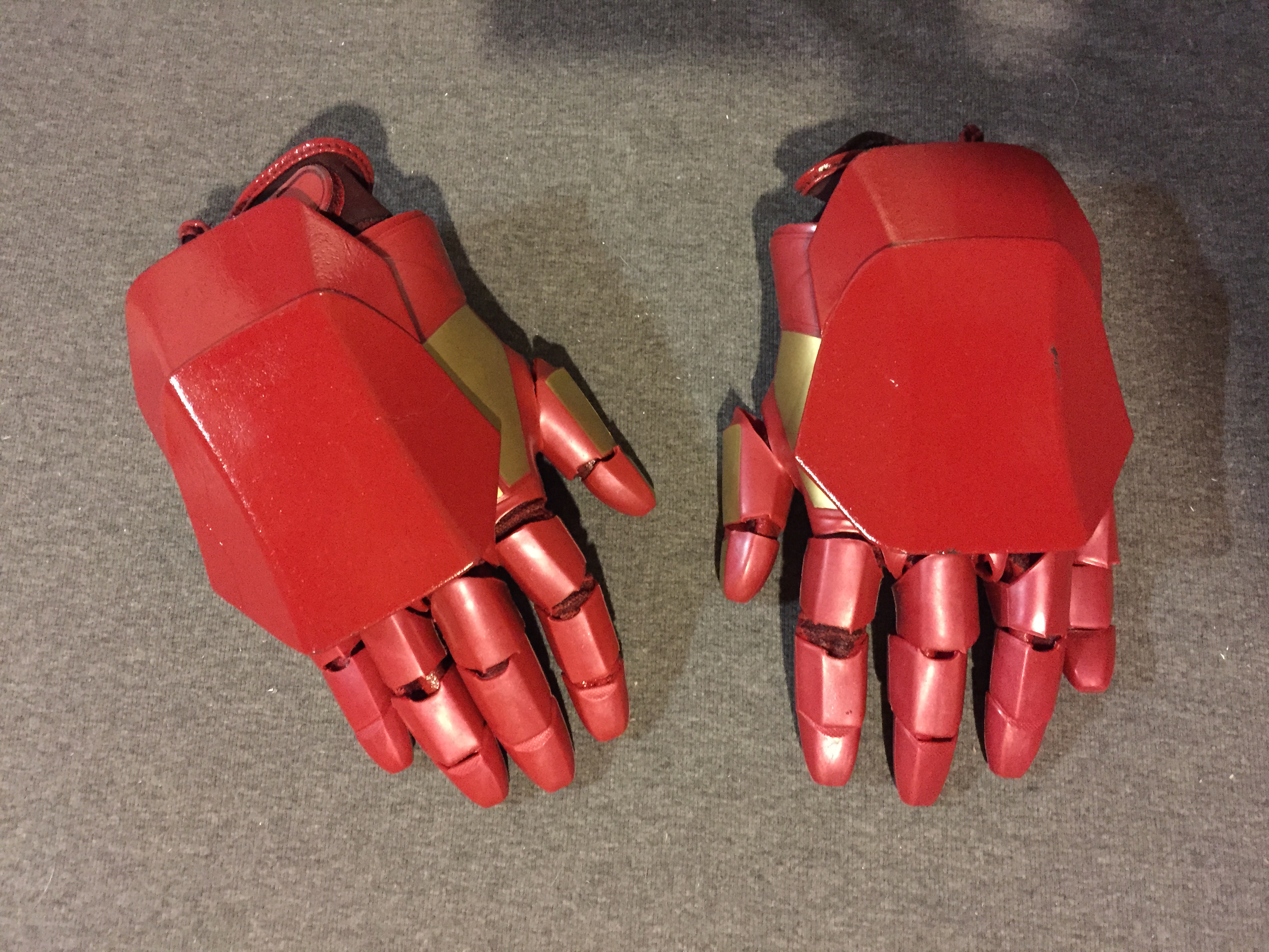

Hey do you think you could post pictures of these finished? I have these too and this looks like a great solution to making them more "adult friendly".
Here you go! I think the only change I would make is to use a red zentai glove underneath since the fingers can be a bit tight on bigger fingers. The pressure has chipped off a bit more of the paint than I would like. This is after wearing them for about 10 hours so far.

You've inspired me with the gloves. What glue did you use to glue both sets of gloves together? I tried super glue on some fabric gloves but they started to smoke! Yikes!
I used the Loctite Gel Control super glue. The only thing I ended up gluing was the fingertips. The rest of the fingers and the palms are free floating and hold in place with just friction since they are rubber!
