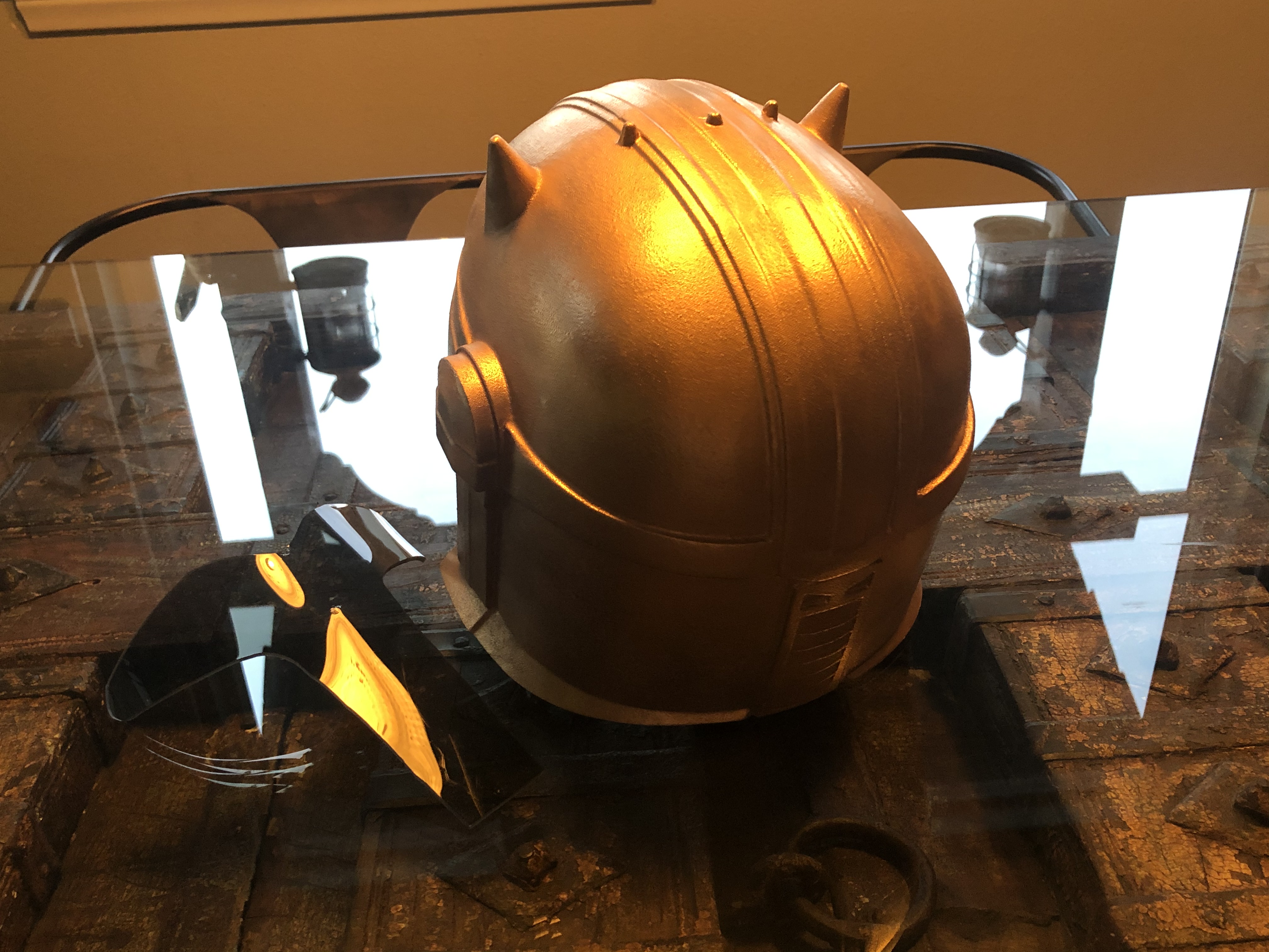

Helmet arrived today safe and sound! Looks fantastic (Of Coarse) Thanks so much, I'll post pictures after I do some weathering, mount visor etc.
Thanks again,
AL
Thanks again,
AL

So how much finishing is actually required on the kit? It looks like just installing the visor and weathering? If so, that's actually within my skill level and I might want one, haha.
The raw cast kits come out of the mold and ship untrimmed. They look like so:
All you need to do is cut out the visor section, trim the edges, install the visor and weather it. I suppose you might want to put in some padding as well. In any case, I've sent you a PM with the details for both versions.
EDIT: bear in mind, both the kit and finished versions include the visor in the price.

Please send me the details about the helmet.
How do you recommend attaching the visor?
PM Sent.
The visor can be glued in using epoxy or CA-adhesive. You can block it in place with steel putty or hot glue it. If you're not sure how you want to do it, you can always get away with taping it in place.
