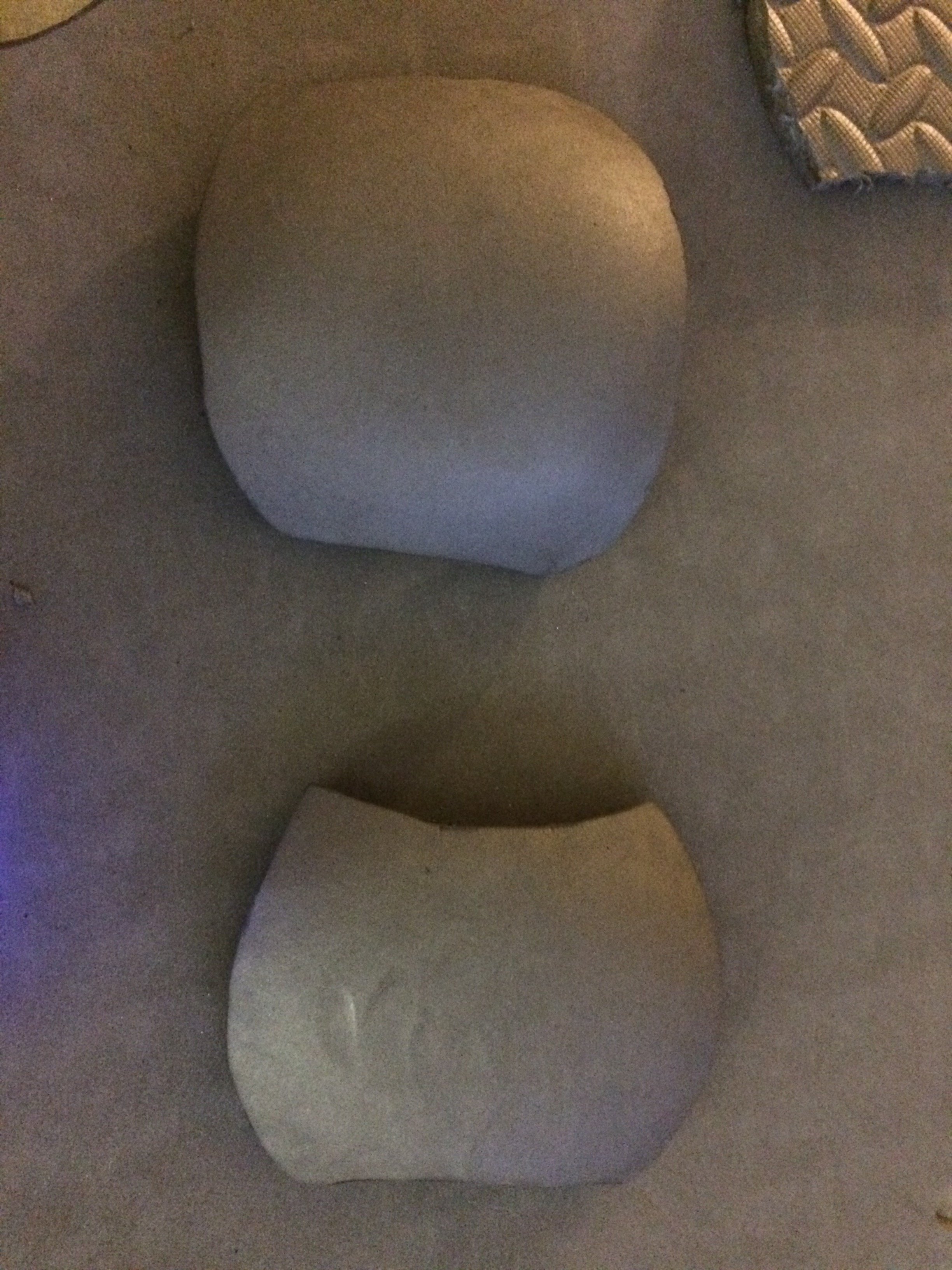

So I got back to making the biceps and I ran into some hiccups.
As you can see, I first create the foam piece and then apply that onto a bigger flat piece to give it that overlapping effect from my first attempt. I don't know how to rotate the image, so please bear with me. IMG_7891.JPG

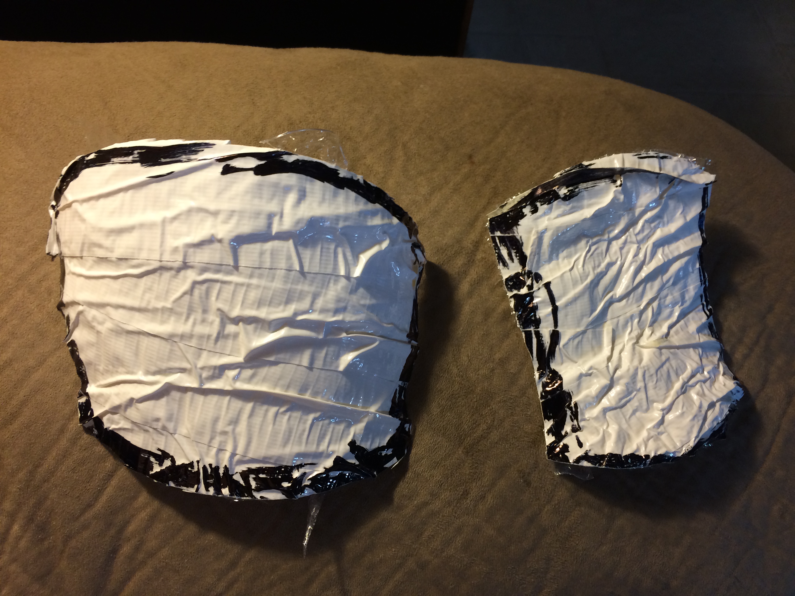

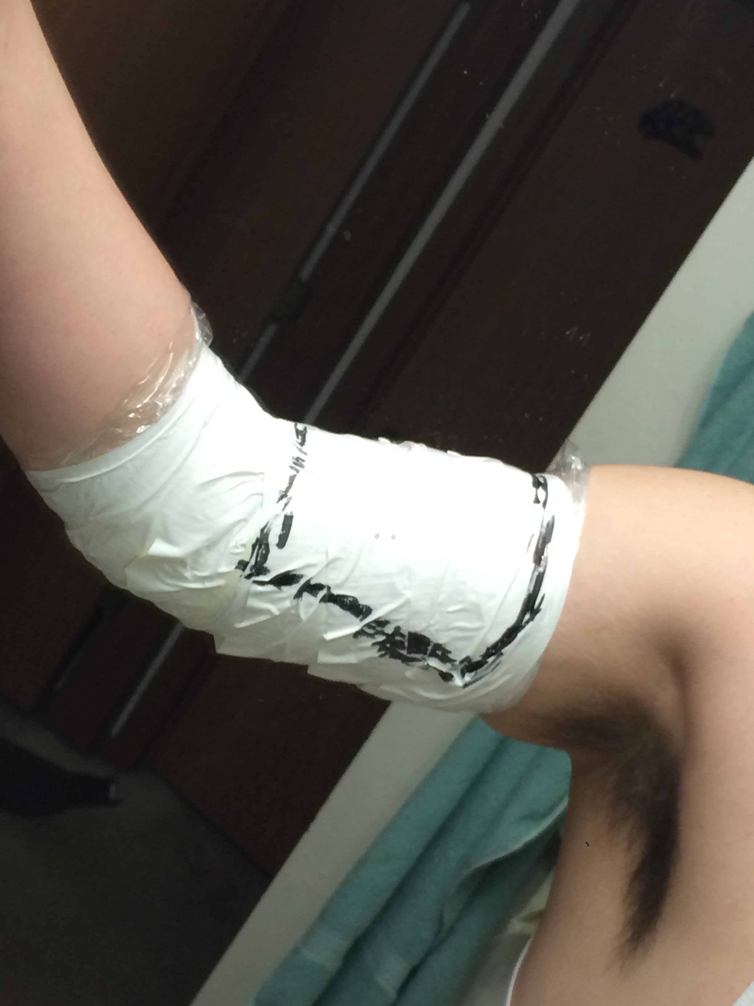

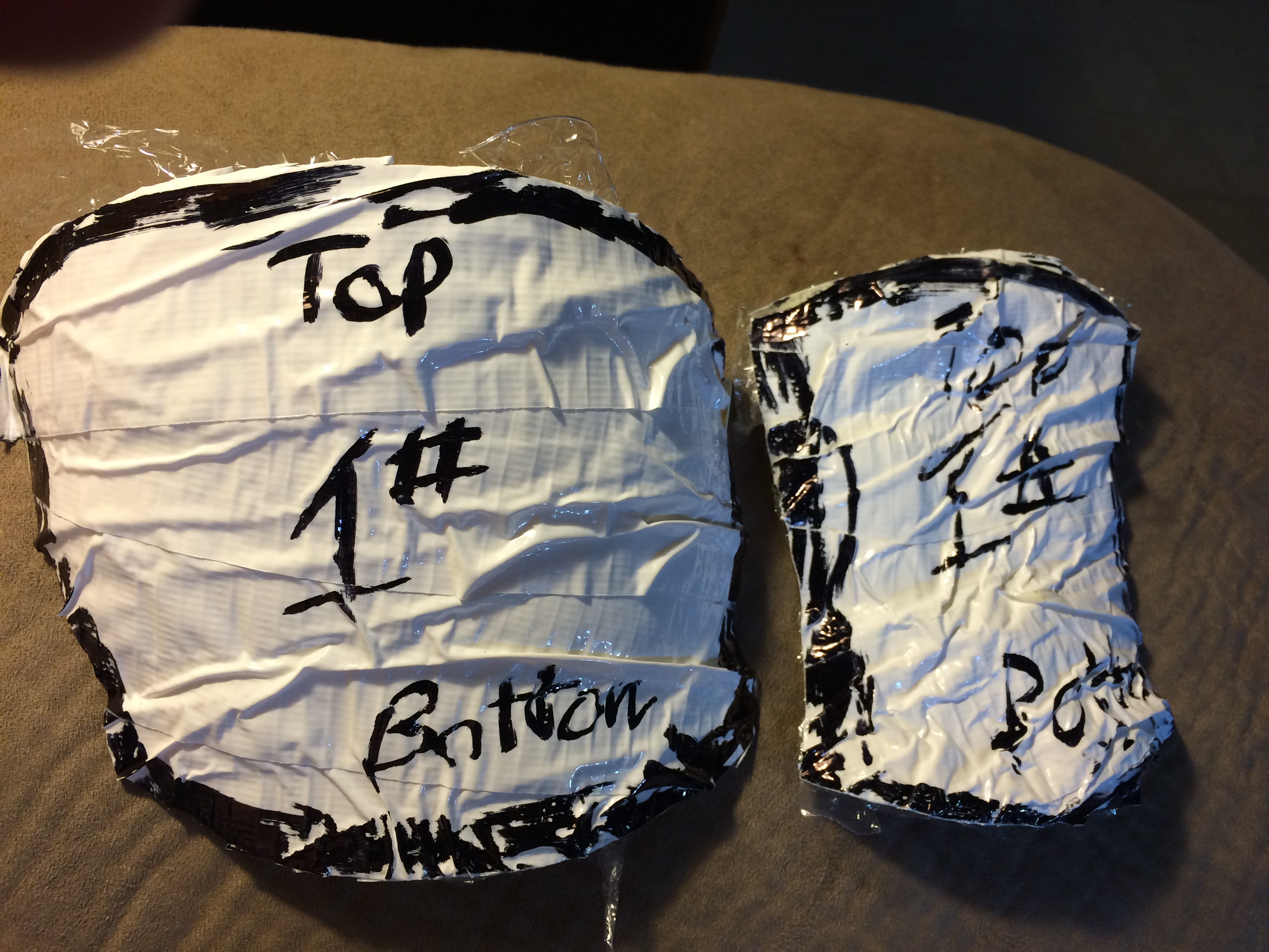

I then decided to use the "ductape dummy" method for more of an accurate depiction of the shape of my arm. then drew-on the details.IMG_7745.JPG
After detailing,I then cut out the pieces and used them as a template,cut out the foam and heated it.
Problem: I'm not going to paint this, instead, I'm going to attach a textured vinyl that looks like Kevlar armor, but I don't know where to get it. Secondly, the base that this is supposed to be glued on has to be of a sturdy material other than flimsy 5mm foam. lastly, I'm still experimenting on the edge details, the hardest part in the arm-build, I could just cut the lines out and heat it to give it more definition, but I want to hear from you guys since you have more experience in this field.

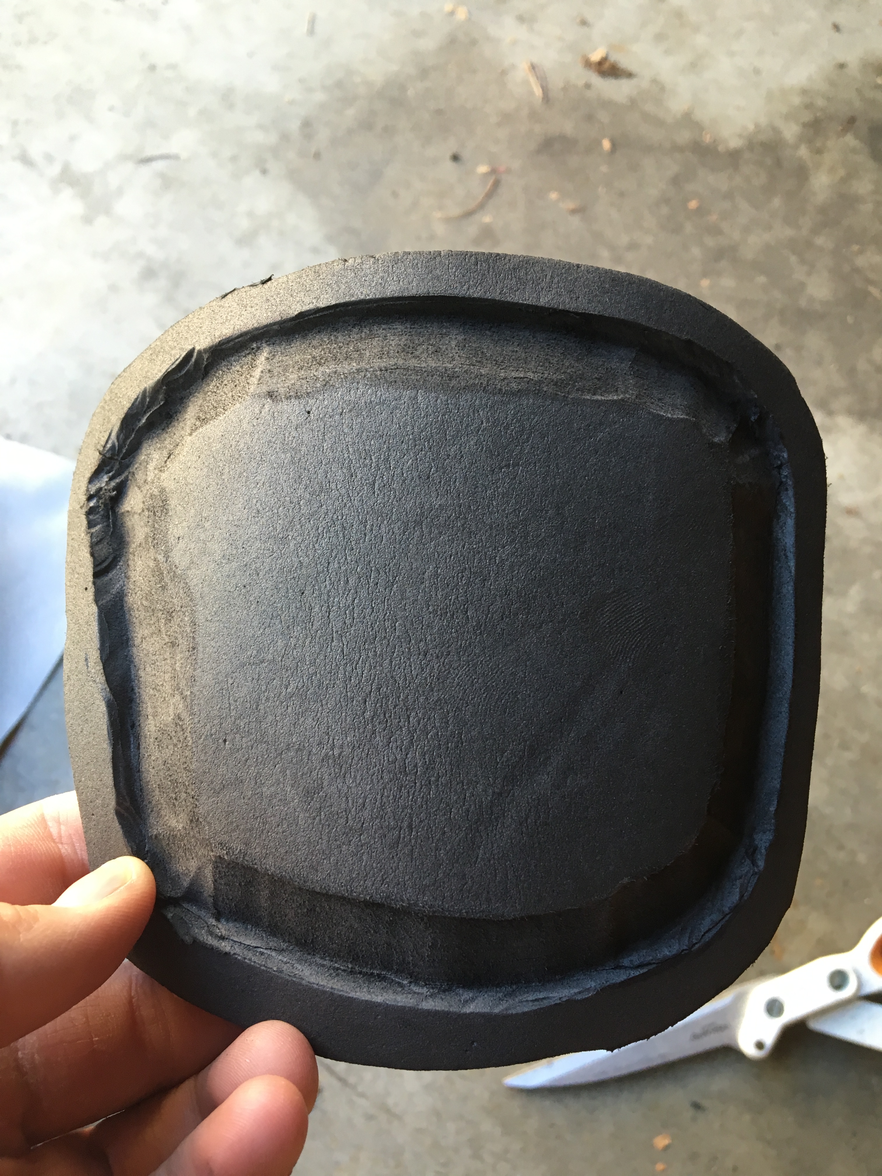

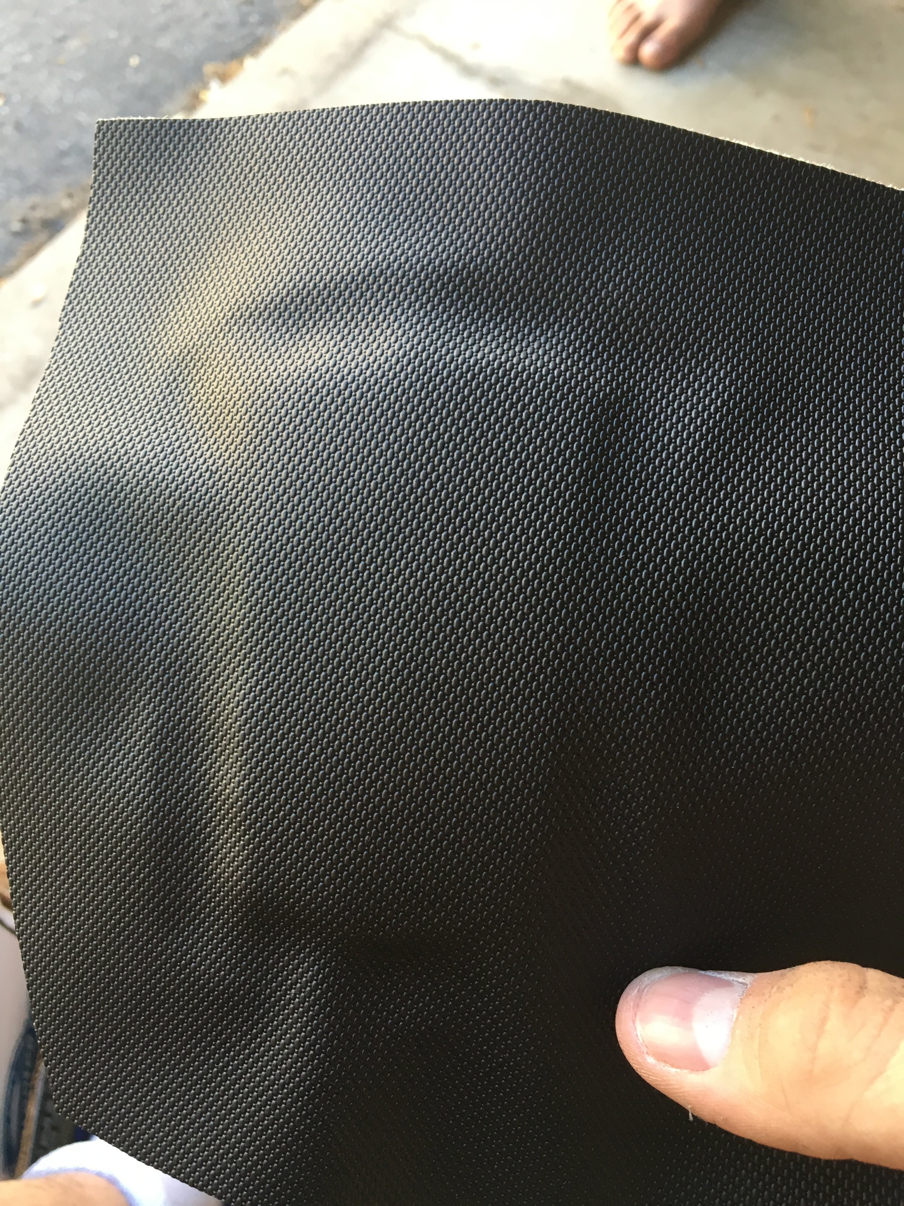

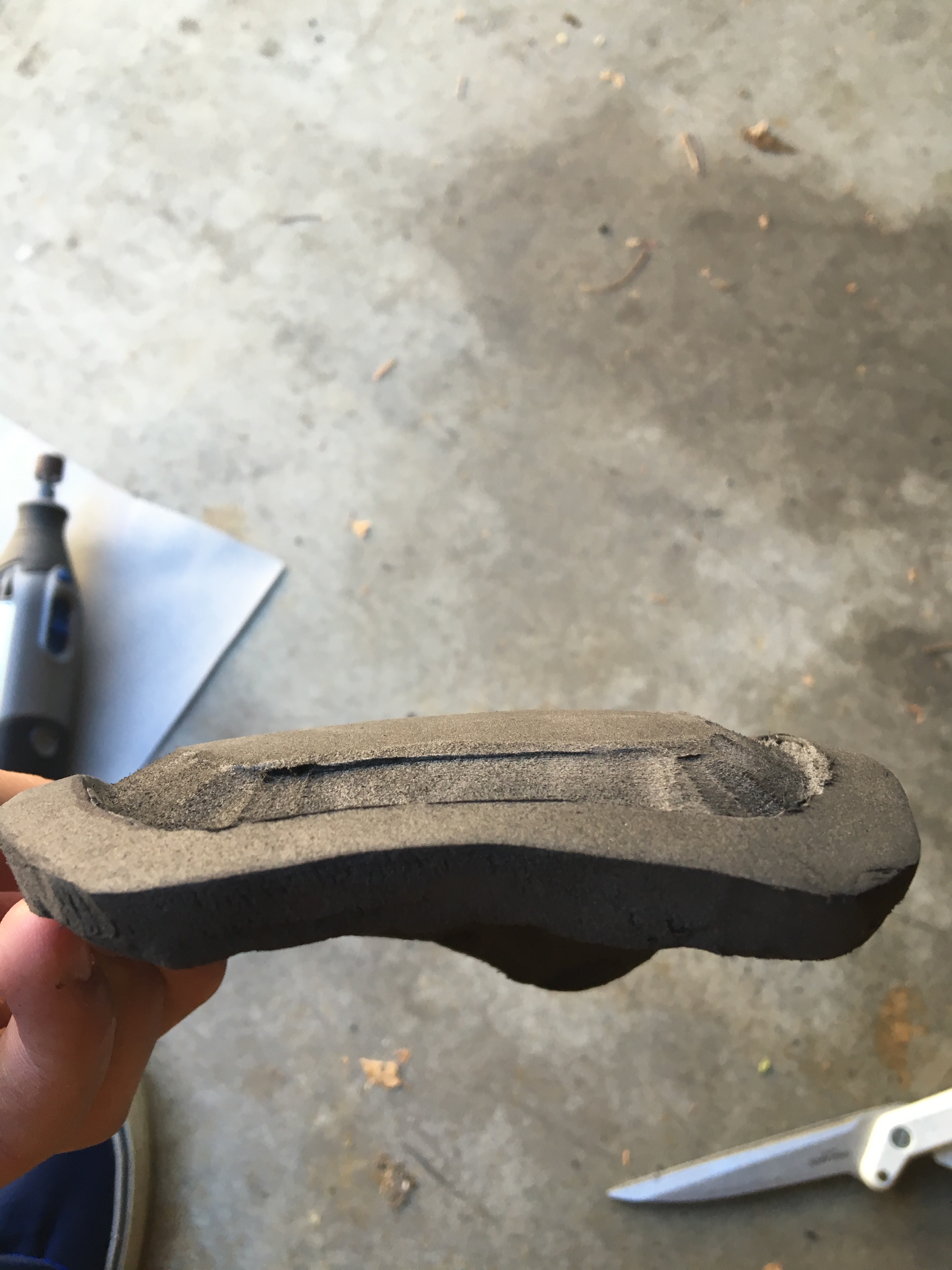

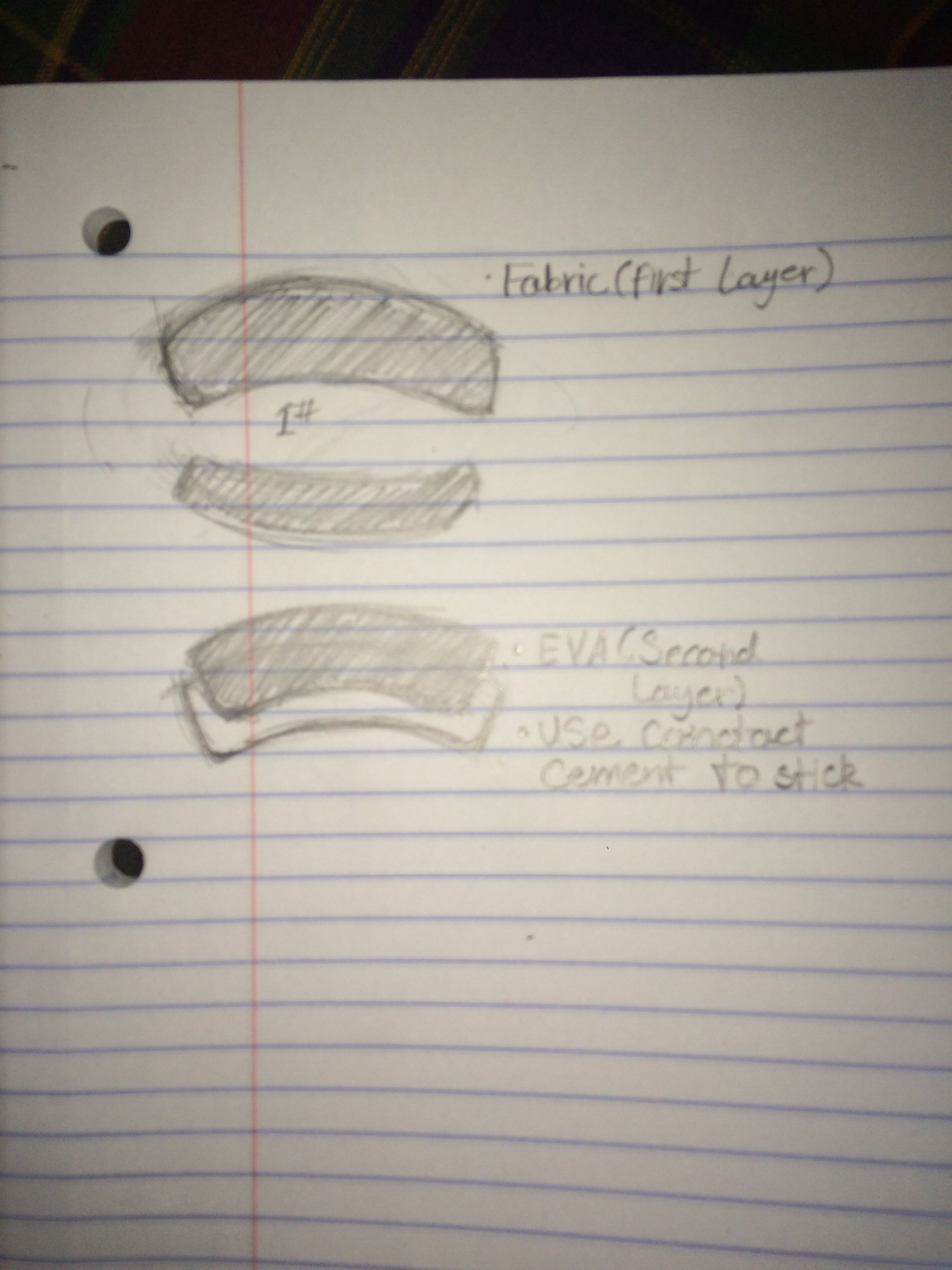

Okay, so I started out by getting the fabric at Joanss. I was looking for a pleather like material that looked....tactical. Luckily, I came across one, I'll let you know what what material it was in later posts. But after getting about 2yrds worth, I went to cutting. I began dremaling the sides of the foam as usual, but this time, getting a more deeper groove.

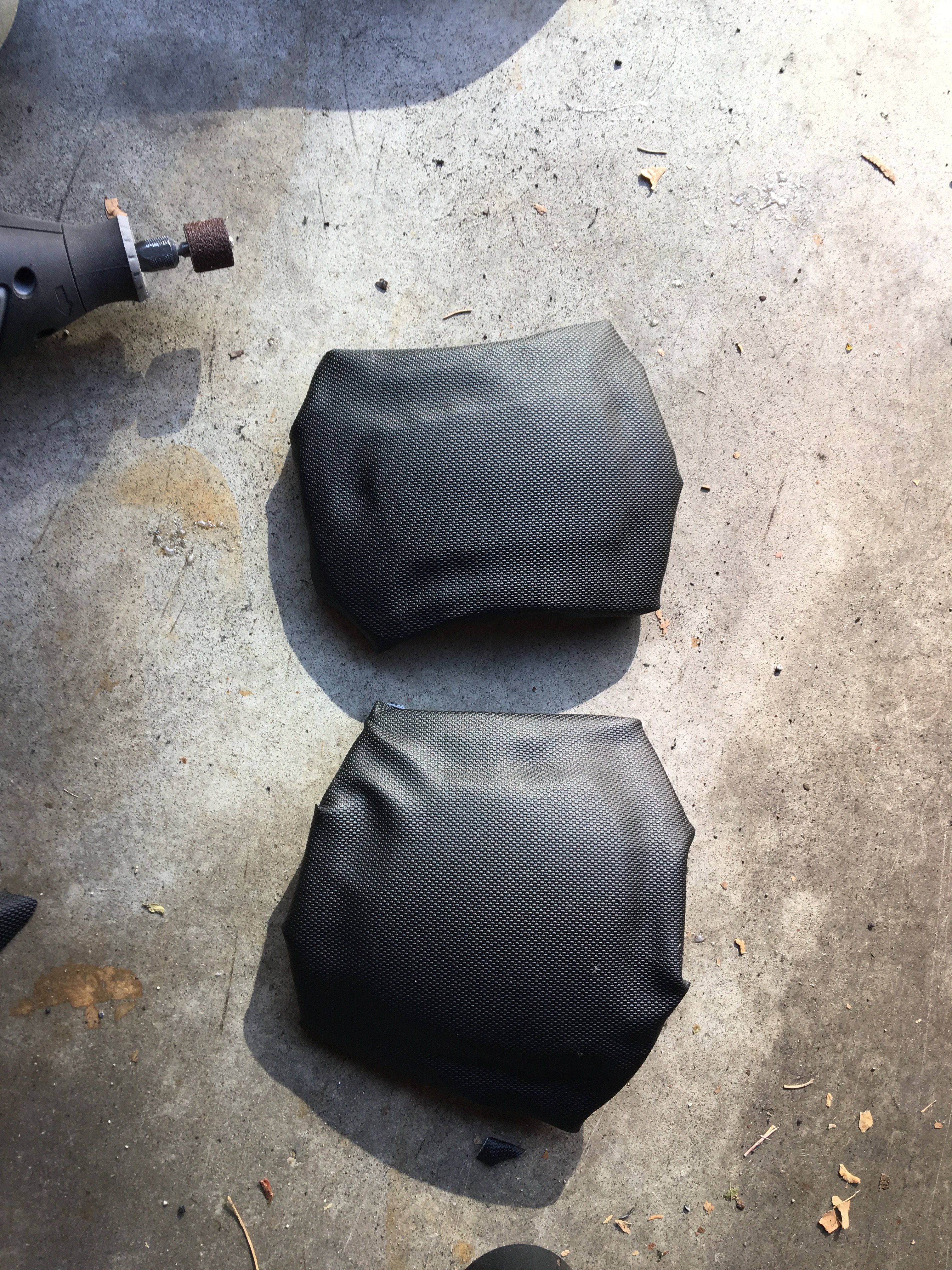

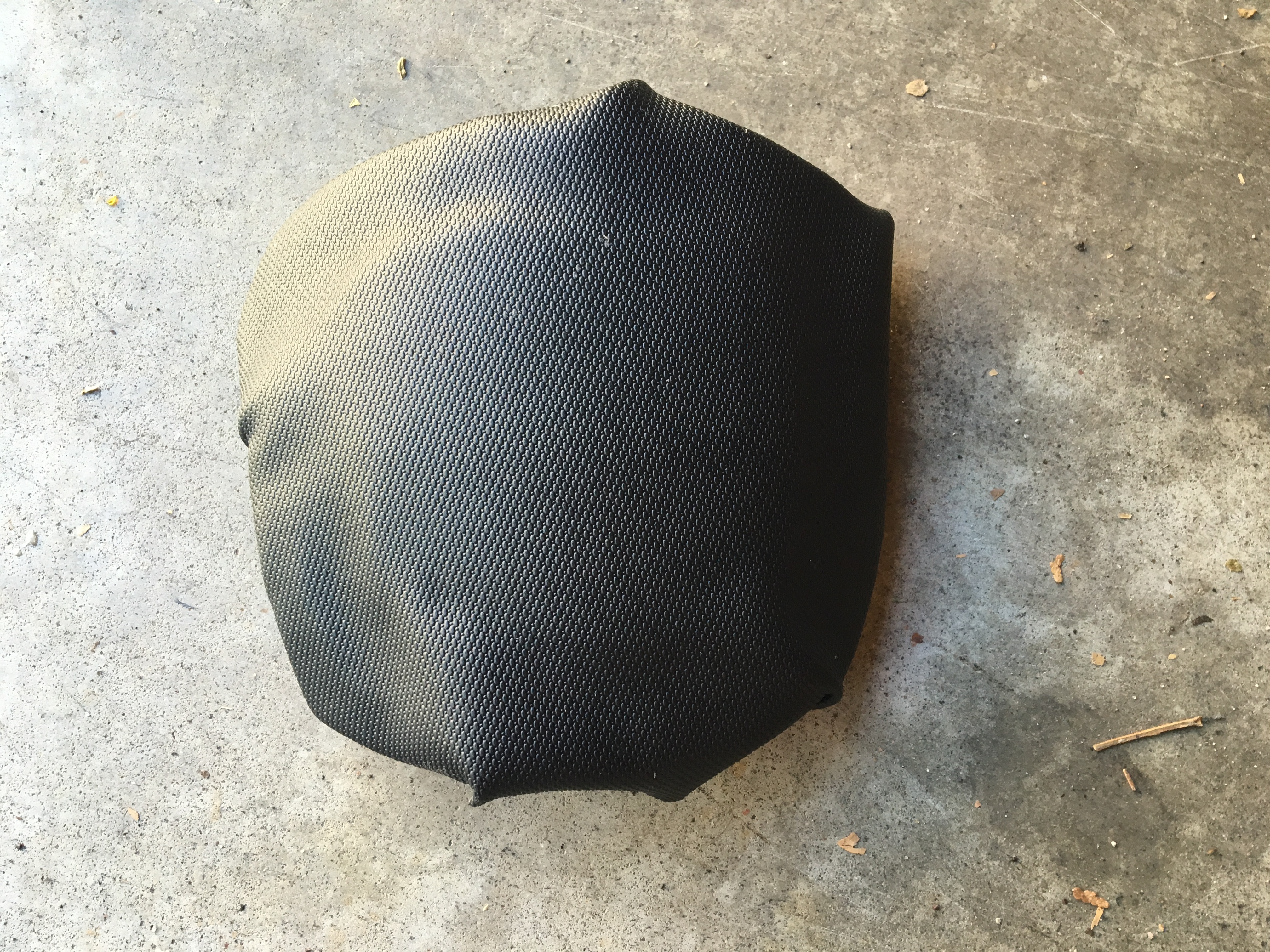

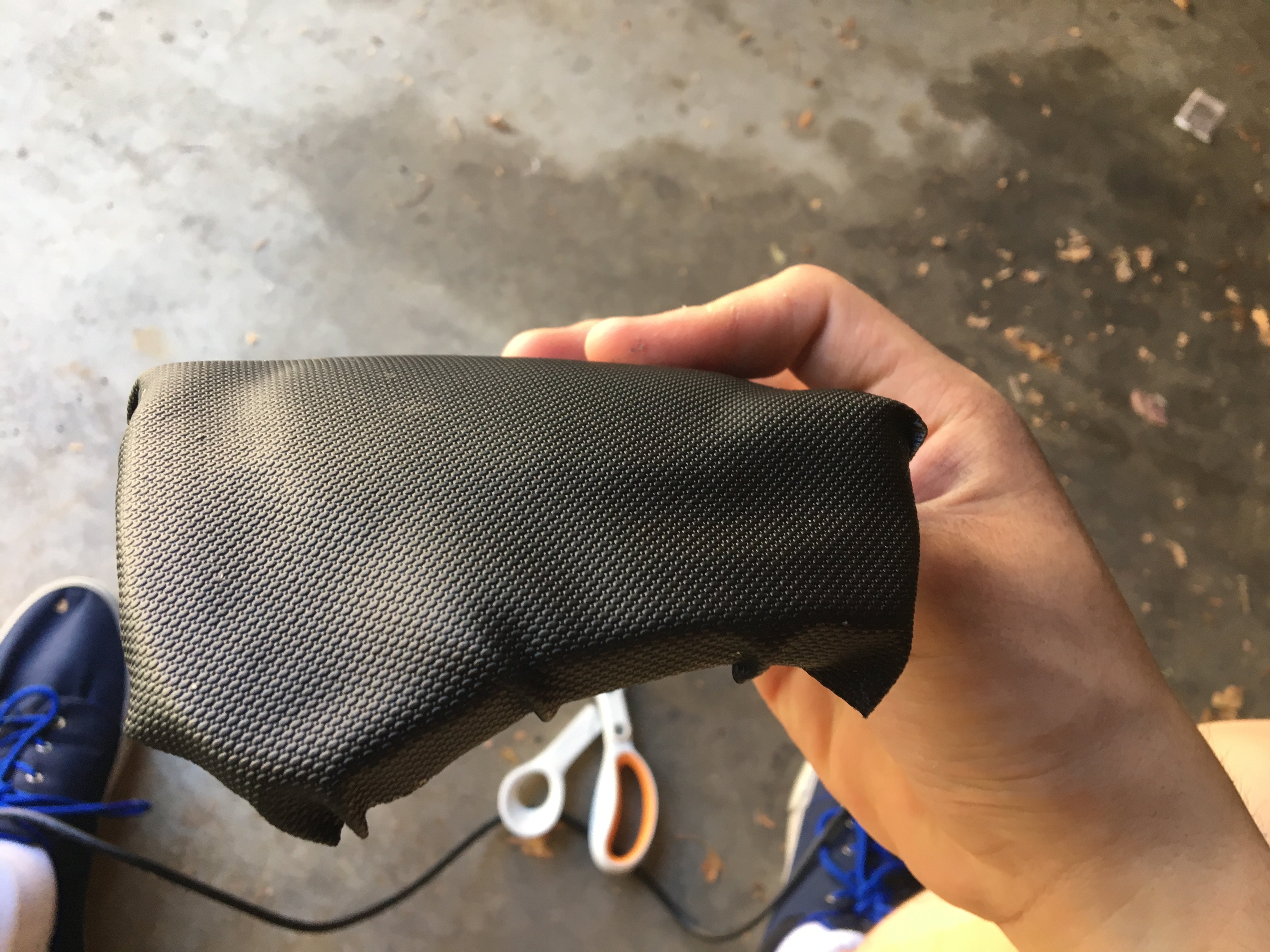

After cutting the material, I sprayed the adhesive and stuck it on the foam. I then grooved the edges to give shape.
After gluing it on I trimmed the fat (unwanted flaps) and got the result you see here. Yes, I need to practice it a bit more to get it perfect, but for right now...baby steps.
