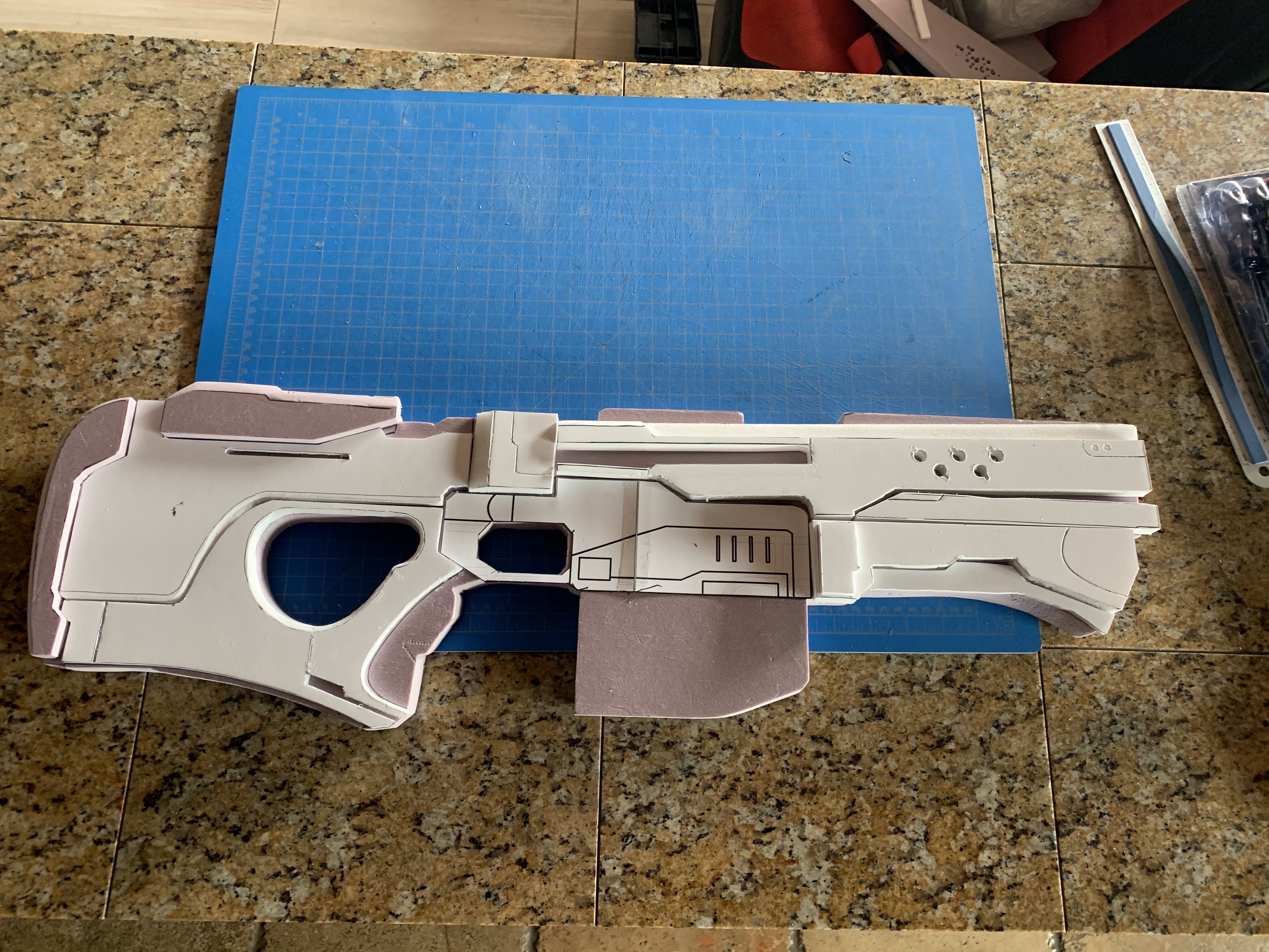

Step 2. Cut the base Stock & Receiver
I decided to make the magazine non-detachable, since I didn't see the real need to show it removed during a Con. I cut the barrel and parts I didn't want in the base off and traced the pattern onto the XPS foam board. Cutting the foam can be tricky, since it's not EVA foam. I decided to cut all of the straight edges away first, then trim away. XPS cuts with several long straight passes, but can leave a jaggy edge if you don't keep your utility knife sharpened. I tried using the same techniques I use to cut EVA foam and I think it helped a lot. I suggest sharpening the blade every 3-4 passes, because this type of foam dulls a blade as fast as EVA foam, maybe even faster. To cut out the trigger guard and the stock grip, I drilled a hole, then used a newly purchased scroll saw to cut that rounded section out. I wasn't very skilled with the scroll saw, so I left myself a bit of extra space during my cuts and decided to sand the foam down to the cut line.
In the photo, you will notice 2 cut out base's that I made. I didn't use the upper piece because I didn't like the cuts I made, so I went back to cut a better stock.

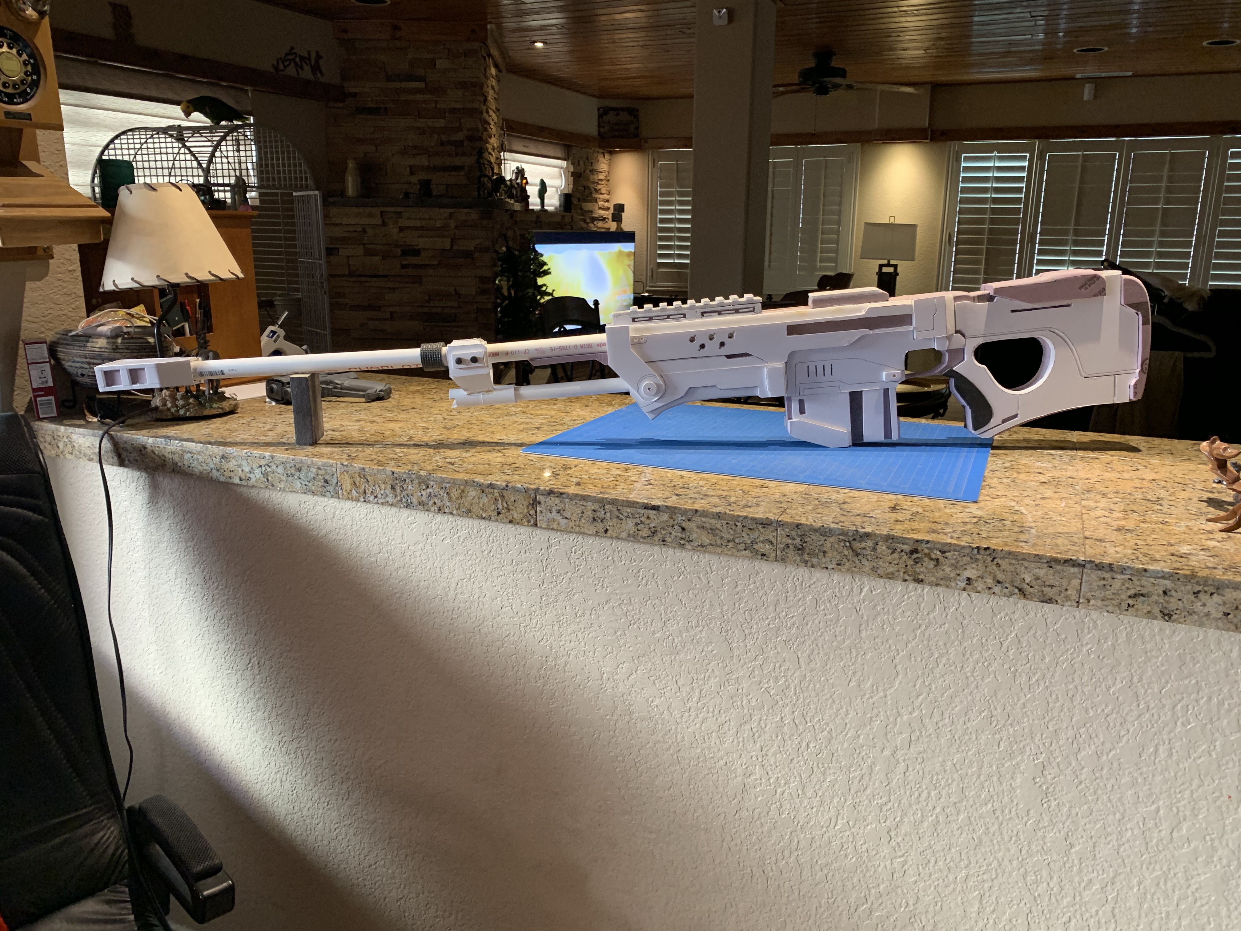

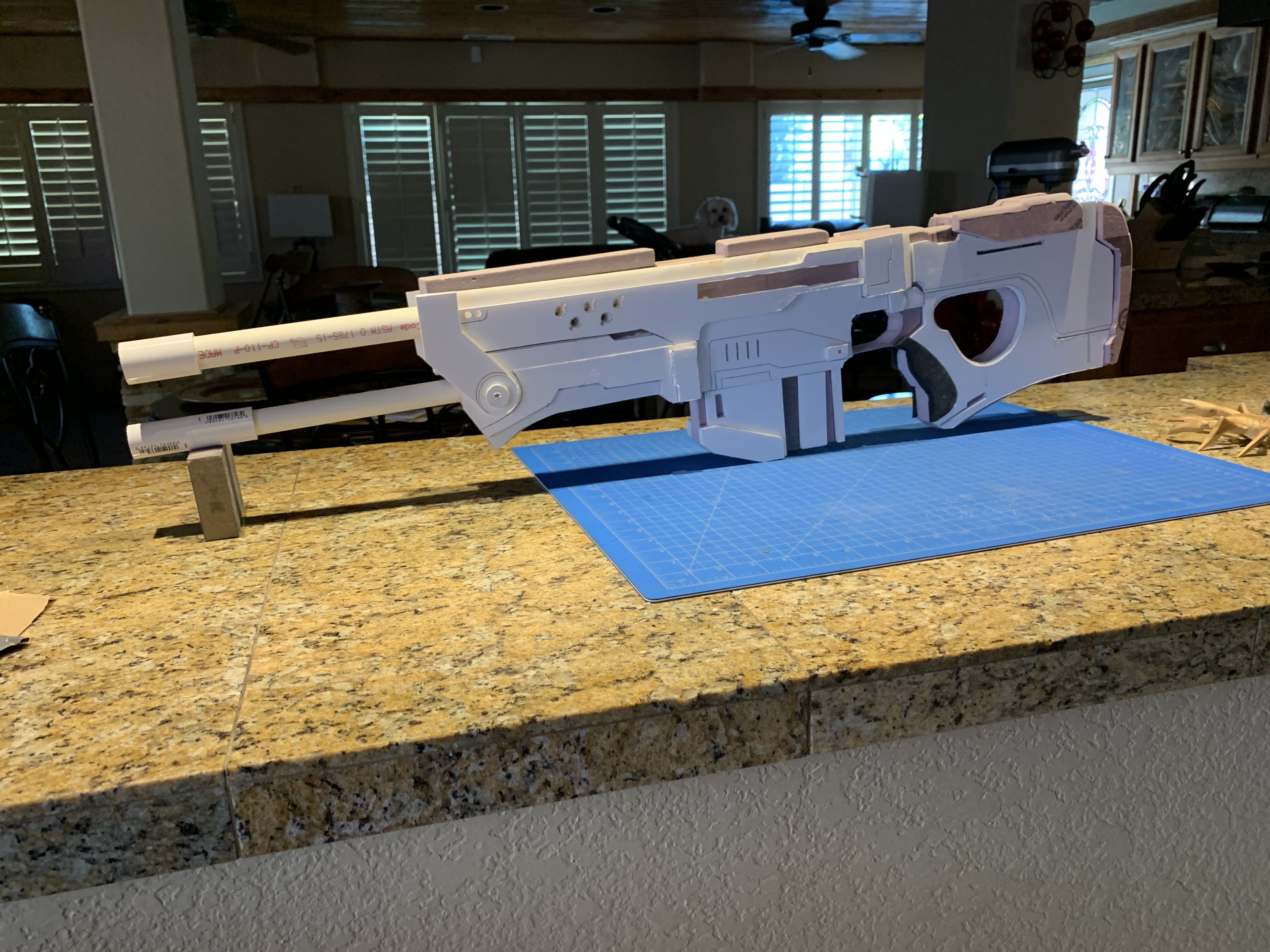

Note: Before I glued the front receiver layer on, I cut out 6 inch slots in the base for the barrel and the lower barrel. Basically, I sandwiched the PVC pipe inside the base, with a 1/2 foam core piece on each side to conceal it. I used 3/4" PVC for the barrel and 1/2" PVC for the lower barrel and hot glued it in. I used the templates for placement of where the barrels were to be placed and aligned in the base stock/receiver. As you can see in the above picture, I aligned the placement of the barrels based on how the templates were designed.
I bought a couple PVC connectors, since I wanted to remove the upper barrel for storage and transport. The lower barrel was 2 connectors superglued together to build out a longer piece.
Step 4. Barrel, Muzzle Break and Bipod Legs
I used the templates and cut out detail pieces for the bridge that connected the upper and lower barrels using the 3/16" foam core board. I made the muzzle break out a chunk of 1" XPS foam board, but skinned it with 3/16" foam core board to give it a better finish. Like the barrels set into the receiver, I cut a 3" slot into the XPS foam to mount the muzzle break onto the end of the barrel. All of the PVC pieces were hot glued into their place in the XPS foam slots. This is where I took artistic liberties and added side vents that suited the look I wanted. I'm sure if I used the exact reference pics,I could create a replica muzzle break. The details are just cut outs in the foam core board, or pieces added to give the muzzle break some dimension.
I built the bipod legs out of 3/16" foam core board. Big tip: I had to run out to get more 3/16 and bought the Elmers 3/16 board from Michaels. This is not the same foam core board that I bought at Hobby Lobby. The inner foam is not as dense and the foam crumbled a lot during many of the cuts. I ended up spackling in the spots that crumbled out, so make sure you buy the same type of foam core board that architects use to make their models, since that product is made to be cut, while the Elmer's foam core boards are more for mounting pictures. I used small punched out bits of 4mm EVA foam for the bipod leg rivets.
The bipod legs are glued in place and static. After seeing if I could make them functional, I learned that the foam core board wasn't sturdy enough to hold the weight of the rifle up. Also, the angles of the bipod legs didn't seem to swing out in a manner that was level enough, so i followed everyone else's builds and made the bipod legs fixed.
Since the bipod legs needed more support when the rifle was set down, I elected to add a cross support piece between the legs, then add a 1/2" block of foam core and a metal spring clip that is used to clip brooms to a wall. When the clip is inserted onto the lower barrel, it added great stability and strength, so the bipod legs can sit square on the table and no wobble or tip over.

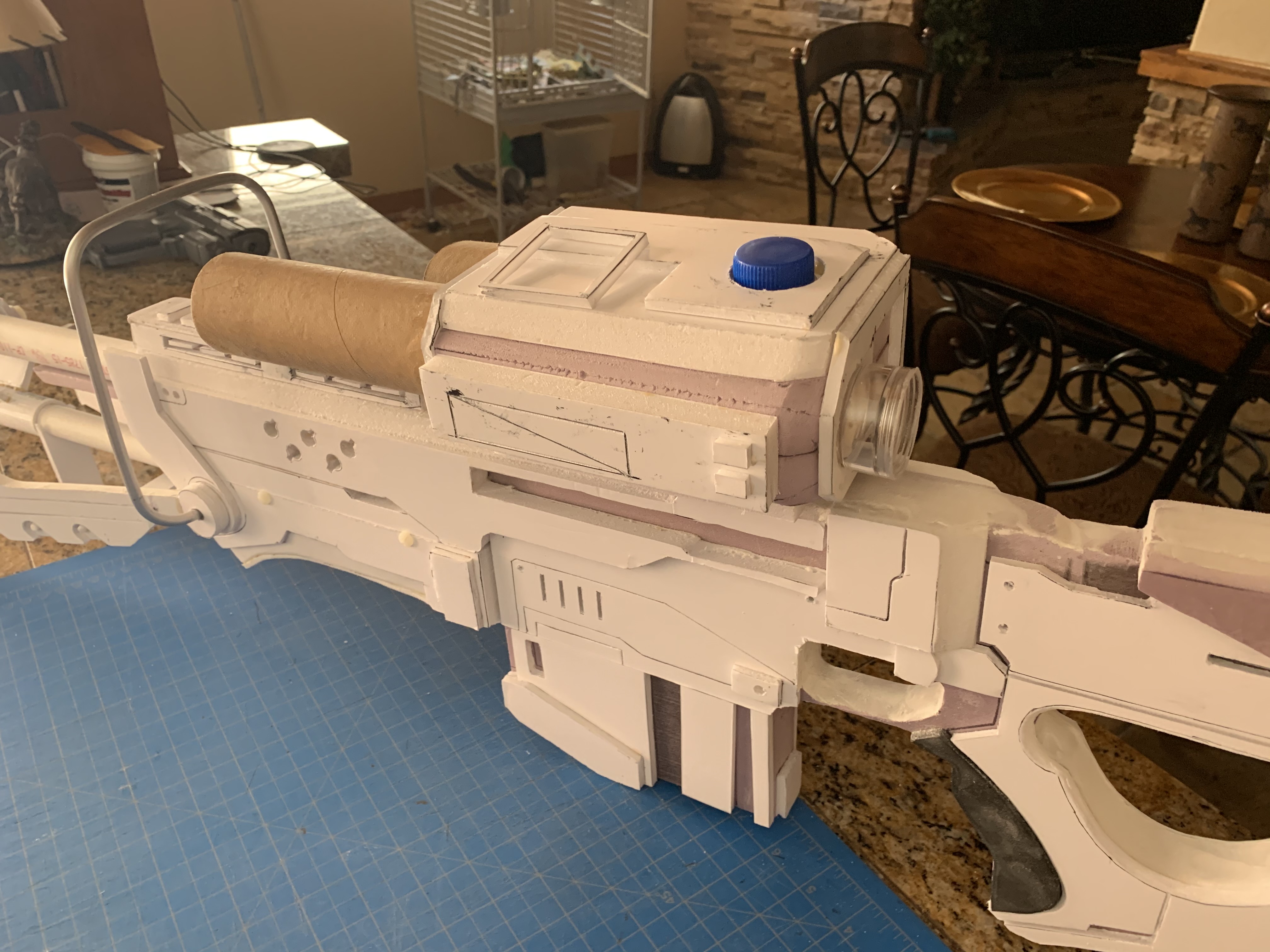

The scope was built gluing two 1" blocks of XPS foam together. This gave a 2" tall scope that was cut to the shape in the templates. I had to skin the scope with more 3/16 and 1/2" foam core board to build it out, and give it the size needed. Again, layers of detail foam core was cut to give it the shape and look. The scope had 2 scope tube parts, that were made from paper towel cardboard rolls and recessed into a circle cut into the foam core board that skinned the front and back of the scope. The top dial was a soda cap and the rear eye piece was a plastic paint container I found in my paint set.

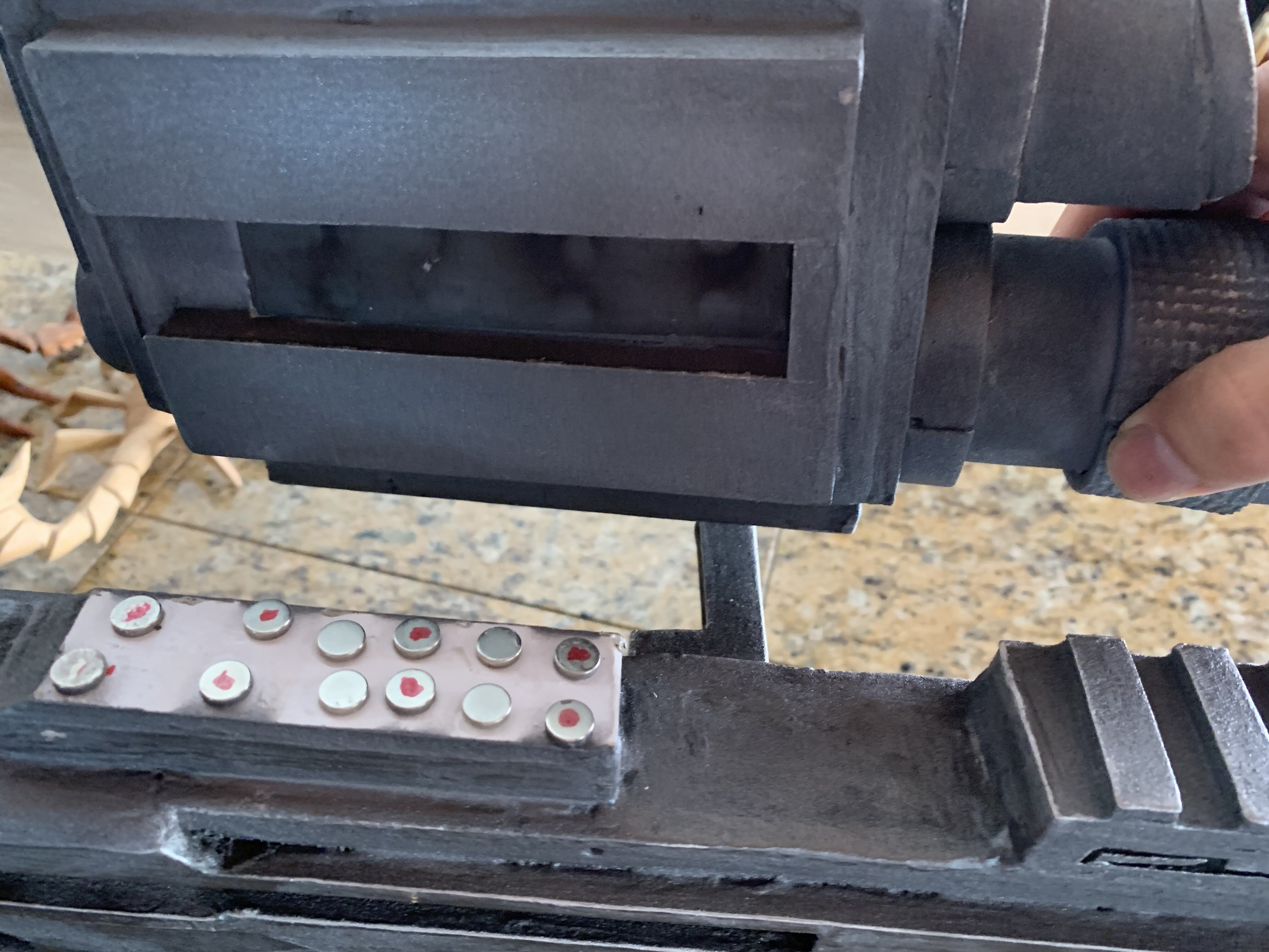

The scope is not permanently mounted on the rifle, but I used rare earth magnets to detach it for storage. I achieved this by building out side rails with 1/2 foam core board, that snuggly sat on top of the rear top piece I had from the base. I Super glued
several rare earth magnets to the top rail and glued a flat magnet strip inside the recessed part of the scope. I've tested the holding power and so far, the magnets do a good job holding the scope in place.
By the way, detaching the scope was great for painting the prop too. It was nice to work on it detached and not fumble with turning the whole prop upside down to prime and paint.

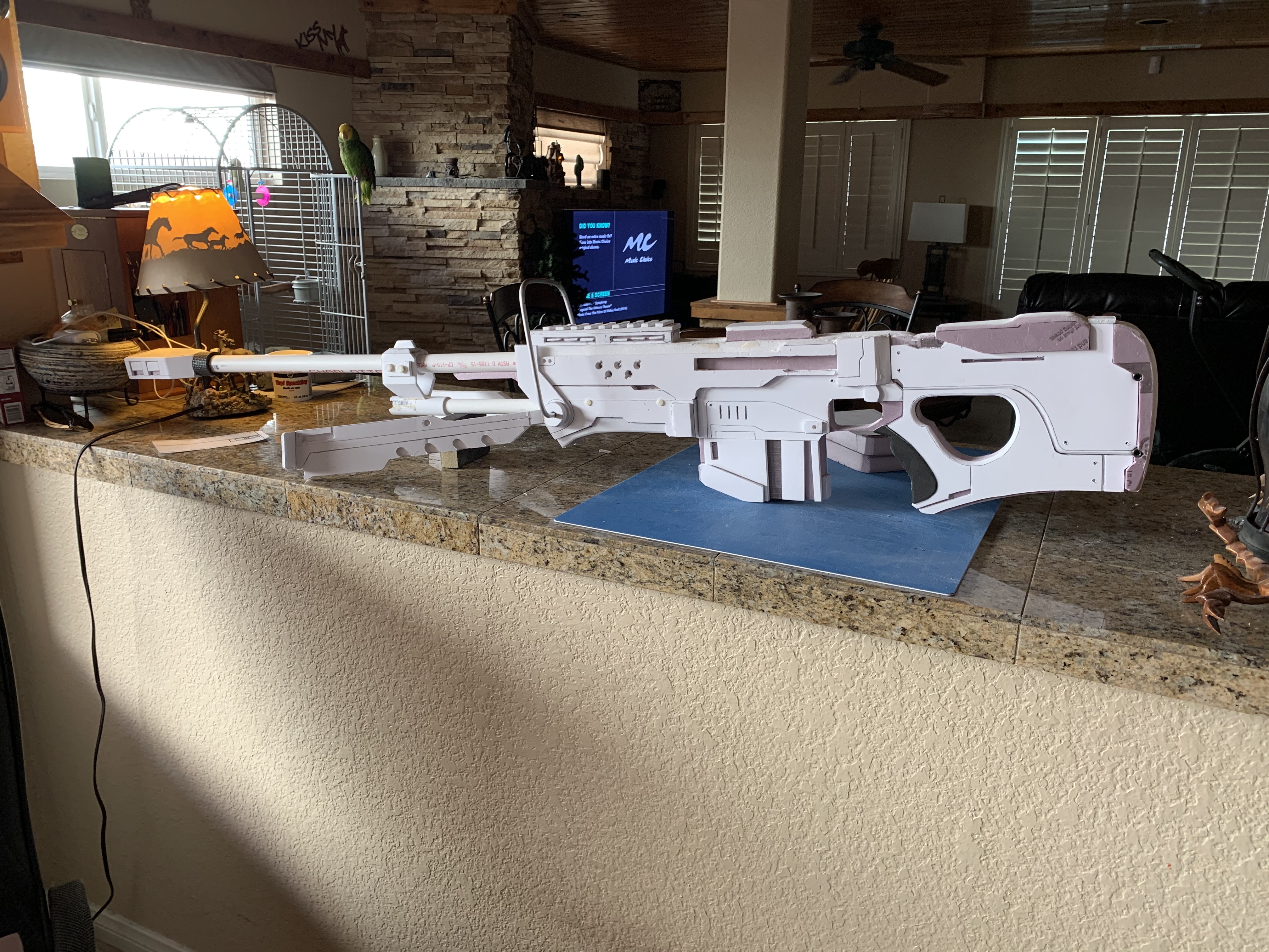

I researched how to paint XPS foam, and to fill the knicks and gouges. Since my plan was to spray primer, I was worried that the spray can would melt the foam. I ended up using a vinyl spackle with a bit a water to massage it into the XPS foam fill it where it was rough and all over to seal the XPS foam. Once dry overnight, I sanded it smooth. This was a good product and with a flat surfaced plastic spatula or putty knife, spread the spackle nicely. The spackle dries fast, but I gave it 24 hours before sanding.
I added some scrap EVA foam here and there to detail the barrels, the forend grips, the scope sights, etc. I used a clear acetate sheet and a window tint to cover the scope ends and give it a finished appearance to look like tinted glass. I just traced the size of the scope circle onto the acetate, cut it out, then applied a small sheet of window tint. Once the water was squeegied out, I trimmed away the tint and had my lense. I used EVA foam to sandwich 2 circle cut outs between the lense and hot glued to the scope tube.

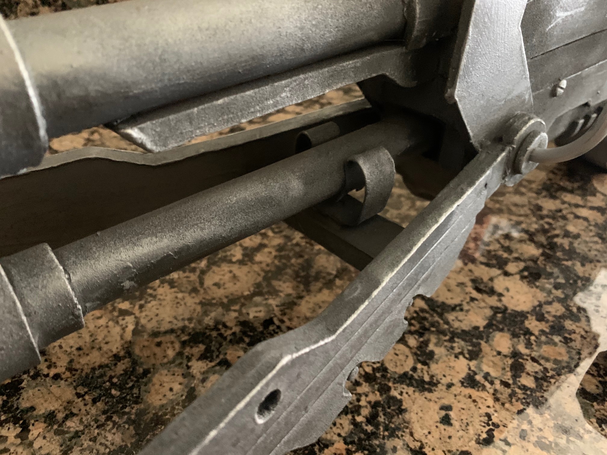

For finish details, I bought some nylon or plastic screws and hex bolts, then cut the ends off and hot glued them where there were visible screws and bolts. I bought plastic furniture hole covers and glued those to the stock to match the reference pictures I used. I also scored the foam core where there were detail lines, then widened the score lines with a metal pointed hook tool to give the lines some depth.
I finished it off with a few coats of Mod Podge and then a spray primer. I was confident the rattle can primer would not melt my foam, since I sealed it as well as I could.

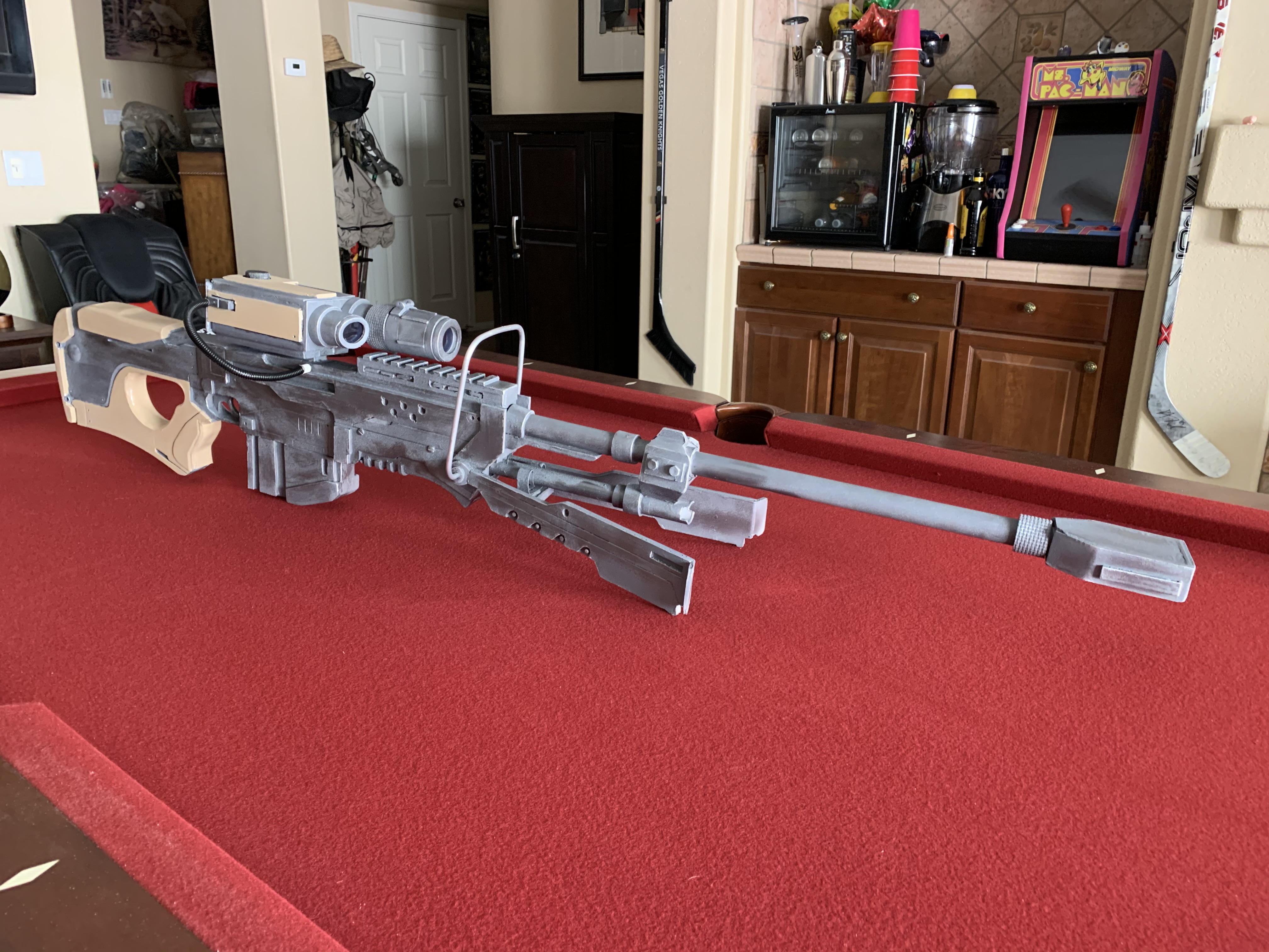

After filler primer and finish primer, I sanded and scotch bright sanded it smooth, then airbrushed it a gun metal gray. I hand painted the tan stock grips and scope details. Finished it off with some silver dry brush weathering and a coat of Pledge Gloss floor sealer for protect the paint.
My mistake may had been not sanding the filler and finish primer down on the foam core enough. Filler primer is a bit pebbly and if I sanded it smooth, my finish surface would be smoother.
The carry handle was a bit tricky to make. I first bought a 36" piece of 1/4 stainless steel, but it was almost impossible to bend with my tube bender. A ended up buying a piece of 36" aluminum rod from Home Depot and it bent in a 90 degree angle with the tube bender with no problems. After cutting the ends off, I squeezed it into holes I drilled and it worked out perfectly.
The last detail I added was the cable on the scope. I used some left over RCA stereo cords and cut them to size. The them covered them with 1/4" wire protectors and hot glued the ends to the RCA fittings. Finding the right sized wire cover was a bit challenging, but I found the coiled looking covers at Harbor Freight for about $3.48. I cut the right length and inserted the wire into the slit. This cable is removable, because I inserted the RCA jack plug into holes that I made in the foam.
