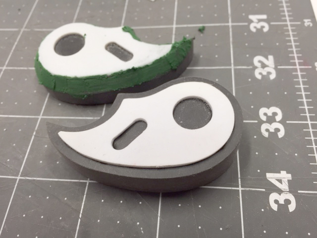

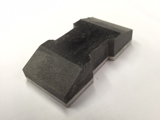

Beginning this build. Should be able to build everything up with layers of Sintra and styrene. Started with the little winged clips around the buckle.

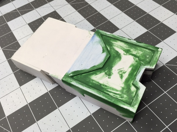

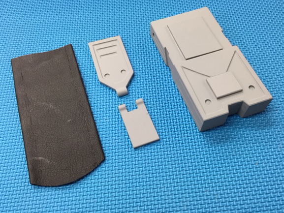

I built out the components of the main pouches. I am bit bit torn. My plan was to build this as a hero prop and cast all the pieces you see here and assemble them with a real leather flap. My only concern is how sturdy some of the small pieces will be for folks who (unlike me) actually wear the belt.
One thought is to assemble the whole pouch and mold the entire thing assembled ... then cast it in Smooth-on's FlexiFoam ... which I have zero experience with.
Any experiences with FlexiFoam anyone could share?

This looks fantastic!
I do have experience with Flex-Foam IT. I cast my Origins belt in their 17. 17 and 25 are very dense and self skinning.
You'll need a mold with a fibreglass jacket. A full silicone mold won't hold the pressure of the foam expanding. And you need a backer board for your mold. Like mdf with a smooth side. Put a few holes in the backer board so the foam has somewhere to go and relieve pressure. Mold and backer will need release. The stuff sticks to everything. Basically pour in the foam, slap on the backer, and clamp the heck out of it.
Foam will end up with bubbles here and there on a piece this detailed. So I'd recommend skinning the mold with urethane rubber to catch all that detail before doing the foam. That's how I'd do it at least based on my experiences.

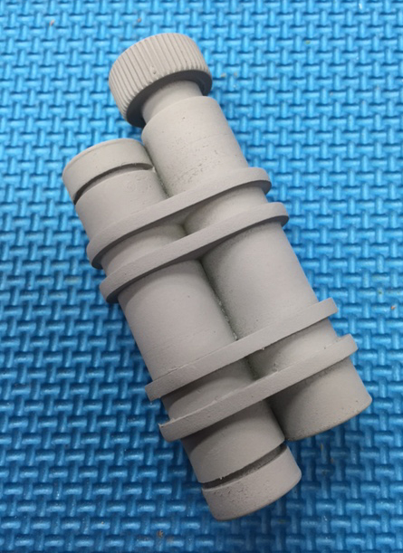

Moving on to the twin capsules on each side of the buckle. I want to cast these as a single piece so I needed a way to build the assembly that would take to casting. It looks like the two capsules are meant to be bound by four thin metal bands. This would create a challenging cast. So I decided to build the whole thing another way. I'll be layering a number of nylon spacers I found at Ace. Instead of thin bands, I made an oblong spacer with two holes that, then everything is stacked together, will look like the capsule system on the belt, but made an strong, simple cast for the belt. I need to tweak the length of some of the spacers to get closer to the look from the game. But I'm pleased with this solution.
Crappy pictures. Sorry. I'll post better ones once this is all glued up.

Finished the twin capsule assembly. Again, I'm thinking ahead about making mold making a simple process so I'm trying to eliminate cracks and voids that won't mold well.
With that I have all the masters done for the various components to make a full belt. I do still need to source some black leather for the flaps. Or maybe pleather. The web belt material and functional buckle is on its way. As is more Oomoo silicon. Stay tuned.

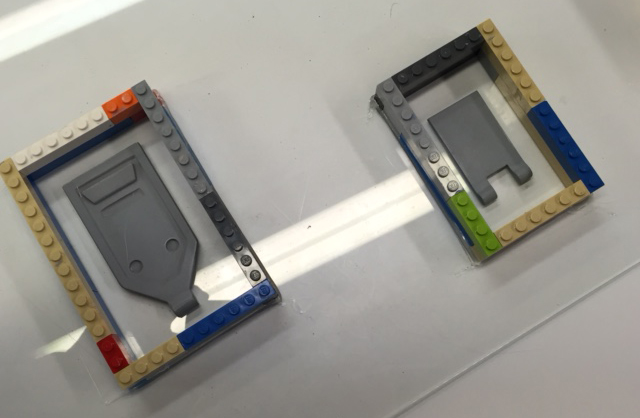

Poured the molds today. This is actually my first two-part mold, so that was cool to get some experience with. I love the sight of happy little molds drying.
