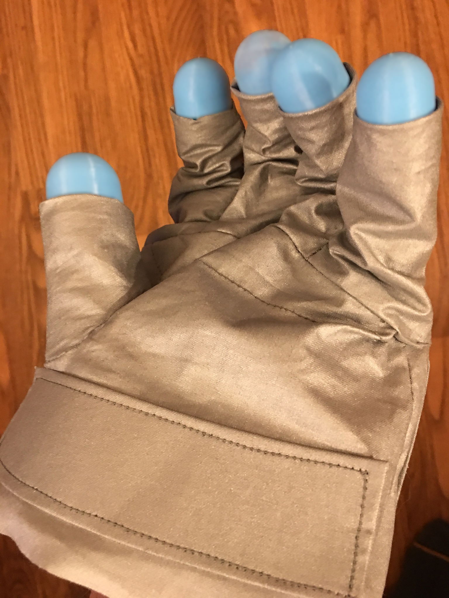

Whipped the edges of the mission patch.
Then I sewed it to the outer cuff before sewing the inner and outer together.
Double stitched the glove to the cuff.
Now to smooth and paint the finger tips!
Not sure this ones a keeper but I sure learned a lot and I can’t wait to do it again!

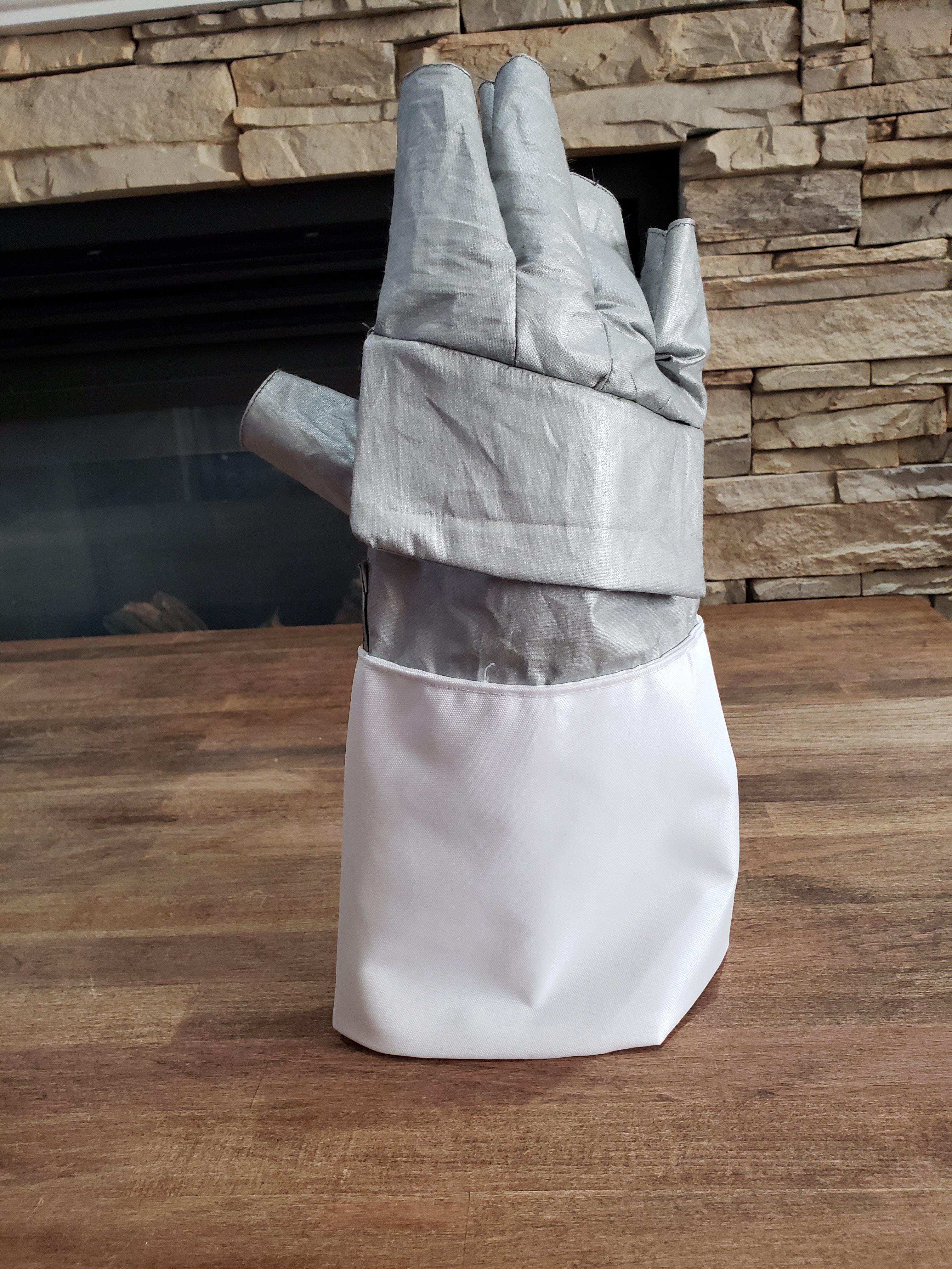

Wonderful work on the glove!!! Looks spot on. What material did you use for the white part (not the one with the writing on it) of the glove? The material looks so much better then what I have.

It’s a white denim type of material. Will probably order what was recommended earlier in the thread for next time but I really wanted to get started and that’s what they had. It’s not terrible, just doesn’t have that slight sheen.

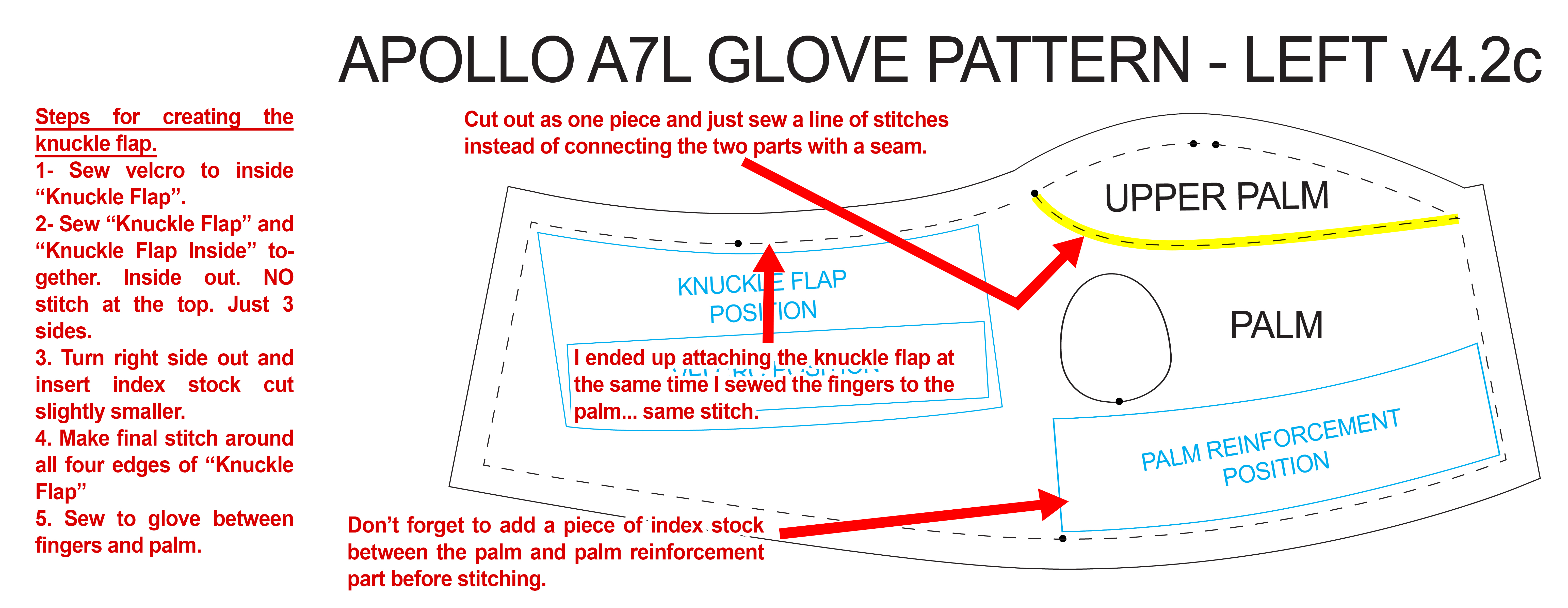

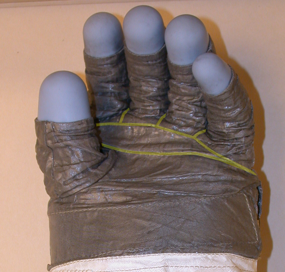

Revised the glove pattern again after finding even better reference how the seams look on the palm. Posted to first page 1-24-20.

Thanks for v.4 of the glove pattern! Having it printed up then I'll be cracking on with my gloves later this week/early next week.

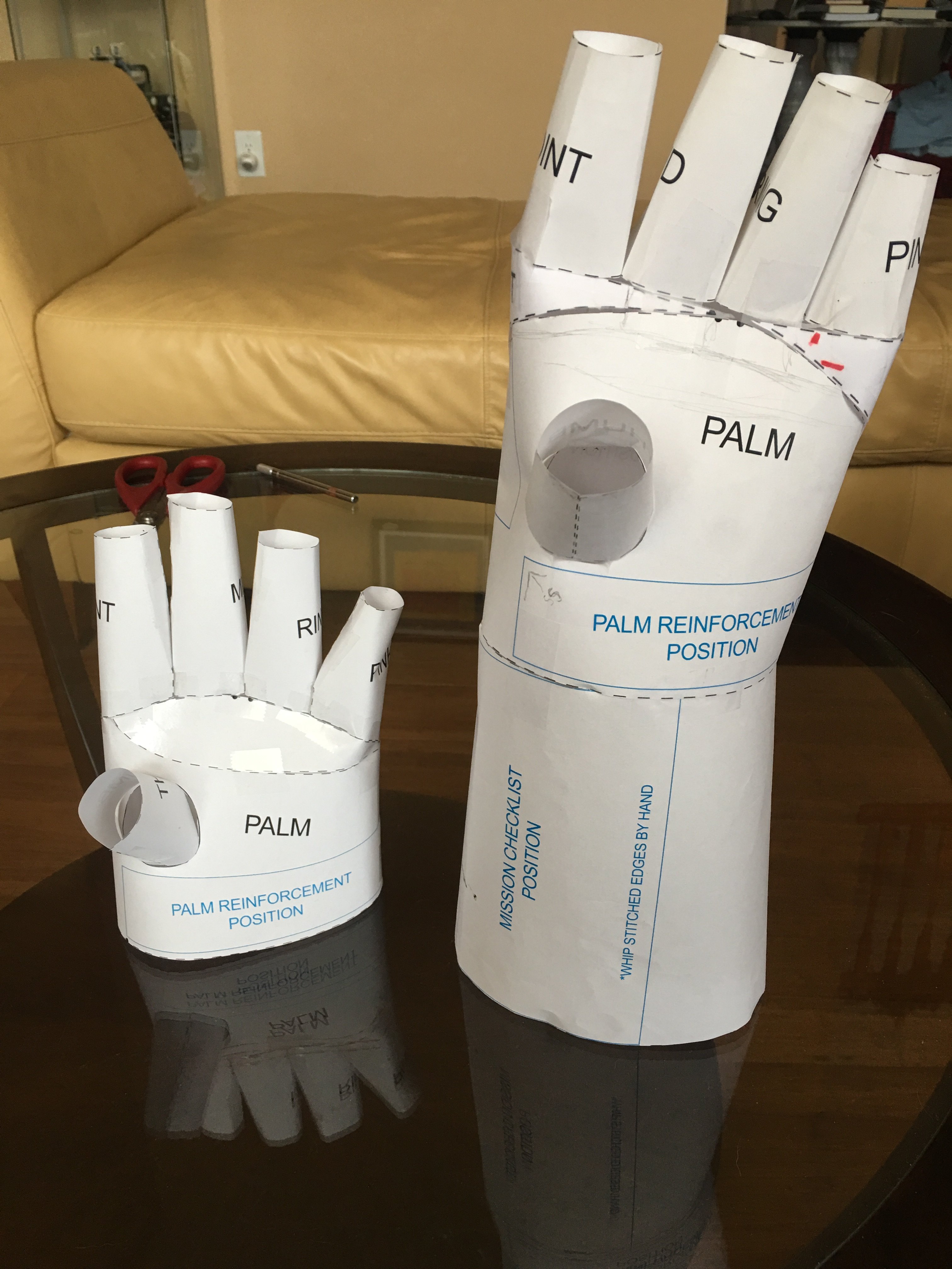

Before you print make sure to always check the latest pattern file. I have been trying to get it as perfect as I can. Here are some photos of the second try. This one went together WAY better and easier too. I tried the suggestion of heating the fabric to get more wrinkles and it worked pretty well. I did it after these photos though. I still need to do the cuff, but the hard part is over. Now on to the right side!

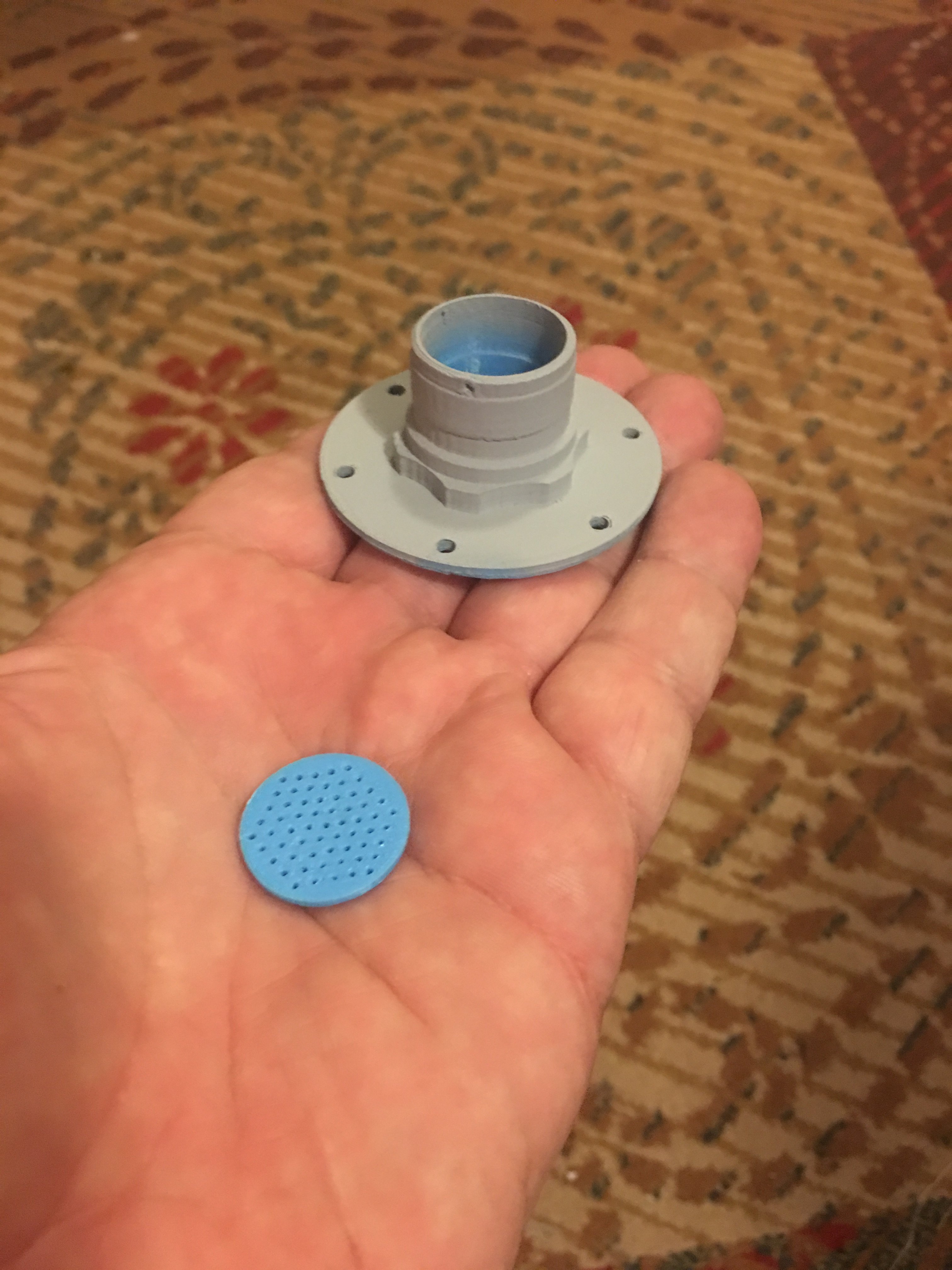

I'm also working on an insert for the electrical connectors. Using my resin printer, I was able to create a plug that fits in nicely and will have 1.0mm brass wire inserted in some of the holes to more closely match the real deal.
Perhaps my stl was mislabeled and it's actually another connector then?
Using this collection: NASA Space Suit Connection Cluster by PublicUniverse
I just looked at those. Those models are not particularly accurate.
Here is a photo of an actual Airlock Apollo electrical connector. On the left is the part mounted to the suit (Less the base disc) It's .907" tall and 1.067" in diameter.
I was going from memory in my earlier post, but you can now clearly see the circumferential groove , which is flat bottomed and centered on the fitting.
