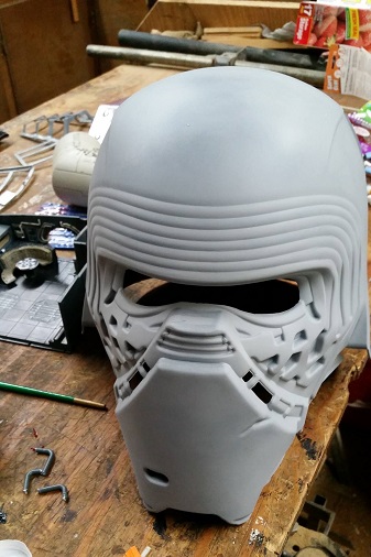

I just took the velcro pieces off of the Kylo Ren helmet. Without them, the two sides fit together pretty well. I'll probably just glue them together and sand the seams down a bit and not bother with filling in with bondo, since it'll be under a hood.
Edit- Here it is with the velcro removed, two parts glued together and primed for sanding.

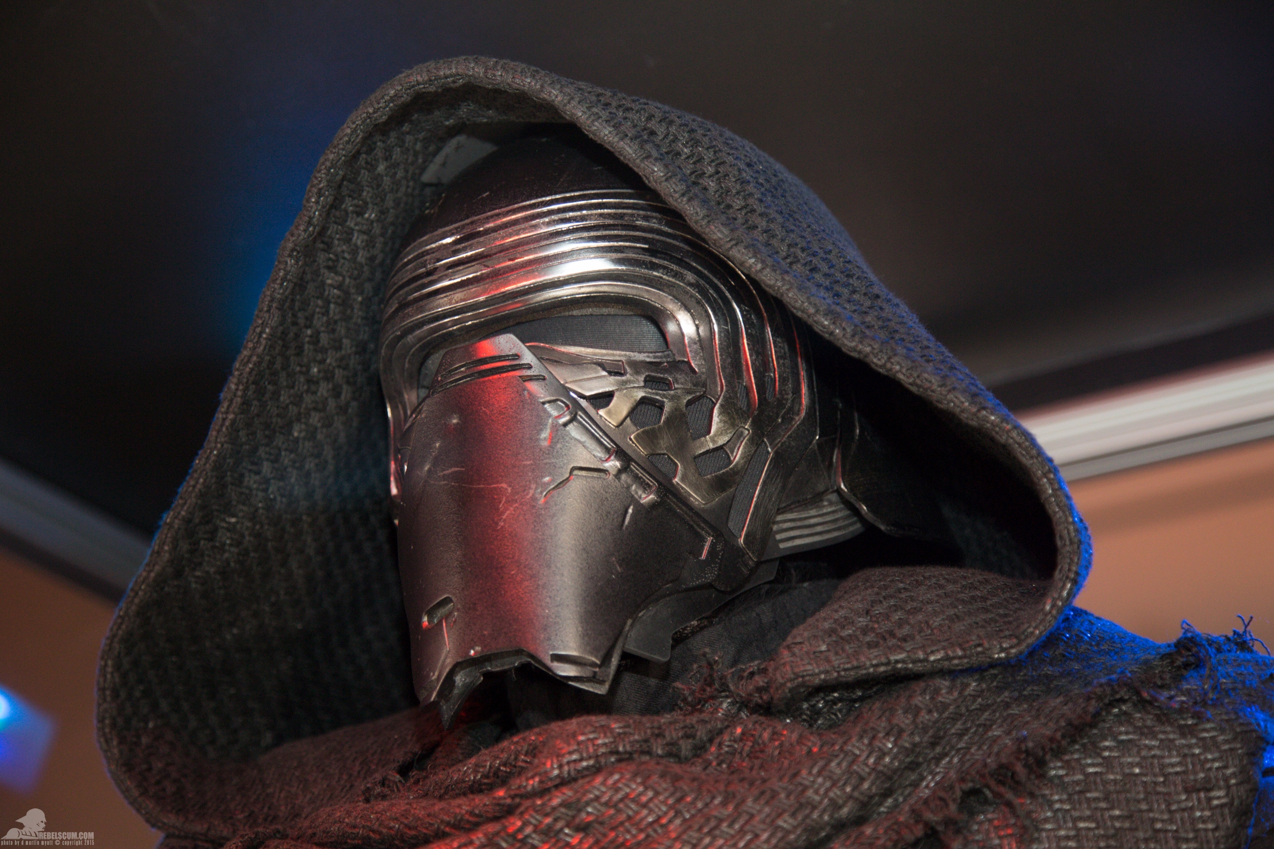

I got a PM from another member who didn't quite understand what I meant about the mouth guard paint, so I just wanted to clarify.
The area over the mouth has a metallic base tone, and the black is misted/spattered on over it. If you look closely you can see many black specks making up the darkness, and the scratches and weathering goes right to the metallic base. It is not chrome on the faceplate, and it also is not solid black. (I also believe that goes for the rest of the helmet, but there just isn't enough reference to know for sure.)
