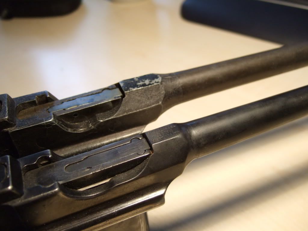

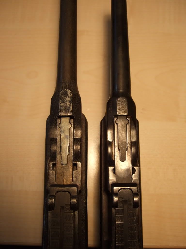

Here´s a comparsion between the MGC and a real C96 to visualize kpax´measurement differences between the two:
Markus
Re: ANH Hero DL-44 Discussion
Pat, we need to reconsider the barrel length.
As the frontpart of the original receiver is shorter, more so when turned down, this difference should be keept in mind when working on the barrel.
Turning down the receiver more and use the original barrel-length - or cheat and turn less and shorten the barrel accordingly.
I think thats right
If you want to keep the proportions of the HERO the length front to back of the top of the receiver is about is about .400 or 10.25mm and the width about .354 or 9mm (on mine I cheated and left it a bit wider than the real .2975 of Dcarty since the Denix is overall just a little bigger. The MGC seems even bigger so you should adjust accordingly.
The important thing I think is to keep the proportions. Most people don't cut back the receiver enough. I like to do a visual comparison between one part and another to check the numbers. Because of the variation between the REAL guns and props and our replica castings, MGC or Denix, we have to adjust the real numbers to "fit" our models.
