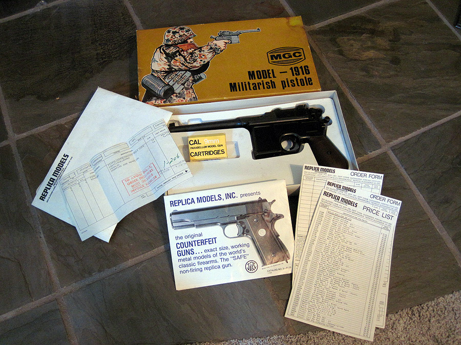

Due to its completeness, it will be tough to deface it. But this is what I got it for. You think the order forms are still good? :lol I'll probably have my modded denix in the JY soon. :)
Re: ANH Hero DL-44 Discussion
Nice find, Clutch! :thumbsup
Very fine condition too, cool that it even has the import slips with it. Now you own the "Safe" non-firing replica gun..;)

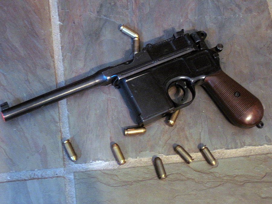

Just scored an MGC as well! Should be to me shortly. Now, it has the 9mm grips which I need to replace. Am I correct in thinking the MGC grip frame is still oversized vs. a real mauser? So, to make my real mauser grips fit, I'll have to remove metal like I did for the Denix?
