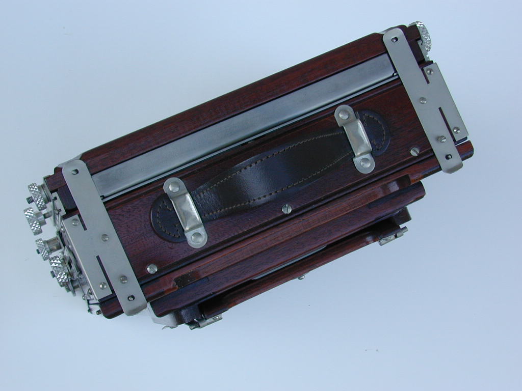

Similar stepped knurled knobs were used on some cameras. You can see some here even have the recessed center.

Re: ANH Hero DL-44 Discussion
nice find. beautiful camera.
