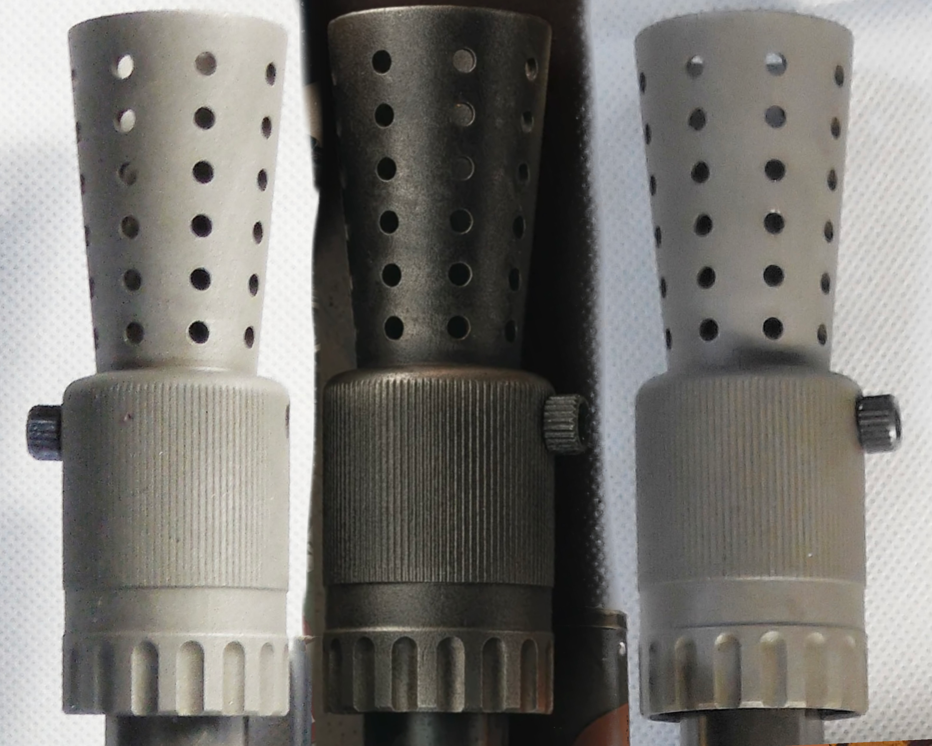

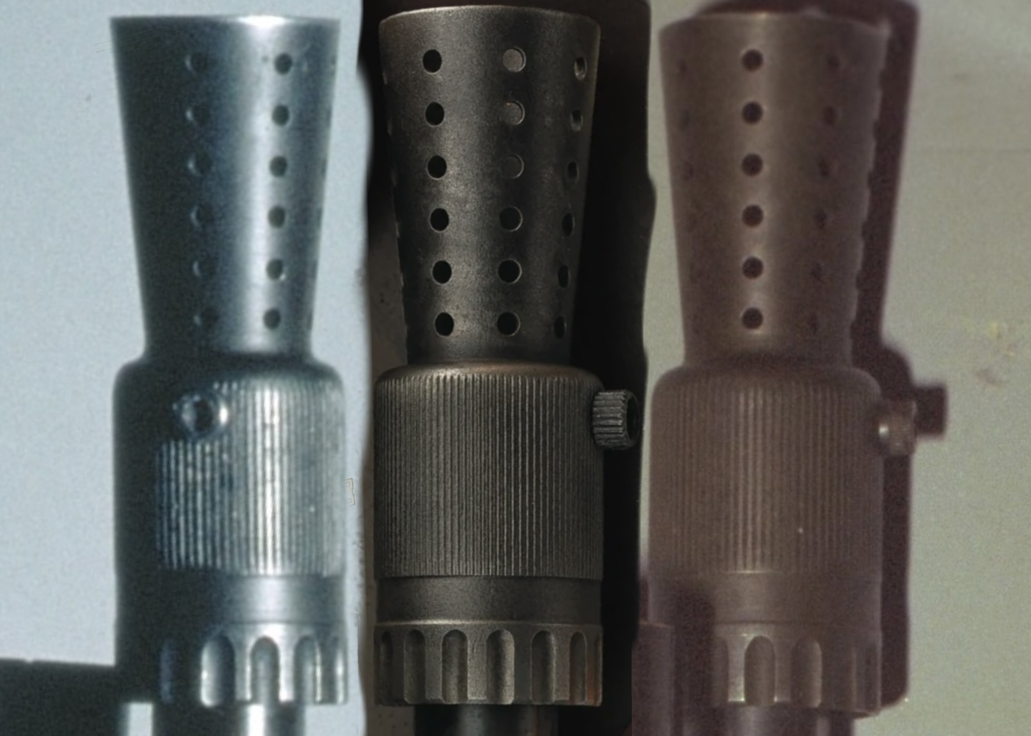

The scallops around the base of the FH look different at first glance. I think the last one was bead blasted.. there’s no way back from that to smooth it out right?
That flash hider isn’t the same as the one on the hero. At least not in the same way as it appeared in the film, right after or before..
Sorry! My bad. Ya it’s the same. They are just getting wise and trying to doctor it up more. Looks that way anyways.. View attachment 1597070
oh wow... thank you man, yes those are identical. I still see texture, I wonder if they just blued it. The rumor was that this was the last MG81 flash hider they had at bapty and used it for the re-build, the conservator in me is really sad it was stripped so roughly
Actually the thumbscrew has been replaced, now that I look closer. There is some discoloration that doesn’t match either
