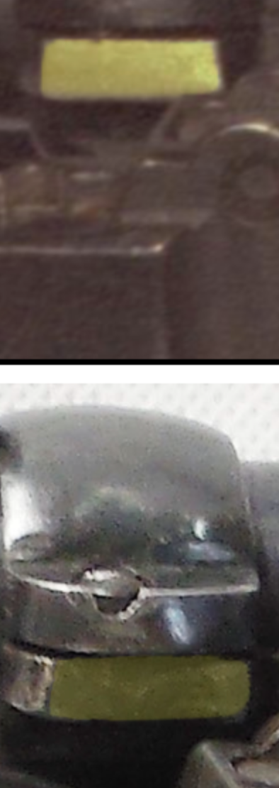

When parts are machined in a similar way they will have similar- but not identical machine or tool marks.
The small similar markings aside, there are many problems with the lower cradle being original.

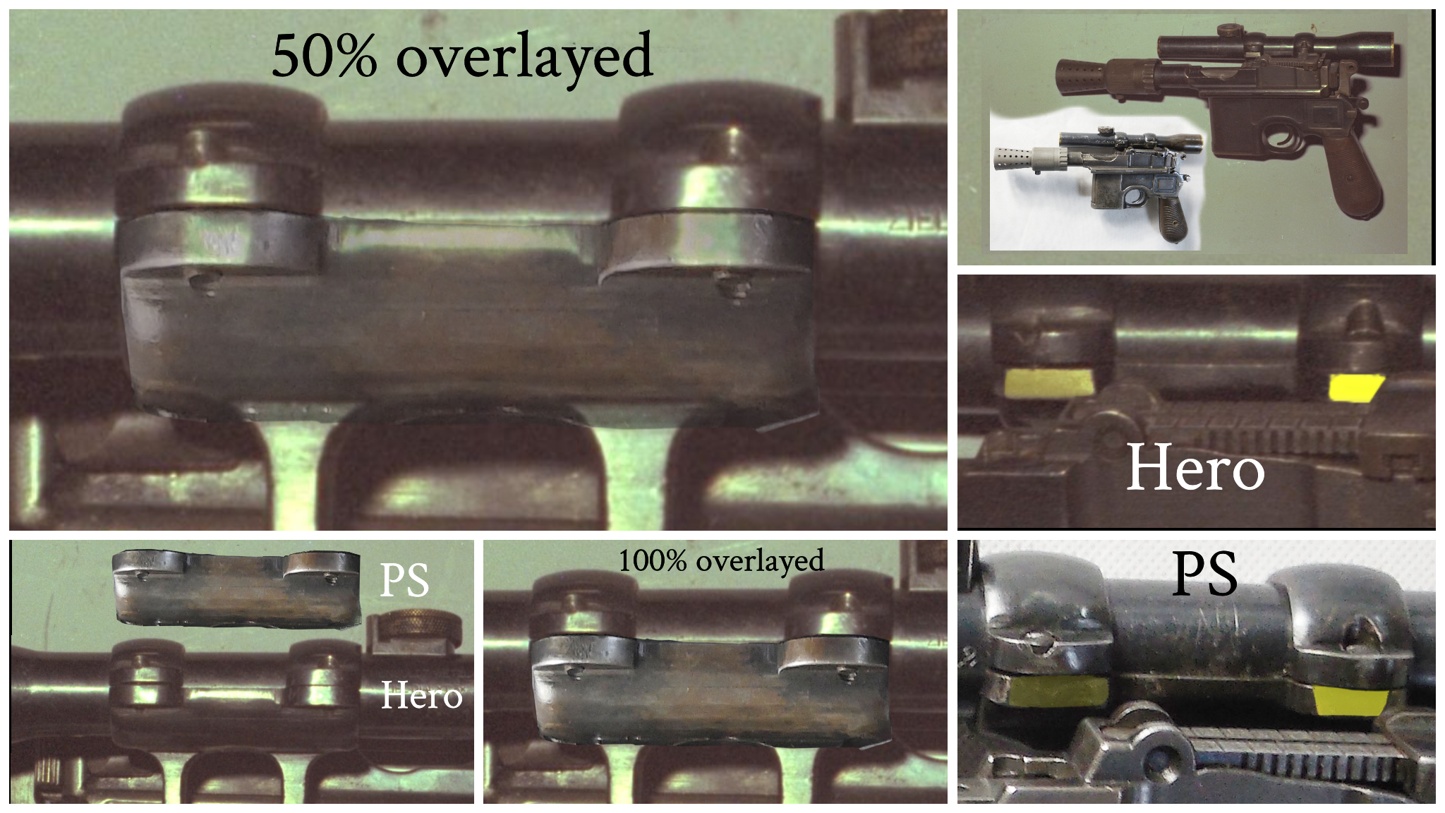

Note the comparison below. I took the best PS images and made a composite of the mount in ideal plan side view. I corrected for distortion and camera angle best I could. This is just to get a rough idea as to size and shape.
The full side images of the PS are off center and hard to relate but there was one image of the mount that was almost ideal side view. I used it to locate the left side and bottom positions and size based on the screw positions and center thumbnut roundness.
I then scaled it to the screw positions on the HERO and the upper ring size and locations.
Even accounting for minor discrepancies in imaging, the PS mount is much different in shape and size than the HERO.
Anyone feel free to repeat the comparisons. Maybe you will get a different result.

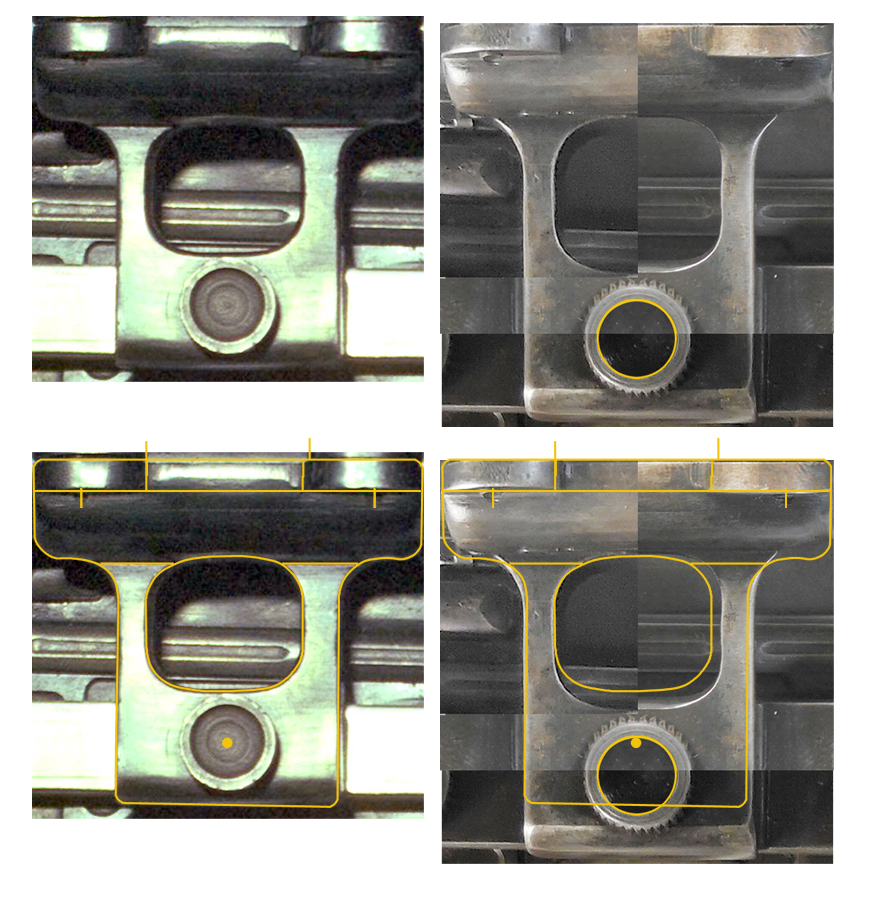

Here’s an overlay (pic/video) of the PS cradle to the HERO’s..
But why does the back cuts (marked in yellow) not line up at all. That seems strange that at anytime they would I have cut those any different especially if preservation was so important.
Perhaps these different cuts here or any other small discrepancies we're seeing are just places where the upper half of the mount was cleaned up. If it was at the bottom of a box of steel parts for 30-40 years I imagine any of these surfaces could have been rusted/pitted, badly marred, etc.
