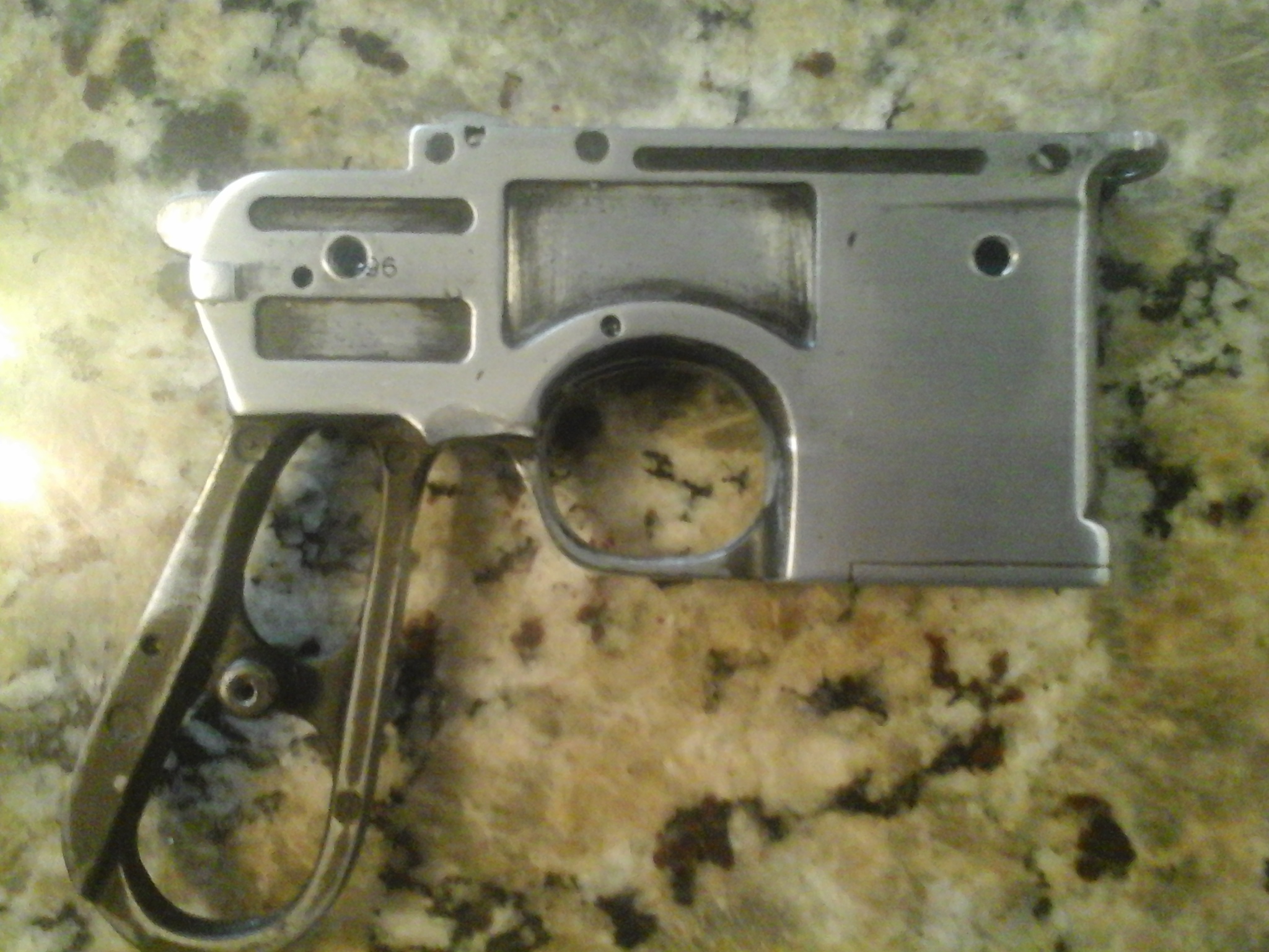

They're definitely right about that... when it comes to mounting the ANH setup on a Denix, you've got to kinda eyeball it a little, as it will never be perfect, that's just the way they are. If it helps at all, here's a pic of my old Denix lower that I drilled and tapped that looked about right to me:

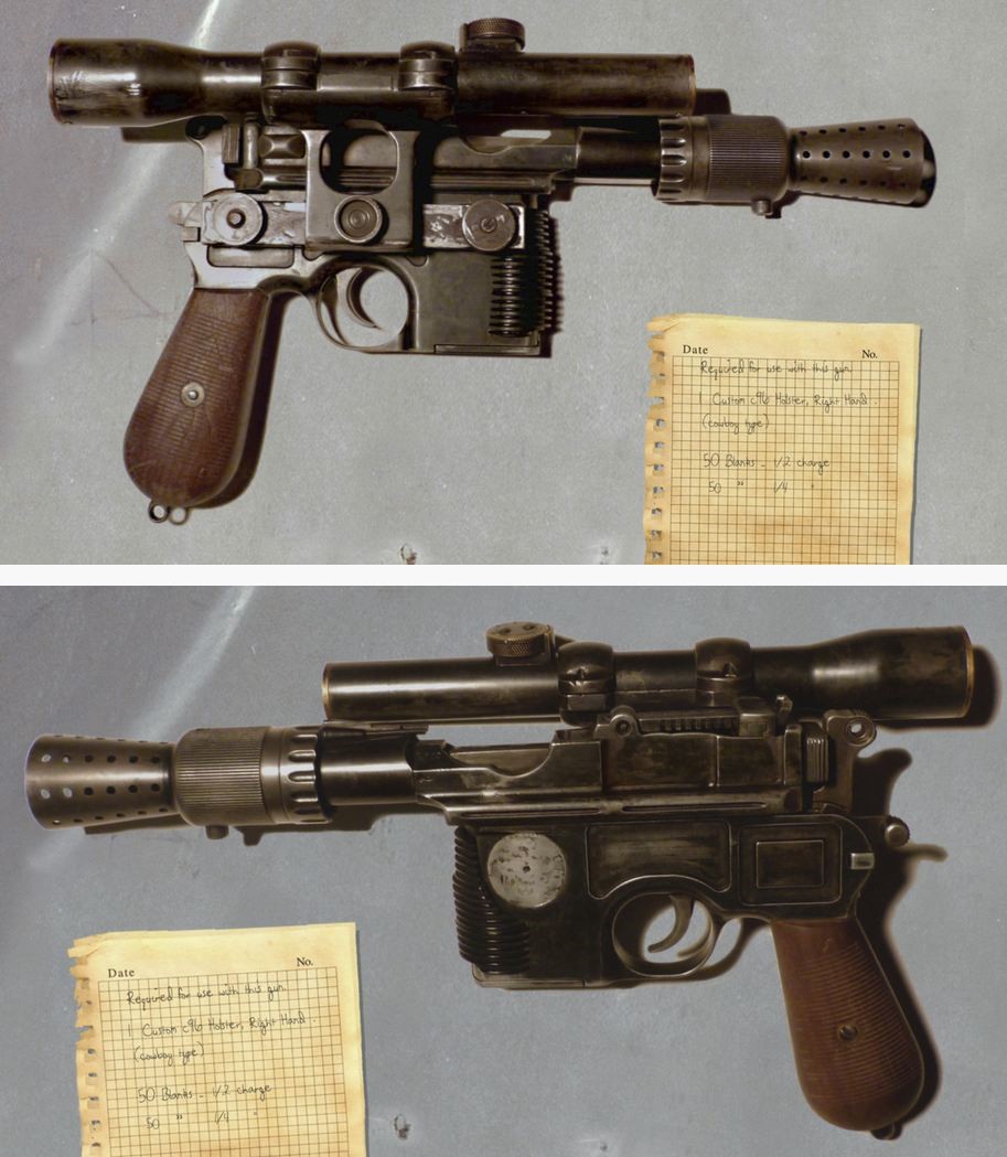

...I think it's interesting that only a few people (who contacted me privately) noticed the biggest "tell" which was the "straight" FH. :)
I thought that would give it away for sure. I decided to leave mine straight and not even take the "trick" images with the bent FH so there would be no real confusion.
Not sure how the real one was attached. If they simply used the bottom screw to attach, which could cause the upward bend, I would not have wanted to be in front of that thing. The FH could have flown off any number of times...

My personal favorites of Kpax's pics were these two:

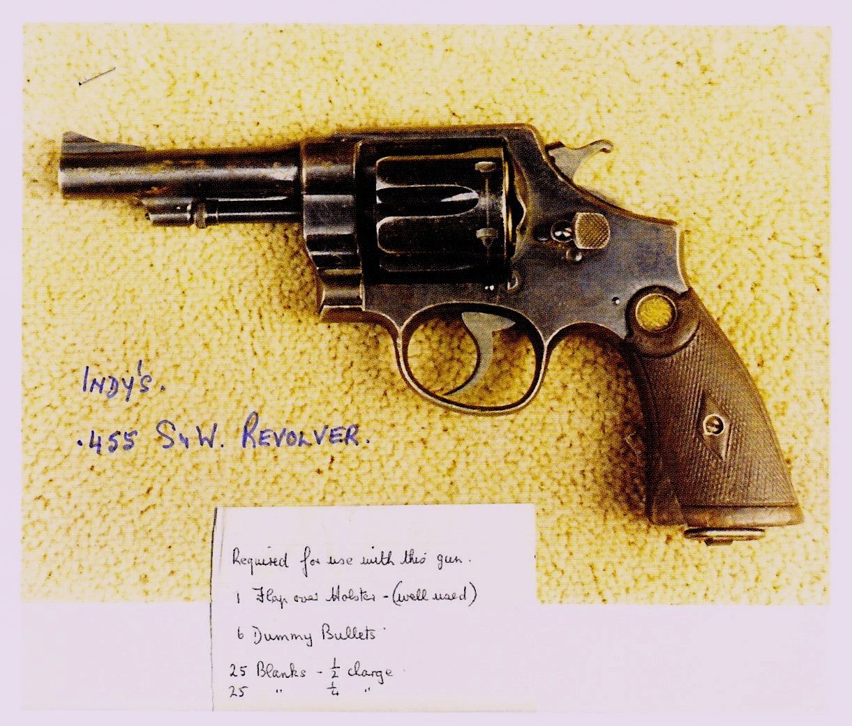

They look legitimately vintage and the details in the handwritten note are great. It's an especially clever ruse when you consider this Bapty pic from Raiders:
But there's another clue here to this being Pat's build, aside from the straight FH. The crossbar is beat up like it is in the Chronicles photo, which was taken late in production, IIRC. A pic with the ammo info would be a reference taken at the beginning of production, which means the crossbar would be relatively clean like it was in the pre-production photos. That's my theory anyway!
I love that Pat put so much time and effort into placing his build in the right environment.

That Bapty and Co. Indy pic is great.
