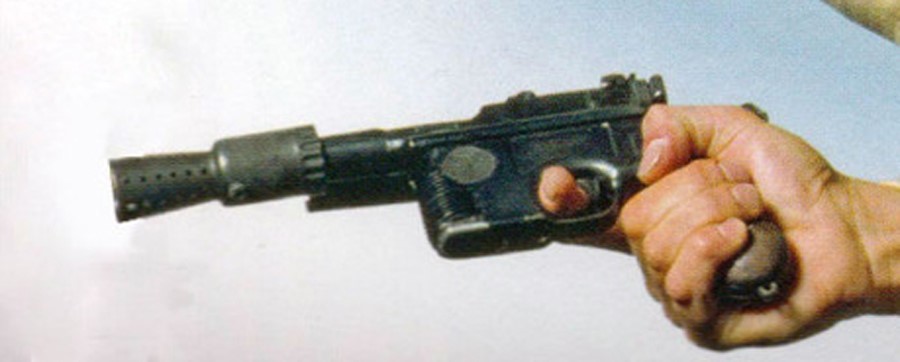

Yeah, I think you are all right - just looking at one or two of the photos, I LOOKED lightly painted, although all the rest of the photos looked certainly to be blued. And yes, Pat did indeed mod his MGC VERY well. I'm trying to duplicate his work - the first MGC I have I overdid a touch, so I'm going slower on my second, to make sure I don't screw up.
I'm torn between admitting that move by Pat was either very masterful or very mean... maybe a little of both? :behave
It's funny. There was a time in this very thread when painted was the general consensus. As for me, there are some chips on the surface of the blaster in the promo pics that I find difficult to reconcile as wear. Could be some deep gouges, but I go towards painted. I could be wrong, but it is tough to tell for sure.

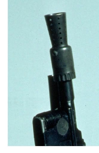

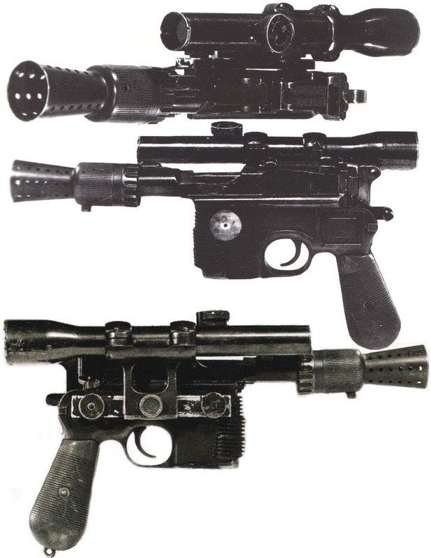

As for Halloween Fools Day, I noticed the bullets in the flashhider too. And, the aft edges of the knurls on the flashhider aren't worn as bad as the hero either. Funny even the dust in the background matches, and the white wedge shaped support looks exactly the same. Must be photoshopped into the original pic? Excellent work though!!
blasterallsidescopy_zps06fb202c.jpgtumblr_lsiep7k1uA1qmnqf0o1_1280a_zps2b0aac11.jpgtumblr_lsiep7k1uA1qmnqf0o1_1280_zpsb047ff62.jpg
Now that the secrets out, extremely nice work on that blaster, Pat! She's a beauty. That's certainly one for the record books, all the work you've put into finishing it really shows.

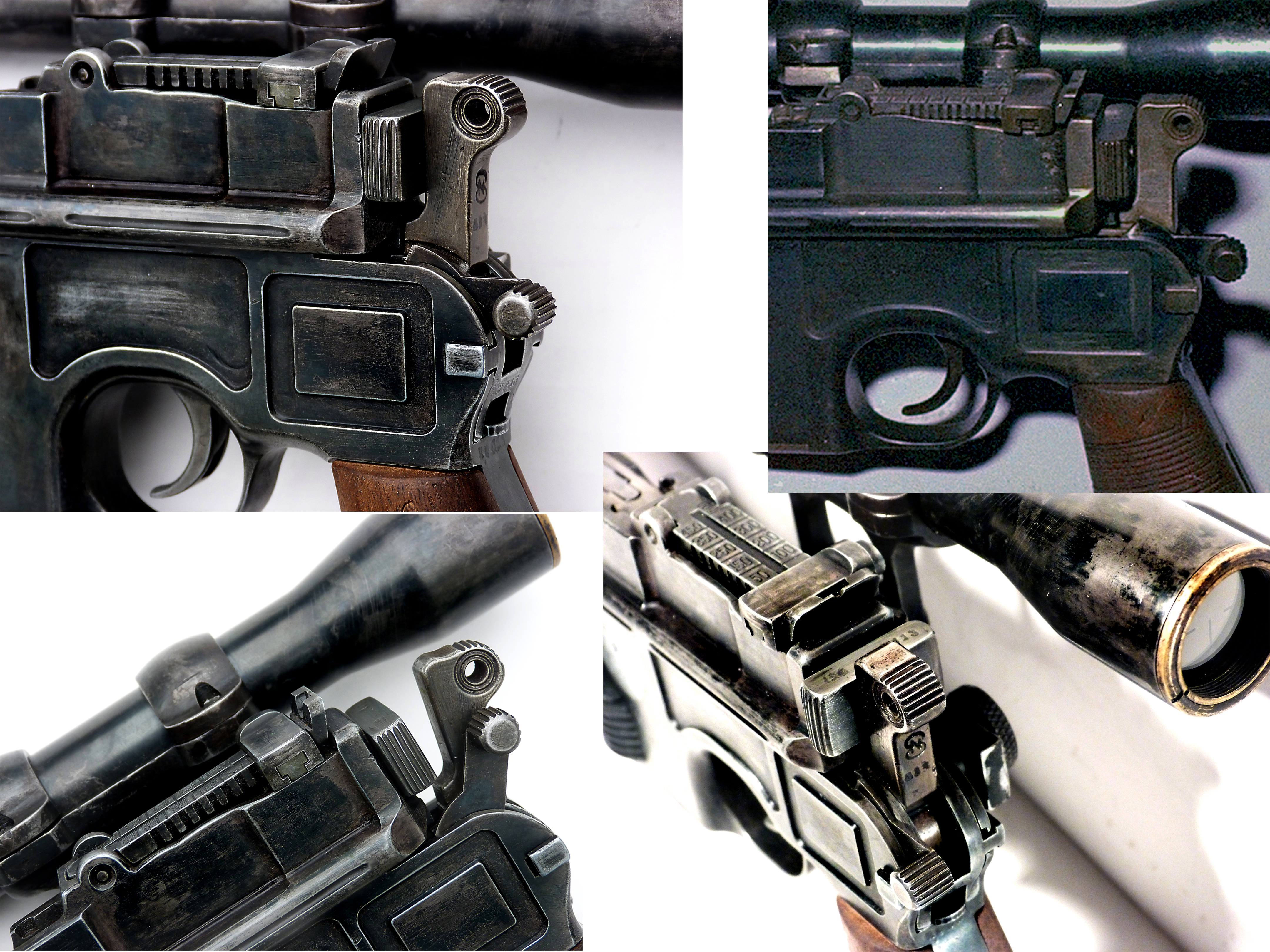

As for the paint, two of the page-5 photos posted by dcarty and lonepigeon seem to strongly suggest painted surfaces in some areas. Notice the chipping and such, the unpainted bull-barrel, and also the texture difference/lack of reflection from the surface of the Mauser when compared to the two color pre-pro photos:
ANHHerostill3.jpg~original
Also note the color/contrast differences between the grill and the paint, possibly suggesting that the grill was put on after and is unpainted. The visible glue under the grill seems to suggest that as well.

Here's how to tell: the biggest sign is the holes behind the ejection port scallops - the shaping of them isn't like a real Mauser's, but a heavily modded MGC.
Hmm.. While there are minute differences between different real Mausers, you could be right.
MGCs usually have a thicker wall between the sight rail and ejection port than on most Mausers, but on some Mausers that wall is thicker.
The sight rail looks like a modified MGC sight rail.
...so it's not the real one?

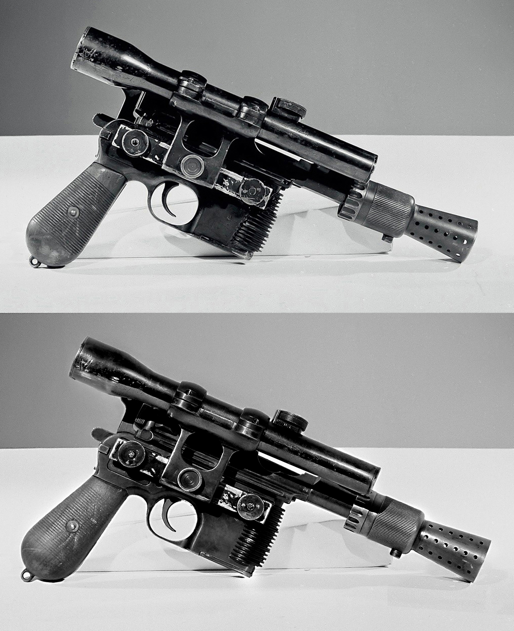

As some know or guessed, this is a heavily modified MGC. I used the MGC so my Nephew could handle it and so there are no Imperial entanglements. ( meaning the govment) I included every mark, scratch and ding , seen or unseen and included the working NR barrel with release latch and threaded barrel for rife extension.
The backgrounds were photoshopped in. Some of the images were taken at different times. I made some more adjustments after Scott posted that amazingly clear big B&W Hero shot. I was too lazy to retake the photos after the fix.

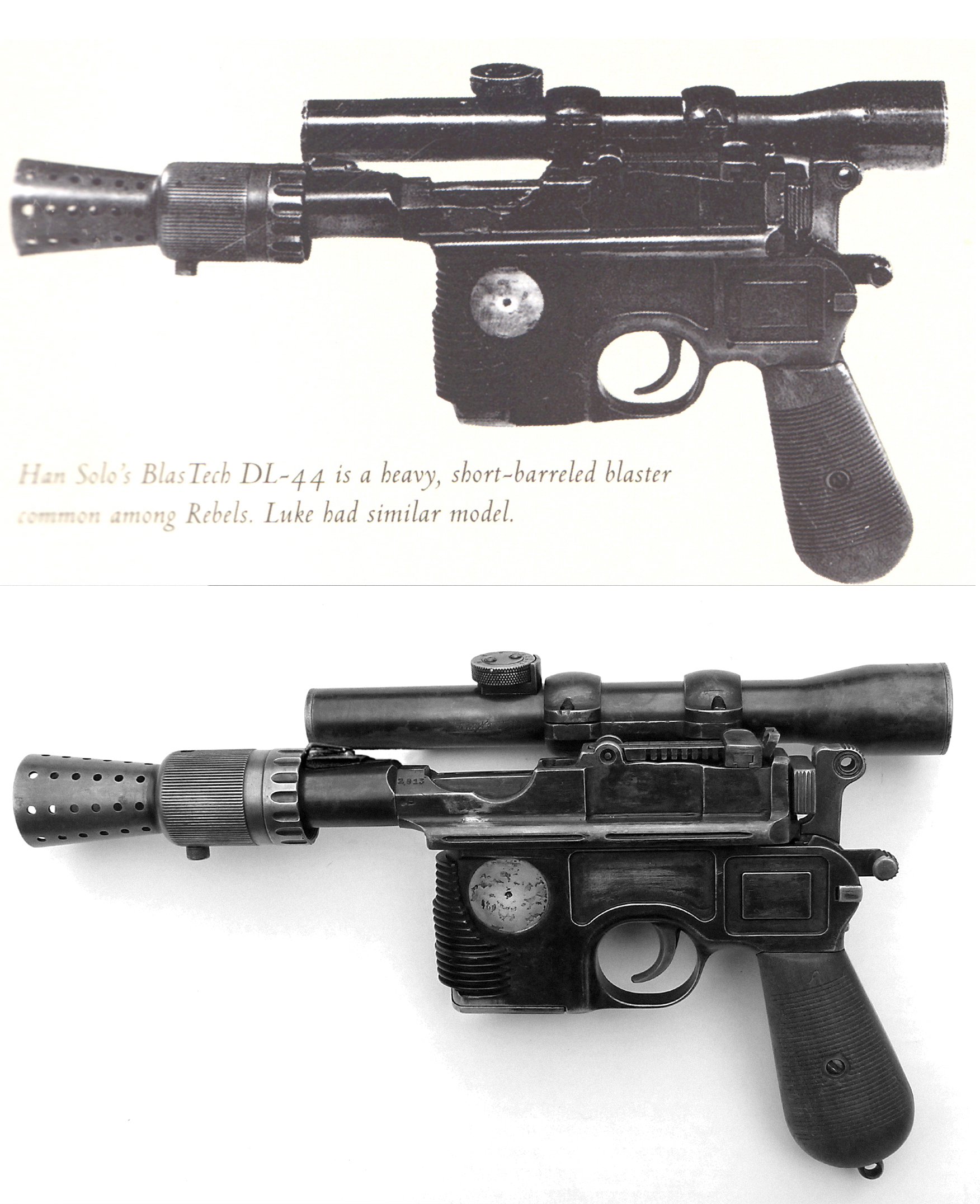

Here is a comparison of the real and replica. The lighting is not exact but you can see the details better.
I will post other images and info about how I achieved the details in case anyone is interested.
Thanks for the kind words and interest in this prop. Could not have done it without you all.
