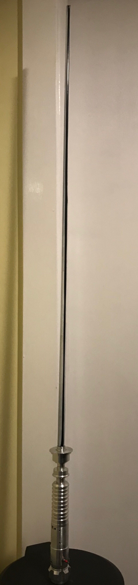

Ok gang, the v2 is fully functional. Blade spins
The battery is very weak and I don’t like charging Lipo battery’s in my parents home. I’ll wait until tomorrow and charge the battery outside (I have a hobby battery safe bag coming)
I put a 5mm strip of electrical tape down it and it does flicker alittle just with white paint and the electrical tape on it
My plan now it to add scotchlite (should be here tomorrow) and add some black pin striping, see how it works
Wicked excited

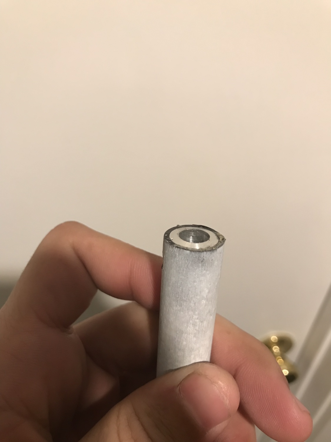

I see! It's a reducer from the golf club to the shaft
Yup. The only reason why I went this way is because of transportation
I plan on using this v2 when I do panels at comic con. I can put the saber and blade in a old rifle case for transport
If I didn’t need the blade removable, I would have threaded the steel rod with reverse thread and then made a reduced/adapter and taped it so it would screw on. I have the emitter spinning the same way in ANH and don’t want the blade coming off lol

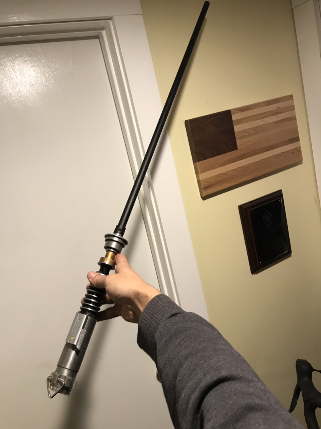

Charging the battery right now.. blade is done dying to see if this works
The RC guys told me to monitor the heat of the battery, once it’s warm it’s done.. it’s been plugged in for 15min and hasn’t change temp
I hate lipo’s lol
That last shot doesn’t look too far off. Very cool to see that reflective glowing effect. And the trick, I think, is getting the RPMs right so that you get those occasional flashes of non-reflective blade (the strobing effect) moreso at the bottom of the blade.
