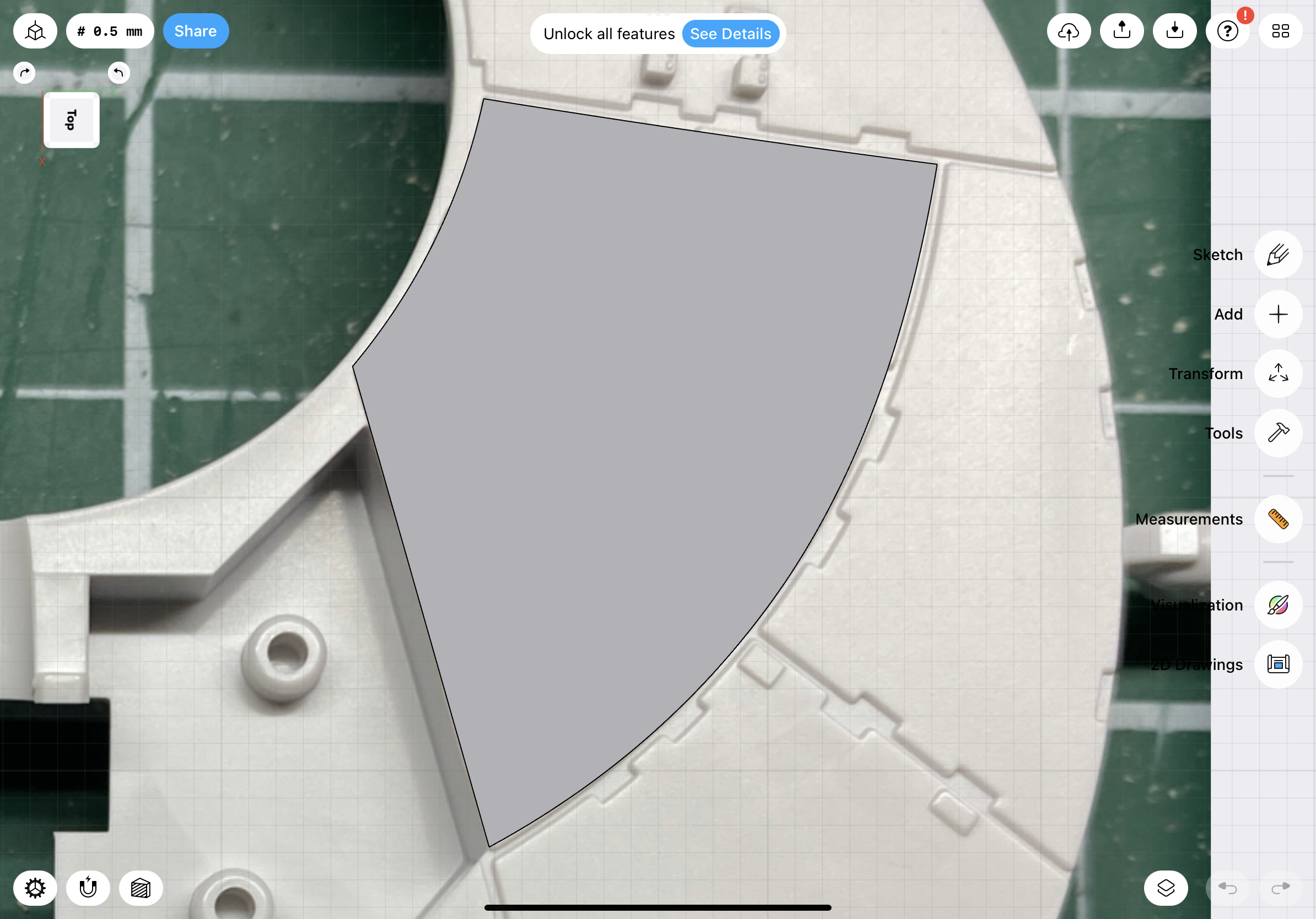

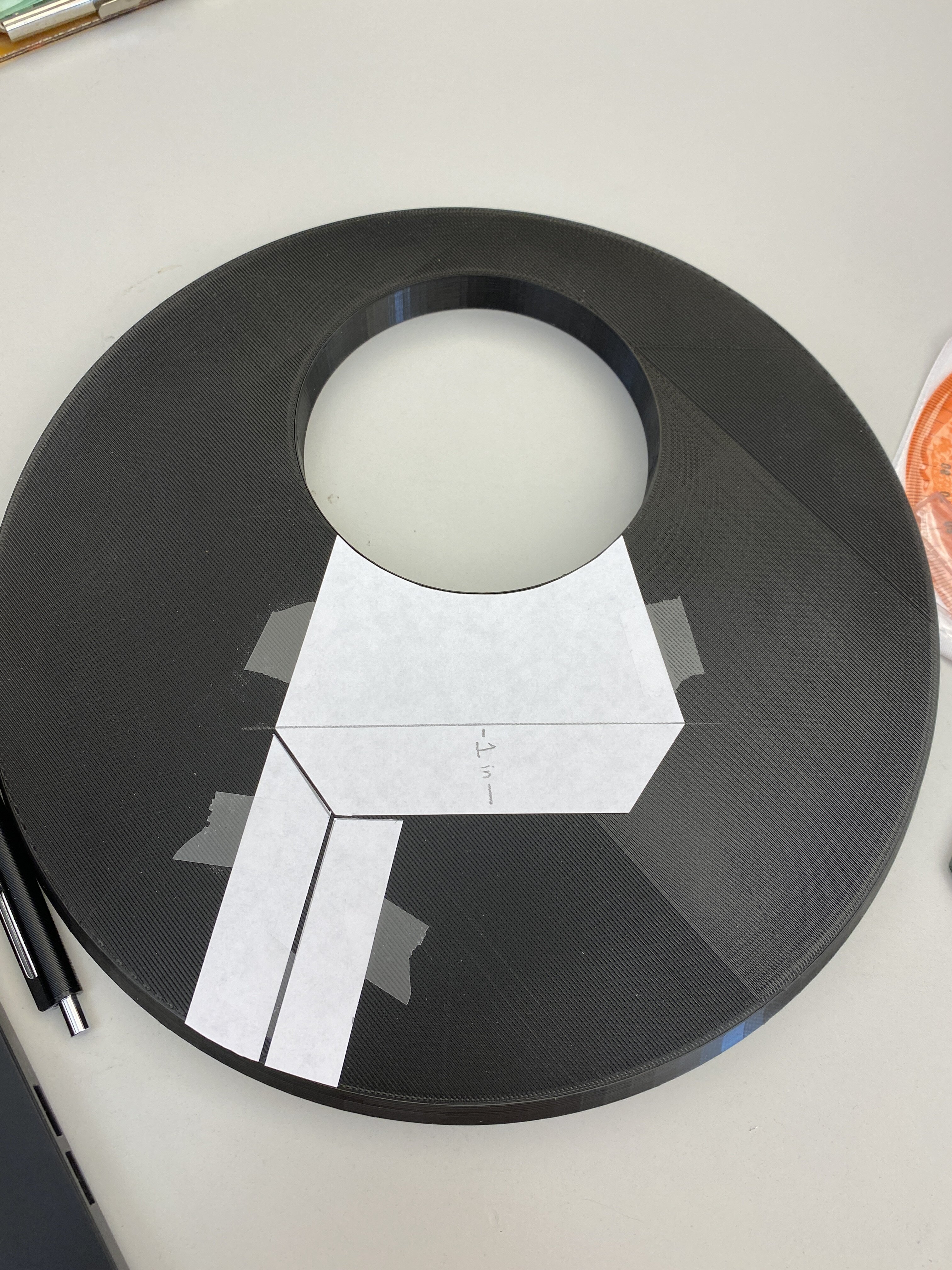

So here’s a question about hull plating. What’s your go to method for measuring and cutting curves? Let’s take this panel for example:
How do you get the perfect curve?
For pieces like this I print them out on paper first, cut them out with scissors and make sure they fit. Then I use that template to mark the real piece of plastic, cut it out with an x-acto and then sand the edges with an emery board.
Awesome. That’s what I was thinking.
In addition to what swgeek said, you may want to cut them slightly larger so that you can sand or cut the edges for a smoother curve until you get used to measuring, cutting and fitting. You can always fix a larger panel by trimming, but gluing a millimeter strip to where you trimmed too much will look terrible and will take more time to fix.
TazMan2000
Also, since there is a slight curve, it may be difficult to get a flat piece of plastic to look good when glued down. What I did when gluing plates of plastic onto a sphere was cut slices in the middle of the piece, being careful not to go end to end so that they would split. The "cuts" would open up slightly, but allow the panel to sit flat on a curved surface. Once glued, fill in the "cuts".
TazMan2000

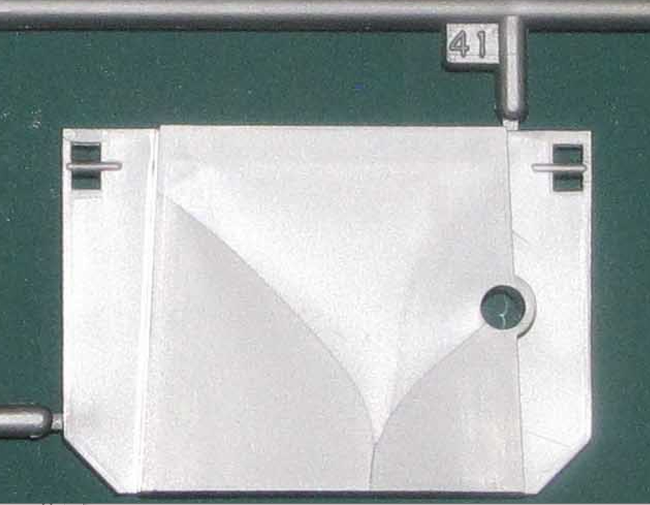

Thought I'd put my 2 cents worth here on panel cutting.
Guys, there is no issue with the styrene curved panels sitting on the hull flat!. Because they do. Even the bigger panels sit perfectly on the hull, believe me!. As they are curved, they match the long length of curvature. There's no issue to be had here ok.
As for my personal panel cutting preference, I use thin card templates on the trickier panels & transfer to the styrene sheet to cut out the panel proper.
If you make a mistake on an edge, as I have done on quite a few, then you cut off a goodly strip, say more than 10mm & butt up a new piece of styrene & sand to it is as one again & continue. It's pointless in most cases to fabricate an entirely new panel.
Thought I'd put my 2 cents worth here onanel cutting.

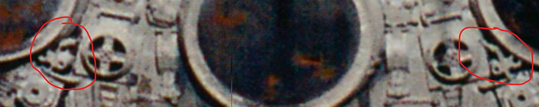

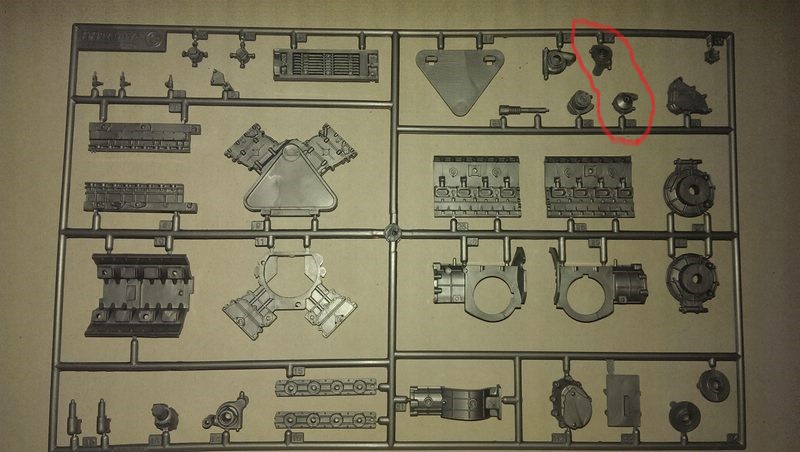

The two circled pieces have fallen off. If we can identify those, I believe the top map will be finished.
not sure about the chrome parts but the part(s) in my cropped photo is on sprue C of the 1/12 m23... edit: it does appear to be only one part.
