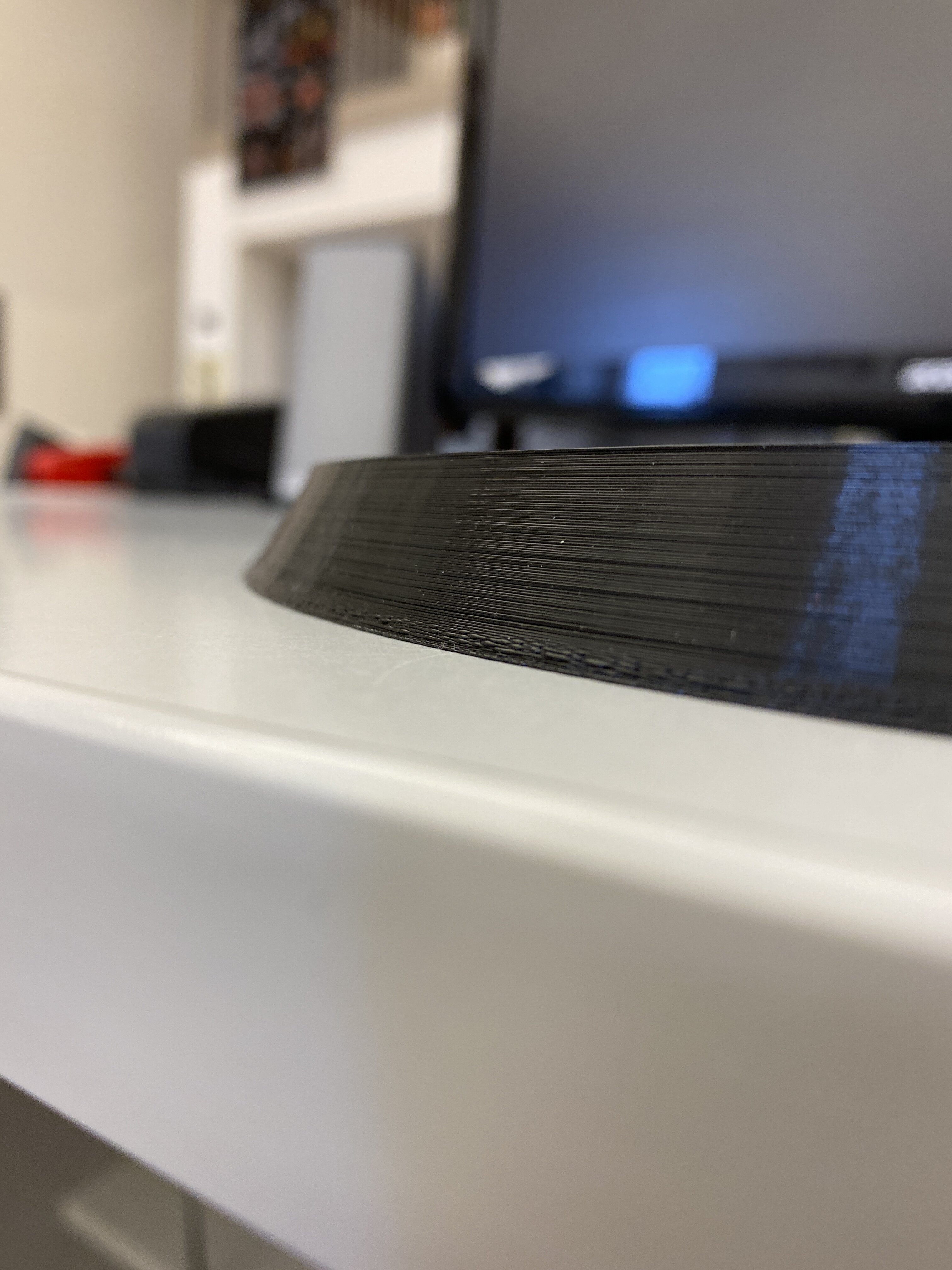

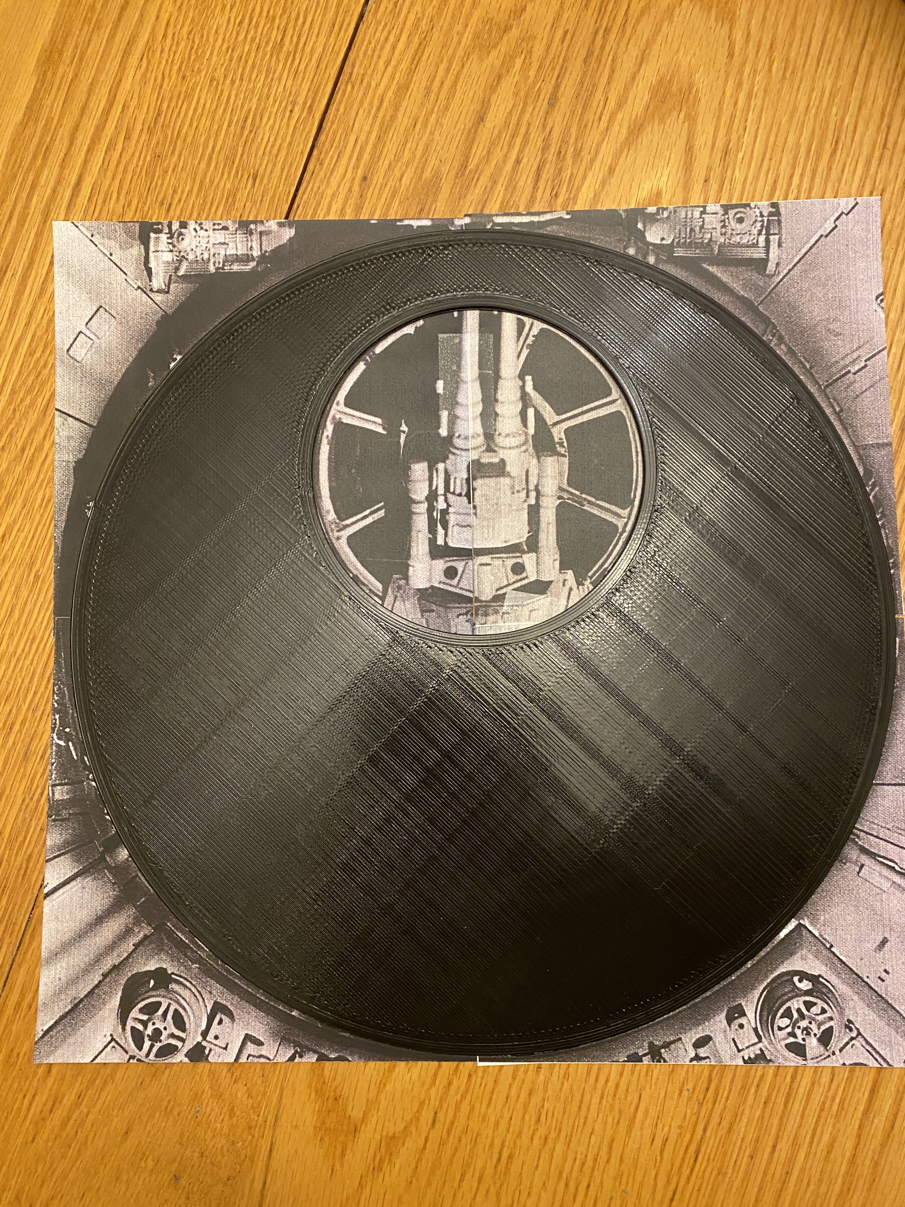

45.5” or 46” for the diameter of the hull? I’ve read both. I’m getting ready to make a paper template…if I can find paper wide enough. :)
The more I look at this I question the side angle. Is it too steep? I just used the computer to make the bottom circle then the top. I raised the top 3/4” and the computer filled in the angle. Thoughts?

To my eye it looks not steep enough. It looks like it should be more vertical. I don't mean it should be vertical, just a little less angled than what it is now. My 2 cents.
That's what I'm thinking too. I'm going to redo it in the computer. I think maybe my design was off.

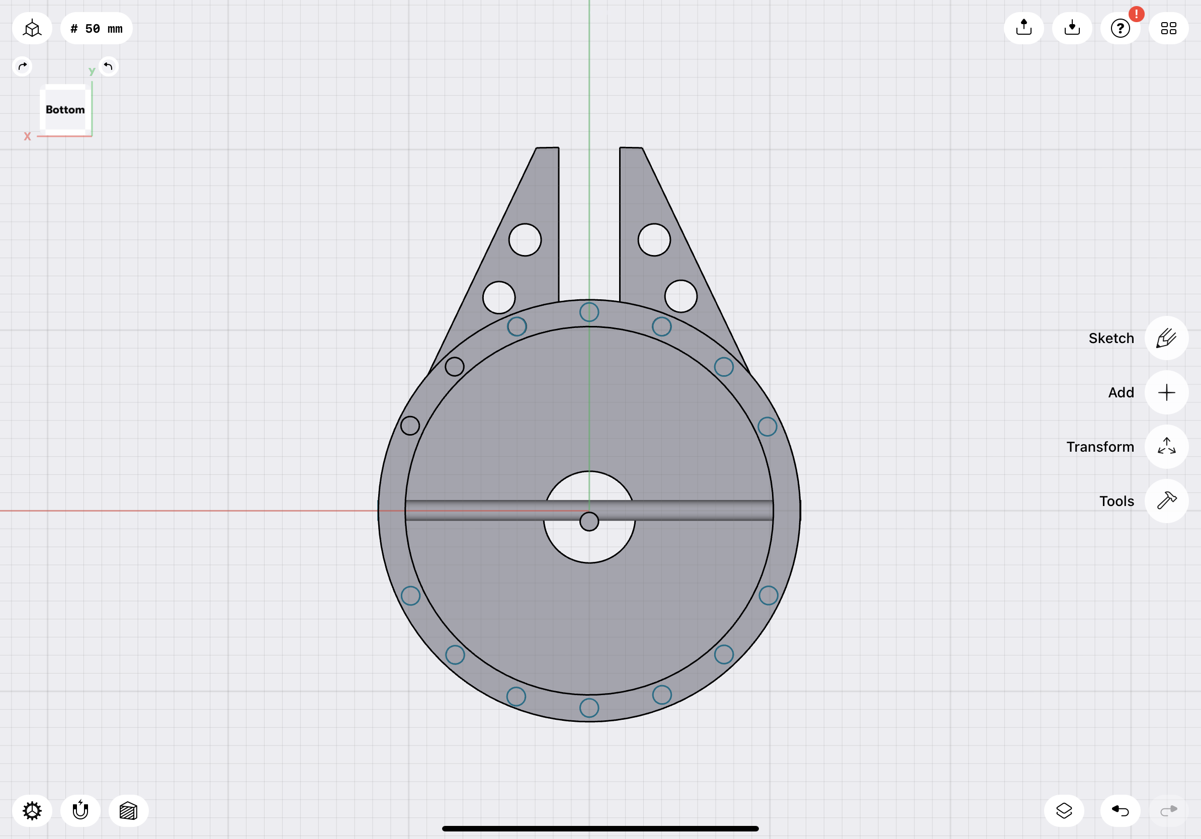

The new skills you learn when trying something like this is almost as rewarding as the end result. I’d never done any CAD before and am really getting into it. Sure they’re just basic shapes, but it’s still fun. :)

Time for a little Saturday morning math regarding the mandible pits. This is what I’m thinking:
Mandible depth is 50.8mm total
Using 3mm plates for the mandible, that would be 50.8-6 for a total depth of 44.8mm to work with
Now if I use 3mm plates for the bottom of each pit that’s another 6mm for a remaining depth of 38.8
Two mandibles stacked 38.8/2= 19.4mm or 3/4” depth for each pit
What do you think?

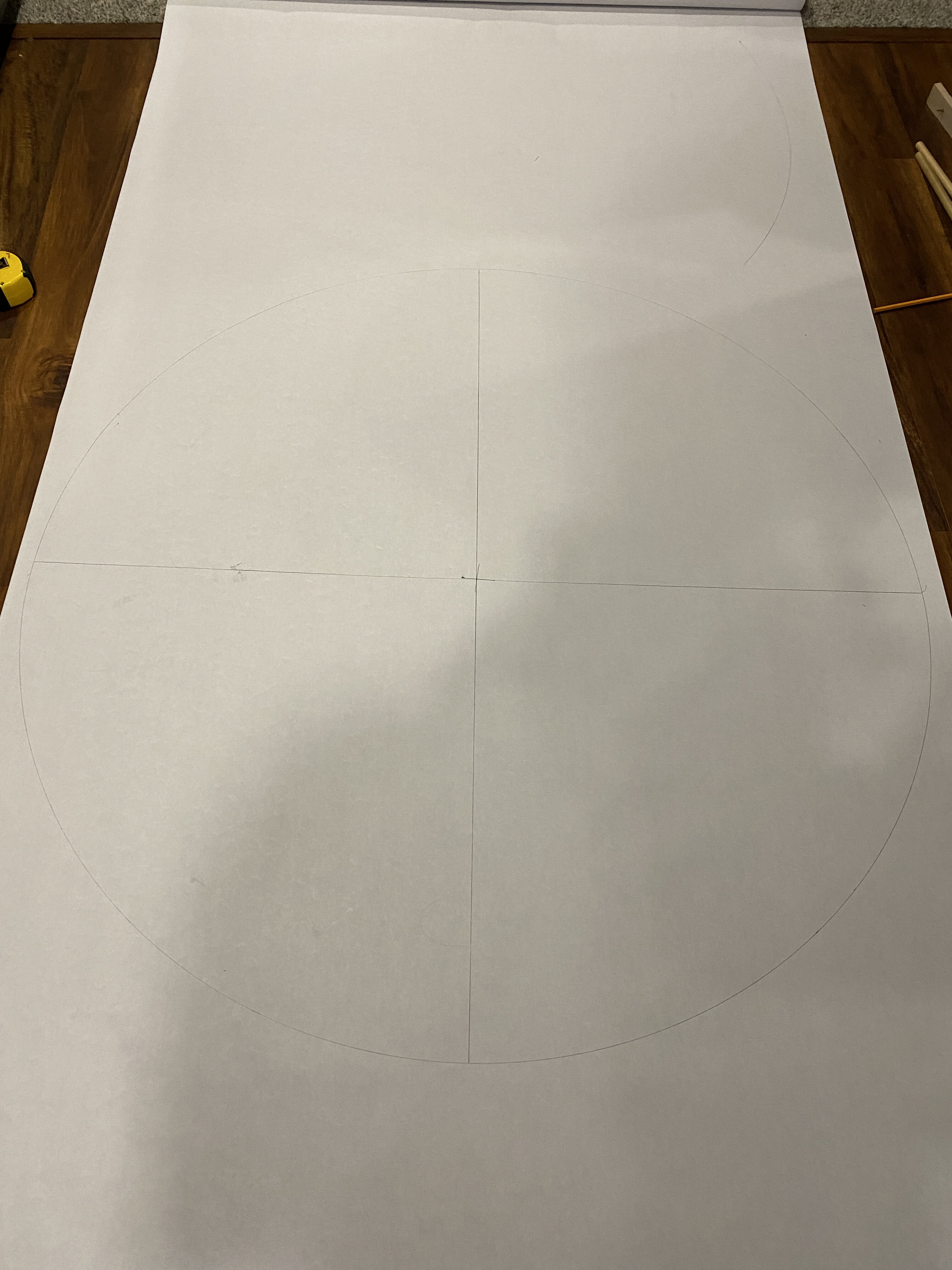

For me, the isometric on the internet (and in the old threads on this site) of the the disc, jaw box & mandible intersection was worth its weight in gold. I got lucky understanding that the hull was literally a discus and that height of the various ”walls”, less armor thickness, depended upon diameter.
Now I appreciate the kit parts tell you these thicknesses at diameter 45.5” for the cut back up front and help insure proper thickness at the 47.5 disc overlap edge:
Sheridan for the jaw box inner mouth & Pontoon Assault Bridge for “naked“ mandible thickness defines what are actually channel thicknesses at diameter 45.5” & 47.5.
Good luck with your measurement decisions as you choose materials, determine construction for the build and factor in skin & armor thickness.

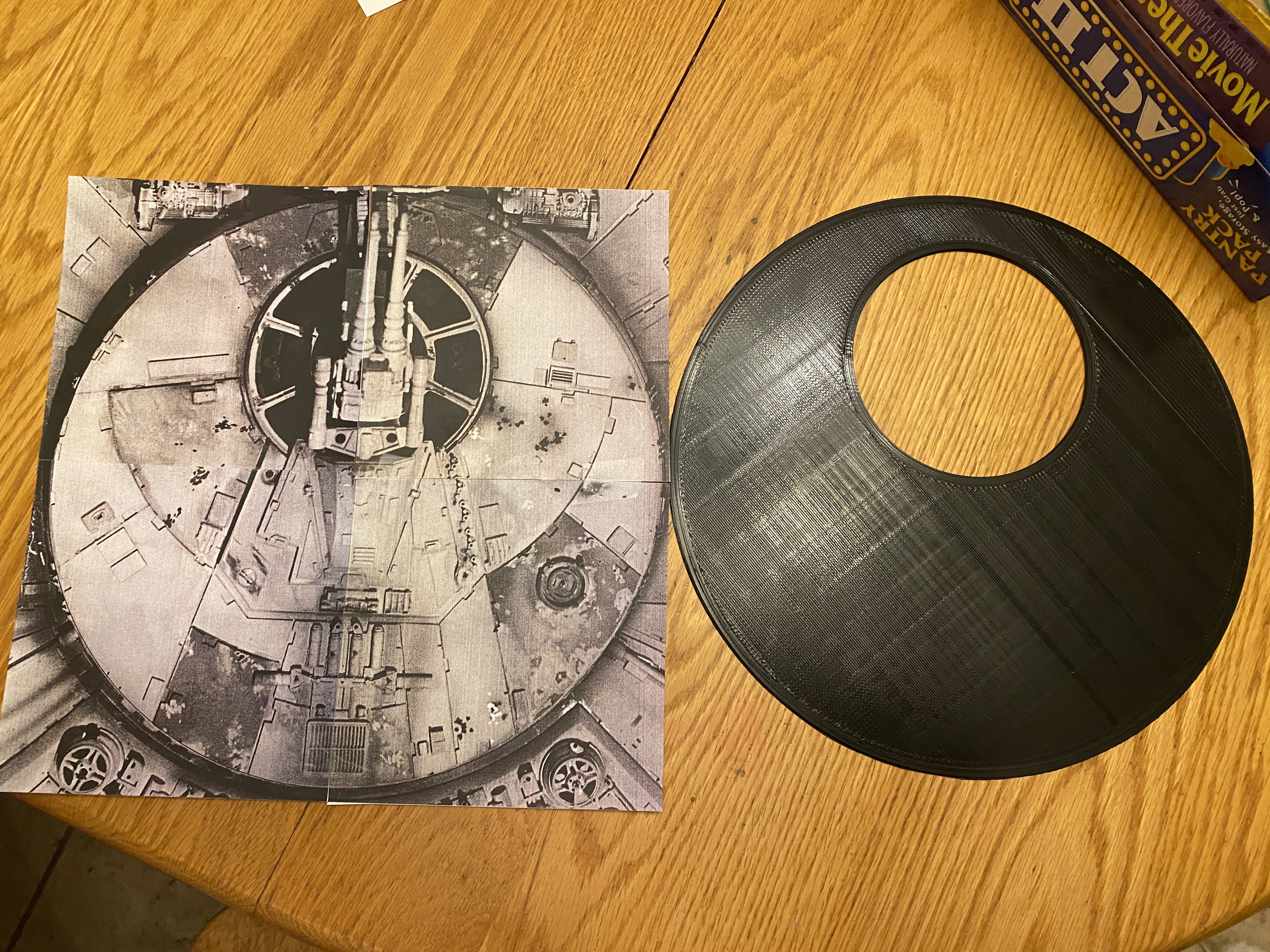

How about 7.25" for the width of the area where the docking ring attaches? Might try drawing my full sized patty tonight,
jcoffman99,
Width is approximately the base the circle of the airlock cone which is 7.25“ on the drawing as you noticed. Or, you can use the side elevation view centerline measurement of 3.688” X 2 per the Andre drawings. Wonderful work by his team. It may just be me, but some measurements may be “naked” and some may be “dressed”, but the stack up of kit parts usually validate how you measure. Any big bust in my build is because I am going a little off script in what I desire by way of added features. Have fun.

Thanks. Just started drawing it out. It’s hard to tell from the pic, but there’s a nice circle on there. :)
Are your mandibles parallel or angled ? ; )
