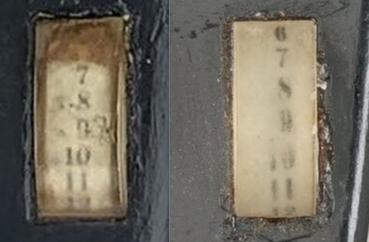

* No screencap match to any screenused prop, thus far.
* P1 rail glued into slots, rather than glued to outer shell.
* Velcro on left side, which matches no known P1, aside from the Jein, which does have screen-matched, vintage Velcro.
* Power meter numbers are the same numbers as on the Jein, and appear to be a different font than both the Jein and TMOST/Finney.
* P1 shape is off, especially near the rear, as robn1 notes.
* P2 cradle ribs look shorter and thinner than on the Jein.
* P2 trigger box shapes/curves look off compared to the Jein.
* P2 side dial does not intersect with the side ribs, unlike the Jein and the authentic midgrades.
* P2 emitter nozzle and side dial look different from the Jein, which, if both of them were found parts, doesn't make sense.
* Non-tapered P2 emitter.
* Crispy looks more like aluminum than Mylar, and does not appear to match the Jein or the midgrades.
* Paintjob and weathering (yellowed epoxy, etc.) look considerably worse and sloppier than on the Jein, yet details like the handle paint look in far better condition. Sure, different storage conditions could yield different results, but you'd think props made from the same materials, paints, and glues would age in a similar fashion if kept in storage for decades.
Again, it is nowhere outside the realm of possibility for a talented propmaker to put together a convincing fake. Just look at the work of (for example) Jon Paul Lussier, who has produced very authentic-looking midgrades with very convincing aging and paintjobs. A talented artisan with the right references and the proper motivation could easily whip up a convincing hero prop which looked very aged.

Differences in the potentially different TYPE of material used have been noted by our people. But the auction talks about tolerances. If the expert did not take into account that it might look identical but be made of a different material, then that analysis might hold less weight. An expert can be challenged by another expert and it happens in courts on a daily basis. The judge (or jury) has to decide which of the experts in a legal case is the more correct when they disagree with each other. And disagree they do, on a regular basis.
EDIT: photo mix up, here's the right one.
