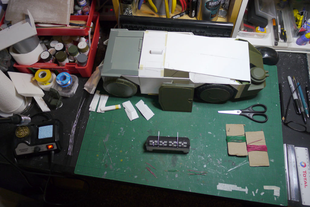

So, I'm sat in our local coffee shop with the missus. She's working on her short story and I'm tinkering with ideas for the APC.
Call me crazy but I'm seriously thinking of making the DSGR missile system a functional feature - at least as far as opening up. I'm having to deal with some interesting planar geometry for the ceiling inners/outers at this point anyway so I figured 'how can I make this even more tricky to achieve' lol.
skiffy
Ah come on! You've said it, now you've GOT to do it! (y)
I think you're right Duncanator. :)
I've done some fiddling with card and I reckon it'll work. I knew all those Chupa Chup sticks would come in useful for something. :)
It's just sat on top at the moment but hopefully it'll work well.
I'll make some rounded warheads for the ends of the missiles and detail out the bays.
Next up is cutting out styrene copies of my card shapes and sorting out how to keep the rest of the roof detachable.

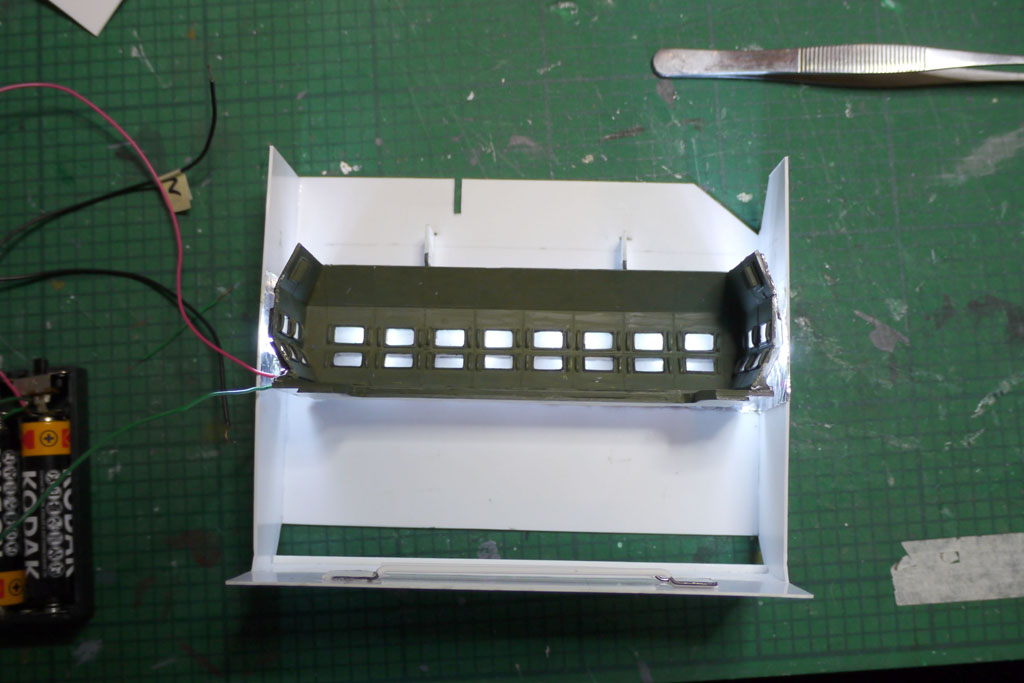

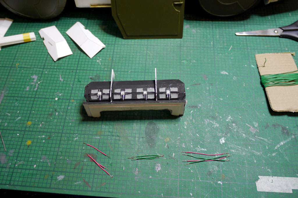

Next up is prepping for lighting the screens in Gorman's console - the TOC station.

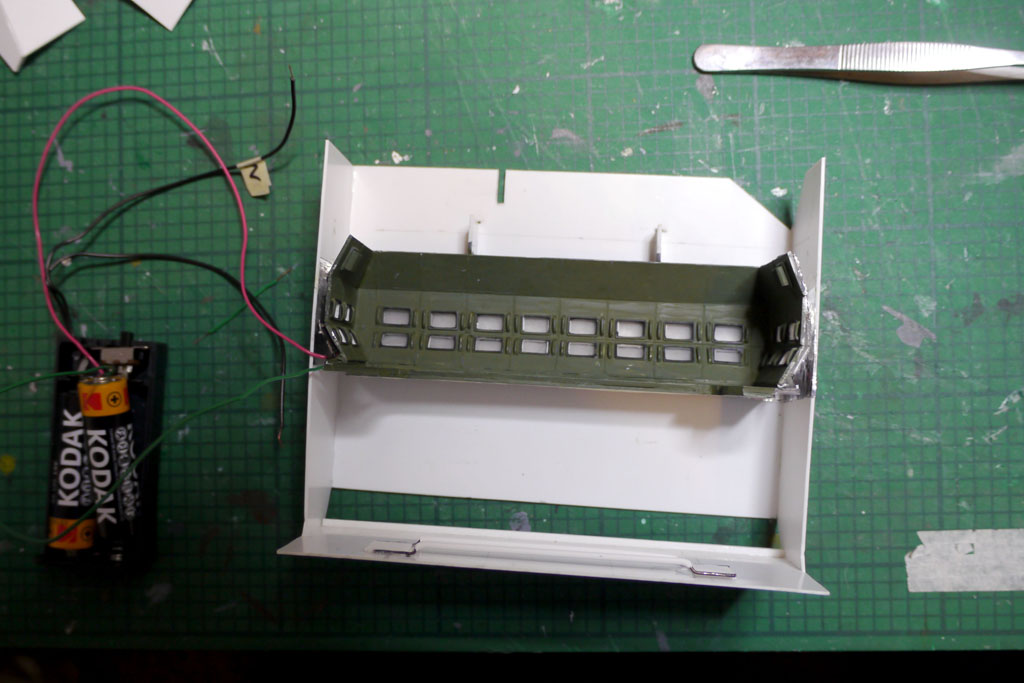

Just about to connect and test - always a nervous time (especially given my sloppy soldering).
Yay! Not easy to see against the white background but it works!

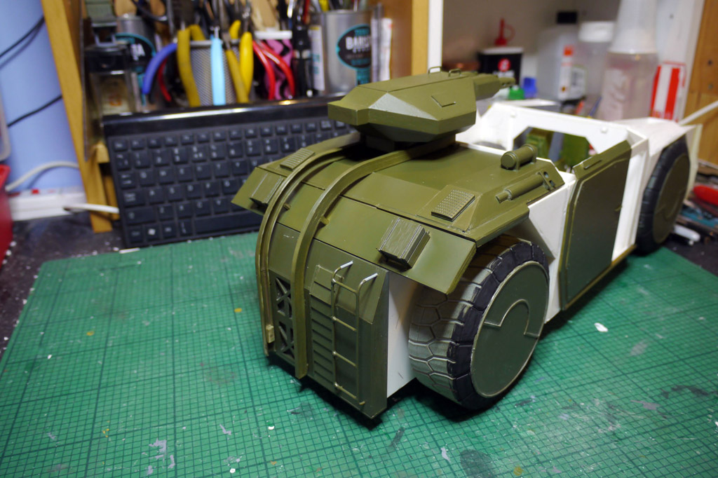

I did some more work on the rear exterior and threw some rattle can olive drab over it all to see how it was shaping up.
It's starting to look a lot better. I'm looking forward to getting the rear light assemblies done - I'm just waiting for a delivery (a new FEP film tray for the resin printer).
