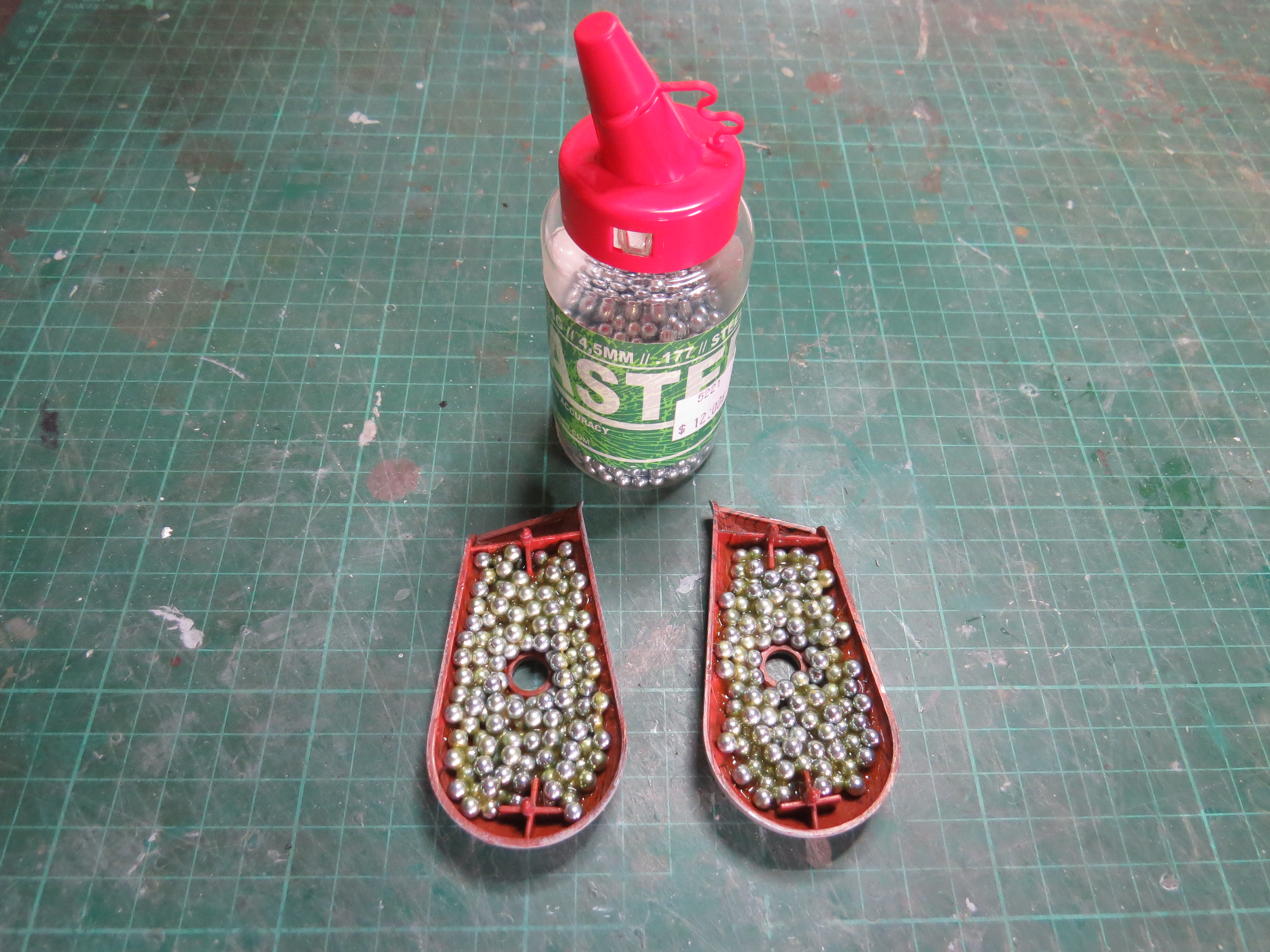

I glued steel BBs into the Grips and it worked quite well and gave the plastic gun some 'heft'
I've used steel BB's and fishing weights with a 2 part epoxy putty like milliput, or steel stick (for a quick set option), or JB weld in the round containers. I'm partial to the putty as I find it easier to work with than liquids, and it adds a bit of heft itself.
