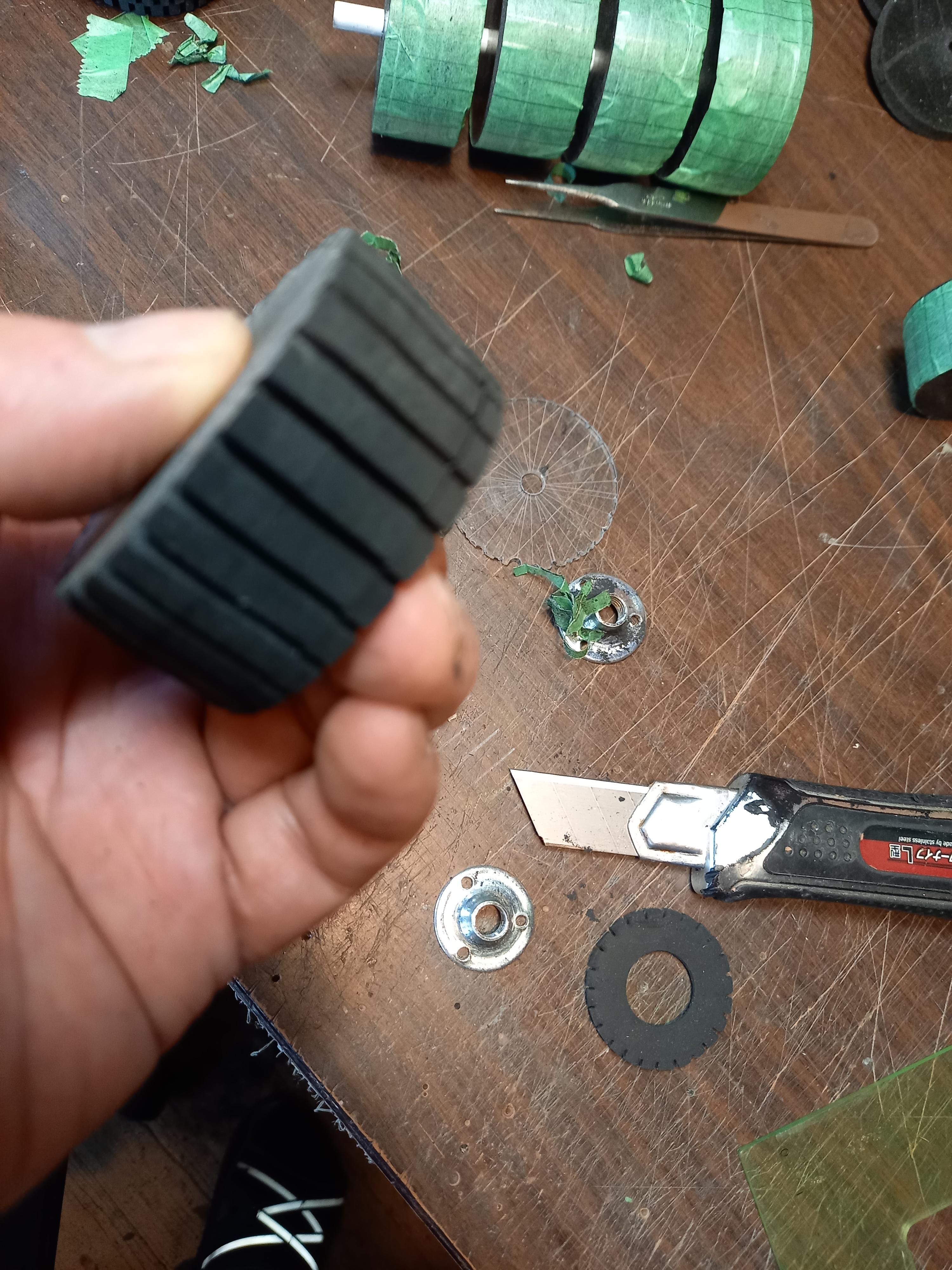

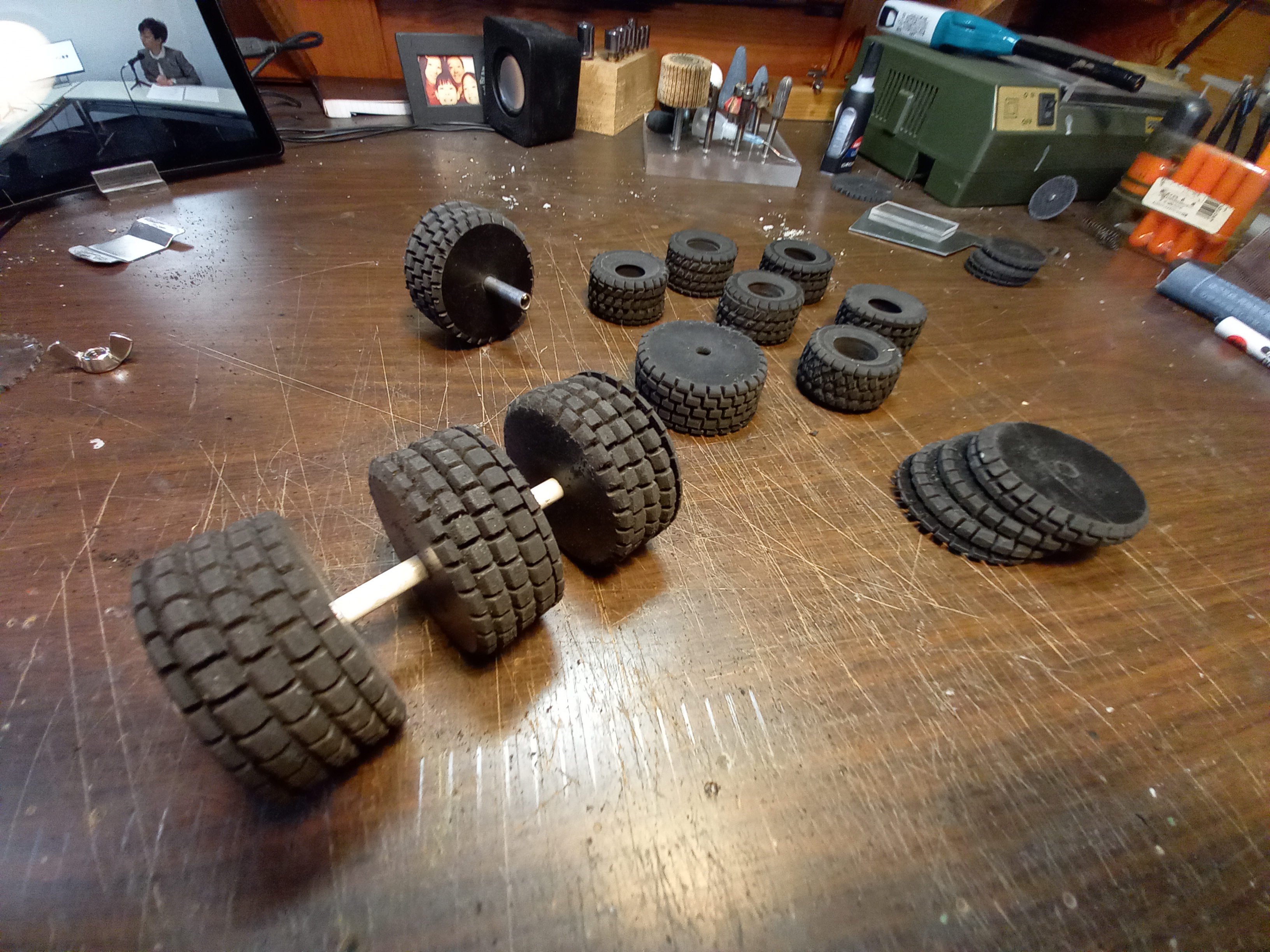

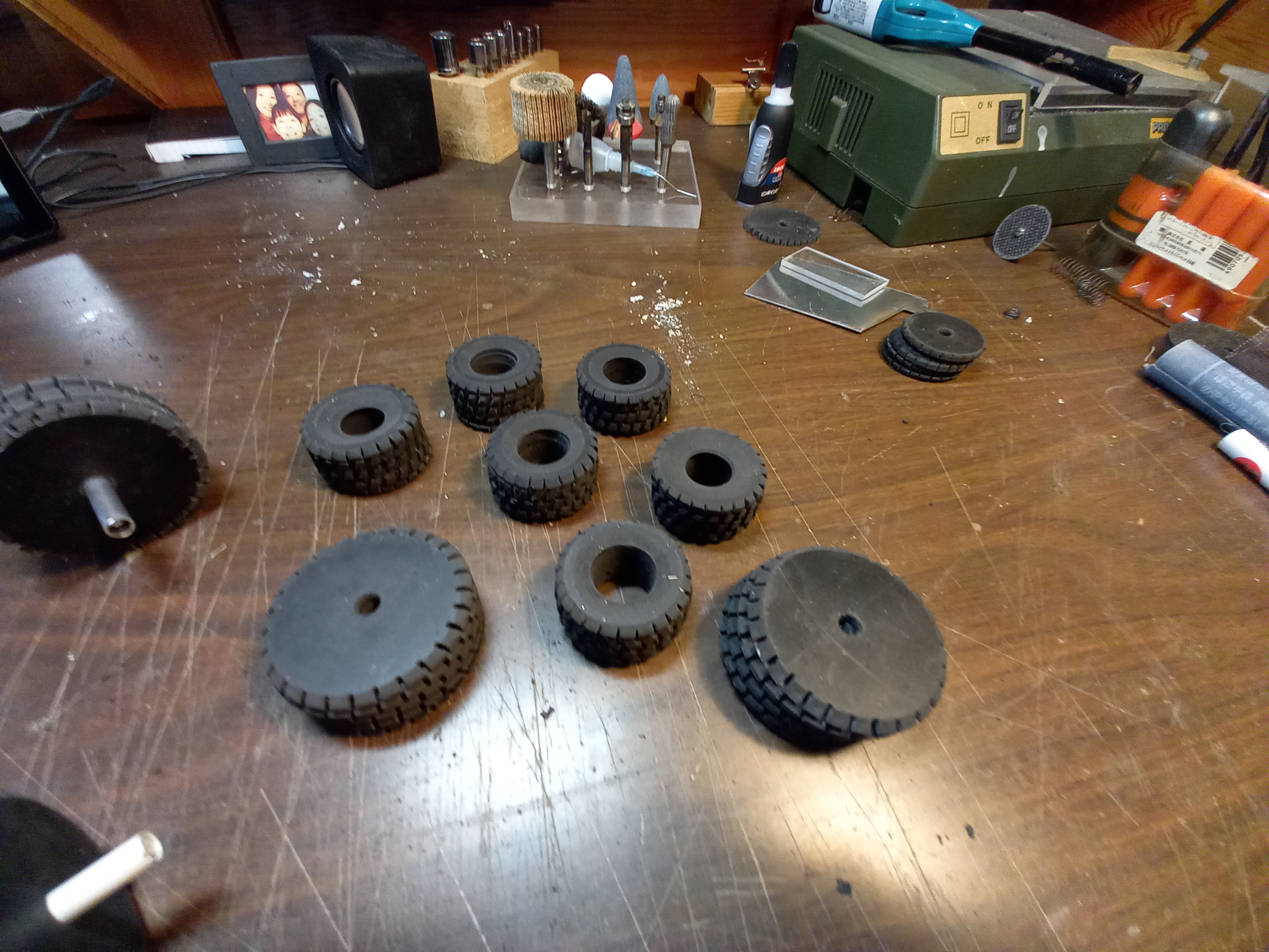

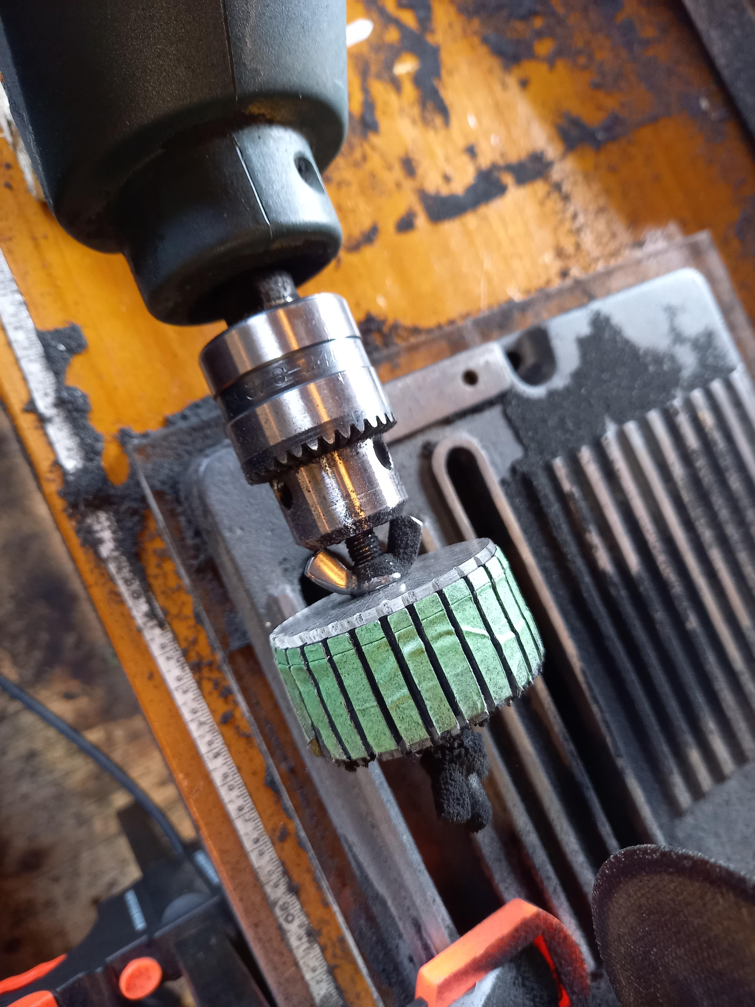

I keep working on the extra-large tires.

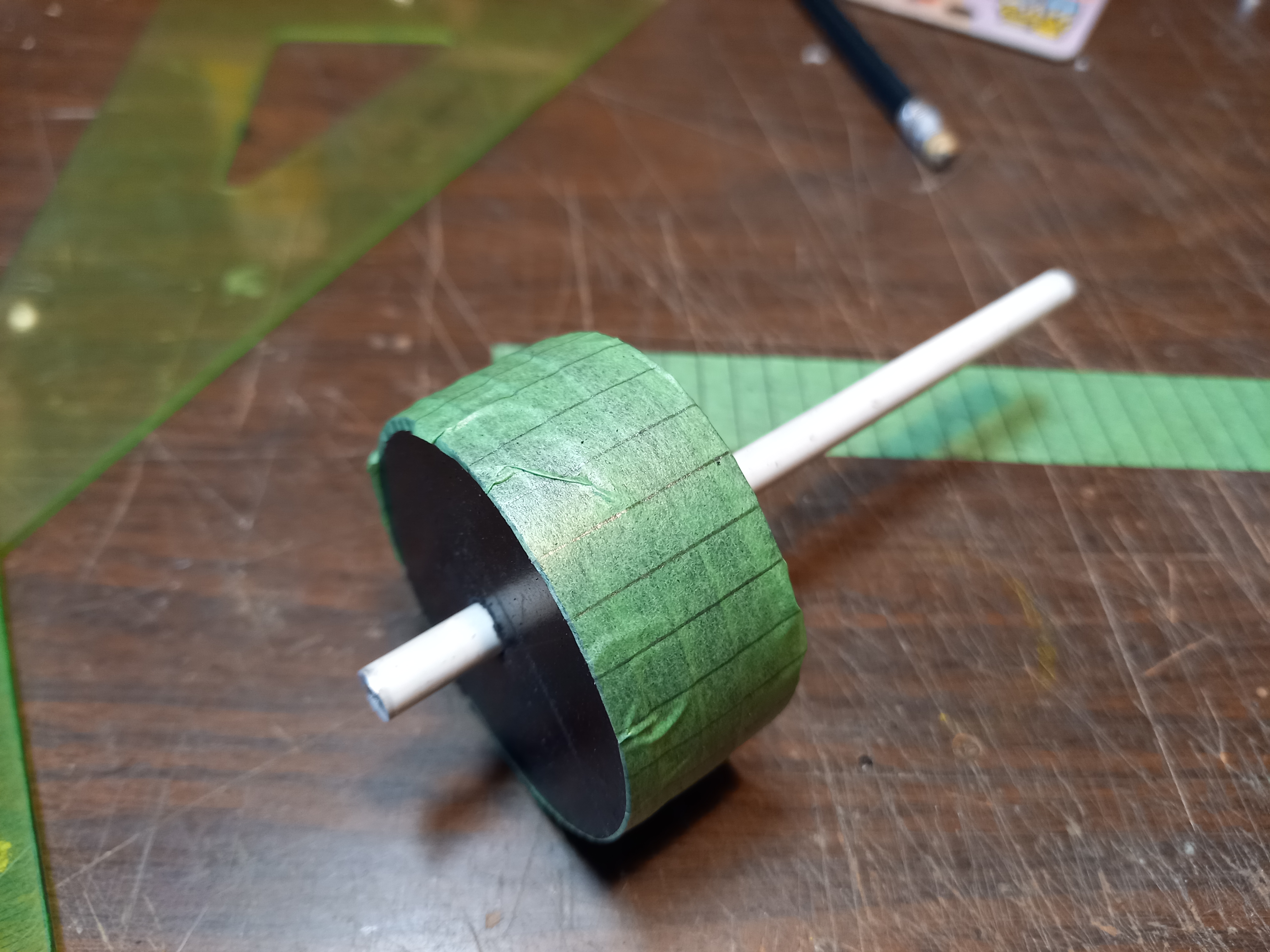

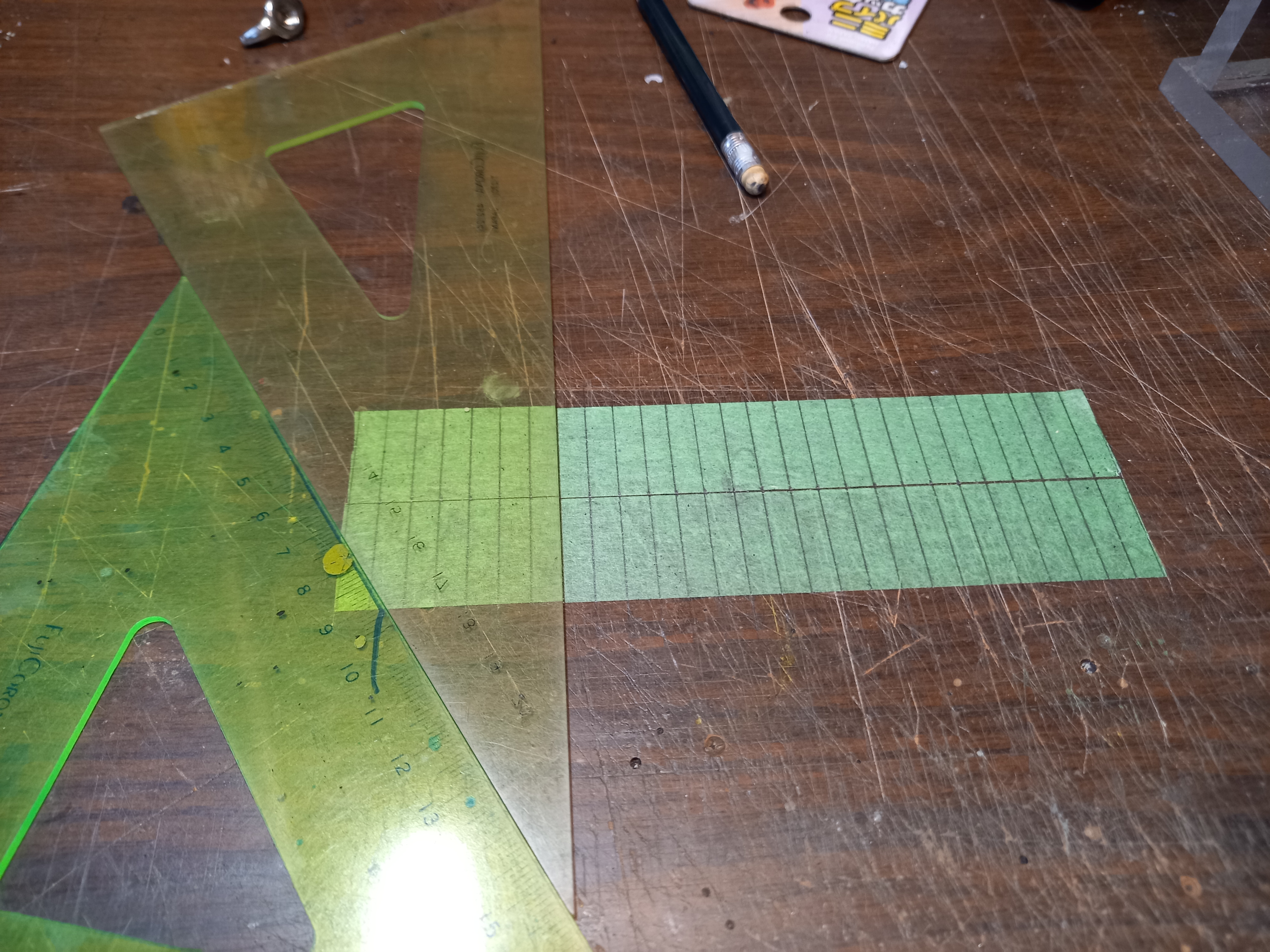

So I made up a simple working tool (Jig?) for this which is combining the power drill and power grinder stand. Previously, I made a cog disk to chop a constant pitch for the tread pattern. But that was not so accurate as I expected. I tested the tool and that was OK. But still, I couldn't get the accurate patterns.
When I was toying a masking tape in my hand, I realized how stupid am I. I missed the simple way to make a constant pitch.

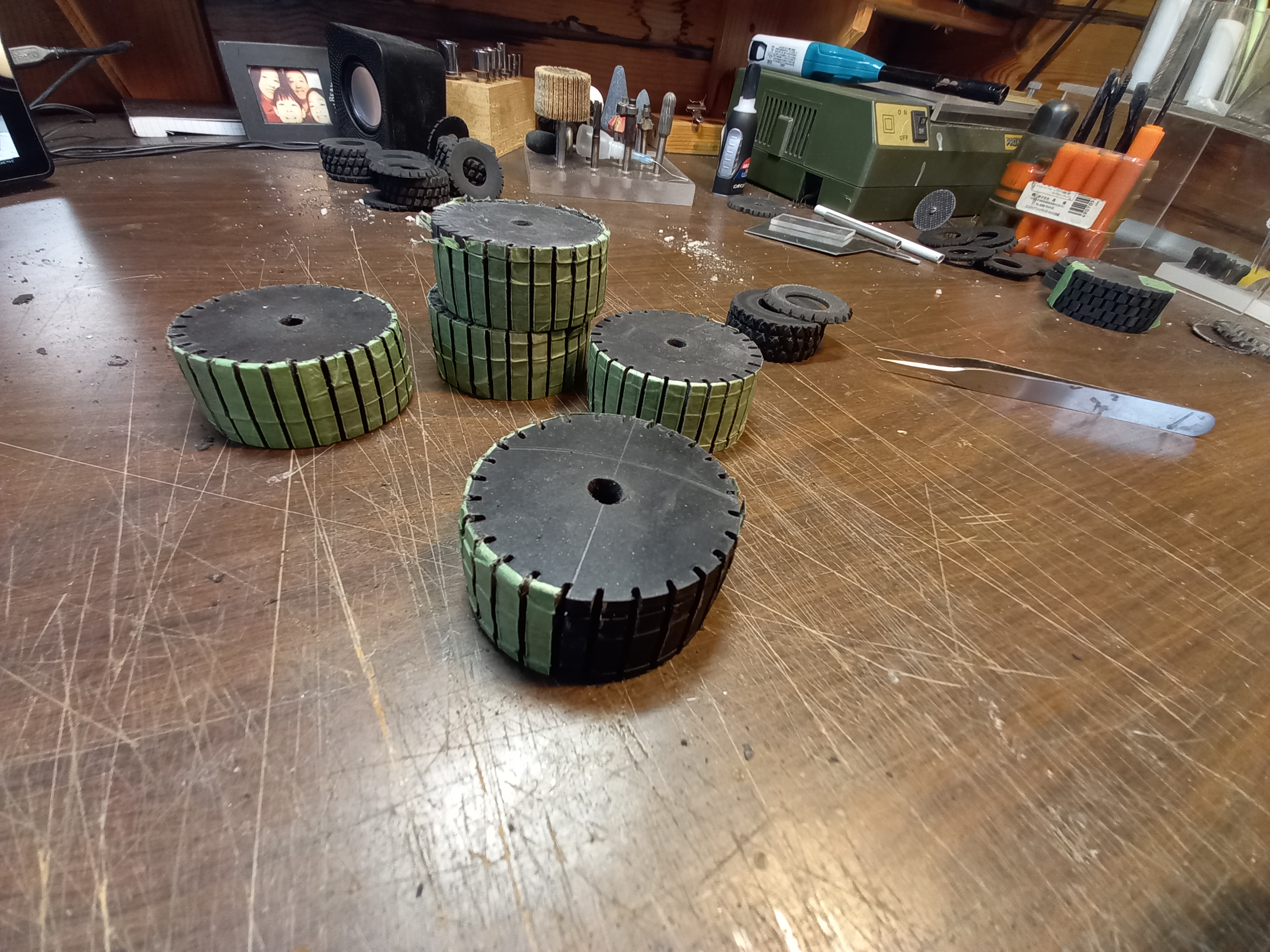

I put the masking tape around the stack of rubber disk.
Cut up the tape and peel it off. So, I got the exact length of the circumference of the tire. Stick that tape on a flat surface and measure its length. Then, with a simple calculation, I got an appropriate pitch of a tread pattern around the tire. This time that was 6 mm. I drew the pitch line on the tape and stick it around the tire again. Now I got the rather accurate carving lines.

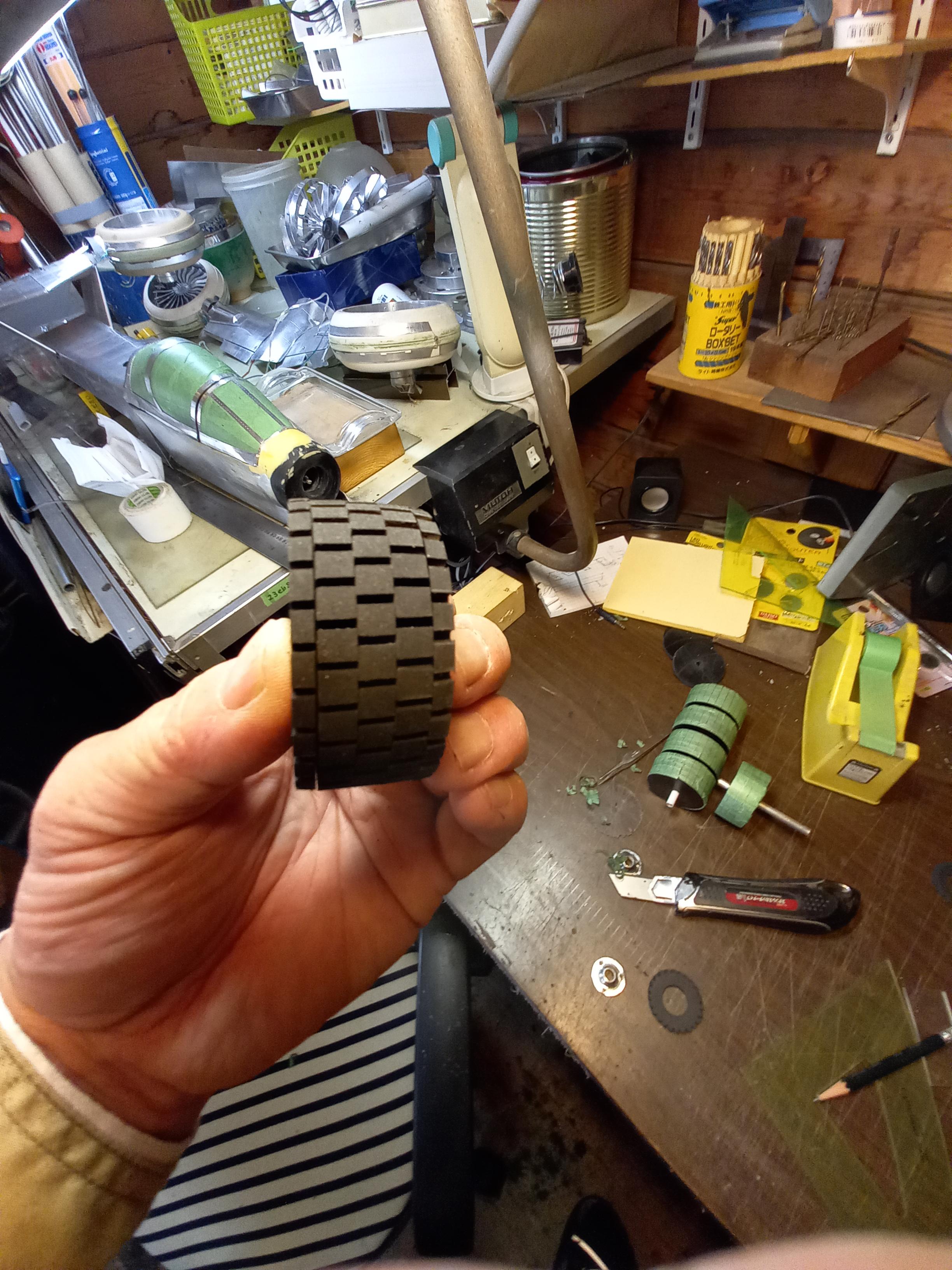

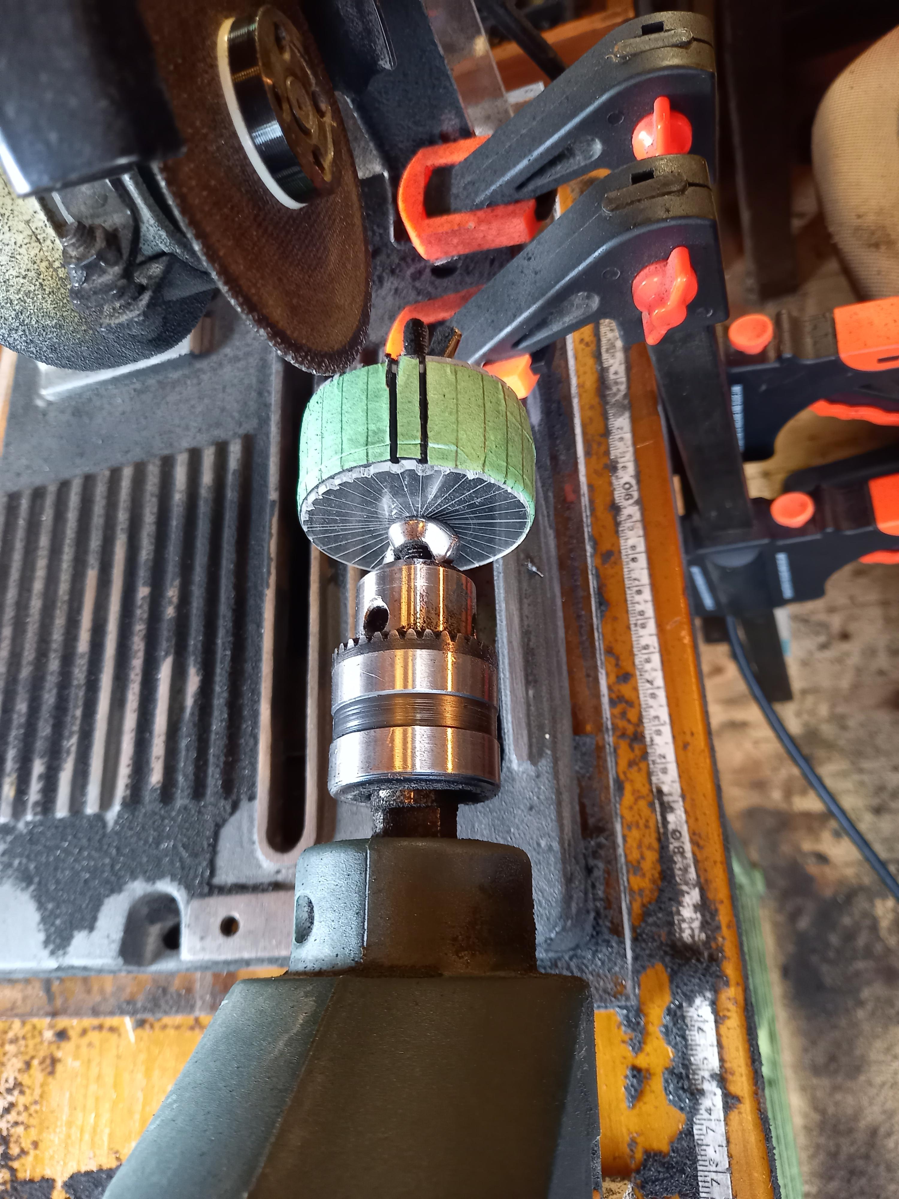

Set the slick tires on the power drill shaft and fix the alignment.
Set the slick tires on the power drill shaft, adjust and fix the alignment.
Turn on the power grinder. Slide the power drill bench into the grinder blade by hand.
Then rotate the drill shaft a few degrees manually to the next cut. That was simple.
Trimming the sides of each rubber disks as I did before and I got better tires.

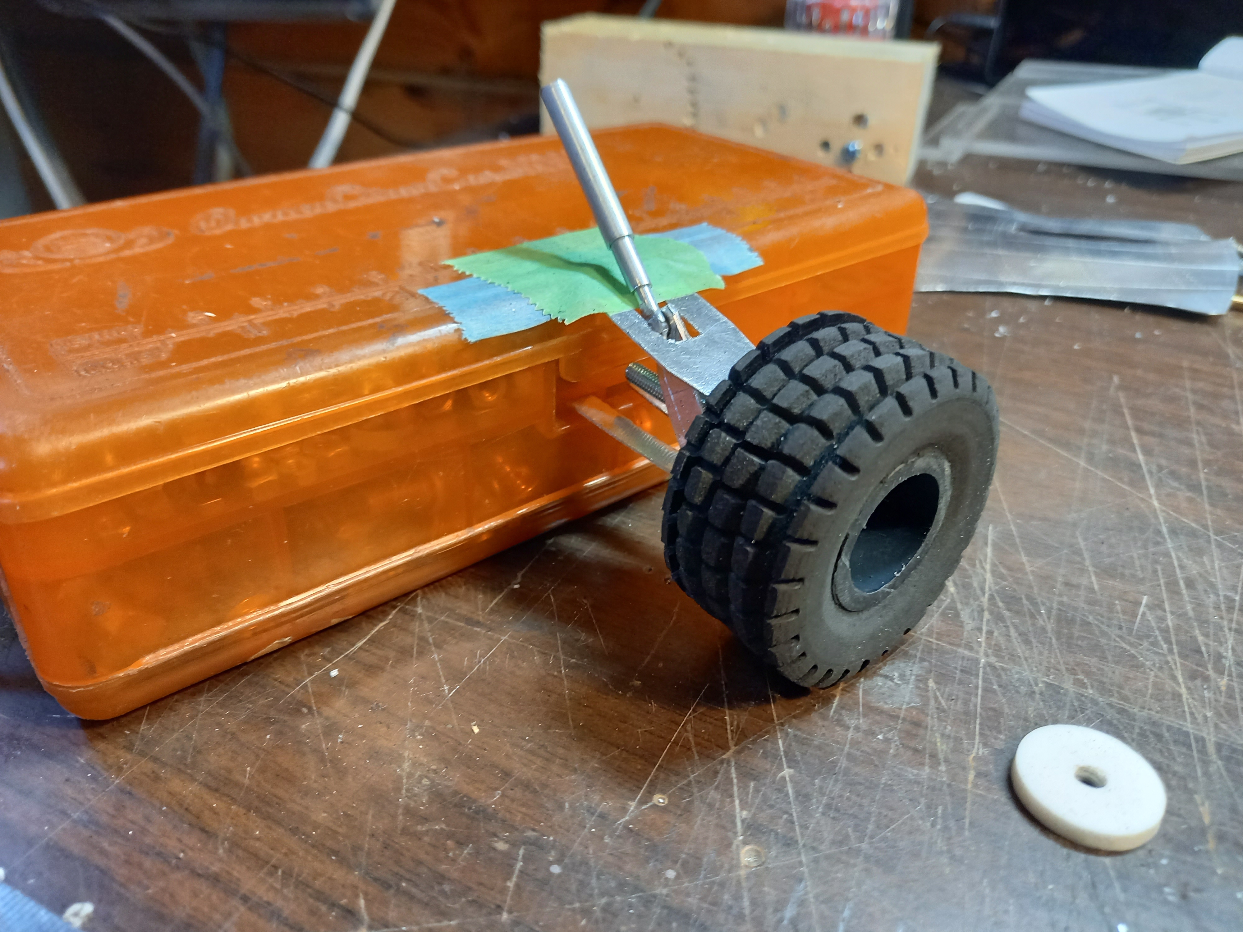

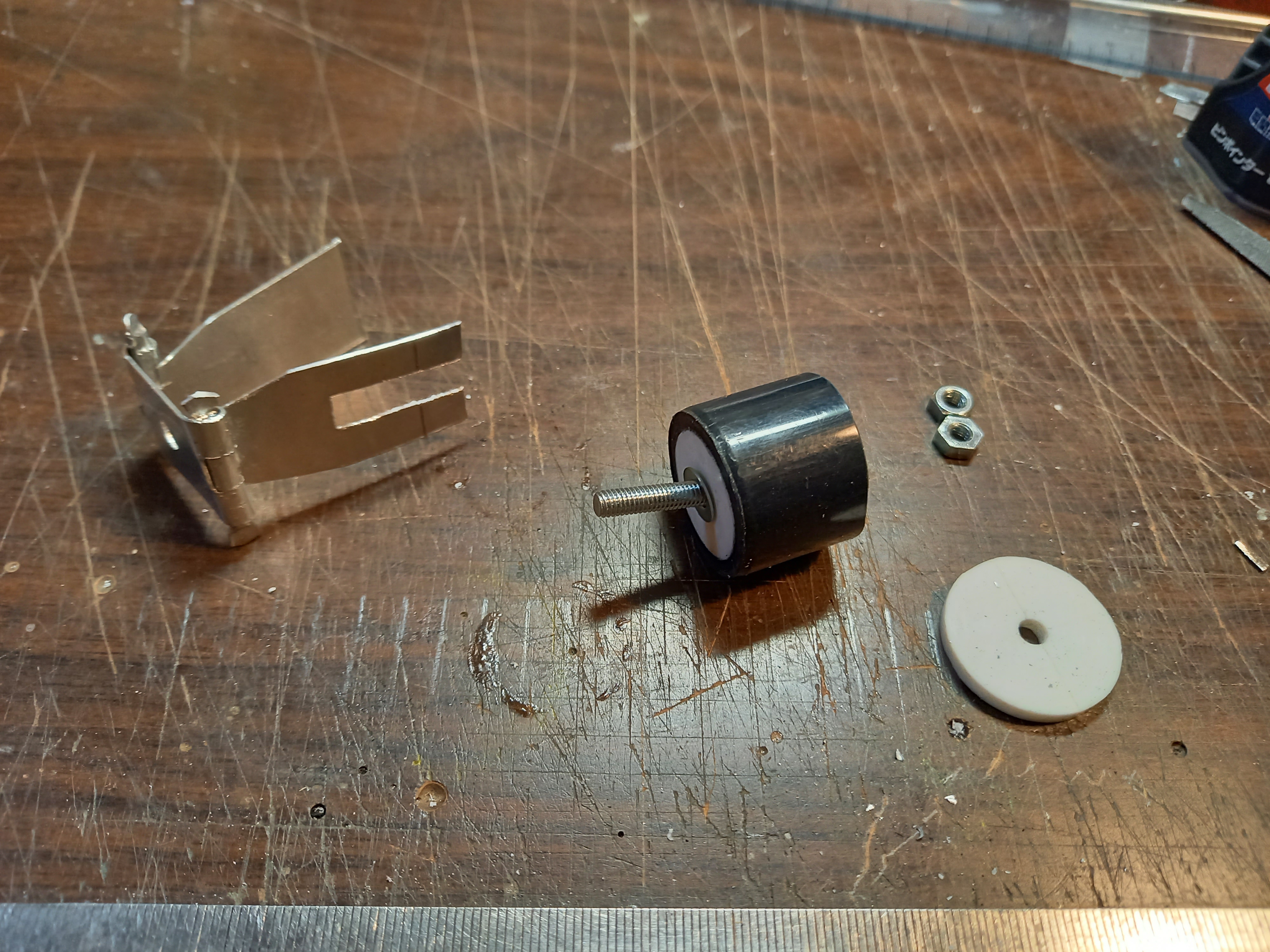

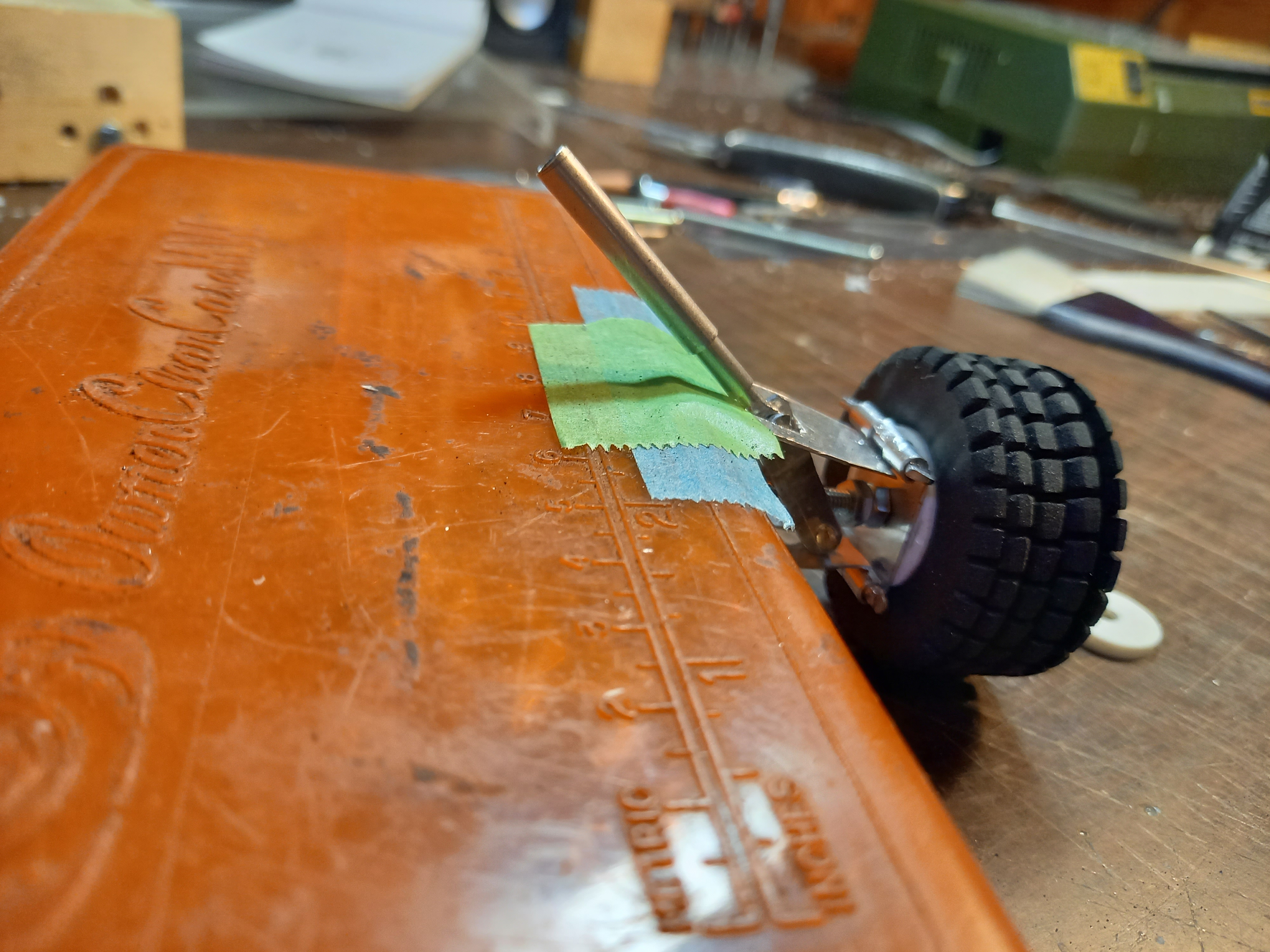

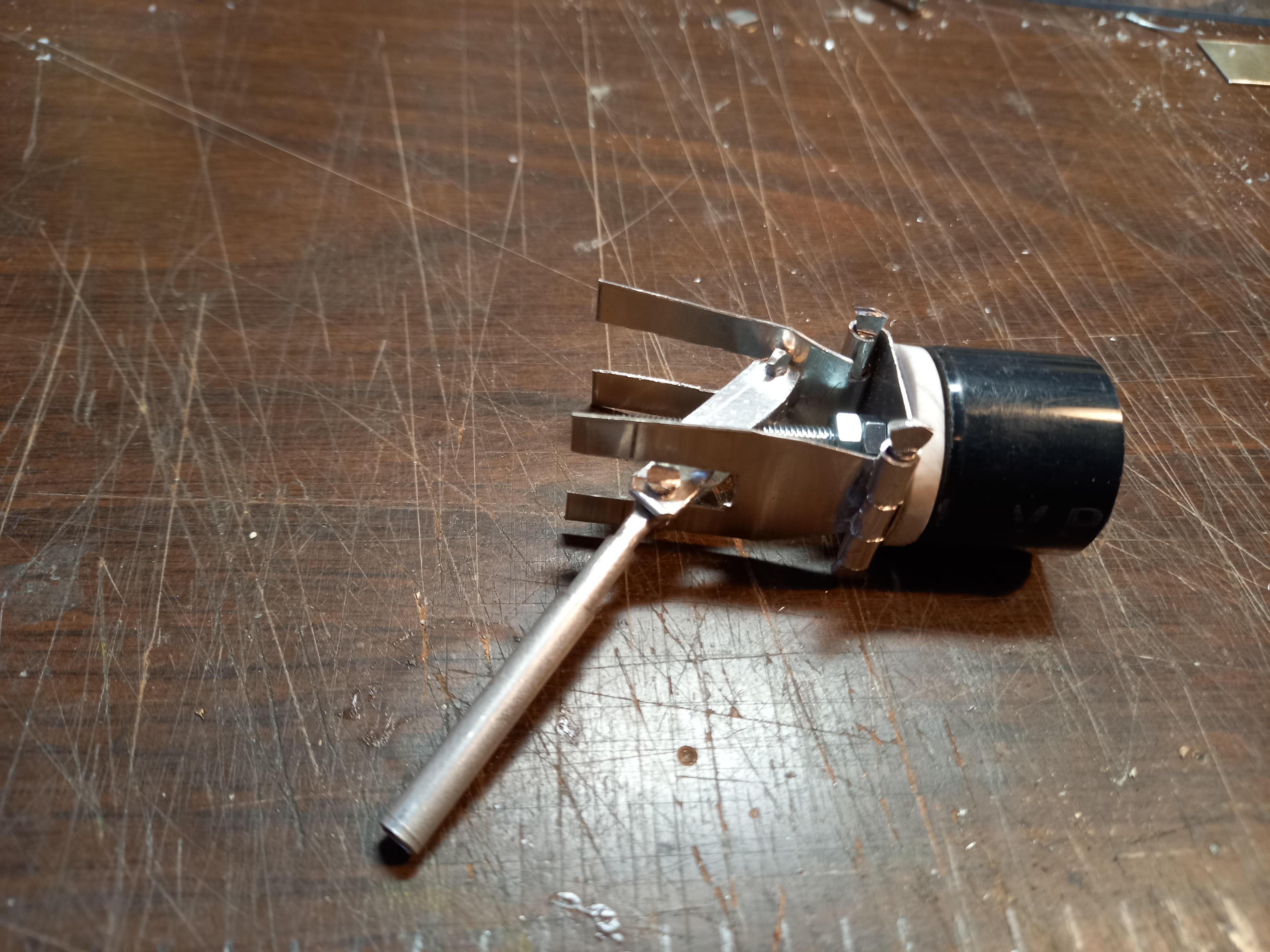

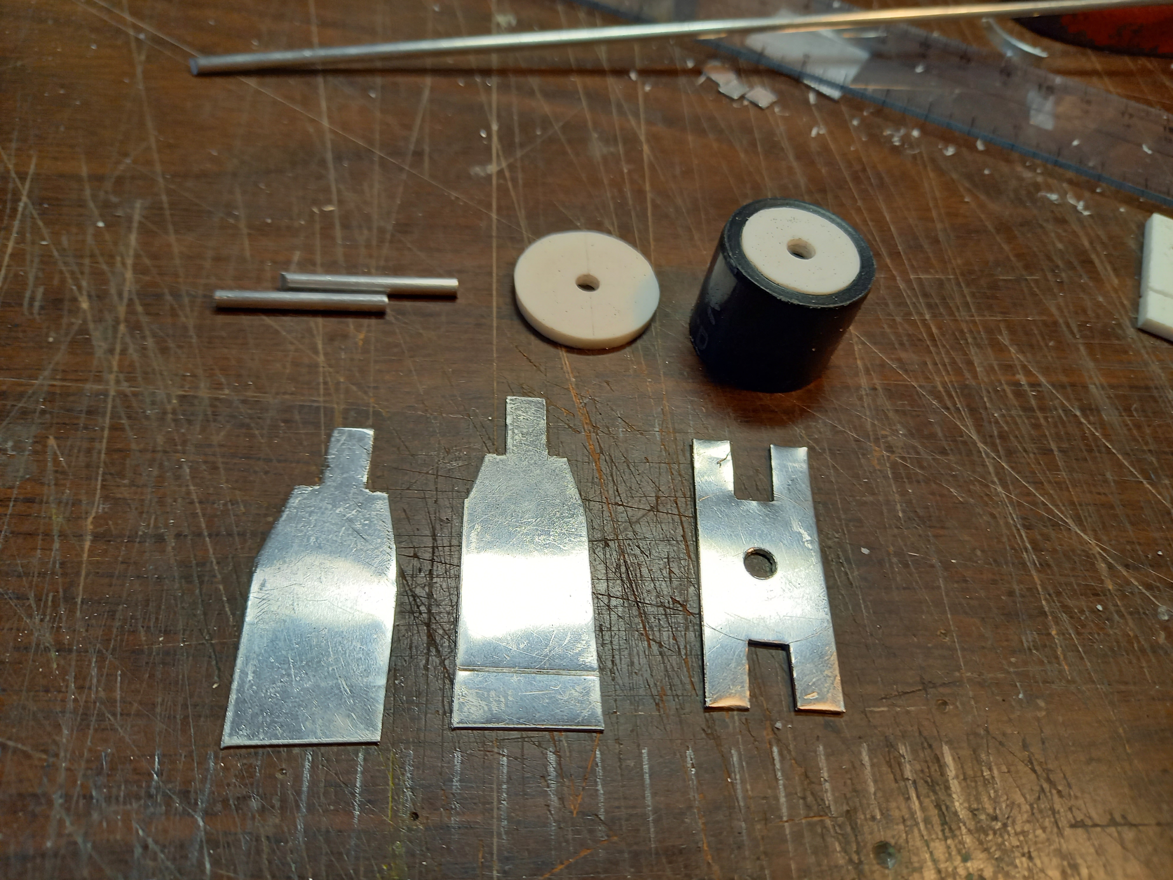

Today, I've test built a wheel and suspension.
I don't think I am going to give it a real-working suspension system but at least I want it looks real.

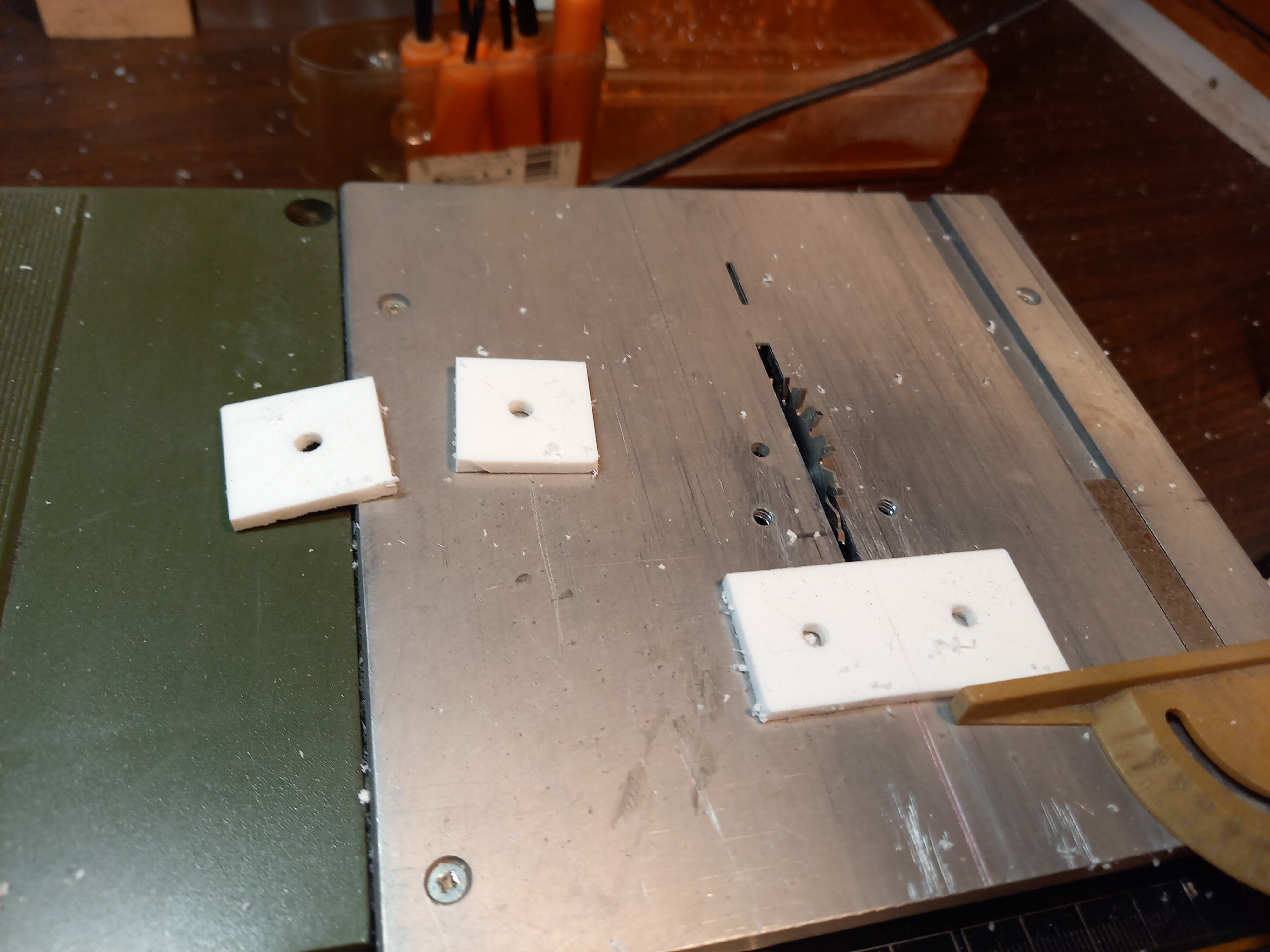

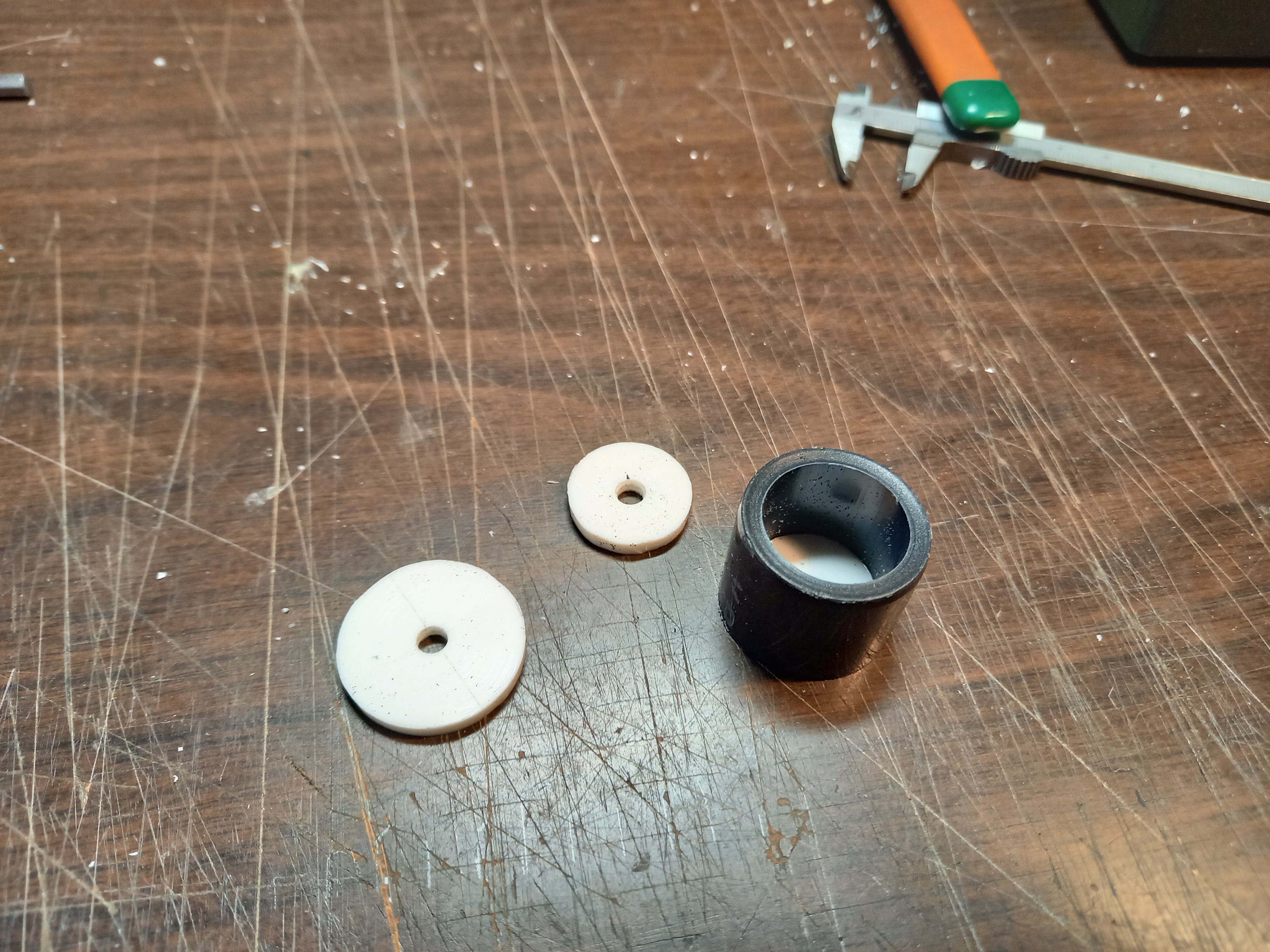

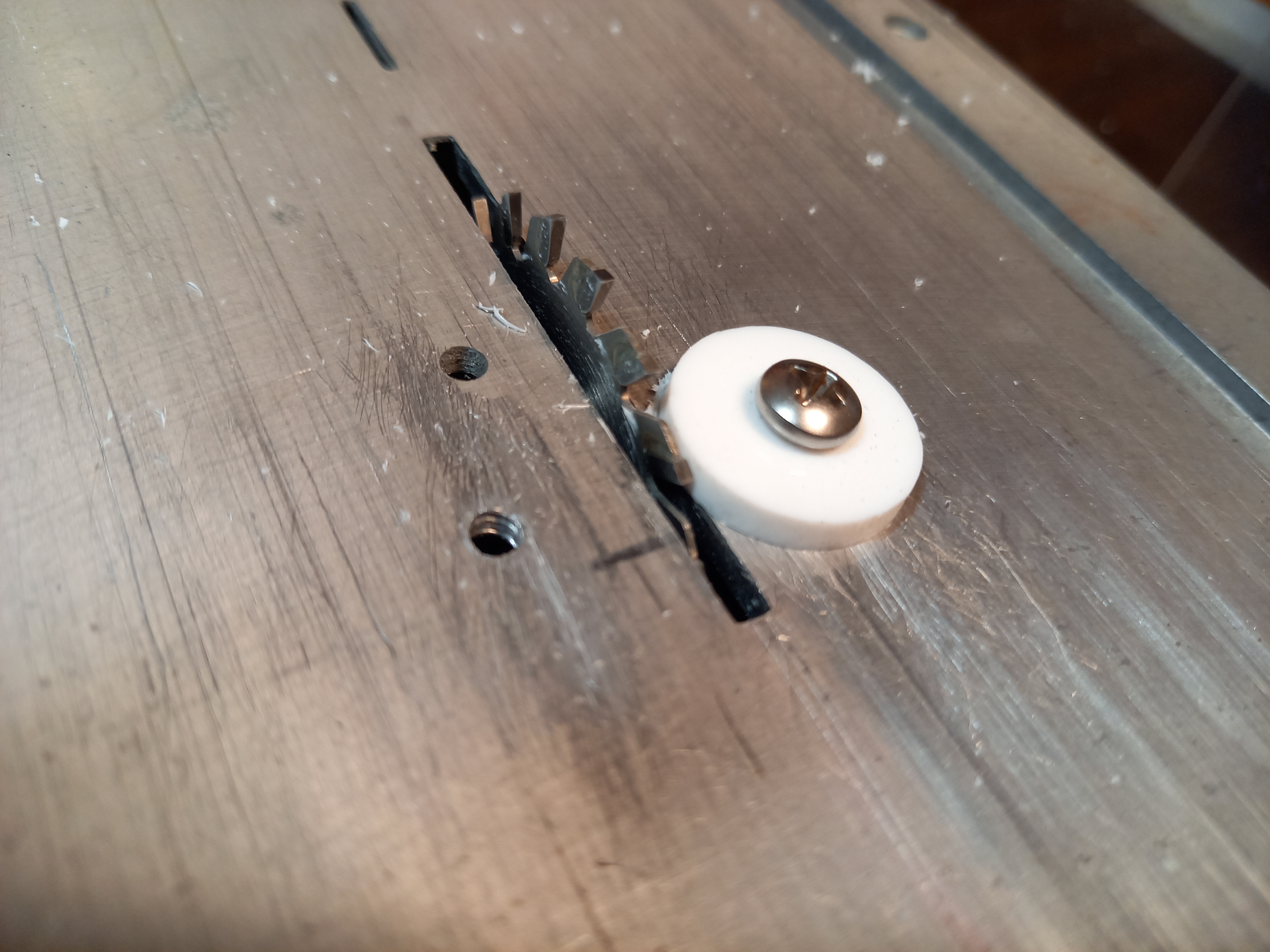

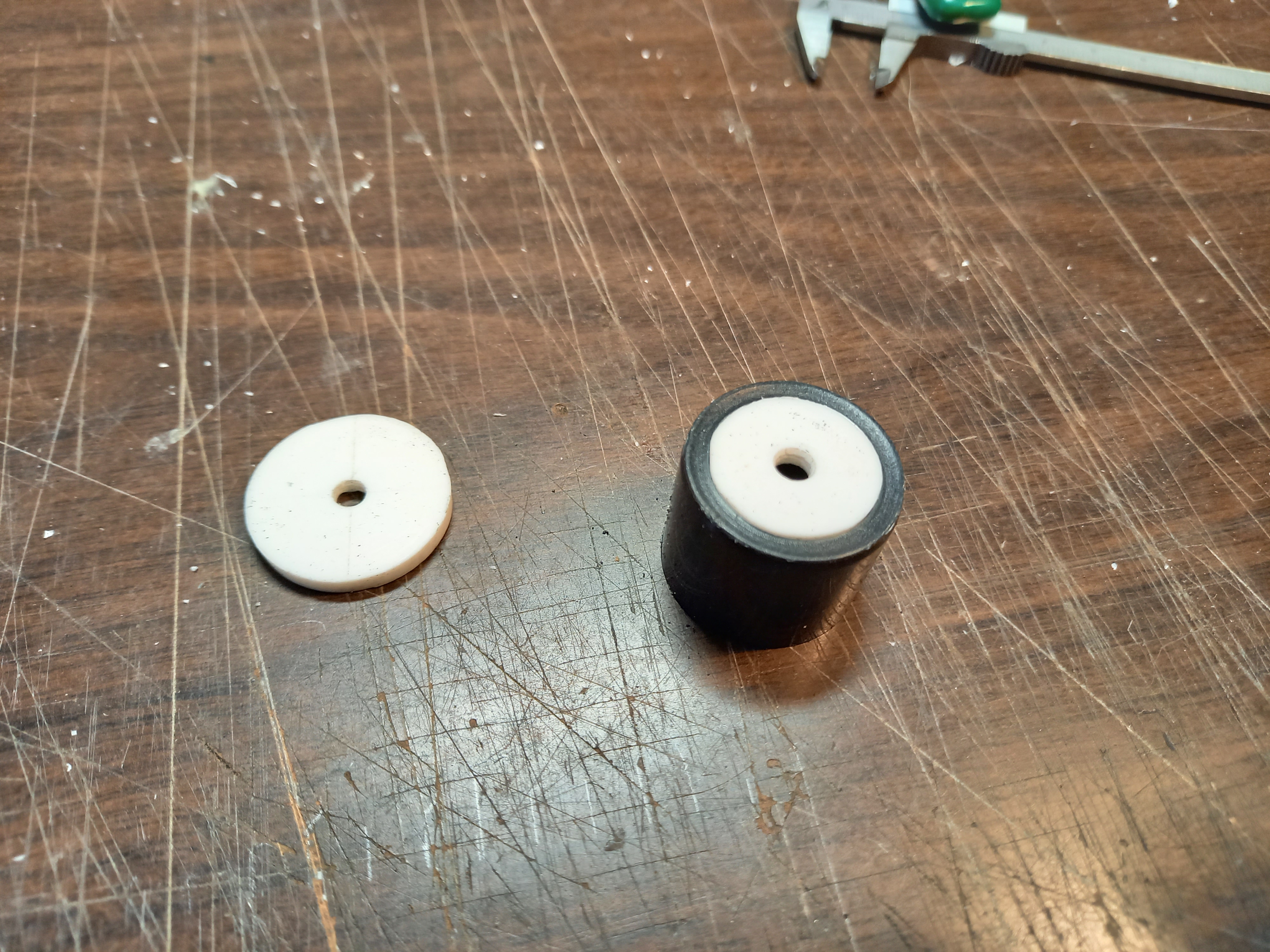

Making 2.5 cm and 2.0 cm diameter disks out of 3mm acrylic plates.
I drilled a little hole on the small circular saw table and screwed the plates on.
Also, cut up the 2.5 cm diameter water line tube.
Some metalwork.
This test build makes it easier to get an accurate measurement for each component part and the crafting process.
When this wheel and suspension assembly has done, I can fix the total design and measurement of the vehicle.
