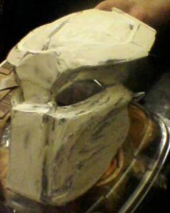

So I know I'm not exactly really far along but I wanted to get some feed back and see what I might do to improve my technique. I started with the Pepakura paper model, and just discarded all the tabs. Cutting out the basic shape from cardboard inserts I got from work. Then I started hot gluing these pieces together. Once it was built I just coated it with Joint compound I had laying around the house.
This was the end result after a bit of sanding,
I ended up having to coat the whole thing again and cover it in mat finish and sanding it again. Then I painted it black, and found out their were still a lot of fissures and grooves in need of filling.

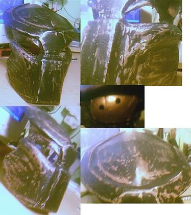

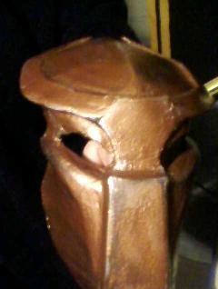

Still more sanding and filling and sanding I finally painted the thing bronze and clear coated that to help cut back on any possible chipping. I chose bronze because that seems to be a popular theme in the comic books so I wanted to go that road instead of using the same movie predators over and over again.
I ended up having to sand it yet again before adding a second coat of bronze and once that dried I began the aging process. When complete I added yellow mirror lenses from a pair of dollar store sunglasses, these were held in by Hot glue.
The end result is now my avatar and the beginning of my Pred suit. I'm now using some of Vinmanmac's tutorials to complete the body armor, which will also be done in the same fashion as the mask for sake of my budget.

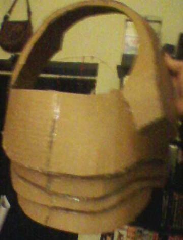

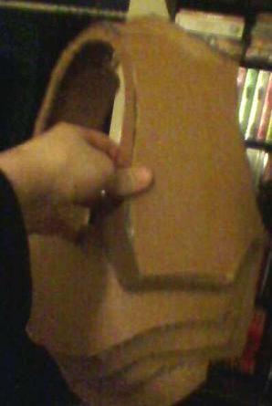

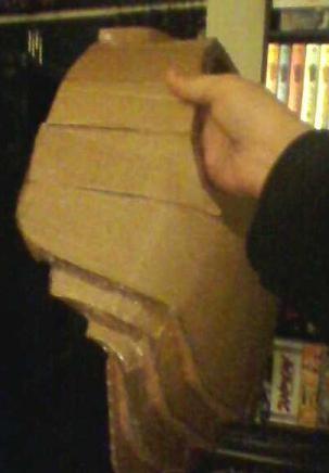

So here is an update for everyone, My chest armor in its first stages. This is only the first half and still in its raw cardboard form.
Back view:
Front view:
Side view:
The templates for this piece started out by Vinman, and I re-sized the plates and built it up a little more. Hopefully the finished product turns out half as good as the pre-sketch looked on paper.

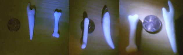

Alright so decided to work with some different material, its called cold porcelain, basically its an air dry clay that is vary easily colored with either oil or acrilic paint. I'm sticking to the basic white translucense it starts with for now. I'm going to try to craft a few test peices and if all goes well I'll get some pictures up soon.
The recipe is really simple:
1 Cup (8 oz.) PVA glue like Elmers white glue
1 Cup Corn Starch
1 Tablespoon Mineral oil (I used baby oil)
1 Tablespoon lemon juice or clove oil, witchhazel may also be substituted (This is a natural perservative to help prevent mold)
Combine all ingredients in a pot, cook on low heat stirring constantly untill a dough starts to form and it begins to pull away from the sides. Remove from heat and allow to cool till it can be handled. Knead to a smooth consistency and store in plastic wrap in the refrigerator
When your finished with this stuff you should seal it with something as its water soluble even when dry.
Alright so I managed to get a few small test samples done tonight, the weather was to warm for me to work on anything larger the cold porcelain kept trying to dry out befor I could finish sculpting. Still It looks promising I think. I didn't get a chance to seal either of the items but the texture on them is very appealing though it doesn't show up in the provided images, sorry about that.
The penny is there for scale as I can not for the life of me take consistent photos with my camera.
I hope maybe this provides some other possabilities to the hunters out there.

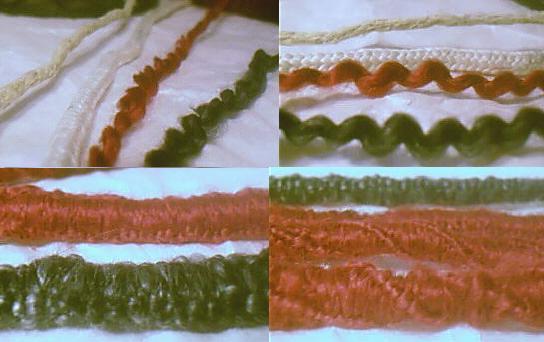

Alright so I didn't get to start on my gauntlets like planned but I did still make progress in other places. I started a few dreads for my Pred, but I decided to try something a little different. I used some rope and yarn to make a braided dread using macrame techniques.
This is a close up of the dread textures and the materials I used in their construction. The dreads are a little over two feet long right now, I may make some sorter ones. I know I'm planning on doing some grey that fade down into the red. Its time consuming but I really wanted to trying doing something a little different then what I have seen.
