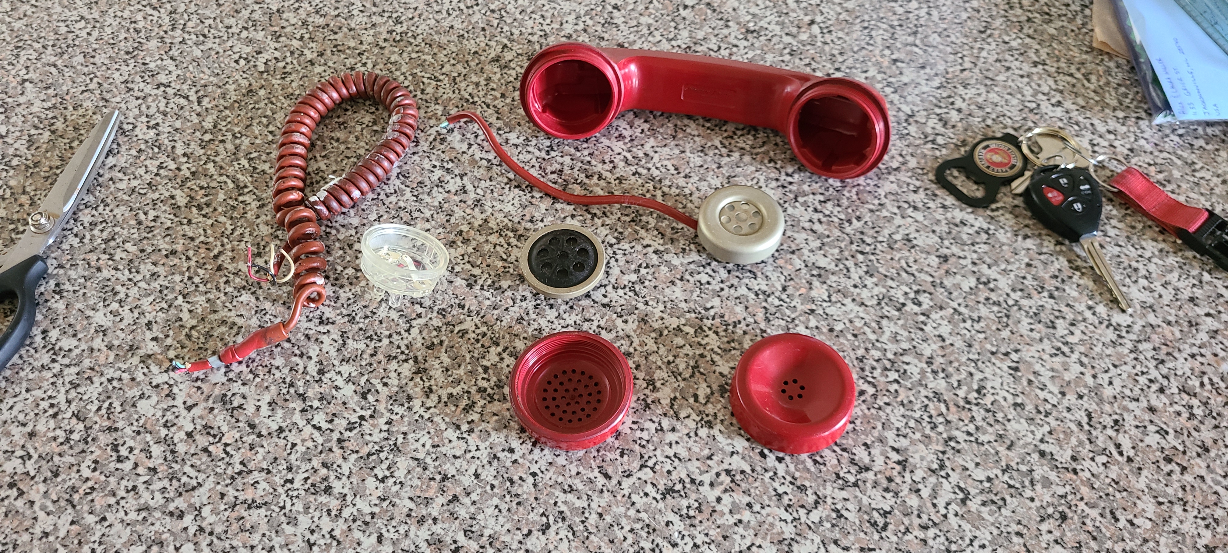

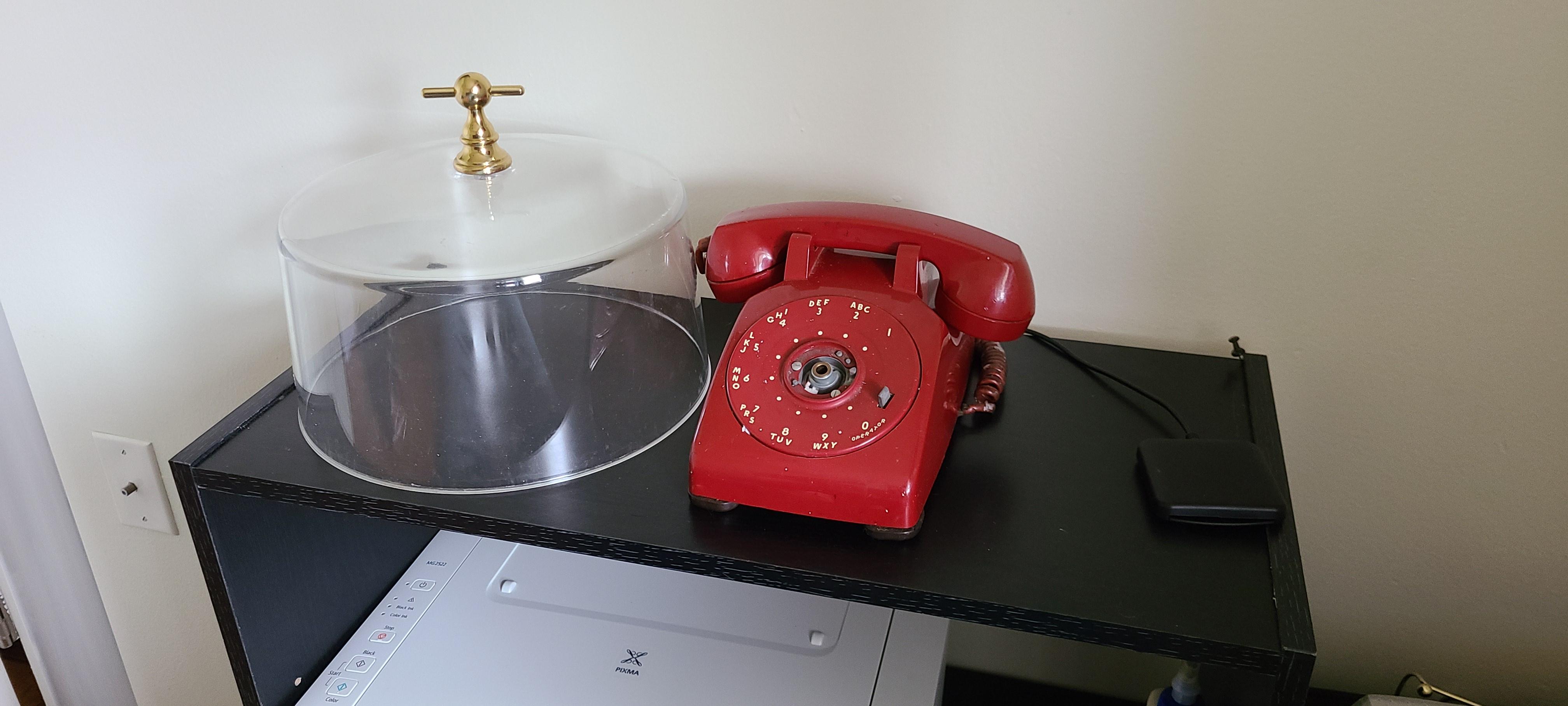

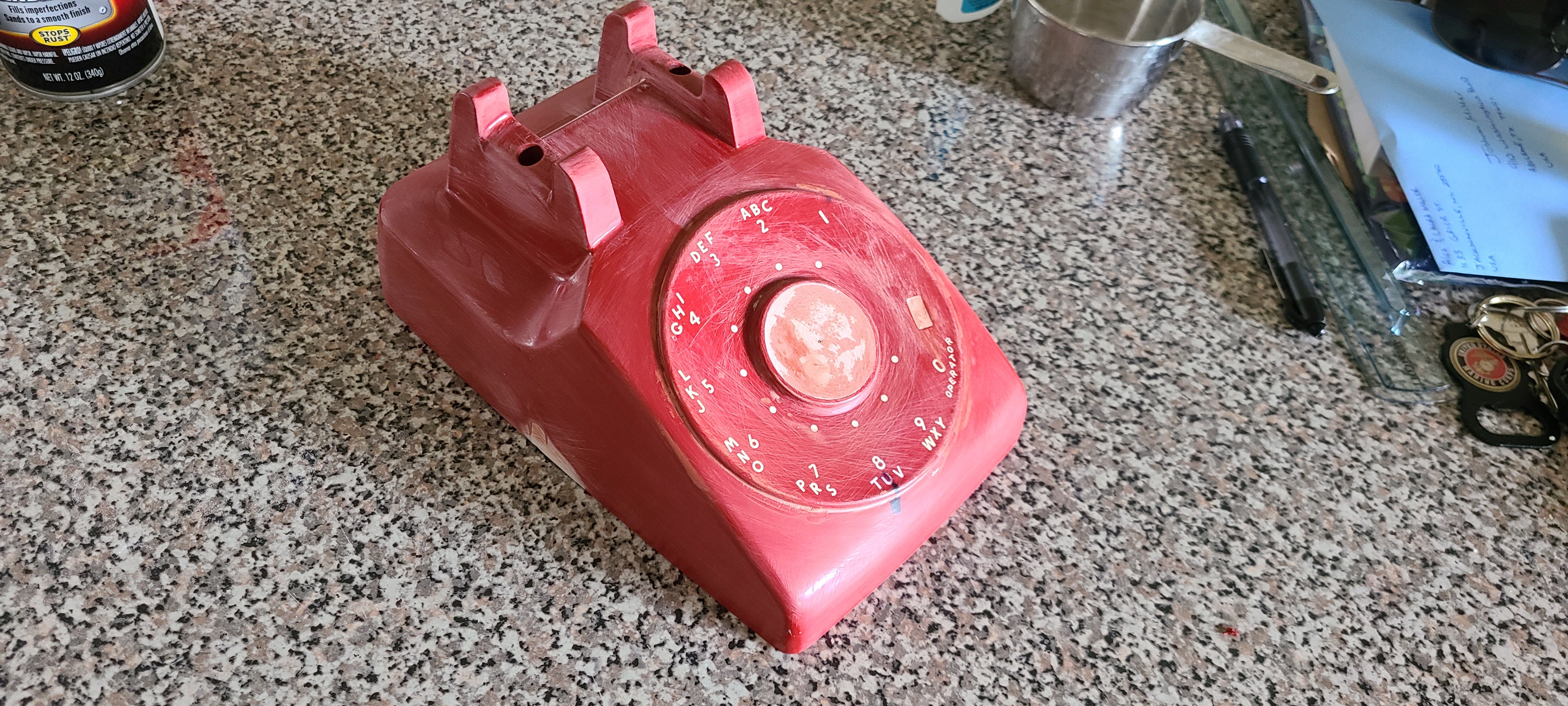

So after starting a build on another '66 BatRadio, I've been viciously bitten by the Bat-Bug, and when I saw this old red phone in a box in the garage I knew it was time to finish this properly. Here is what I'm starting with:
As far as I can tell, these were cast in fiberglass resin so it is my full intention to modify this phone heavily until I have a properly lit fiberglass BatPhone sitting on my desk. There are two versions as far as I can tell: The shorter phone on Bruce's desk and the taller one seen primarily in Gordons office under a decorative glass cover sitting atop a black wooden pedestal. Both seem to be made from the same material (the fiberglass resin mentioned earlier) and look to be virtually the same with the exception of the noticeable height difference.

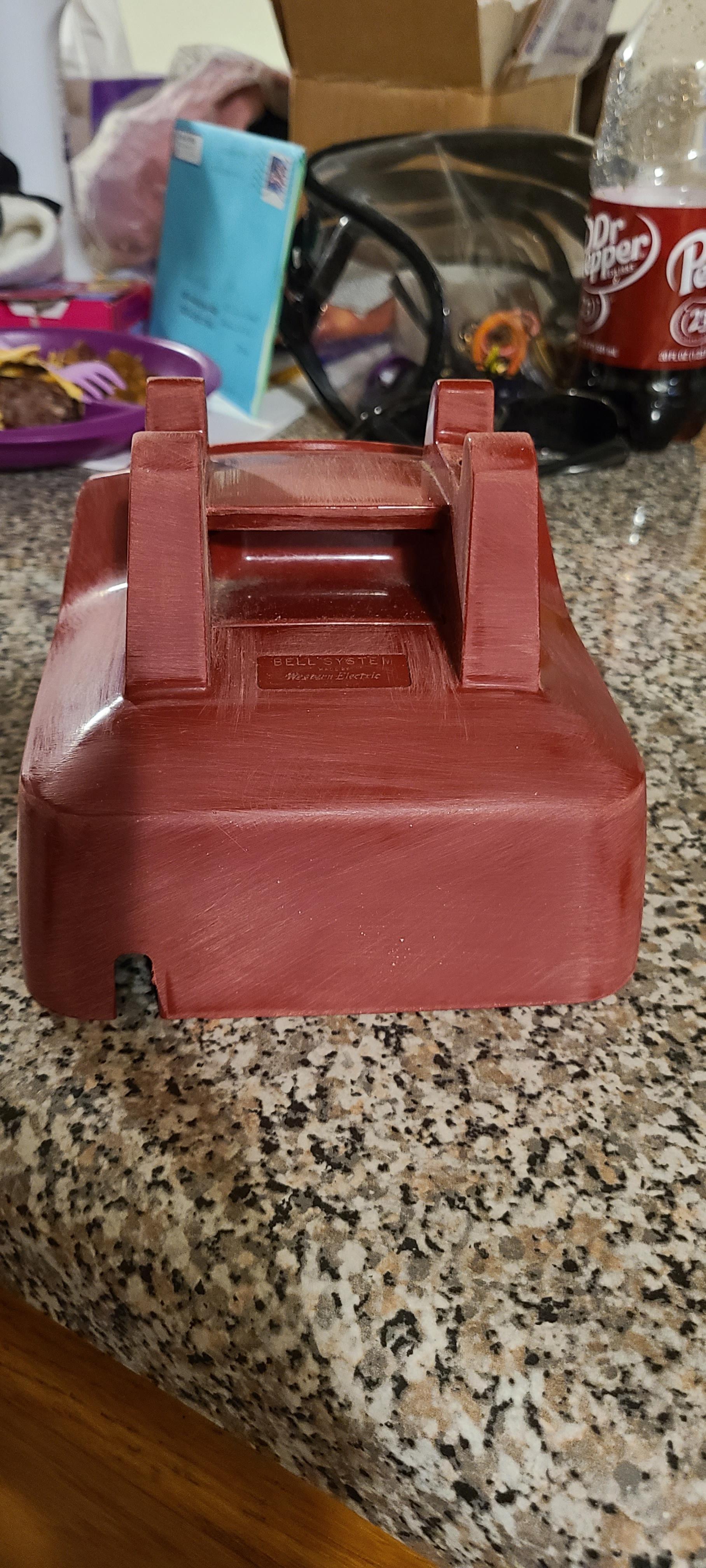

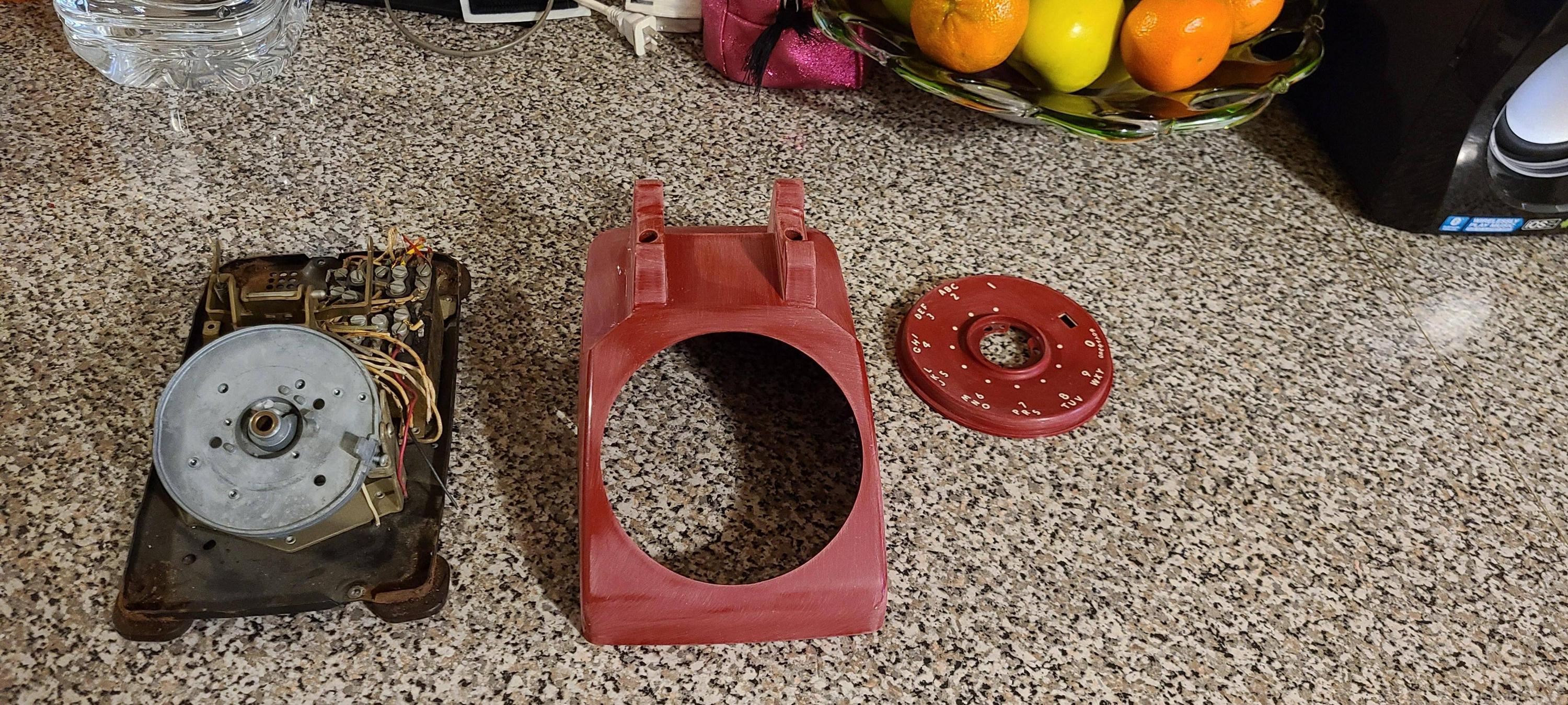

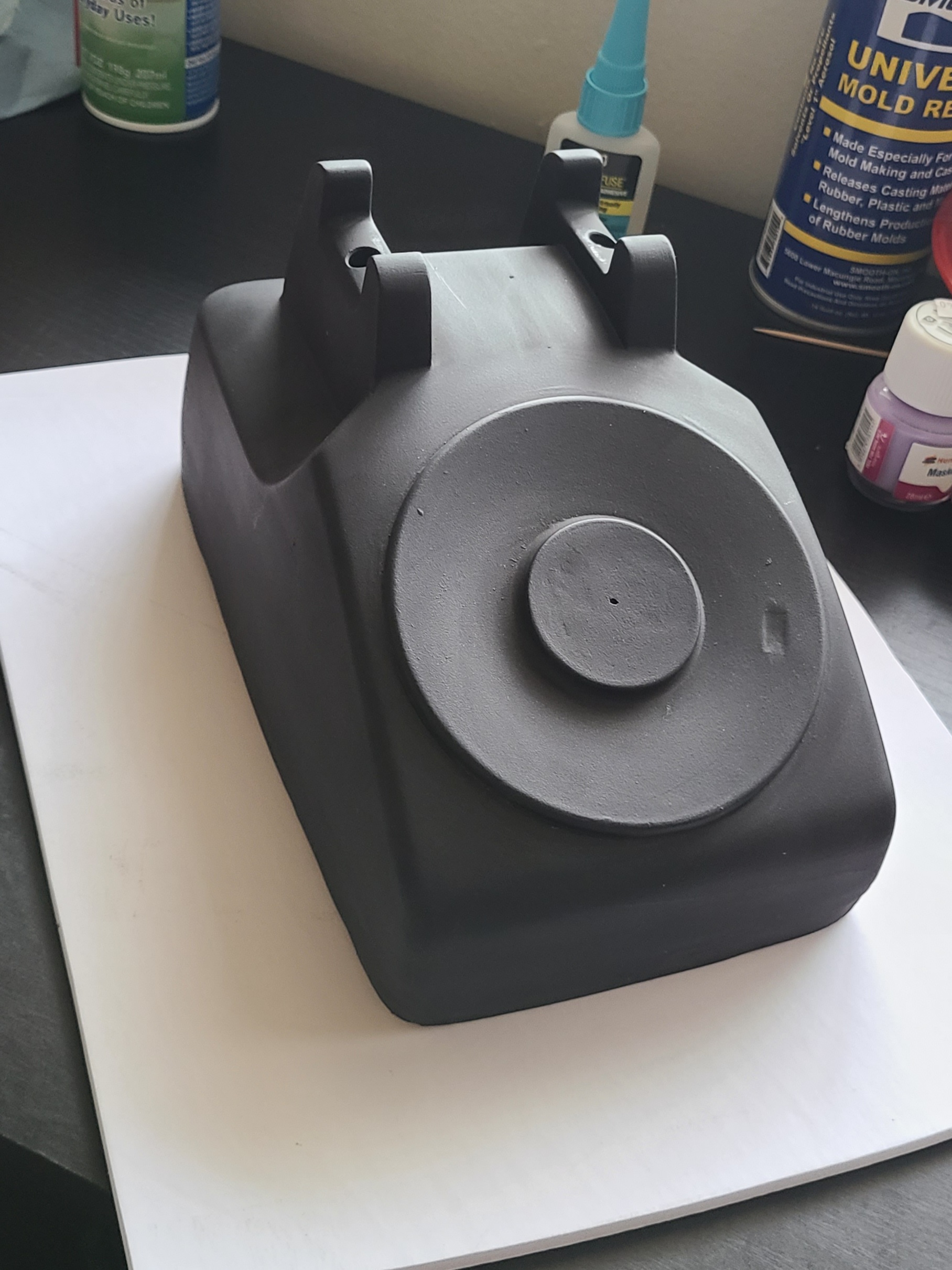

Took this apart last night and fiddled with it for a few hours..

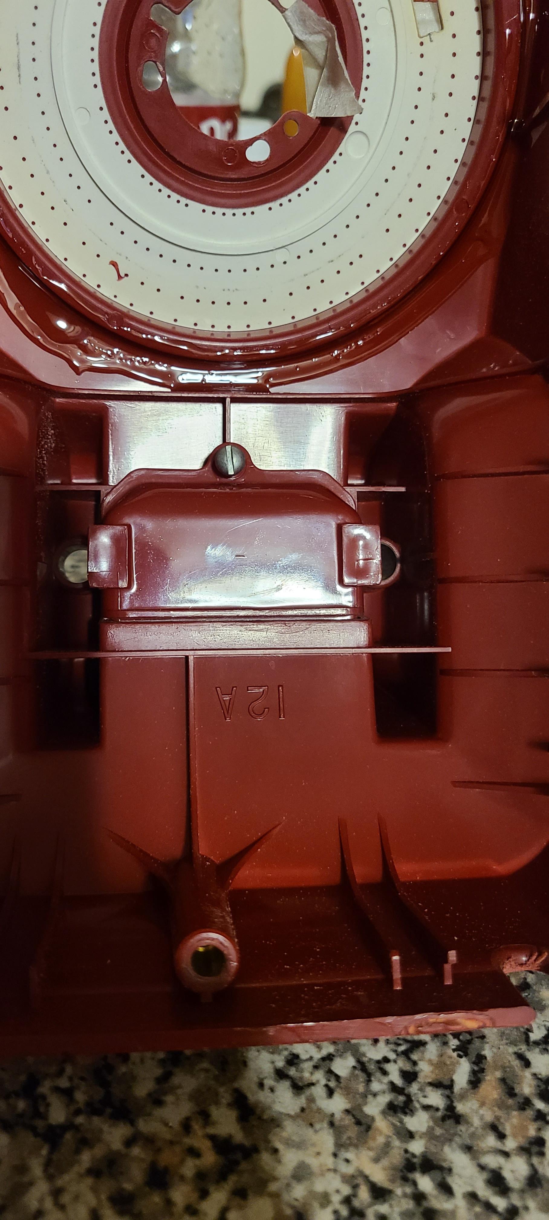

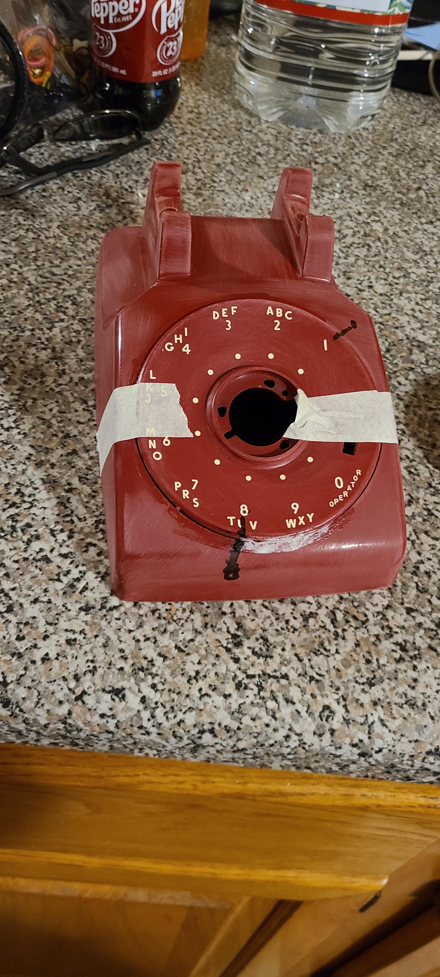

Removed and glued the rotary number disk section into the phone body, and after some viscous sanding, with 4 drops of superglue on top to hold it in the correct position and then sealed it with gorilla glue from the inside. There is a noticeable gap between the rotary disk and the rest of the phone body so that will have to be Bondo and sanded later to look like a smooth transition between the two parts. Then cut out a 1.5" disk from some 1/8" sintra plastic and centered a whole so i dont lose the middle for mounting the button later.

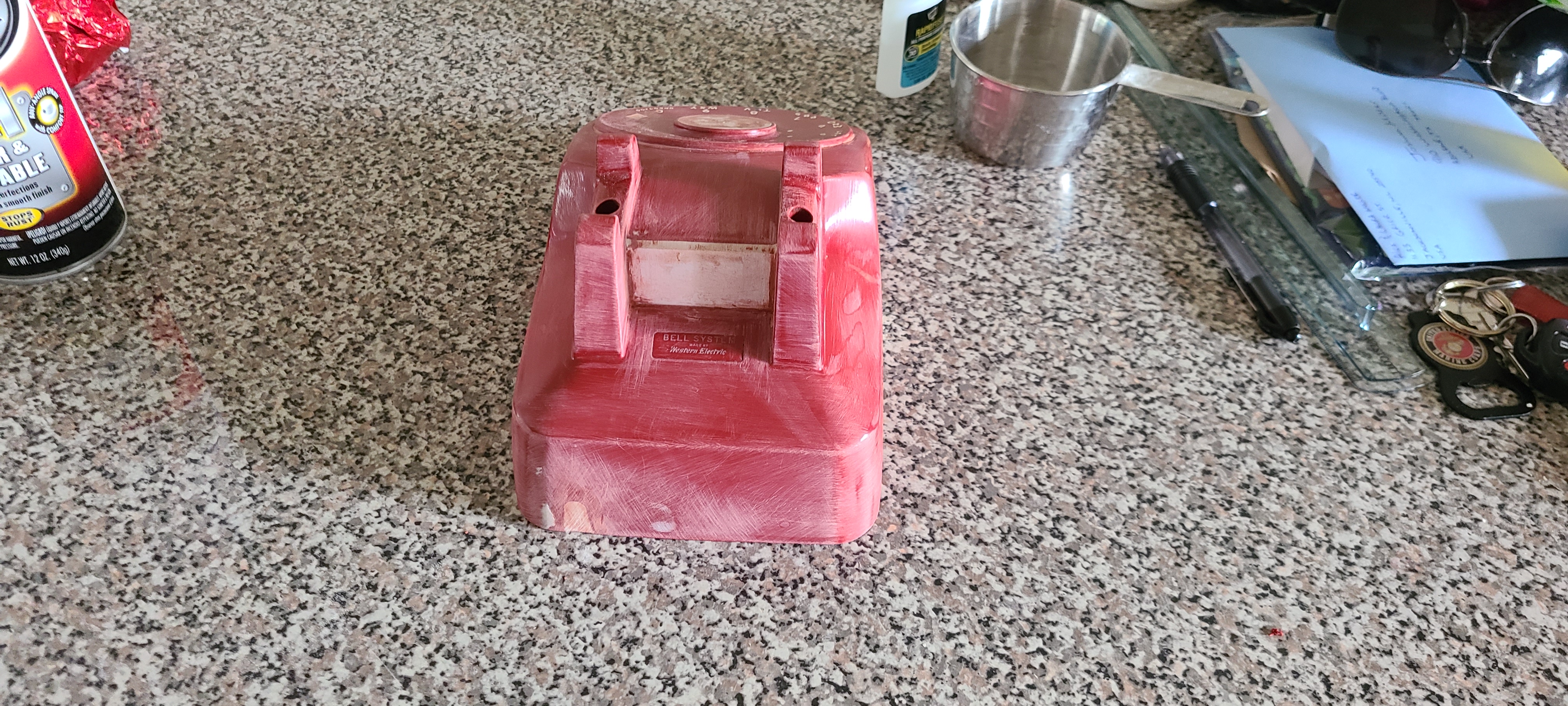

And after looking closer at reference images, you will notice that the phones backside doesn't feature the recessed area in the back like mine does, so that will have to be filled in. On my model all I did was remove a single screw from the inside that held in the curved panel that makes up that recessed area and I will install a piece of sintra there later to fill in the open hole.
PropReplicator2

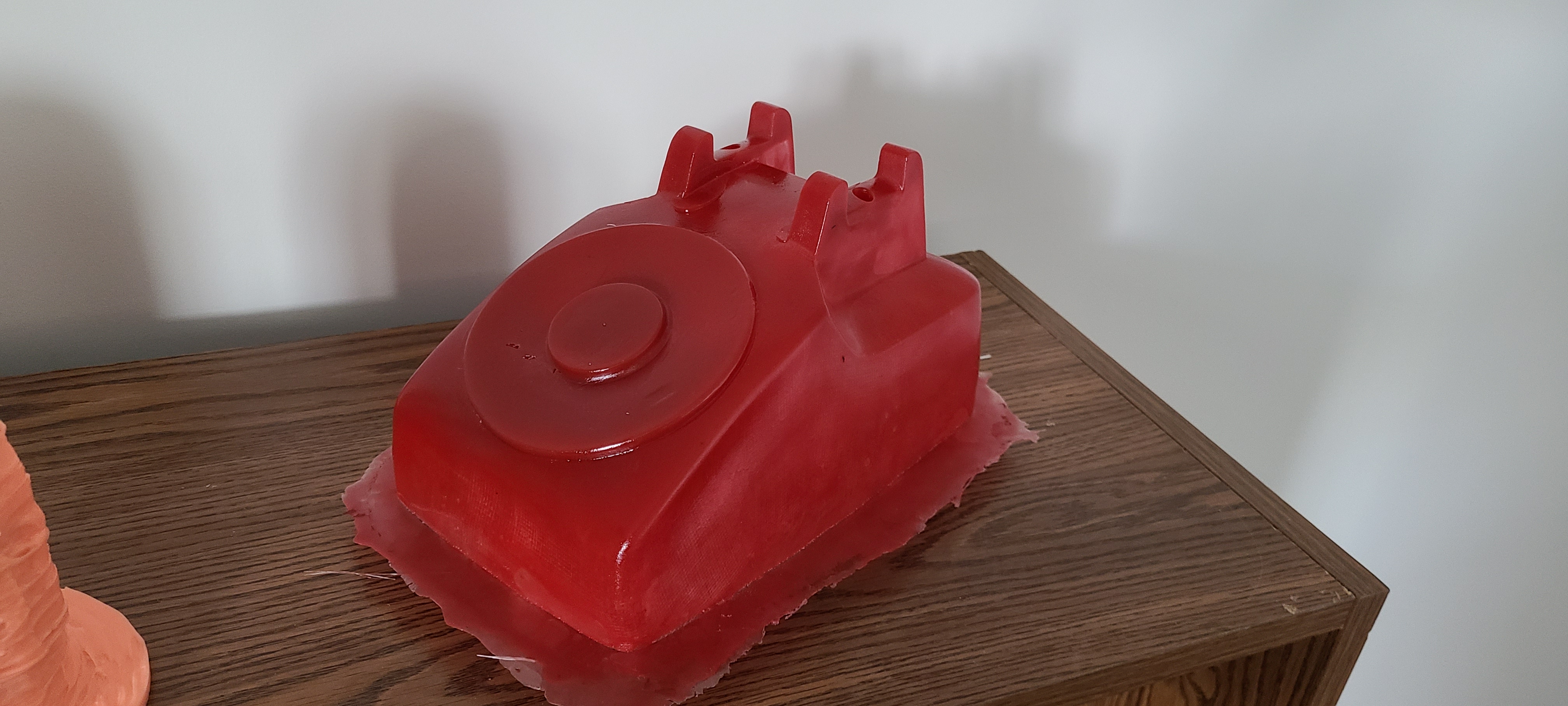

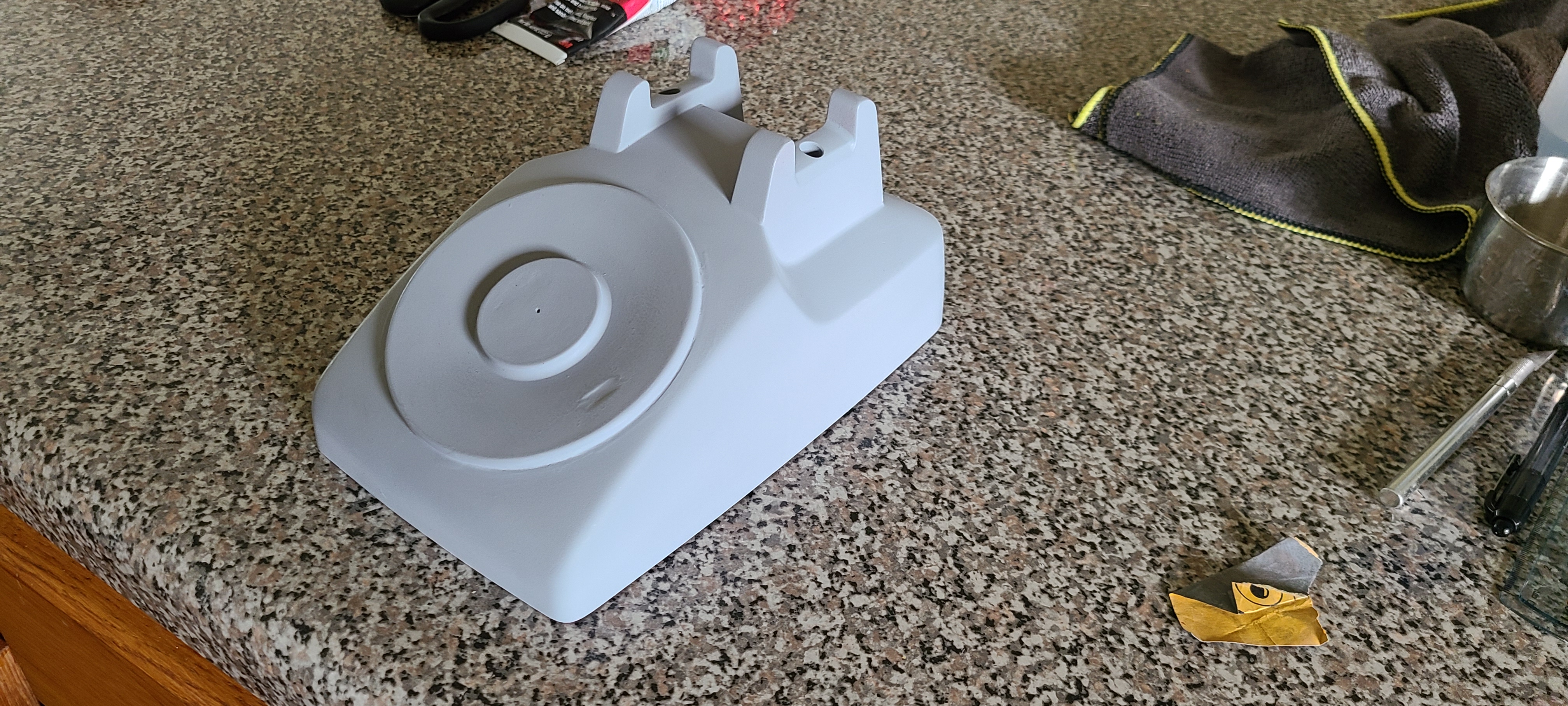

Now that the smaller details have been taken care of, it looks like roughly 22mm needs to be added to the height of the phone to match the height of the one on Bruce's desk. Will update here once the height is added!
