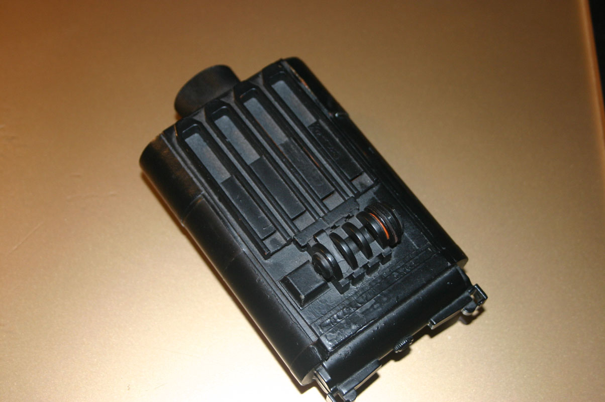

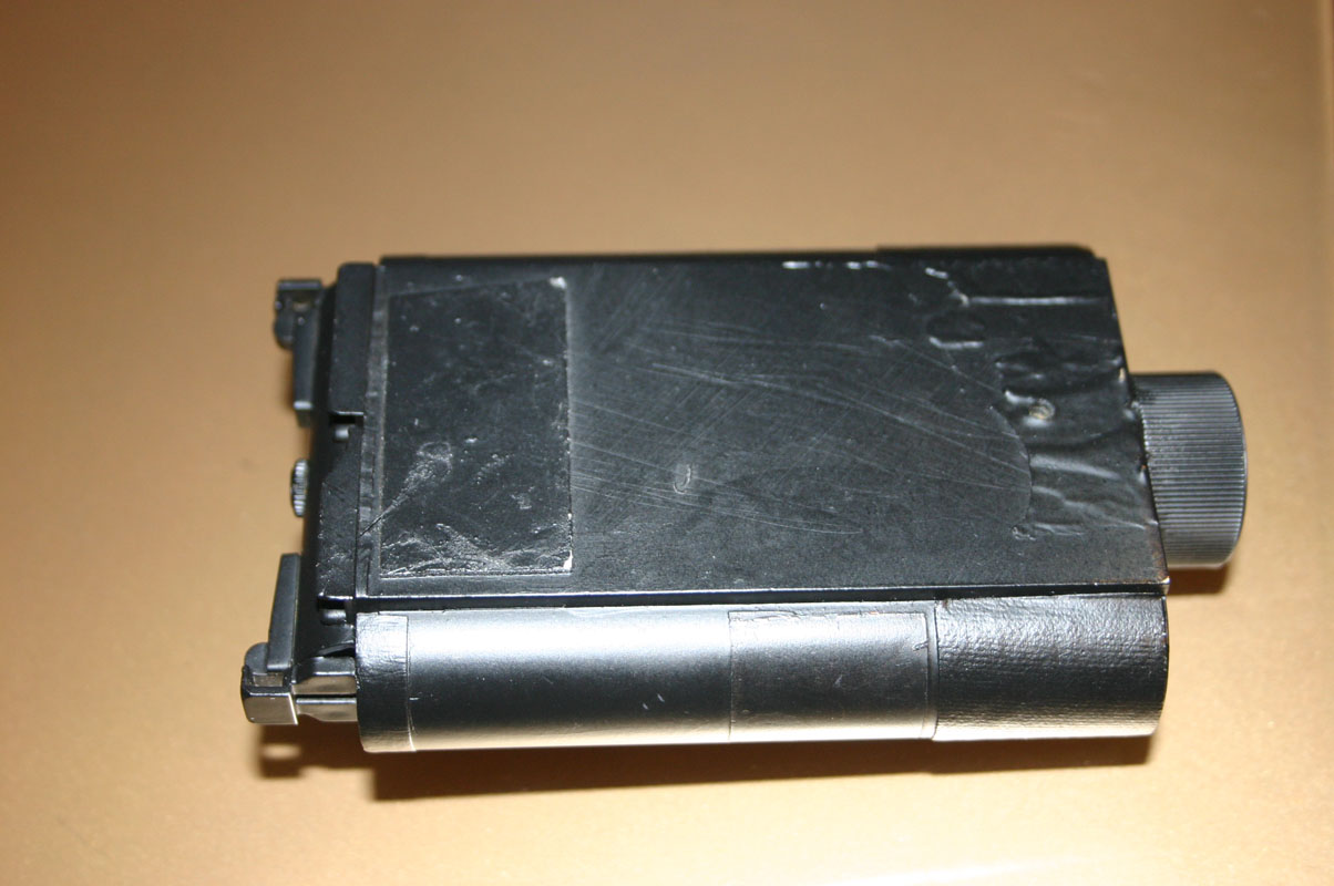

Maybe 15 years ago I saved photos of what was believed to be the base that the flip-top microphone had been attached to (the mic itself was gone) and if the thread still exists on the internet I can't find it. But I've still got the pics and have been doing my best to figure out how the flip-top would have looked/worked.

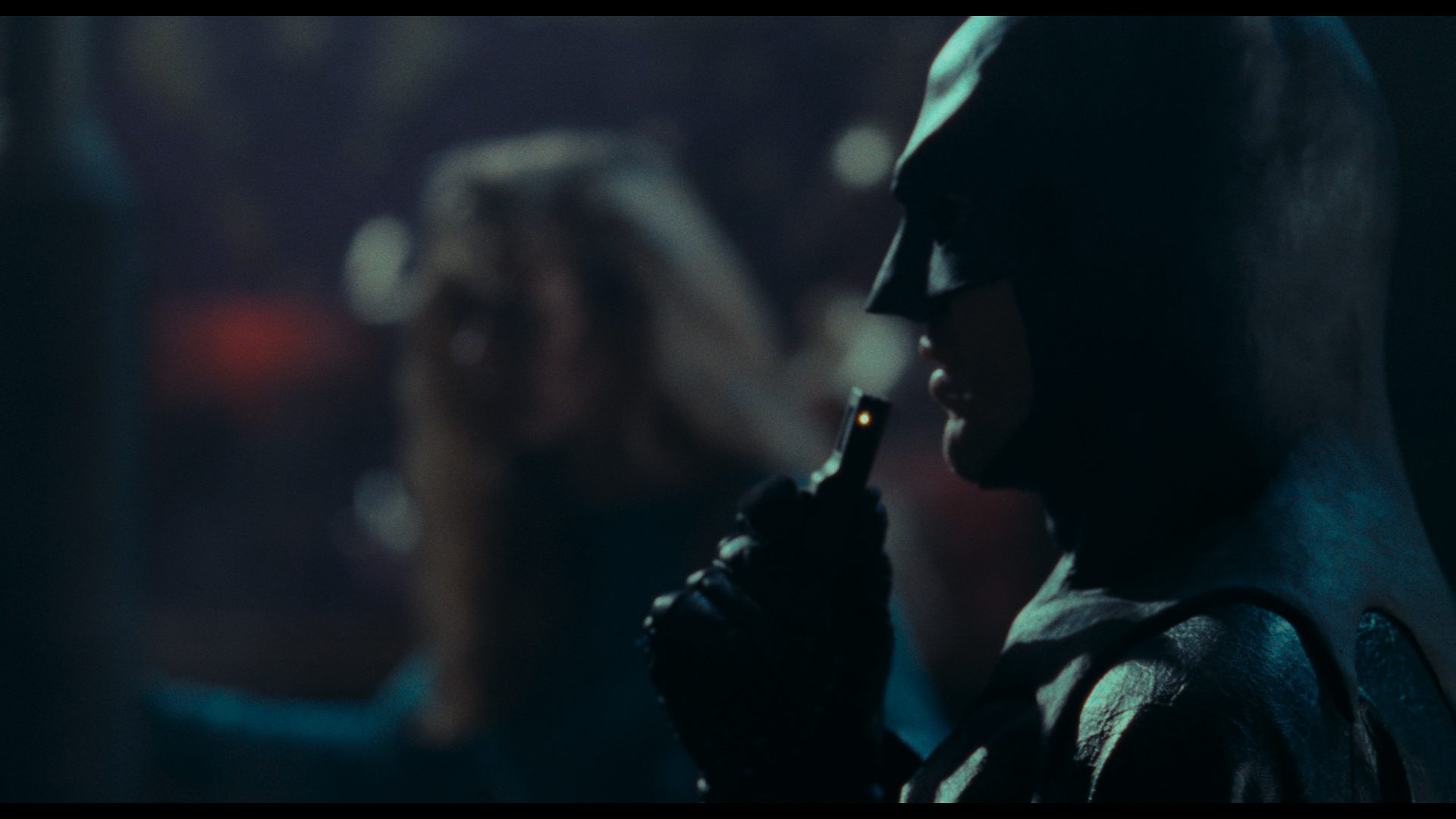

And of course there's the flip-up mic, where my only reference is the "Stop" shot in the movie, and this low-res montage of BTS pics:
Judging by the lack of a light on this side when he commands the Batmobile outside of Axis, it looks like they pulled a Spock for this scene and had him hold it backwards so the "interesting" side would face the camera. I'm working as best I can from the slightly out of focus and blown out screens, but I think I have the basic geometry of the mic down pretty close. The bar connecting the mic to the hinge pin is a total mystery so is mostly a placeholder right now, but there does appear to be a large tab on the side to aid in opening it. I was very pleasantly surprised to find that my estimated dimensions almost perfectly matched the existing base model and needed only the smallest adjustments to slot into it.

Does anyone have 4k caps of this shot? In FHD I can't tell if he's opening it up or just miming the action....

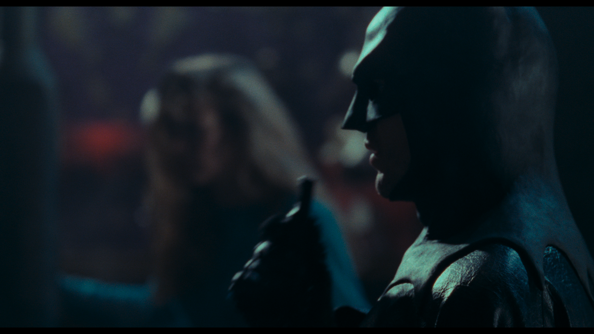

Its hard to tell on the 4k as well. But I was able to grab this shot in higher quality!
Edit, also looking at the shot in slow motion (and the way he's holding it) it does look like the base is wider but I think he has his index finger on a button that triggers the voice mode, as the light dims on when it gets closer to his face (as if he was pressing to activate)

Part of figuring out the flip-mic was placing my digital duplicate in his hand and working from there to match what can be seen. Based on higher quality screens with a hefty gamma boost, I saw that I had the remote slightly askew which had some knock-on effects on the mic's height and depth. But even with the rotation off it looks like I still had the remote scaled correctly! Don't ask me how, I think it was just luck.
But I've fixed the rotation & mic dimensions and now... check this out:
The battery housing top & bottom align perfectly, the c-channel lines up, and his index finger is on the button. I had a really, really good feeling about this prop all those years ago, and it's genuinely exciting to see it appear to be the real deal. I am so pumped!
Does this mean that the gas mask is the only '89 gadget that doesn't have an acceptable replica floating about?
Oh, and better quality version of the flip shot shows that his left hand doesn't flip open the top. He snaps it open with his right thumb or it's sprung to open and his right thumb is just holding it down till the right time. I'd bet on the former... but considering how unorthodox so many of this movie's props are, I wouldn't put too much money on that bet. :)

So, this doesn't feel like a scratch-built object. It feels like it was something they modded. Like a photography battery pack or something? You can see artifacts of tape that was likely covering labels before this cast was made. Thoughts?
I'm on the fence about this. We see so little of this in blurry blow ups, I'm not sure it is the actual item. I acknowledge that the other replicas out there are guess work (and probably wrong), but I feel this isn't anymore concrete. It's an interesting direction, I'm not saying it's wrong, but I think we'll never know for sure (unless a collector that has it and has been hiding it away comes forward).
Still a cool project.
I think it’s just something that never got used on screen. I don’t think it’s the Batmobile communicator. What we can see of what he holds looks nothing like this thing. This looks like some weird thing they were using for fabrication purposes that never got fully realized.
