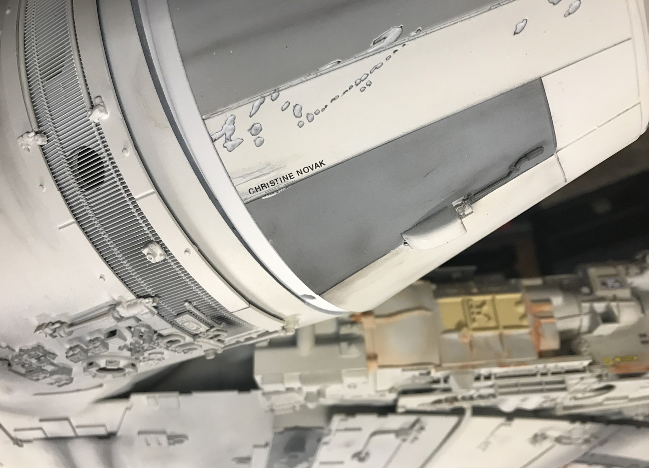

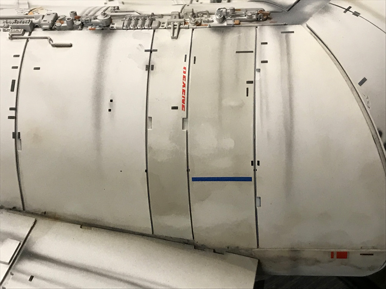

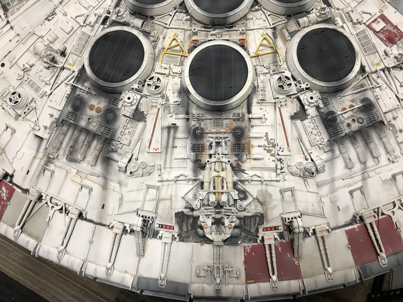

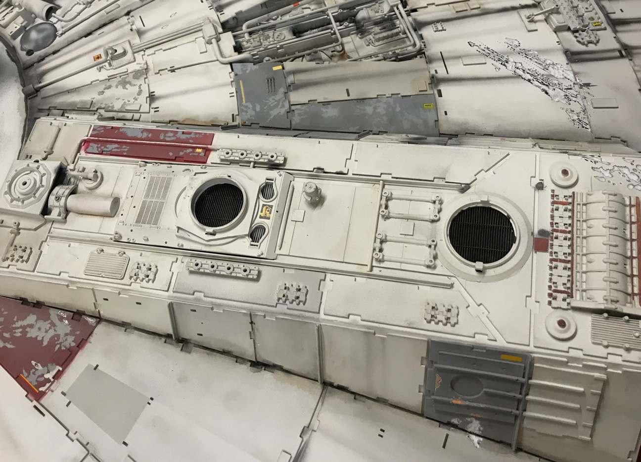

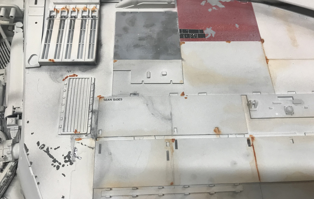

Here's a few updates with the decals applied. Almost all needed decals are now down on the top/sides. The sharp eyed crowd out there will see just a couple missing that I'm working on getting. Overall, it's awesome to see some of the original decals restored here. HUGE Thanks to Craig Underwood and Mike Reis for hooking me up with some key decals! Still have a bunch to do on the underside, but she's getting there.
It's stunning how the smaller details just add to the effect - it's like there's an inverse correlation between the scale of added detail and the impact of the overall effect in making the model 'pop' and come to life.

Thanks very much! It's amazing how much detailing is still left to do (small weathering and such), and I still have to get back to the bottom, add all the little rectangles and more washes and weathering, and all the decals under there....Every time I think I'm almost done... More and more...

Like these? :)
I put mine down where Joe Johnston's went, and Mary Lind's spot has my Wife! (She's a Saint, so she deserves this spot!)
I plan to replace the original model builder names with a few folks that have been key to this project.

The KEY to getting the overall warm color though is creating transparent layers, primarily lightly coating everything with Floquil Grime, heavier and lighter in appropriate places, then accenting with some other 'filters', like thinned down grays/gray-browns, etc. The red was using Floquil Reds, but needing to 'customize' them until the right hue was achieved. When this thing is all done, I'll get it professionally photographed, as the iPhone pics are always way off than the actual color of my replica.
