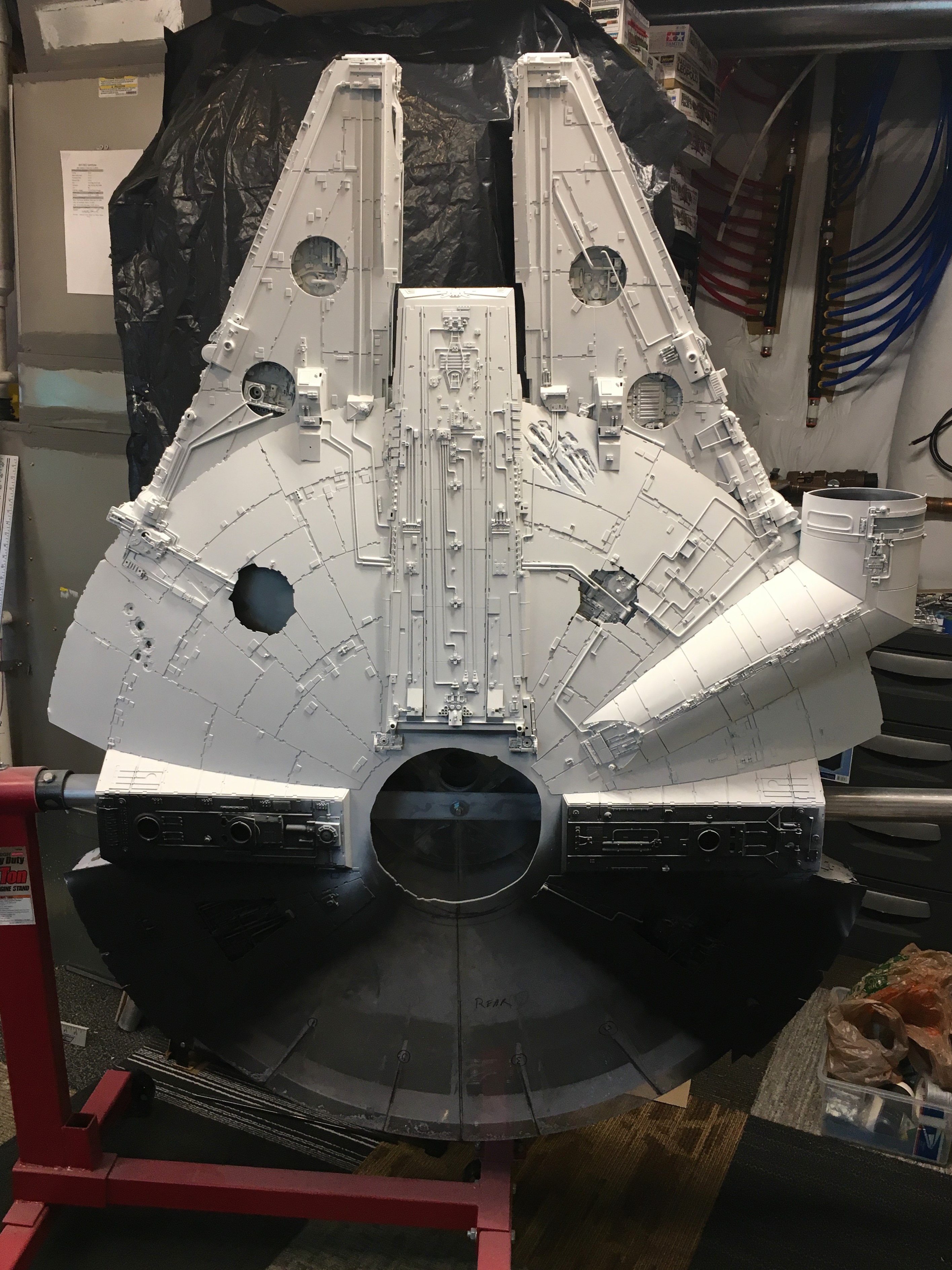

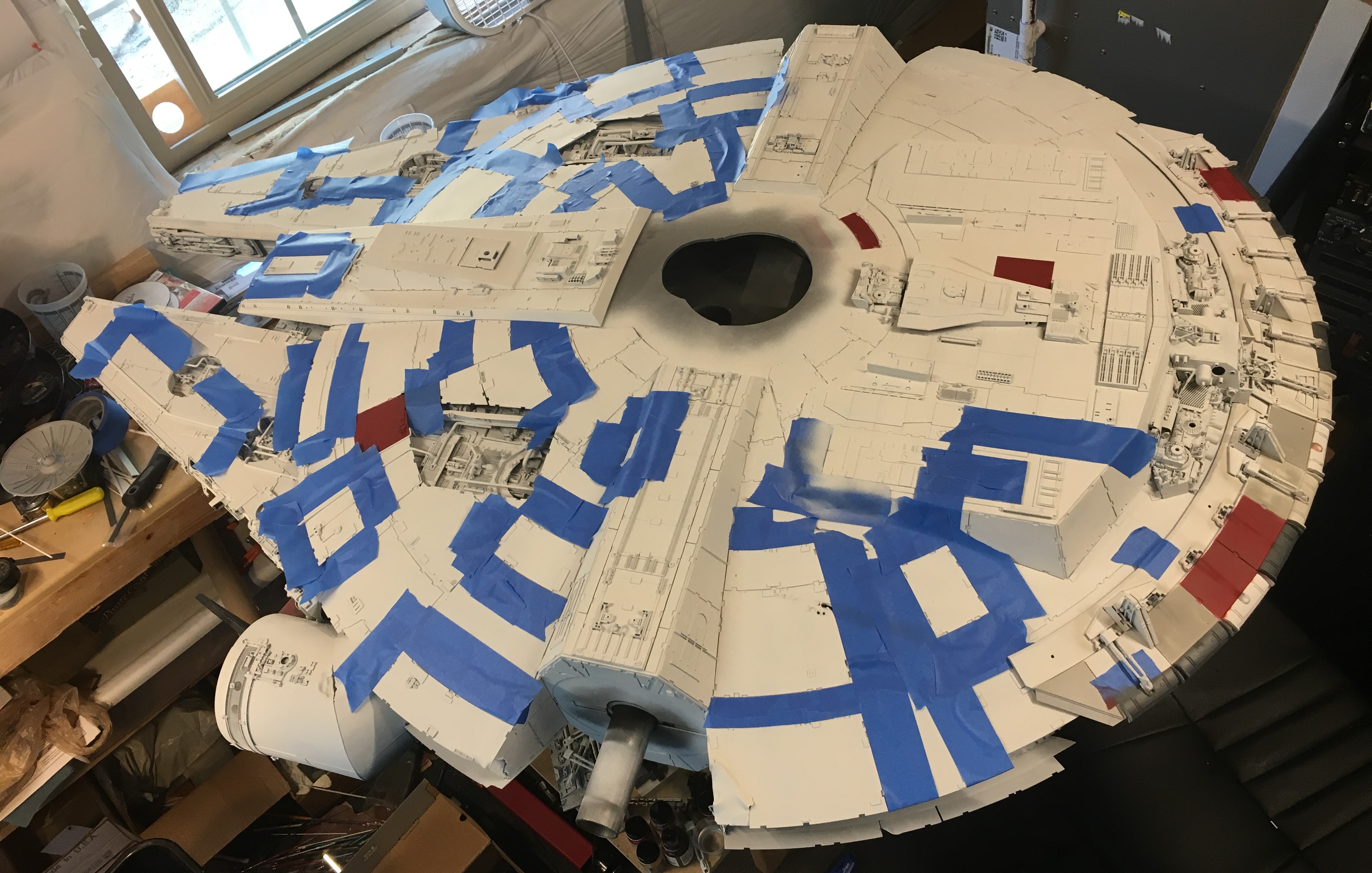

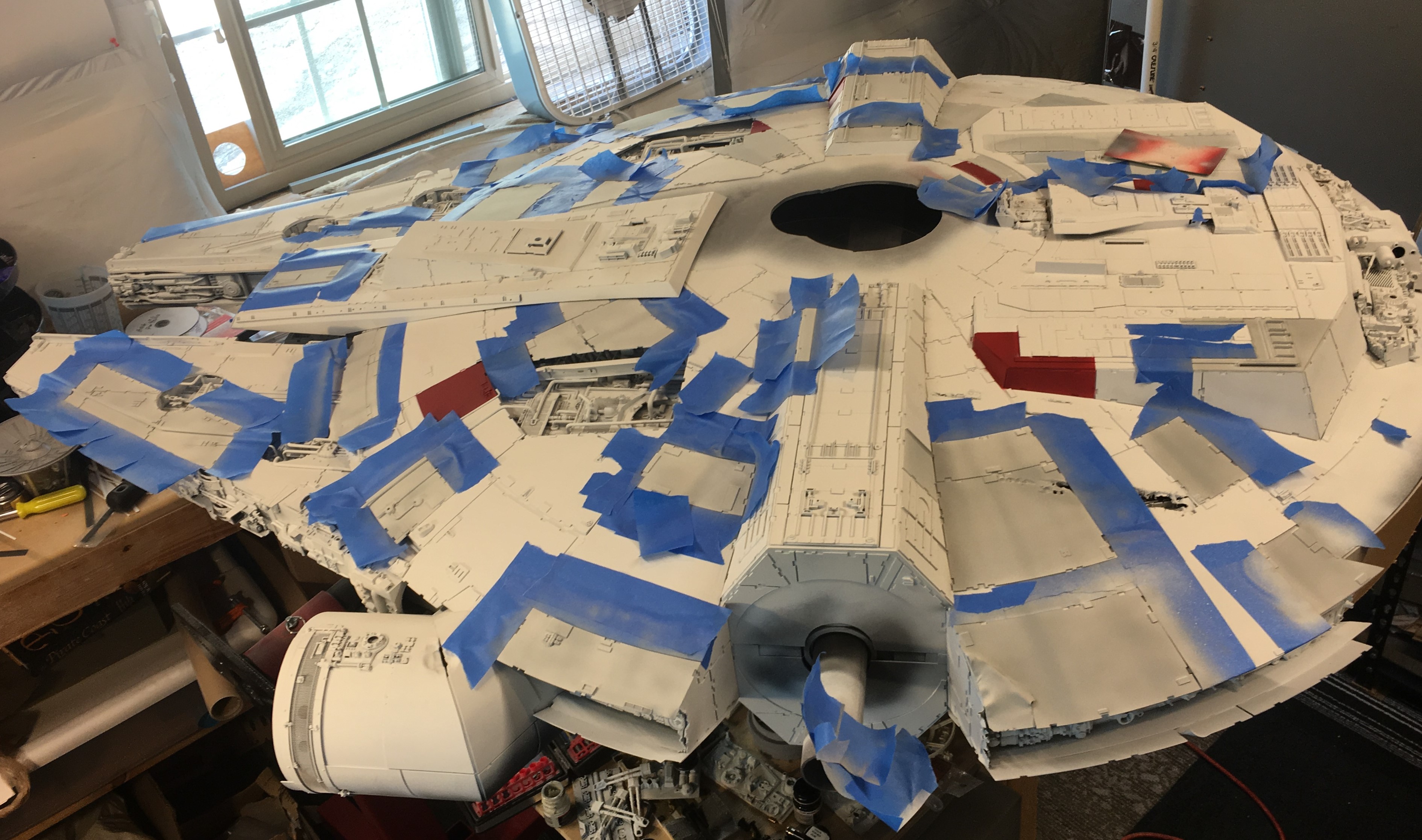

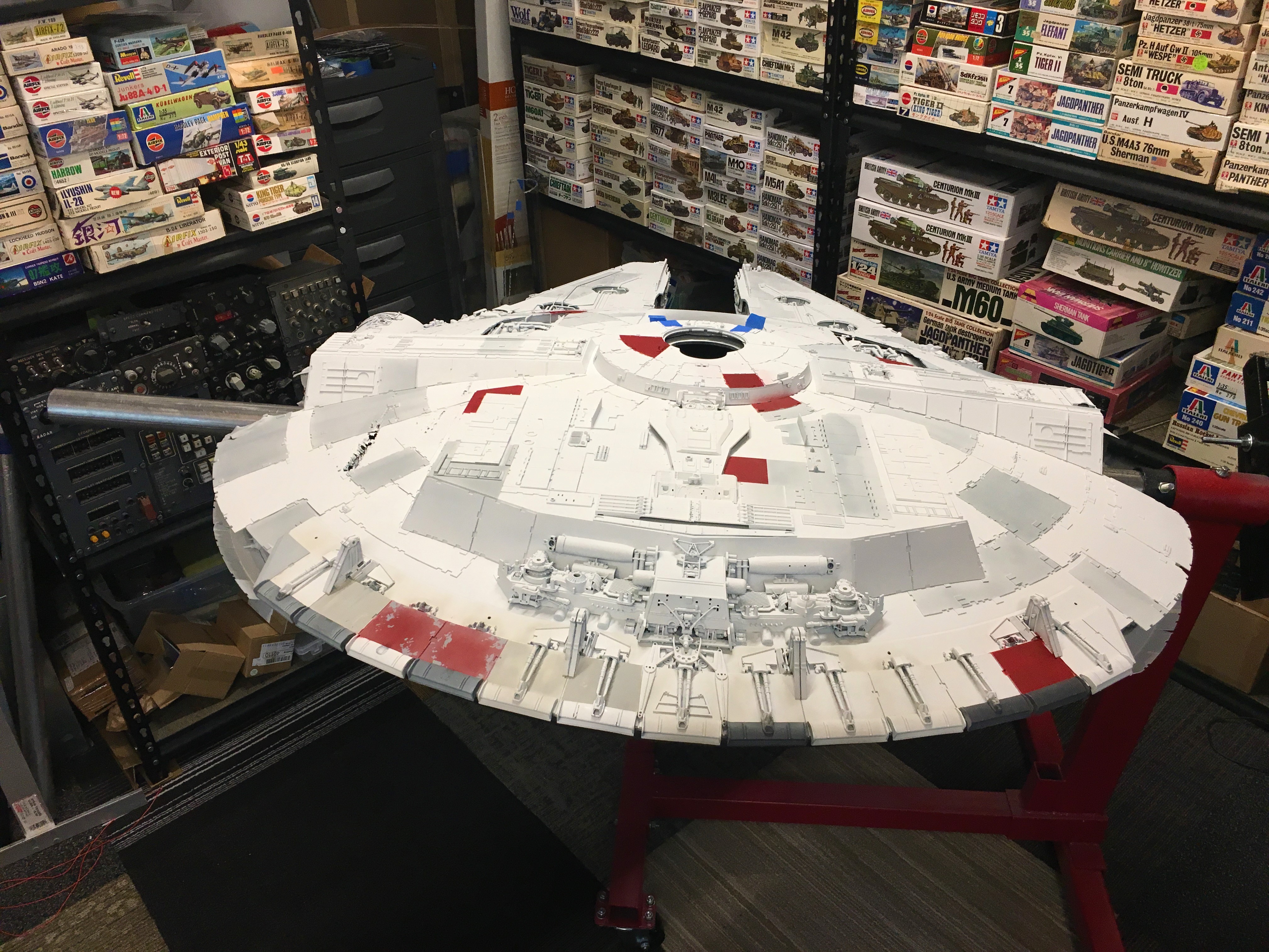

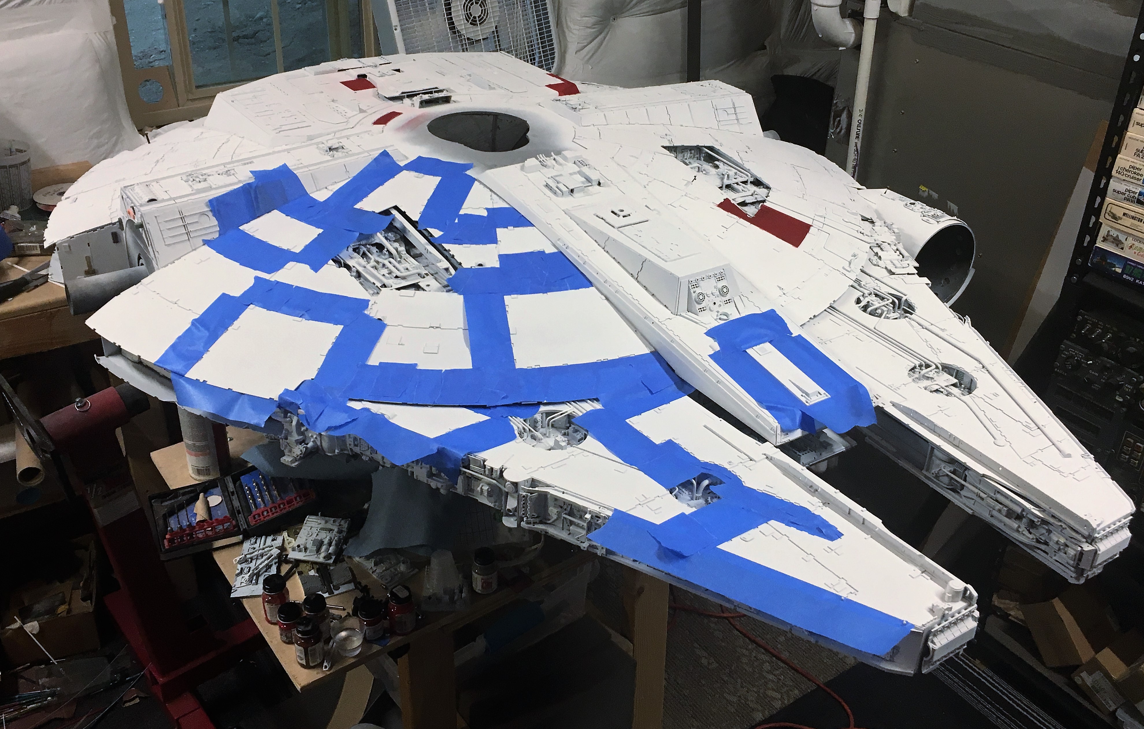

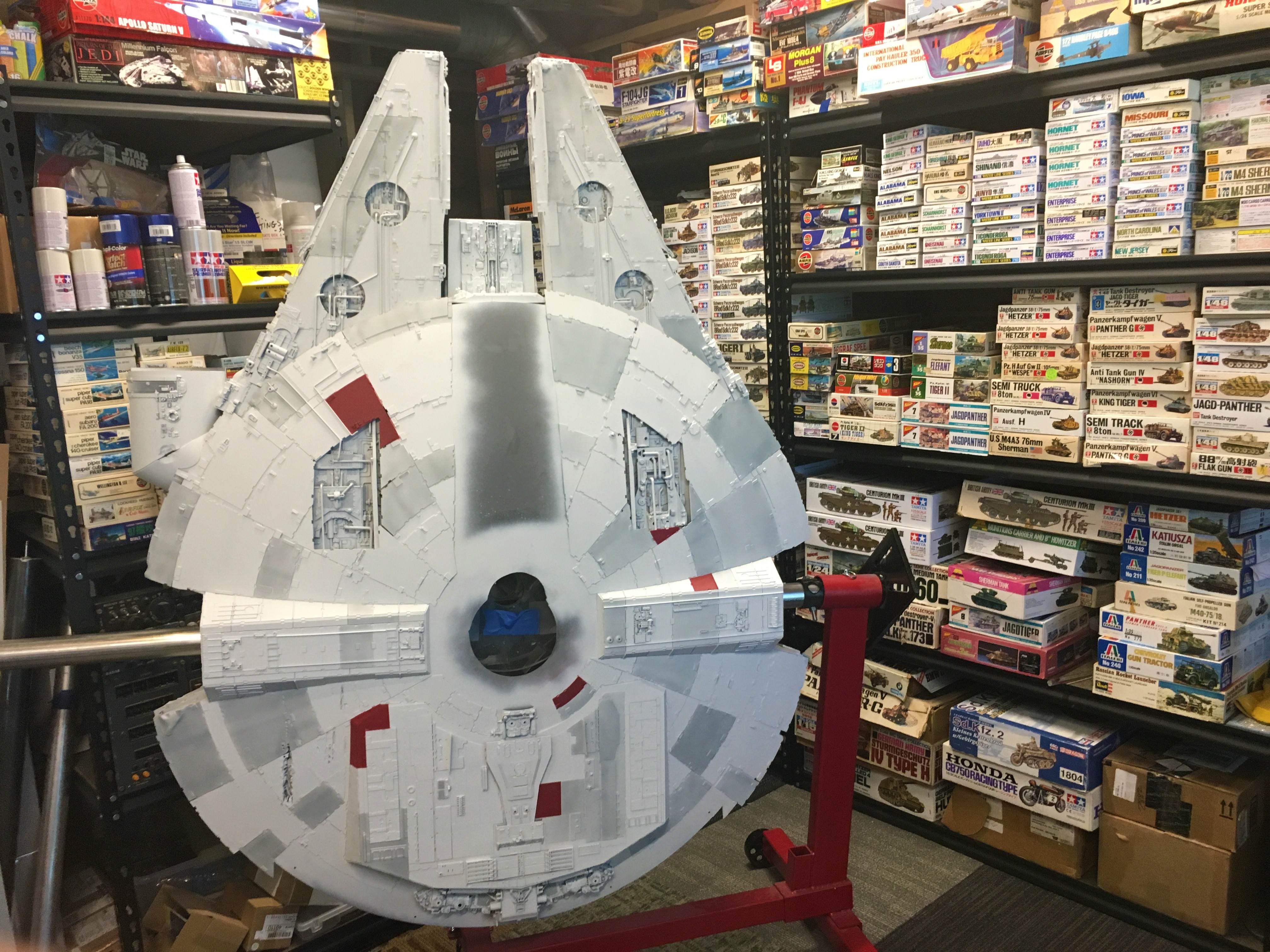

Thanks again guys!! Here's the latest. Started off masking the underside and starting to shoot some of the panels. The contrast looks high right now, but they will blend together as I add the multiple filters and thinned layers. If they started off too light, then they'd blend in, easier this way to soften them up. I started trying out the initial filter/weathering on the left half of the underside engine deck plate. That's only about half the filters, still needs the thinned gray and dirtiness added, but you can see how just the light filter knocks down the contrast compared to the other side.

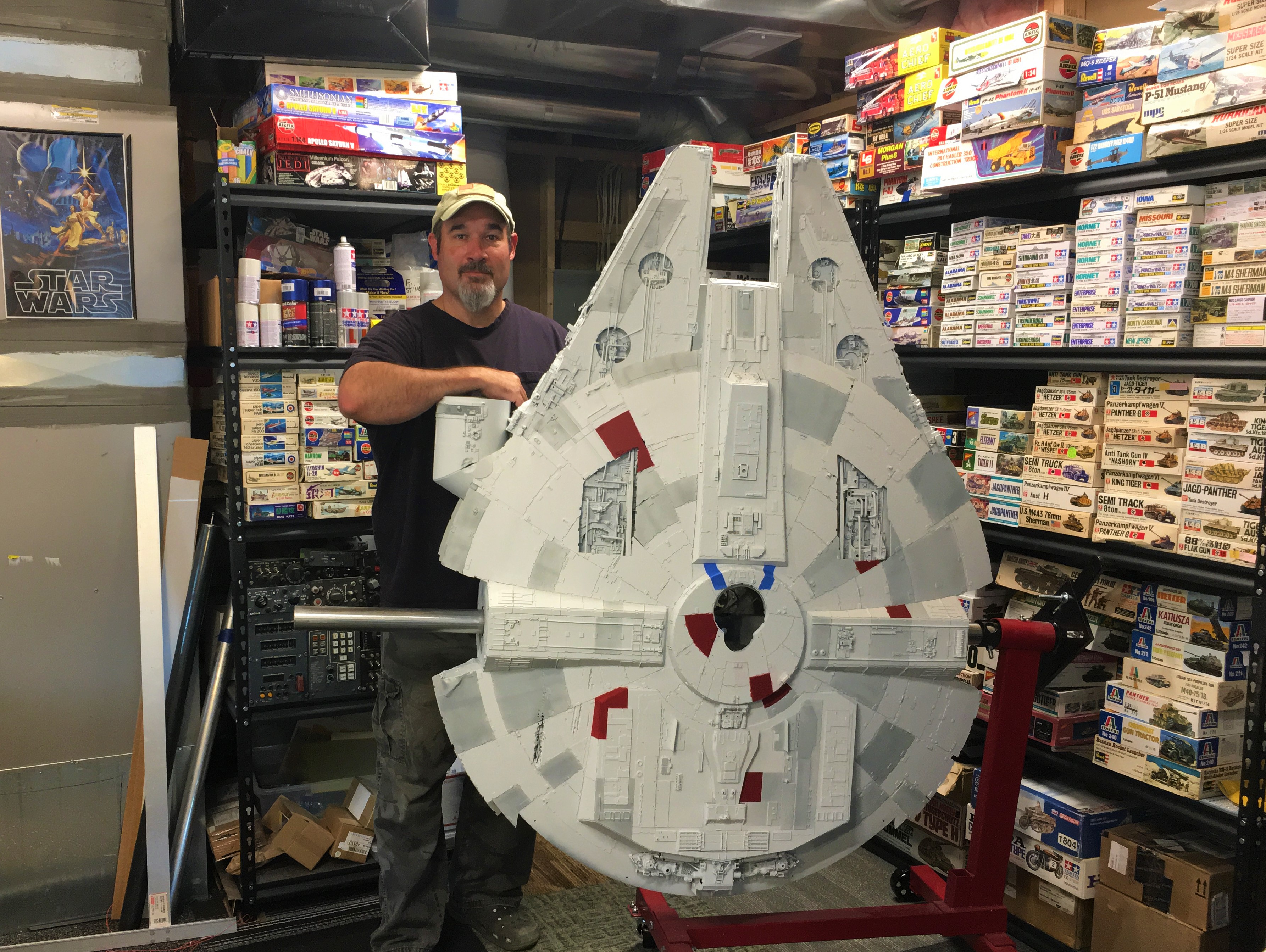

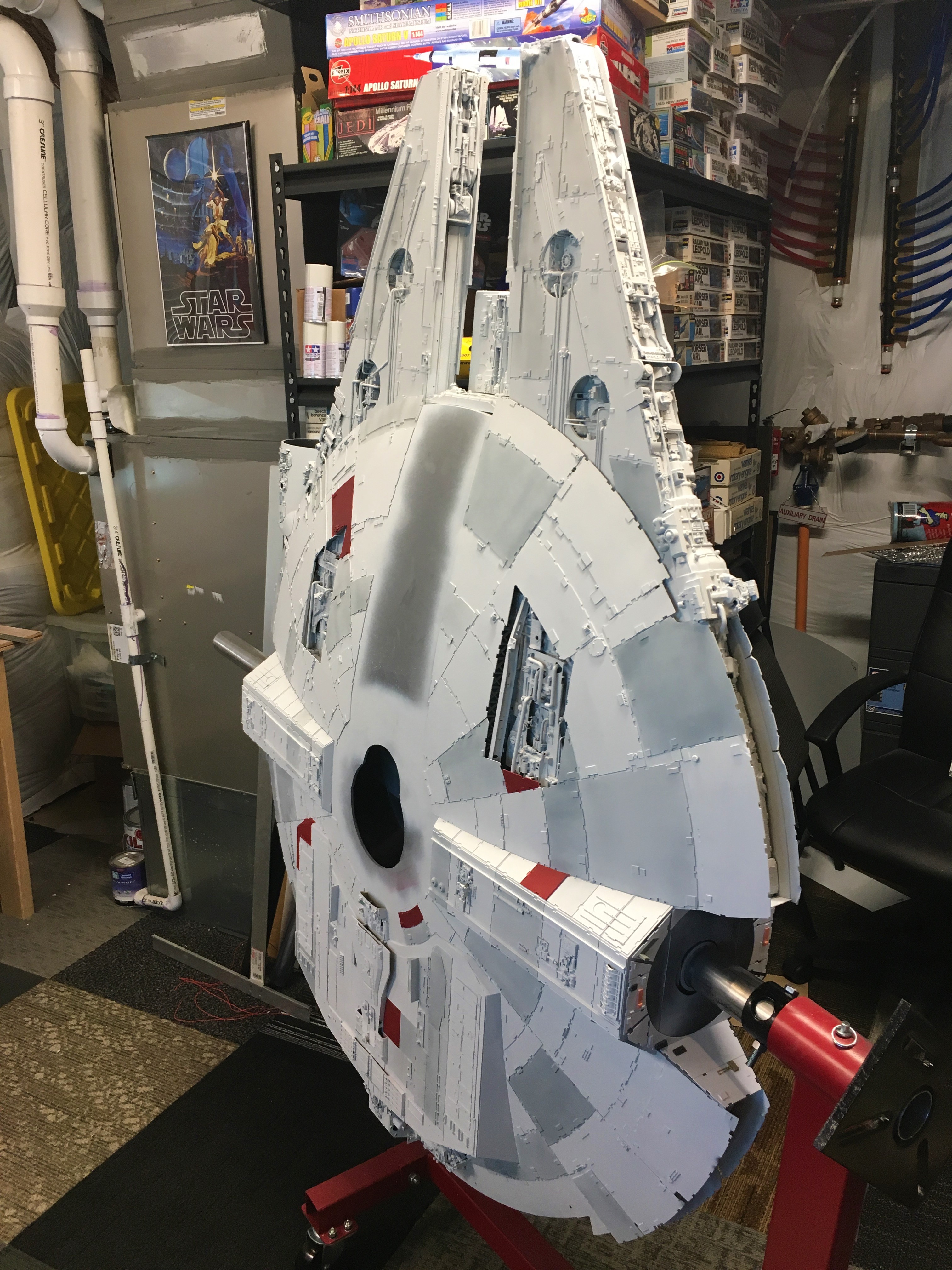

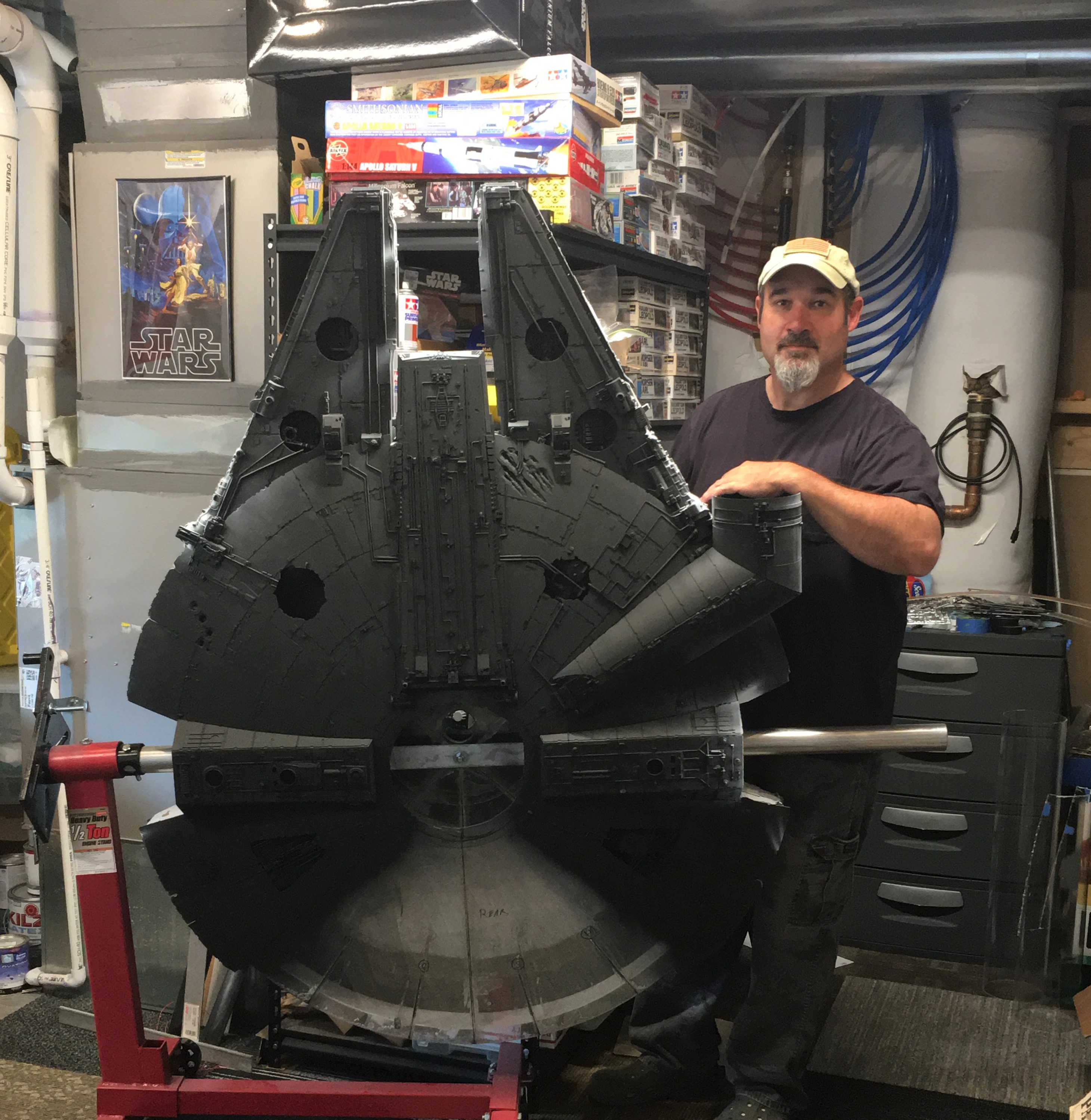

Then, to make the painting easier, got help from a buddy and we setup the model on an engine stand (Lee Malone did this on his gorgeous 5 footer, and it makes things so easier. I can rotate it 180 degrees to make access easier from a number of angles.
Lastly, a couple shots standing next to it to get a sense of size and scale of this monster! So friggin' big!
Thanks for looking!
Sean
Masking the lower hull for the light gray panels (red panels already painted down)
Starting the gray
Model on engine stand for easier access/rotation.
Initial weathering on the engine plate (notice the darker panels on the far right without the first 'filter'.
Here's the top and bottom for scale

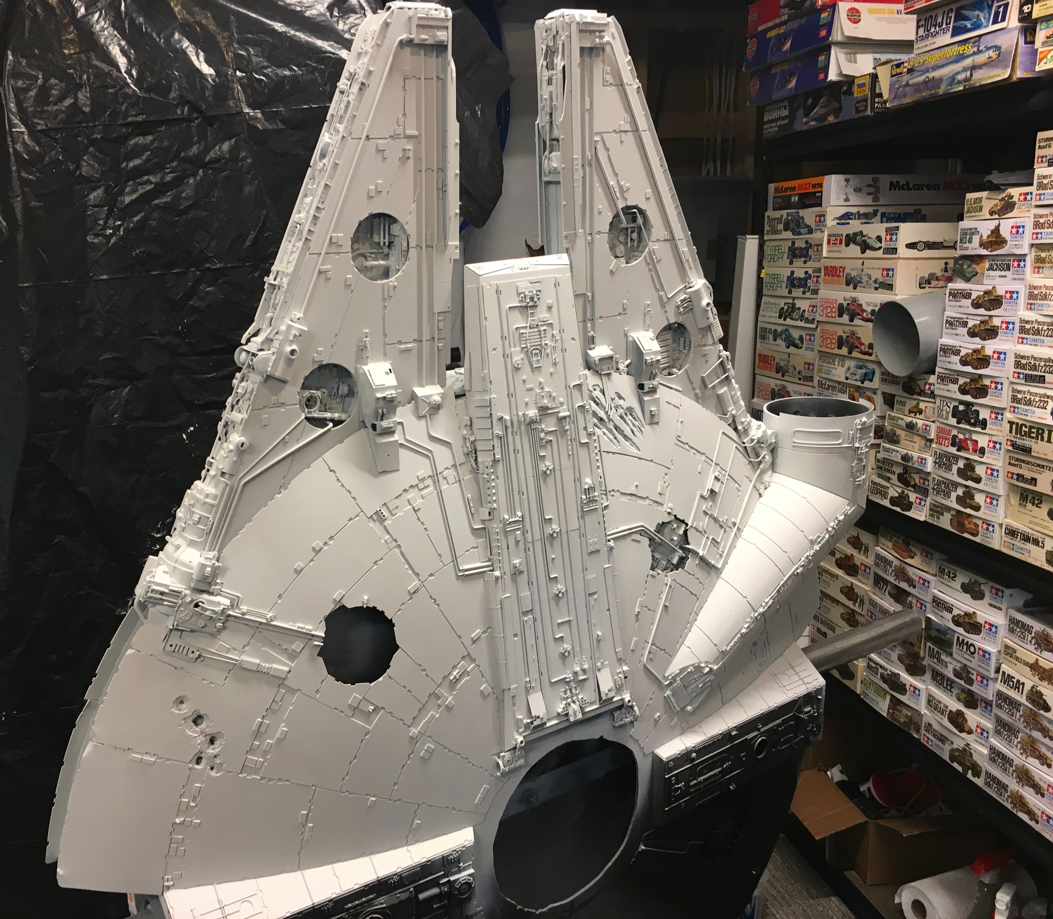

And the beginning of the base coat on the front half of the top is where we are at.

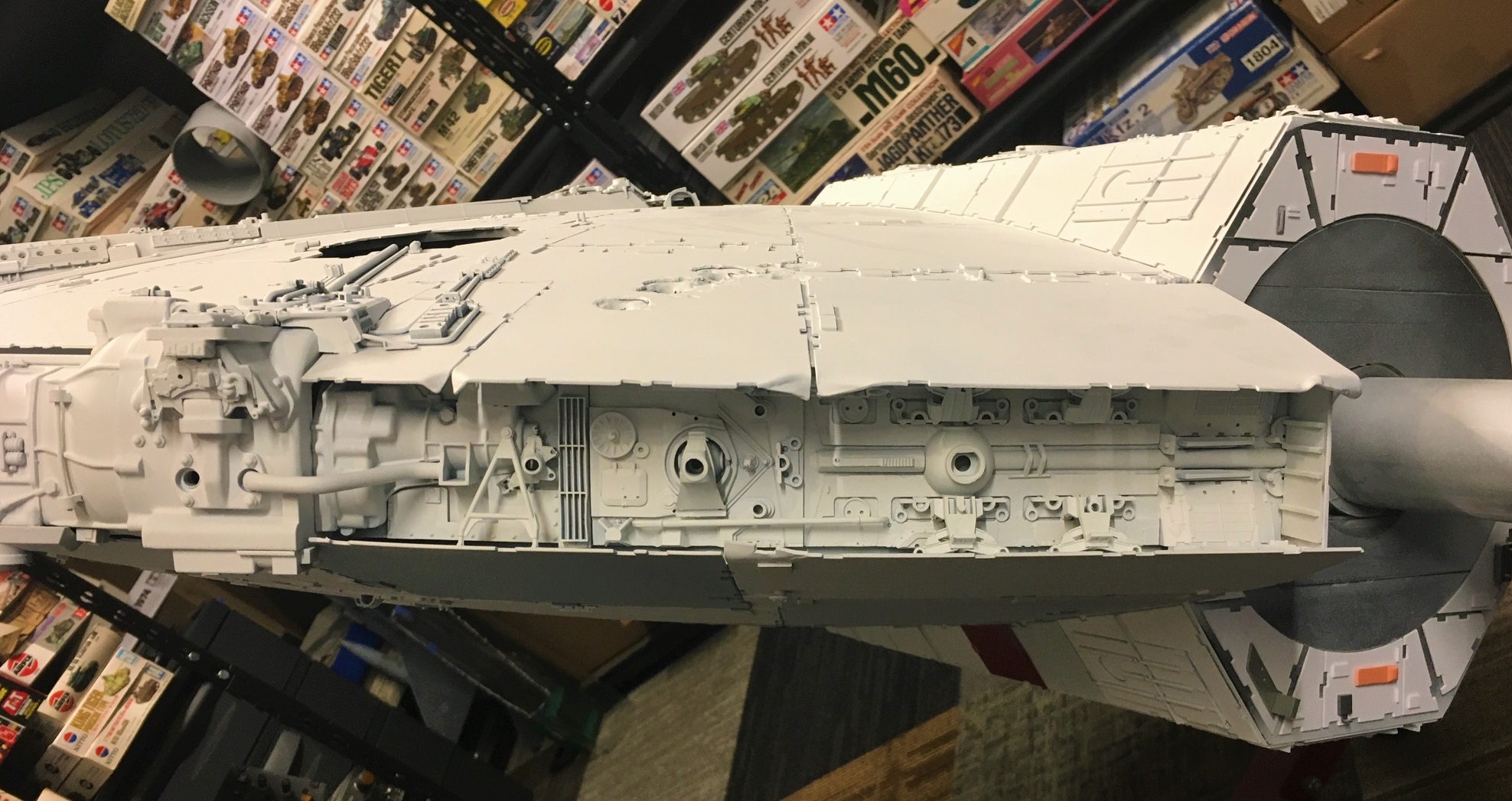

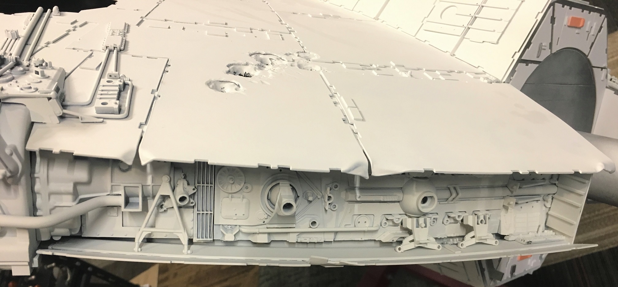

Here's a quick update.

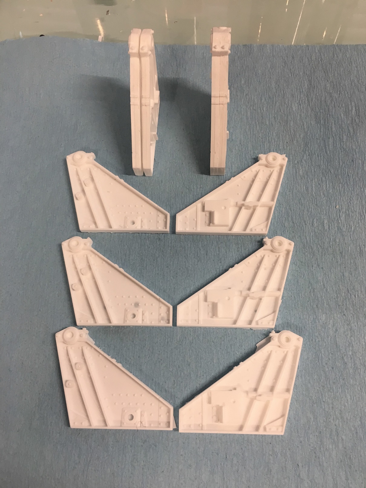

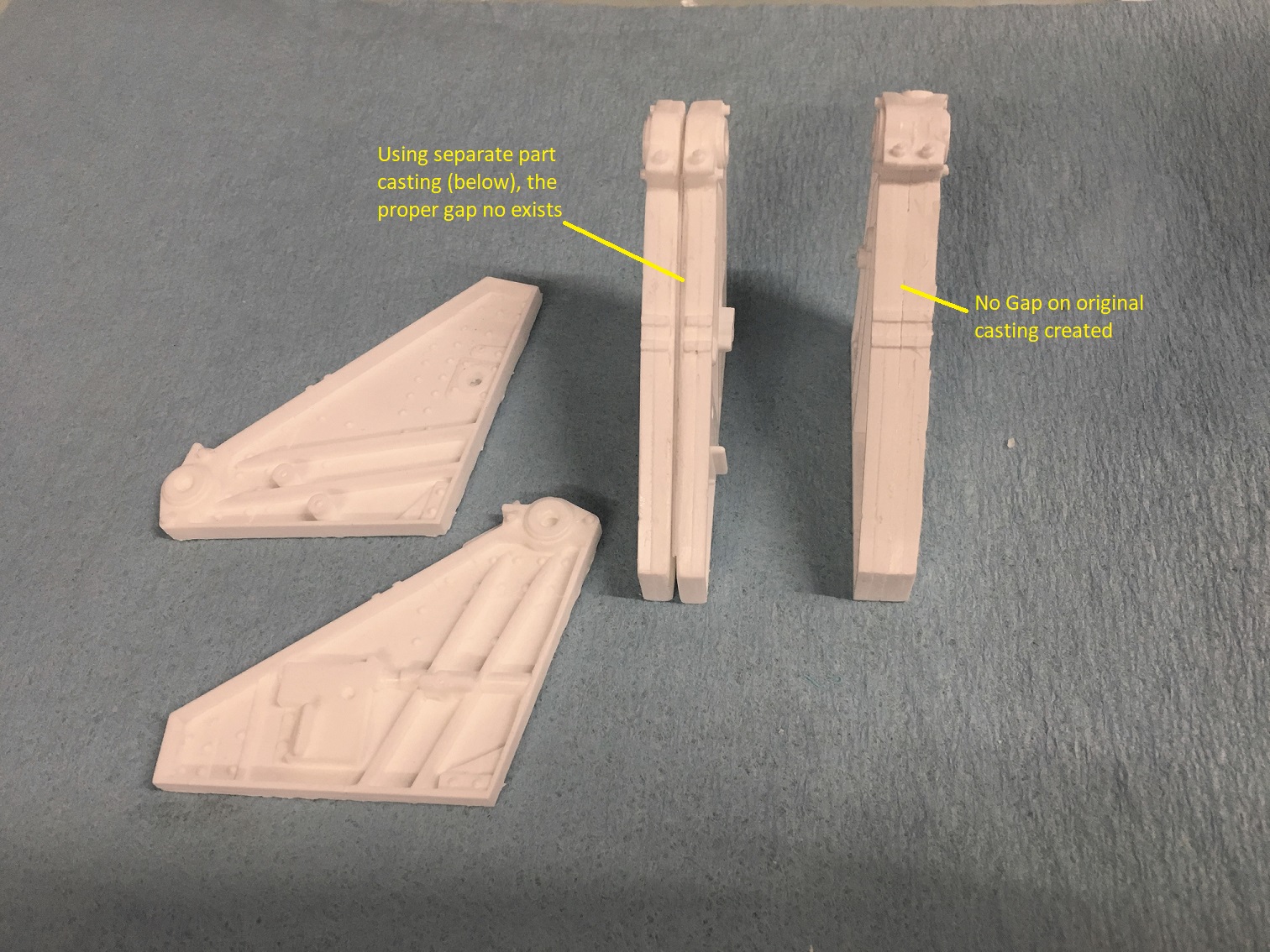

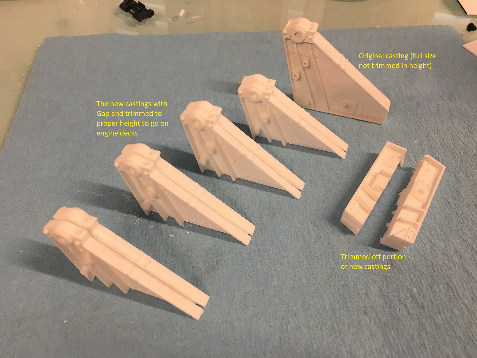

1st few show the Hummel Part that goes on the engine upper and lower 'decks'. I originally took the two Hummel parts, glued them together and cast them. As I was getting ready to paint them, I realized the original had a pretty good little gap between them. So, I was able to break the original parts back to their two halves. I then molded and cast them up, put a .020 piece of styrene between them, and assembled each individually. Then, to match the original, they required a good chunk of the bottom be chopped off, to get the proper size/height to fit into the 88mm parts. It was a fun exercise getting those levels of details closer to the original.

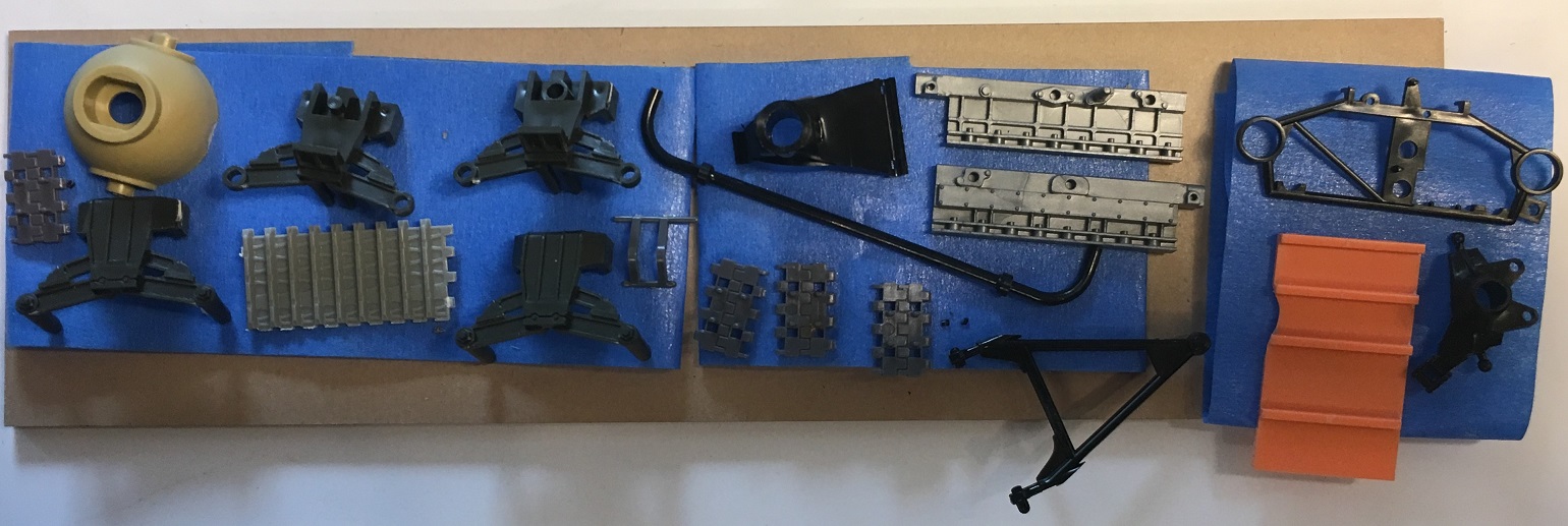

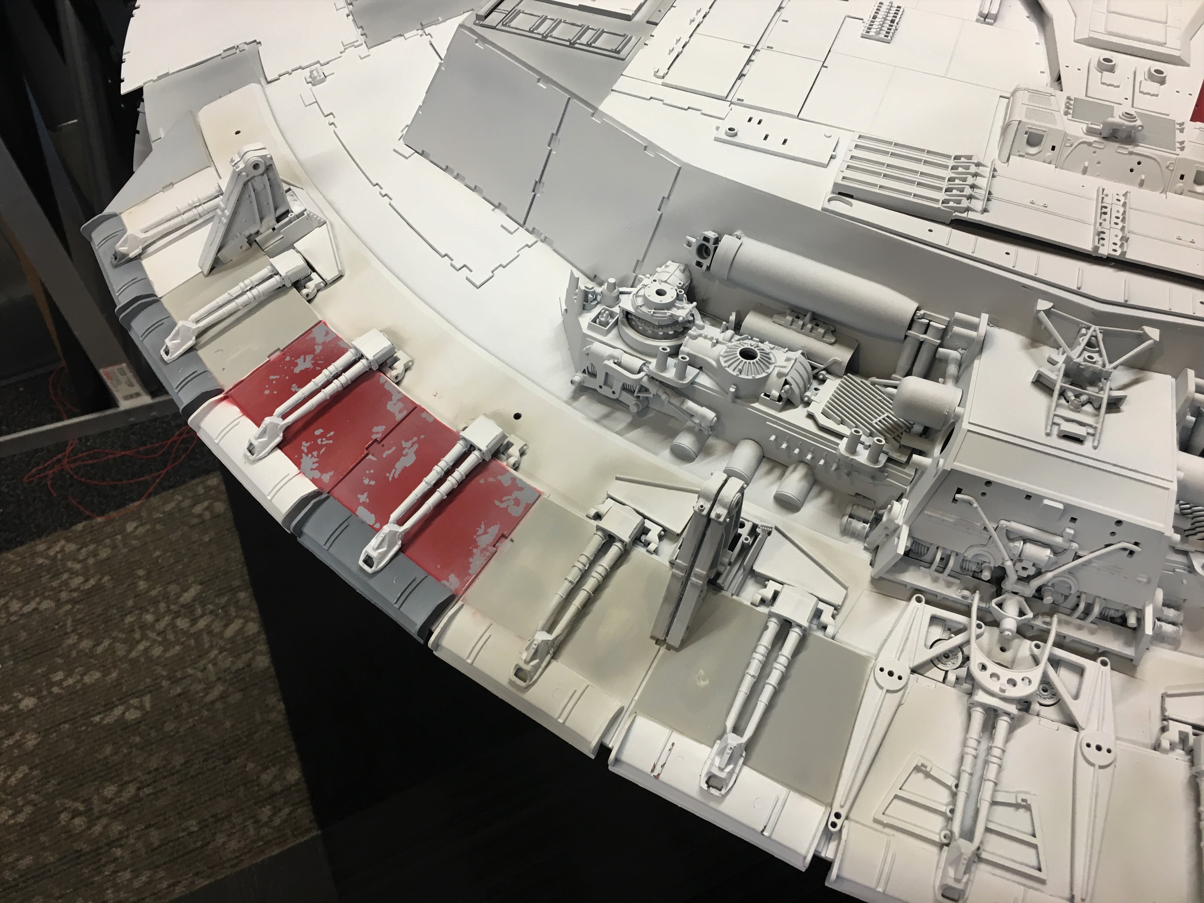

2nd set show the additional kit parts that are being added to the front port body wall. This adds back in several parts that were on the original during filming of ANH. (Still need to add Hasegawa Sherman part). Then a quick shot of primer, then the last pics show the parts applied to the port wall. Once the weathering gets painted in here, it's gonna start looking really close.
Super cool! Looks great seeing stuff like the McLaren triangular part that's now missing from the Falcon. I'm curious about the dome-shaped piece that covers where the holes for the carrying struts go, though.
