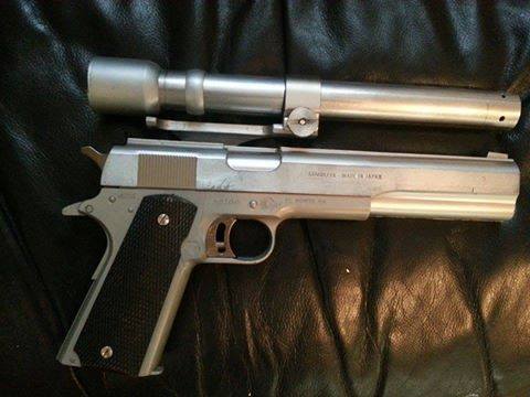

Got the Daisy laser sight at Academy Sports. Had to dismantle it to get the laser sight out but after that it fit perfectly.
Nice....did you make the scope too ??? If I can ever find a scope , mine will be complete then

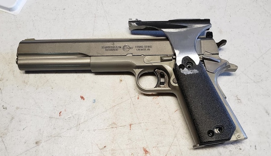

I got a guy selling me a NPC mount for $40. He's gonna send a pic and if it's as described I'm grabbing it.

The NPC mount can be found but it might take awhile. They were fairly common in the 80's so there are survivors out there. Note that the mount is black and the mount and the one grip panel is all one unit. They removed the finish on the upper part for the movie but left the grip panel part black. eBay and Gunbroker are your best bets as well as checking every "old parts bin" at every old gunshop you find.

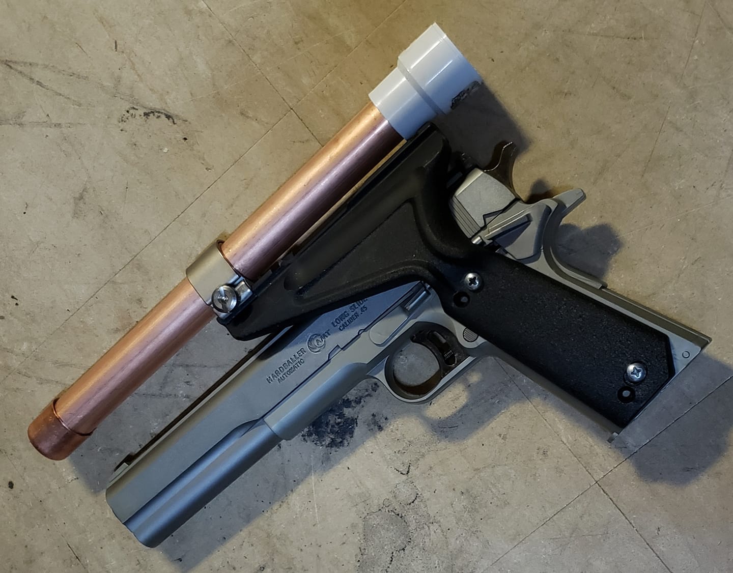

Any reference pics of the rear of the sight tube? I've seen enough of the front. Going to scratchbuild the tube for now, and find a different brand grip mount until I can locate an NPC.
Here is what I came up with.
Gun is a Marui Non-Blowback (NBB) AMT Hardballer. Took me a while to find it.
The scope mount I bought off eBay. I figured I could modify it to look more like the NPC mount. The scope is scratchbuilt using copper and PVC plumbing parts. Scope ring is the correct one - had one of those in my parts box.
Finished everything with Krylon chrome.

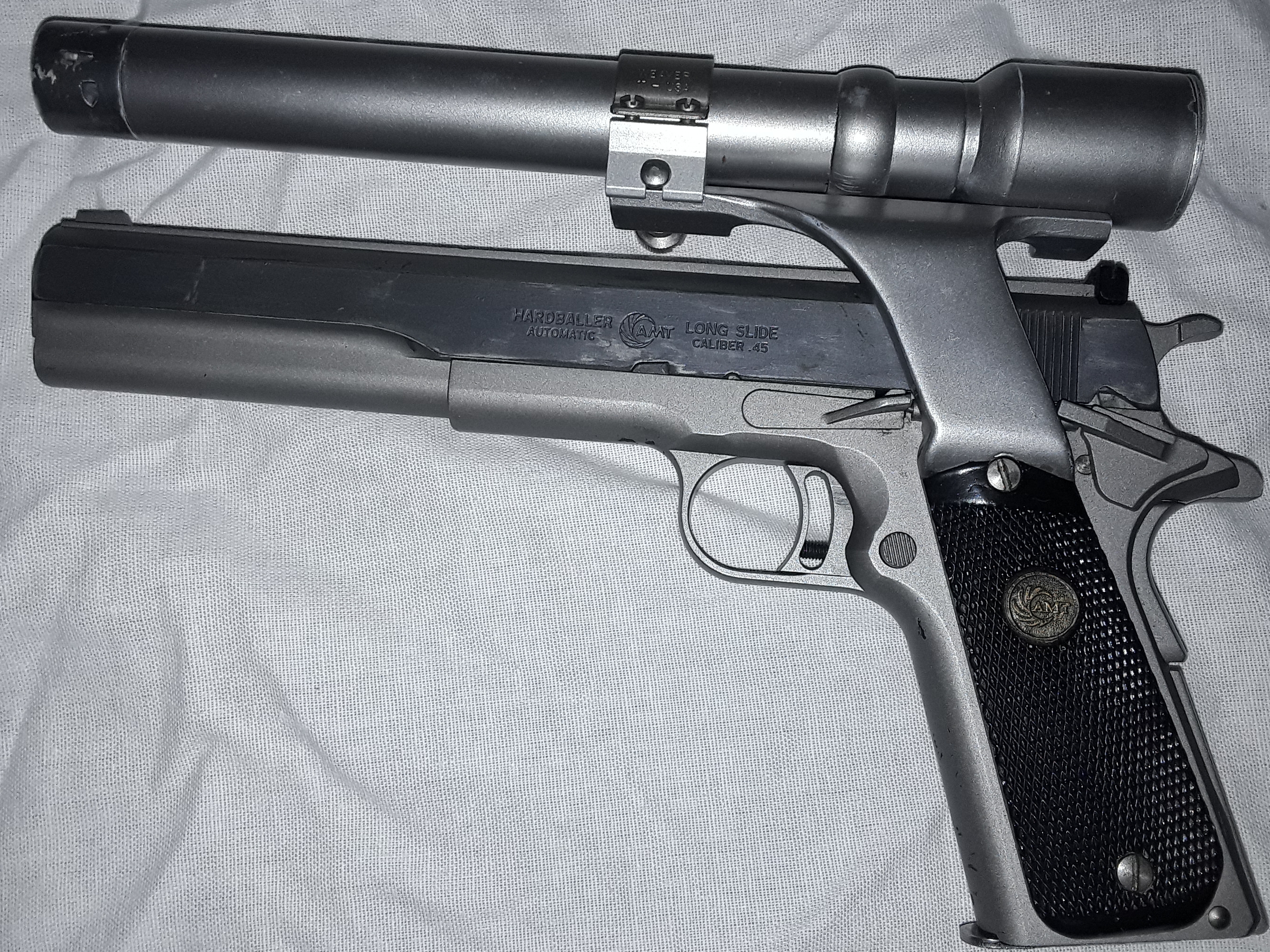

Here's a pic of my build. Western Arms Hardballer, real NPC grip mount cut down with the NPC logo removed, I made the AMT logo insert in the grip from miliput. The laser is a mixture of steel and aluminum tubing housing a diode laser made to the dimentions that Demetrius posted. The wires are inlaid in the back side of the grip mount to the hammer spring and trigger bar so when you squeeze the trigger the laser is activated just like in the move. Still need to make a replica of the DeSantis rig for my UZI.
