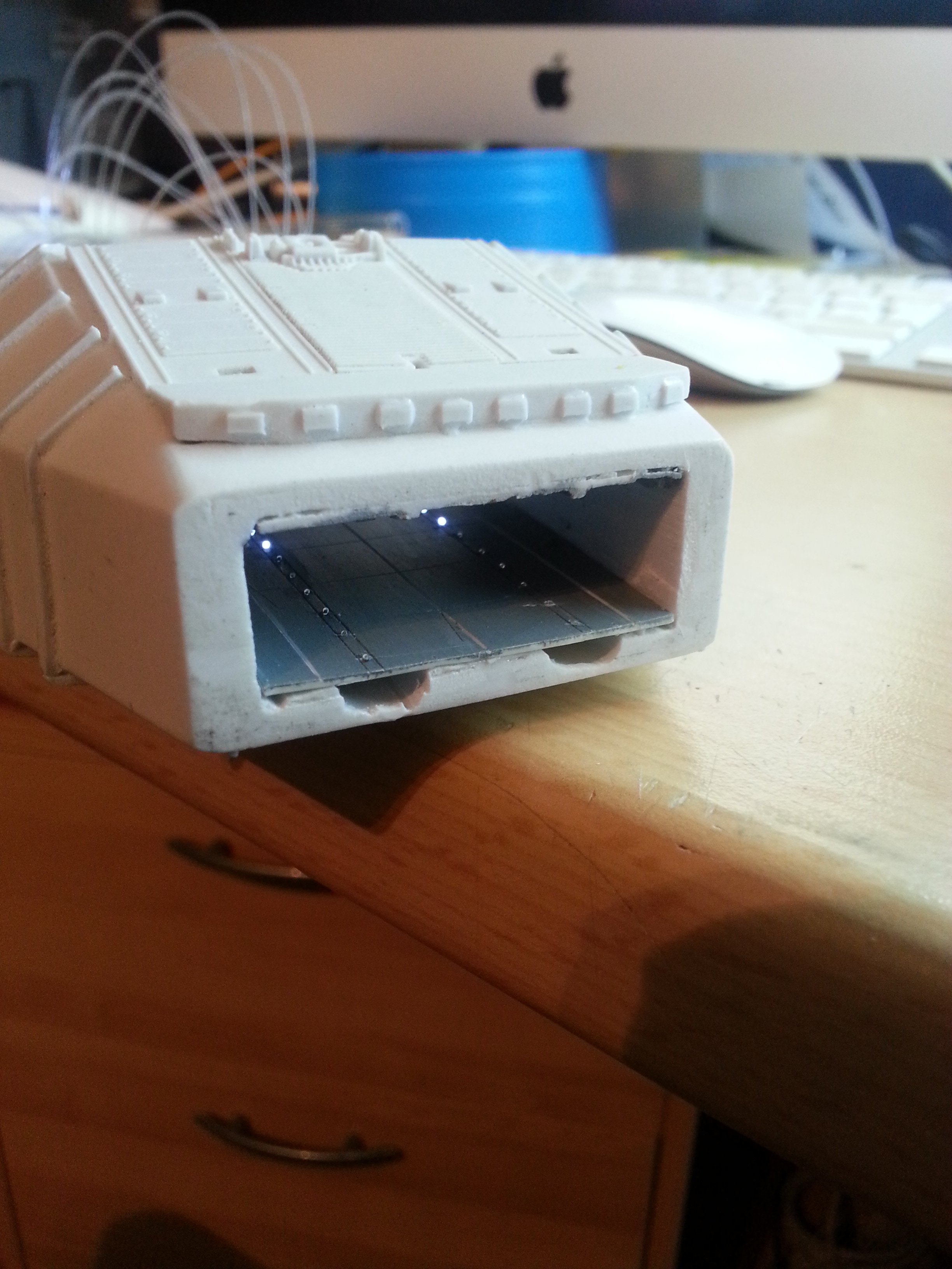

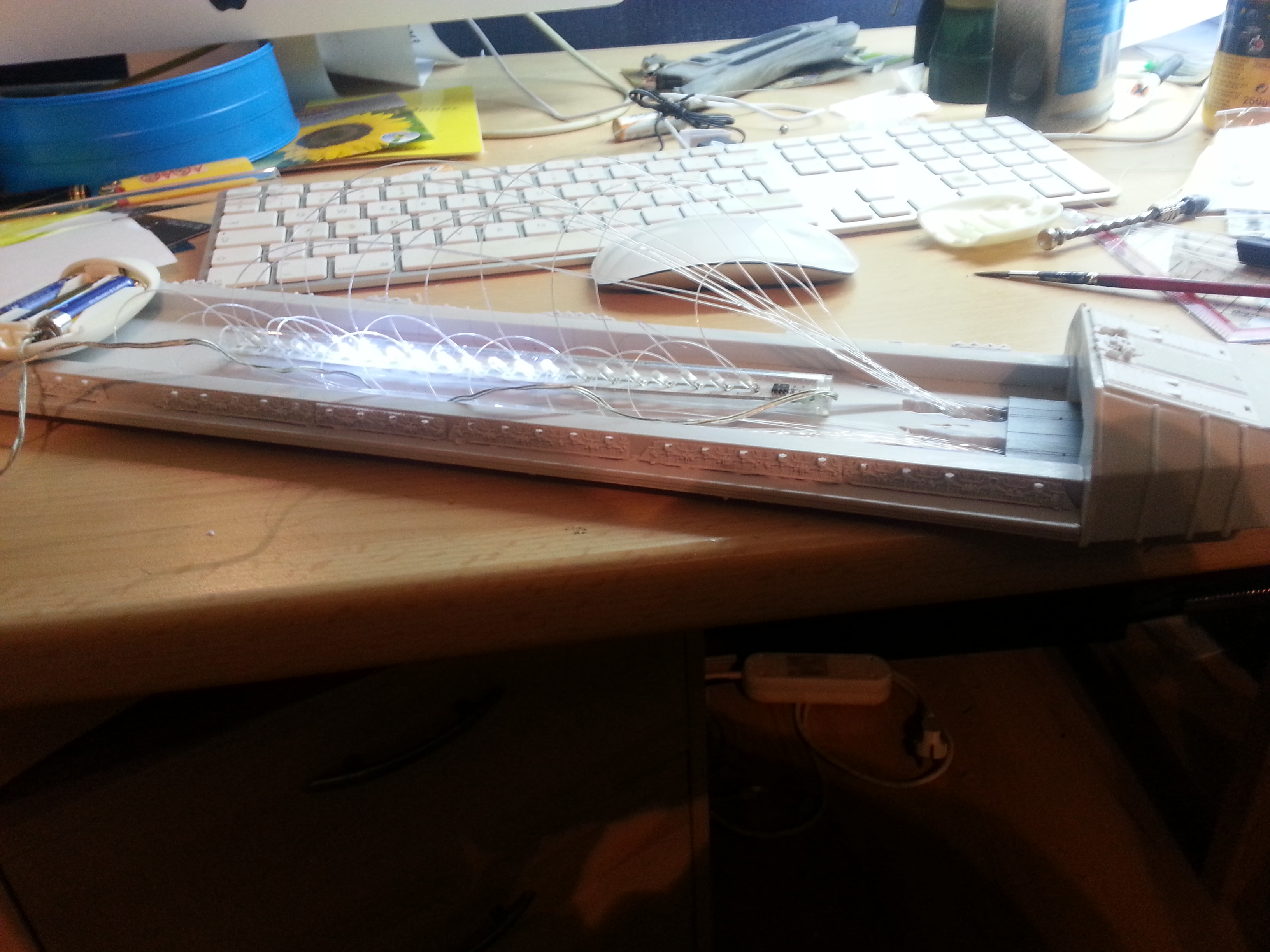

Hi All and happy new Year.
This is what I have done so far for one landing bay.
And this is what I have taken for the light source
More will come.
View attachment 269977View attachment 269978View attachment 269980
More will come.
Hi Tor,
That's exactly what I'm hoping to achieve as well. Great job.
May I ask, is that a commercial LED chaser strip you've cut down, or a circuit/rig you've done yourself? - I've been trawling around but not seen a compact strip with a suitable chase sequence that I could cannibalise yet. Any recommendations?
Cheers
Nick

Hi
Yes that's a christmas "snowfall" decoration with a plastic tube, with 20 LED's, but I used only 10 of them, allways taking the second one.
I drilled 2 holes in the plastic tube for each fiber optic for both sides, and had to carve out a lot of resin from the landing bay part, for the fiber optics not to bend to much. It is in my opinion the easiest way instead of taking a circuit board and soldering LED's, put them in place and then to fit the fiber optics to the LED. Don't ask me where I have bought them, as I got them on ebay germany for over a year for another project which never has been realised, but I think this should be easy to find now after christmas as a discount.
Raoul
A quick search for snowfall lights on eBay resulted in quite a few results for only a few dollars. :D
More will come.
Interesting idea to use one of those light bars as a source for landing bay chasers. To synchronize both bays, however, I might actually use the actual LED circuits instead of fiber to send the signal into mini LED's by wire into each bay with a single light bar in the main body. This is especially critical, as I plan to actually build a full-size landing bay inside each housing, basing the design and top lighting on the transparencies. As you said, fiber doesn't bend too well but copper wire does.
I'm also thinking of using nylon fishing line in lieu of fiber. Not as clean a vehicle for light transference, certainly, but a lot more flexible and inexpensive compared to the real deal.
Thanks Raoul, that's a big help. As soon as you include 'snowfall' in your search as opposed to 'chaser' a whole new world opens up!. They seem to be mains voltage out the box, but looks like once it stripped down you got a battery hook up going on, which would suit my purposes better.
Cheers
Nick

Hi
Raoul
