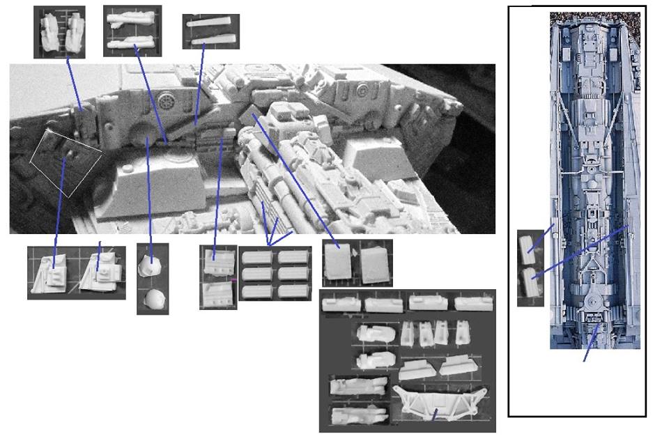

Oh, this is from Randy Cooper, in case it helps anyone out.
Ryan, that'll look fantastic!
