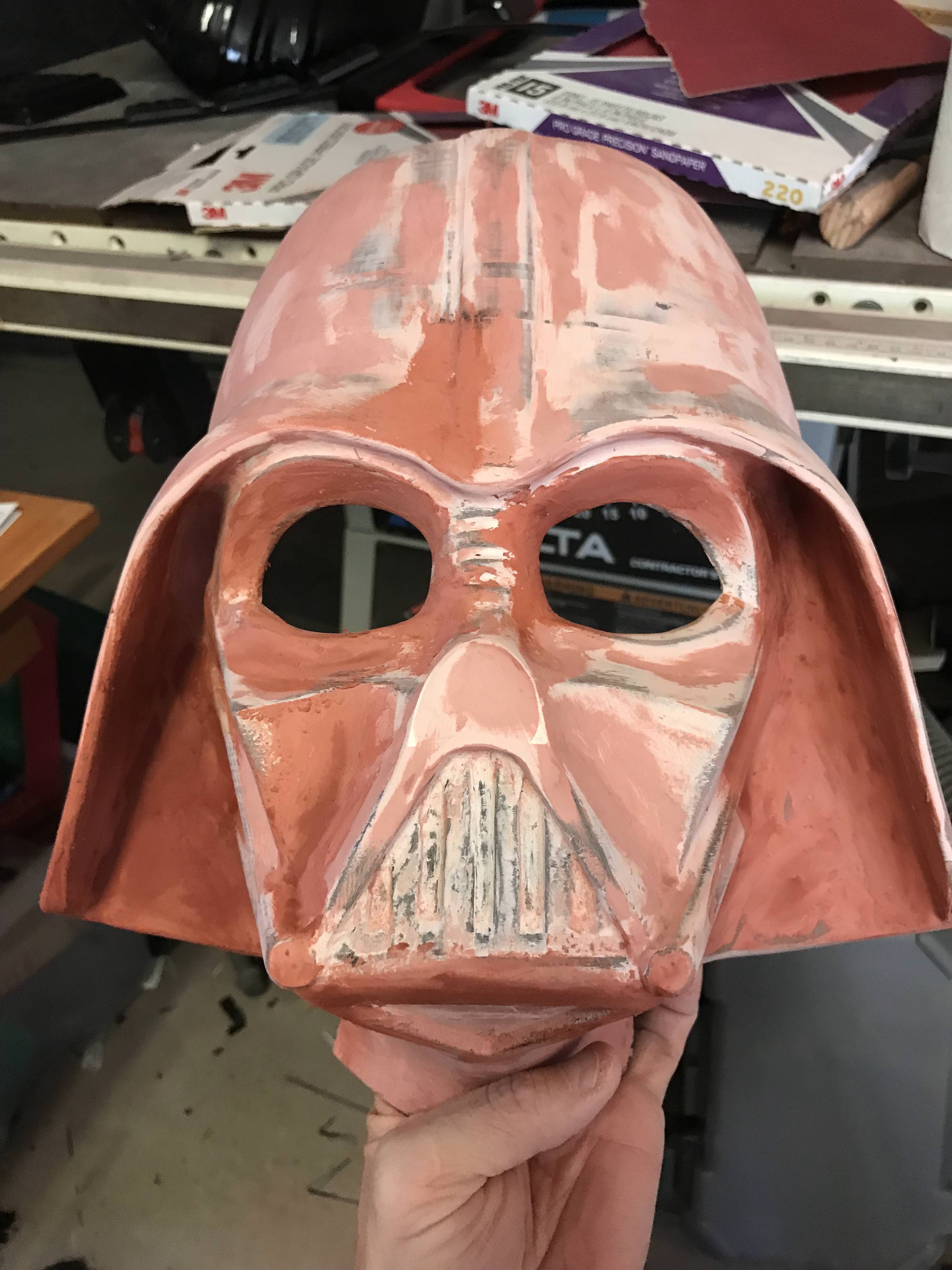

Next, I ground down alot of the edges and slathered with bondo so that I could get the much softer appearance.

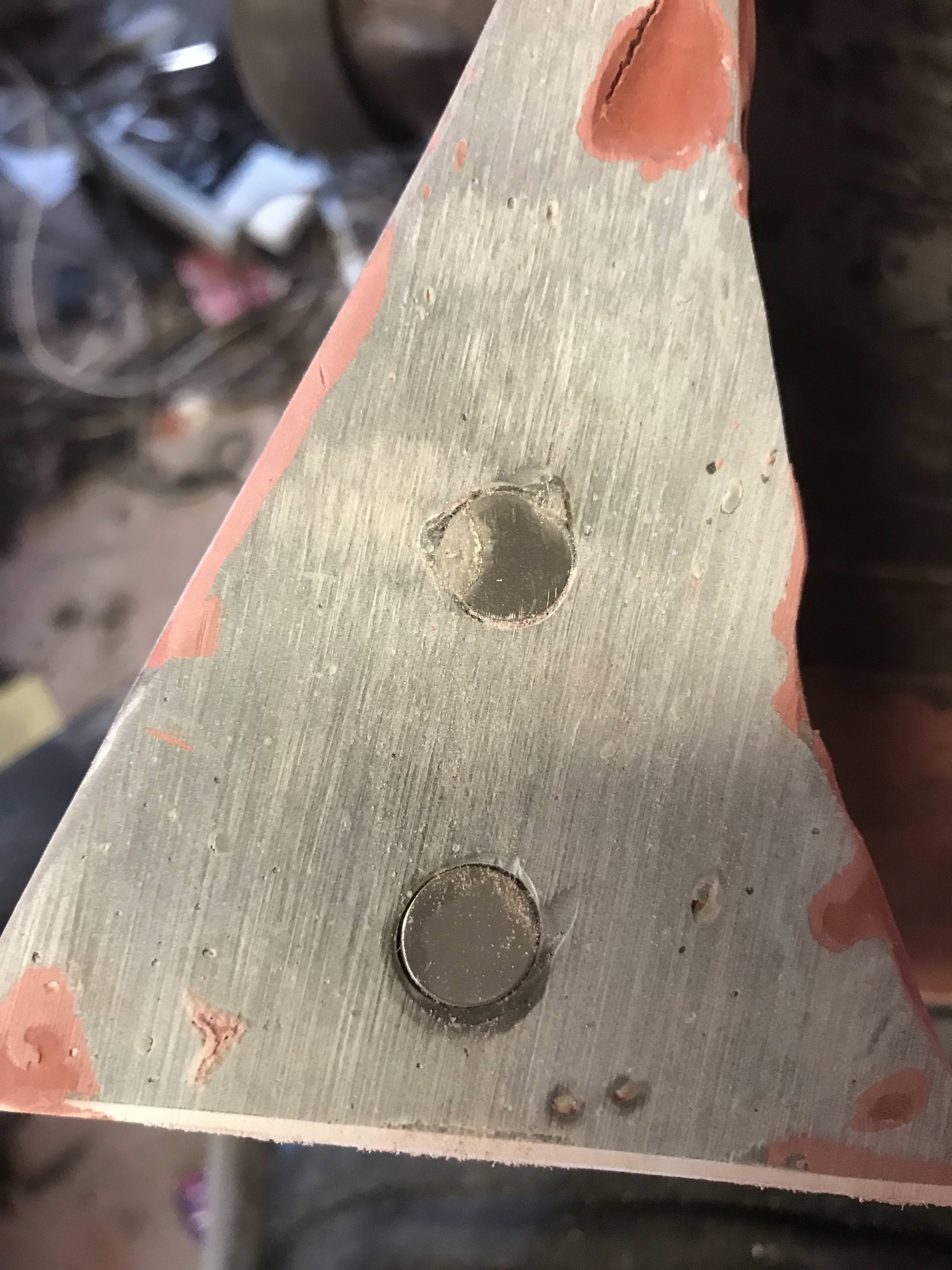

And then after a few rounds of sanding and re-applying, I placed rare earth magnets to hold the helmet closed while wearing. The top is anchored with heavy elastic and this holds the front to the back.

After a while, I get impatient and just want to see how close I am by using bondo filler spray. It fills in some imperfections and gives me a uniform look to see where I need to clean up.
More to do. I didn't capture every phase of this part, but it's the same routine of bondo glaze, sanding, priming, repeat.
