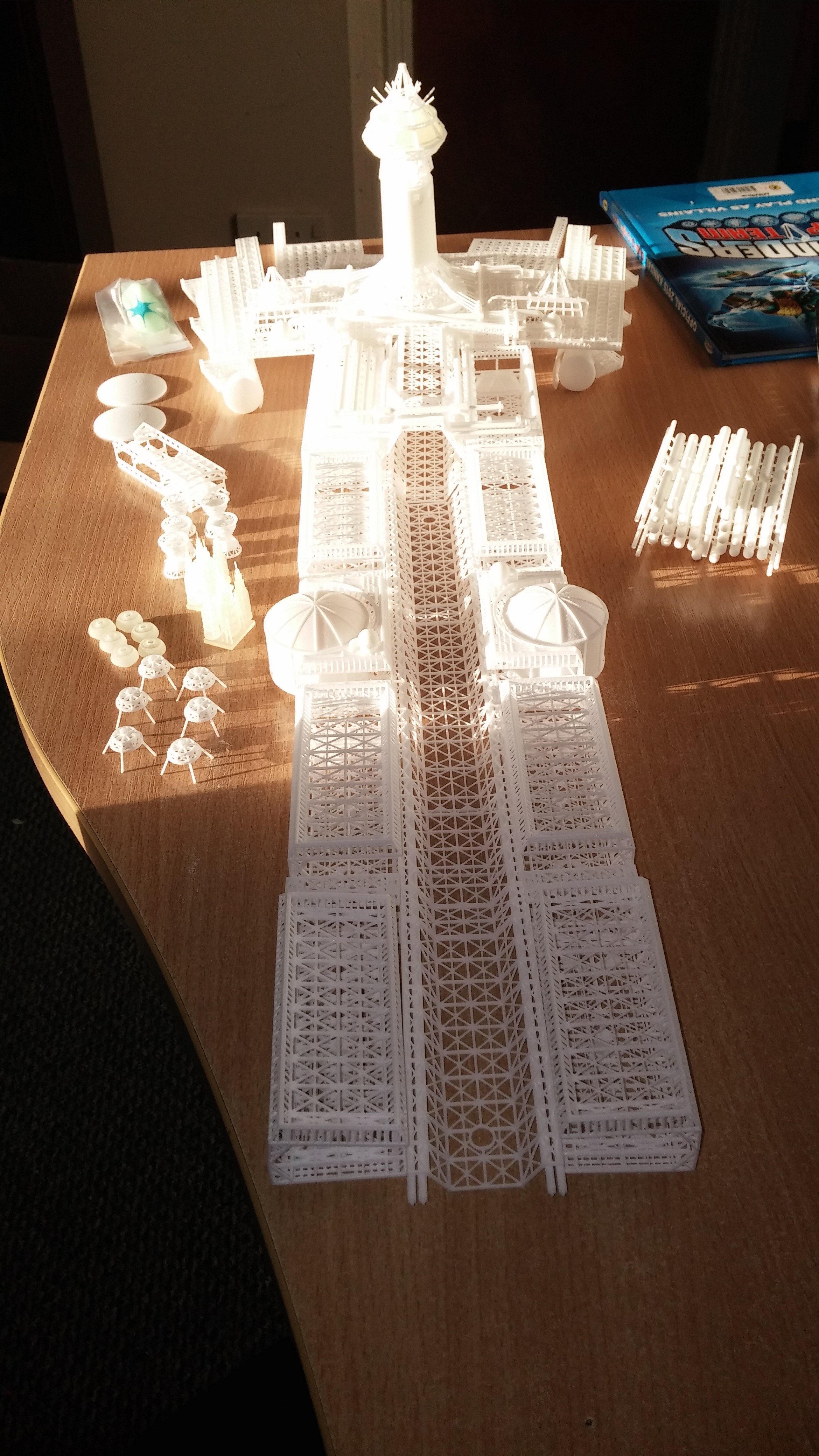

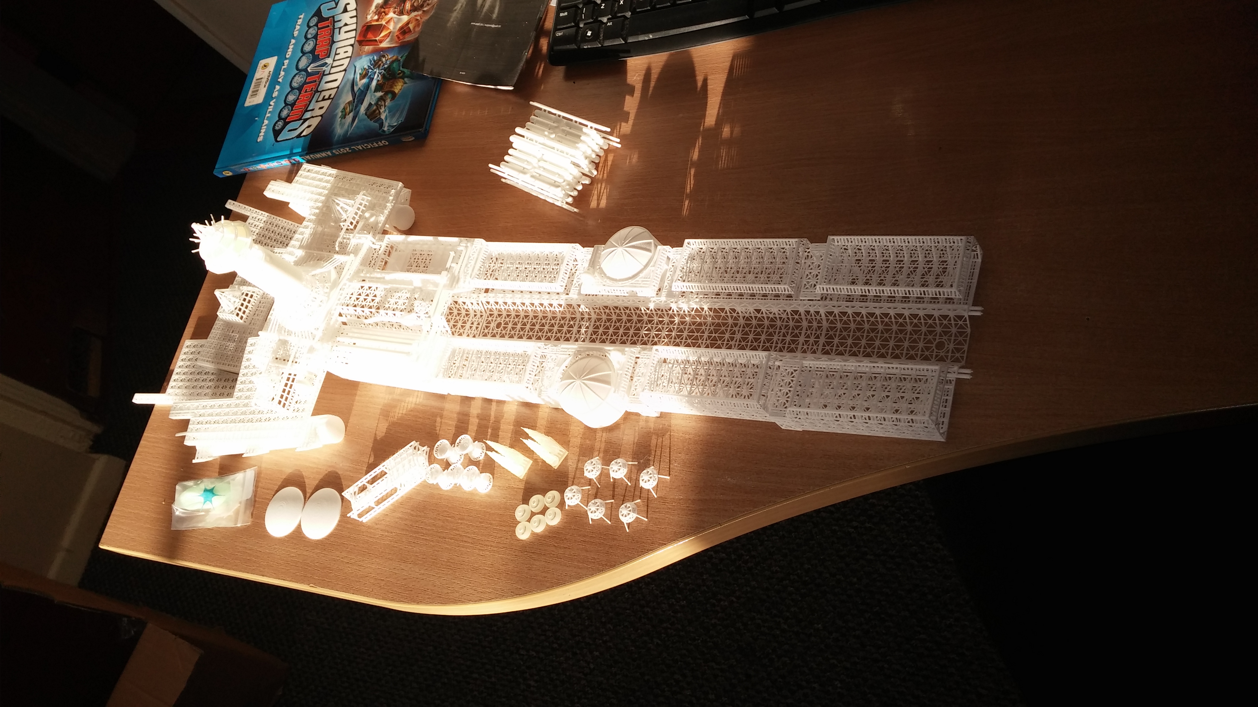

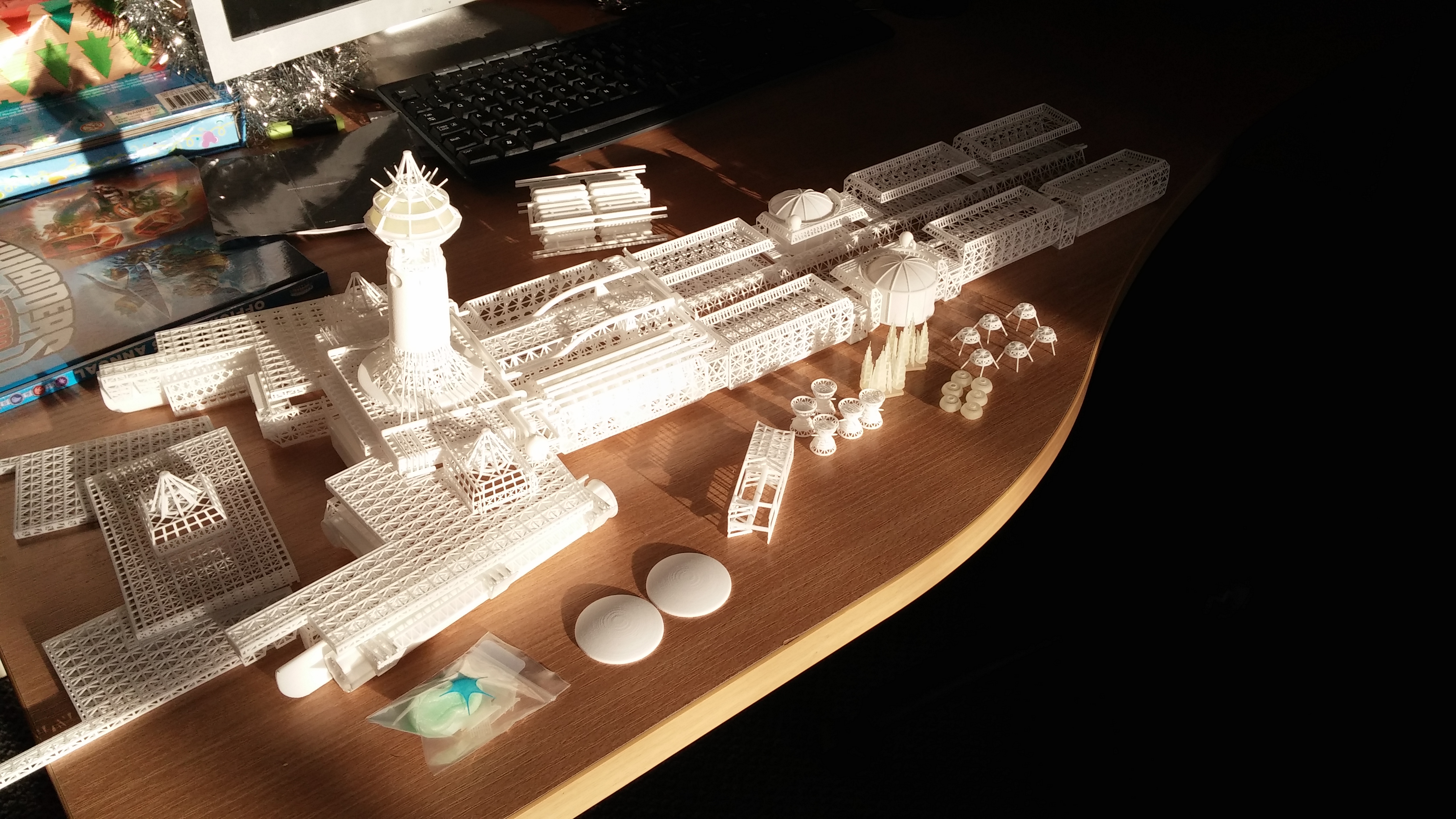

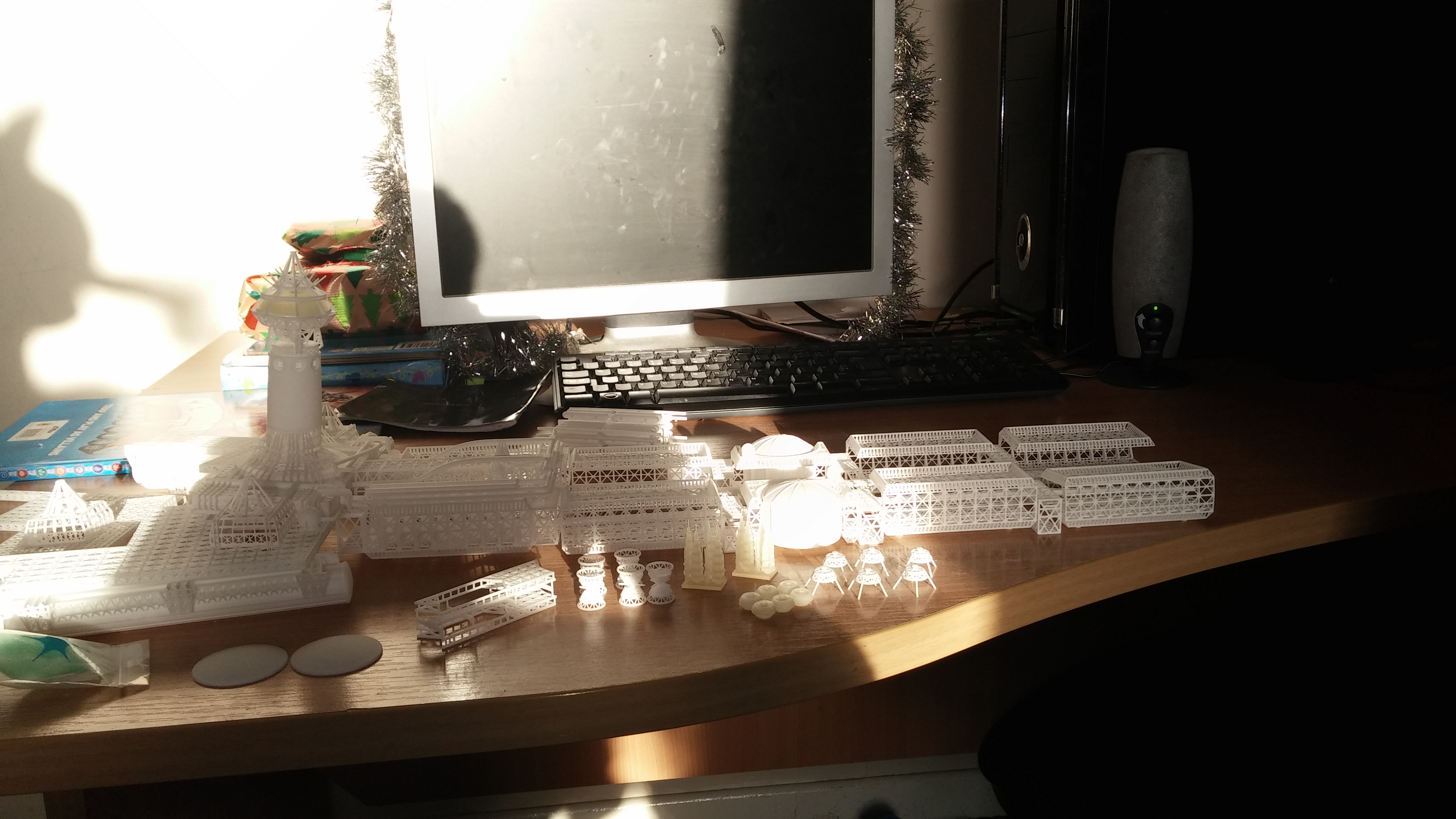

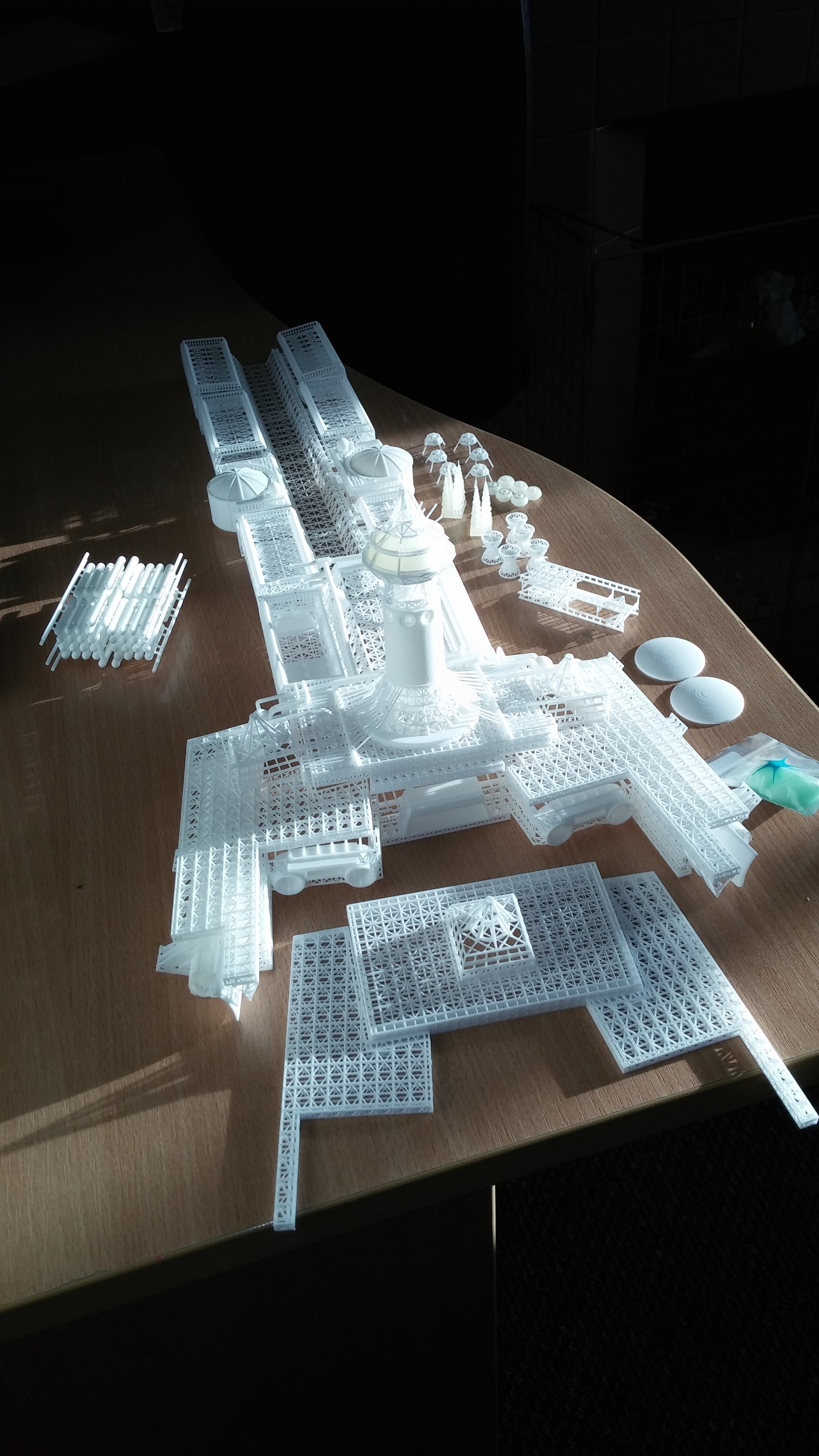

Decided to set up what I've gathered so far. Clearly it's thrown together at present, but it's just to show where I am with this at this time. Looking forward to getting the rest.
Oh,Martyn. I'll be ordering that lower spine antenna from your shapeways store too. The ship just doesn't look right without it.
Sorry about the double posting of one of the pictures. Uploading issues on my part(lack of patience)

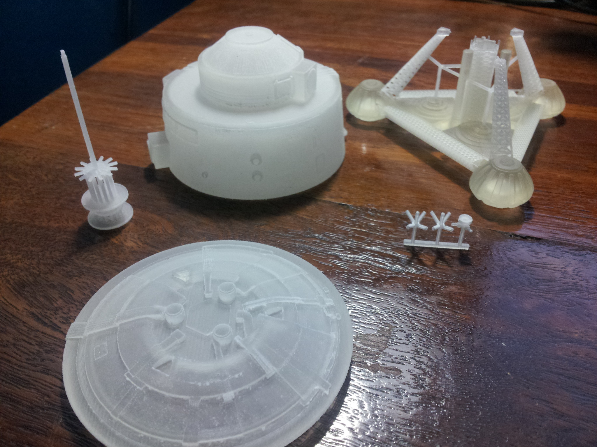

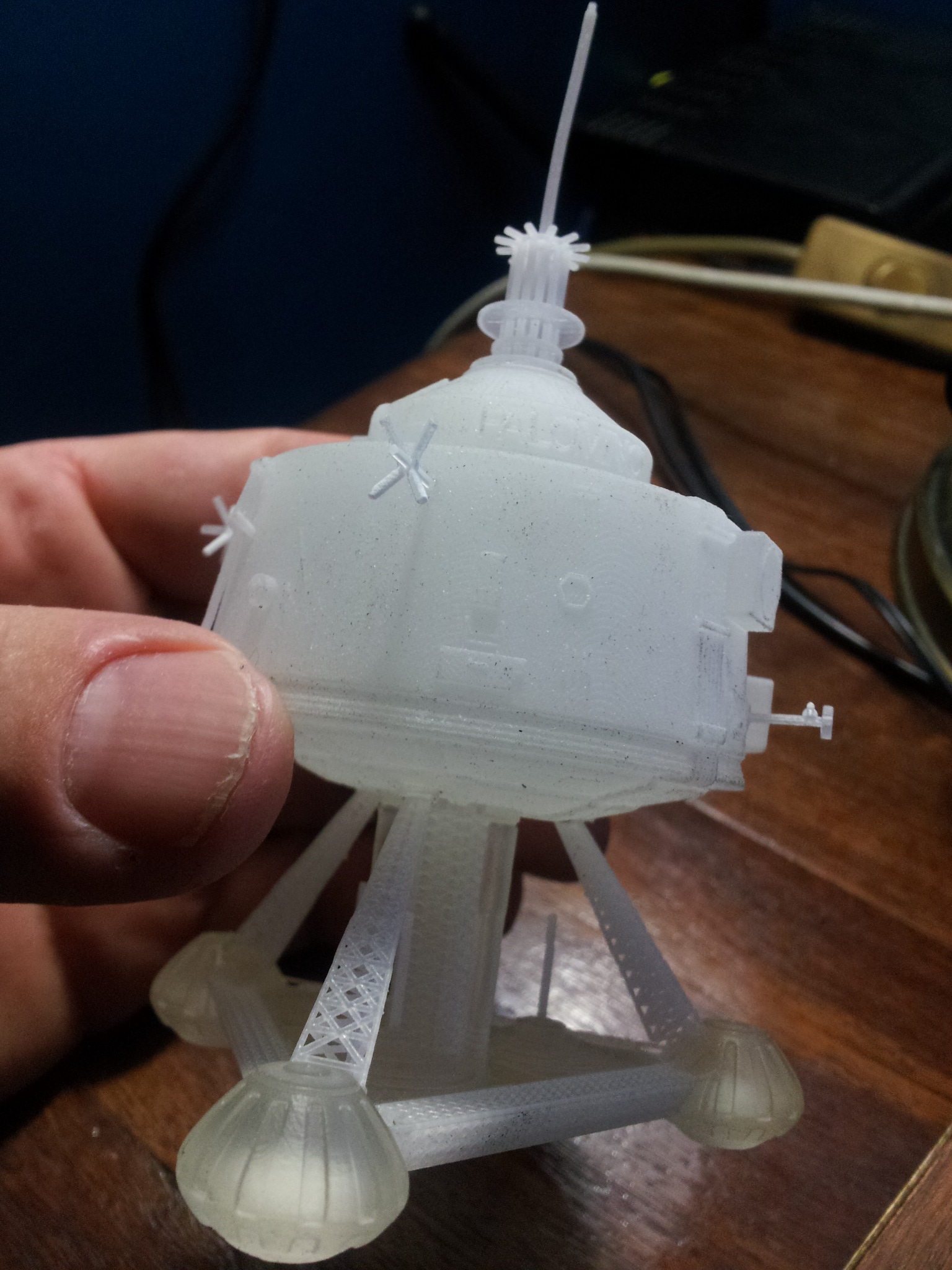

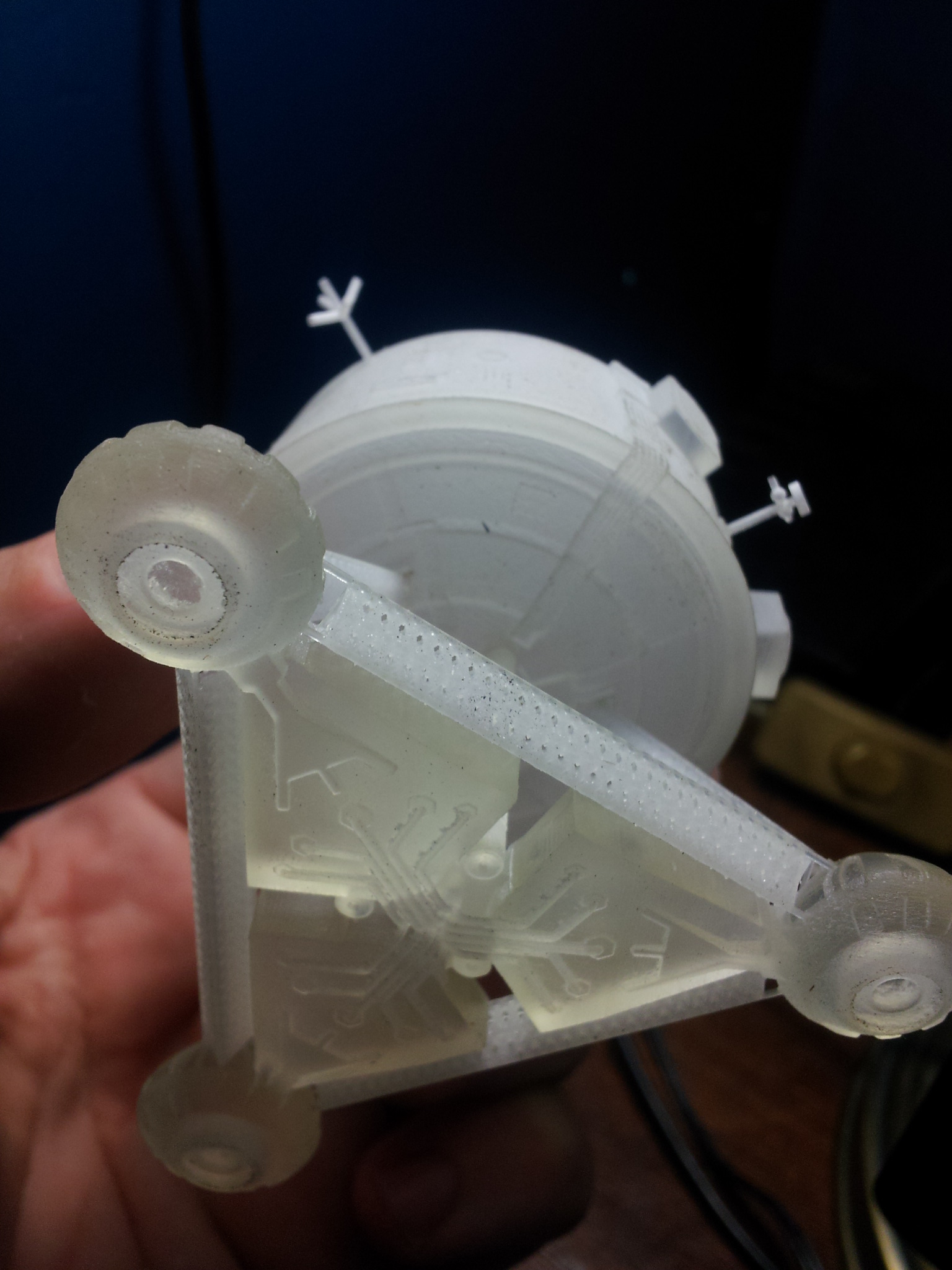

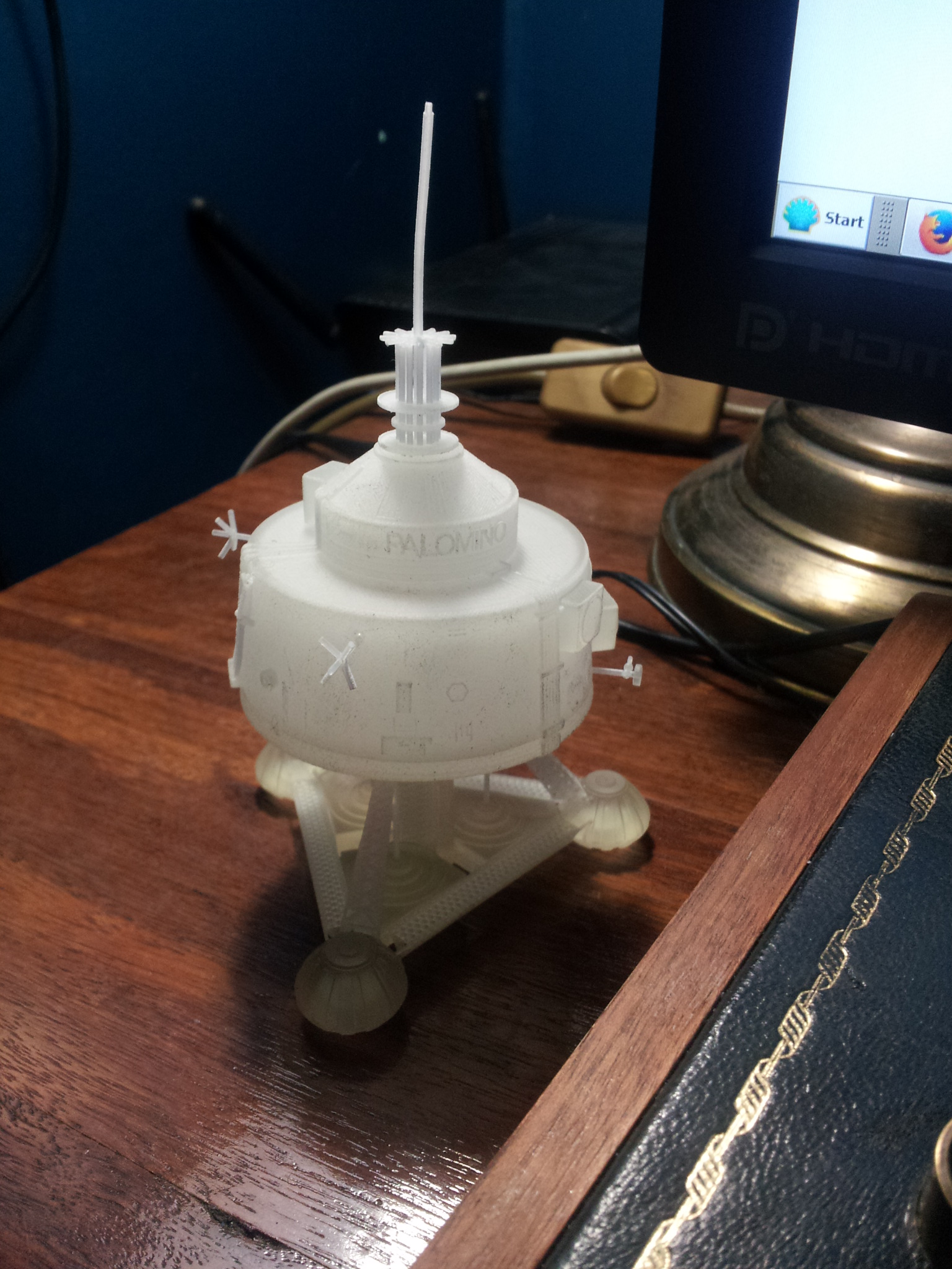

Oh hey I finally got the lower engine deck of my Palomino. All good. After seeing just how fine the smaller elements are (hairlike), I've decided to upload a 1/192 version. Usual place. Quasi-affordable in WSF nylon, bloody expensive in FUD resin.
1/192 is the scale of the 12-foot Cygnus models and smallest Palomino model, so this is technically studio-scale. (It's not a proper SS replica in our terminology obviously.)
Merry Christmas!
Cheers,
Martyn
PS 1/350 on the left, 1/192 on the right:
The original 1/192 Palomino model:
Definitely an improvement on the original version, but fragile, and yeah the top antenna is too flexible, I'll need to replace it with wire. Not bad overall but there's a bit of a quality issue; the engine deck part is gorgeous; they really brought their best game for that one. Smooth glassy surfaces, not frosted at all. But the main hull part and hull bottom, um, more 'snowfield'. :p Definitely rougher surfaces than I was expecting.
