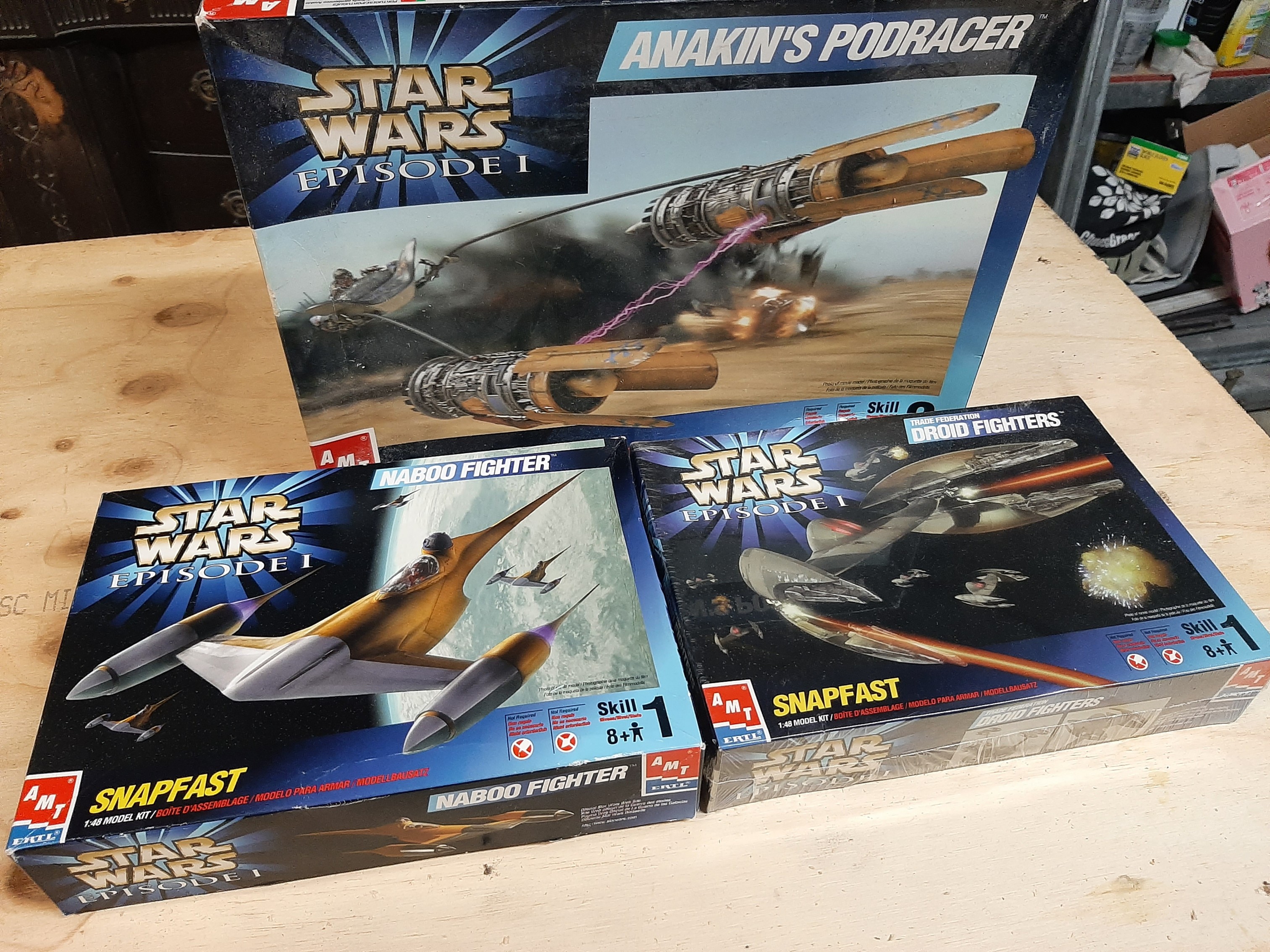

I was in the shed cutting a board for my walker project and pulled these out.
Somewhere in the last 20 years the N1's canopy has gone missing from the sprue... these kits have had multiple moves. I will have to substitute another canopy. Im wondering if I can make a spare Eduard P51 canopy work. To be honest I don't know that I will ever build the droid fighter as they didn't excite me all that much.
I'm thinking however it might be time for my next build to tackle this podracer!
Thanks for the inspiration to pull these out StevenBills.

Just go the "Pimp My Starship" route and make it a convertible! ;)
But where will I fit the 6 TV screens? On the plus I suppose I can go for some chrome landing legs and a paintjob that's too lazy to get under the sill, that will save some time!
