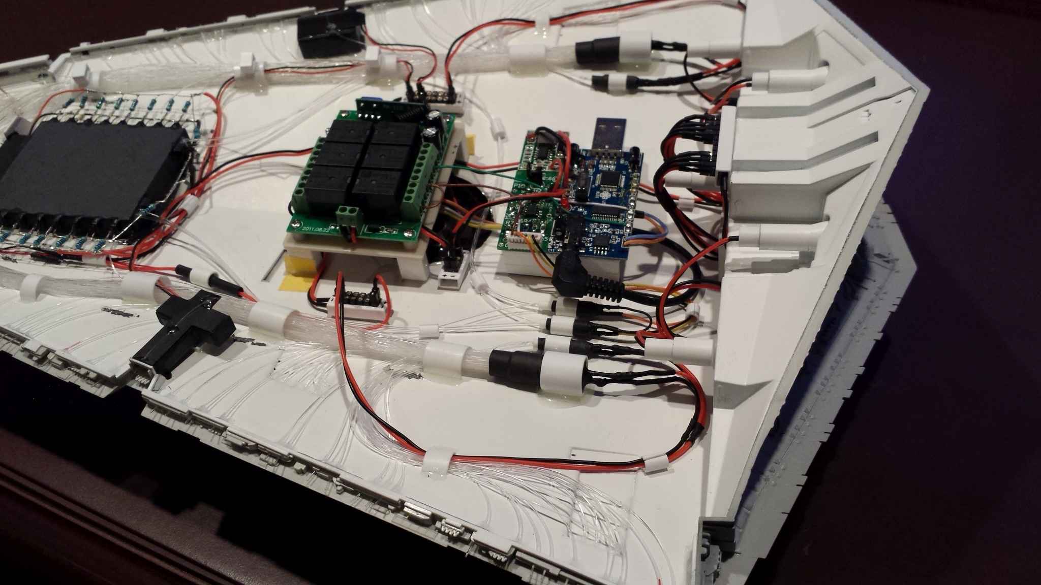

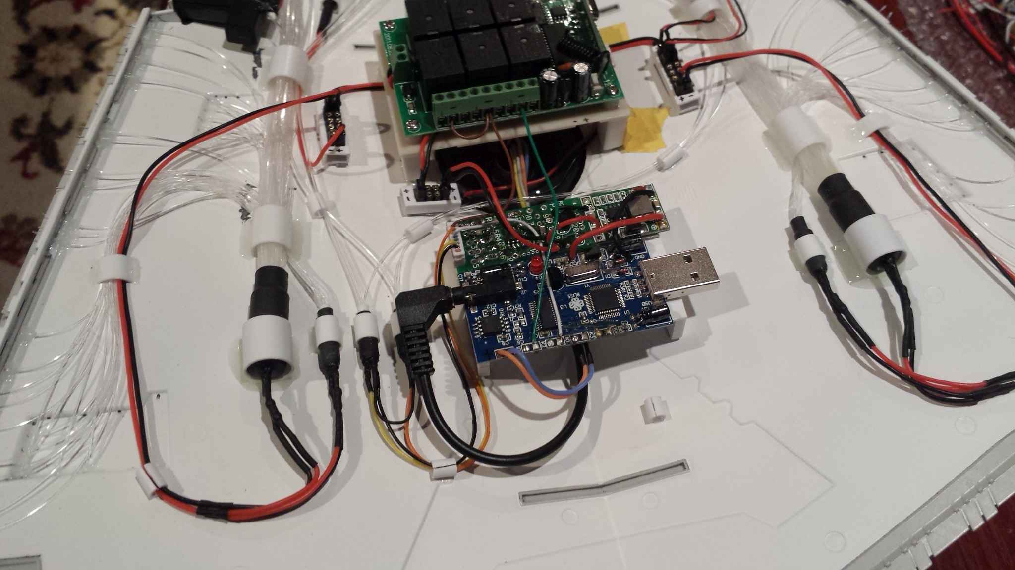

Quick Star Destroyer Update:
Engine block installed. Will be attaching upper hull to lower this weekend. Wash to follow sometime next week.
Base / Stand construction underway. Priming and adding detail started.

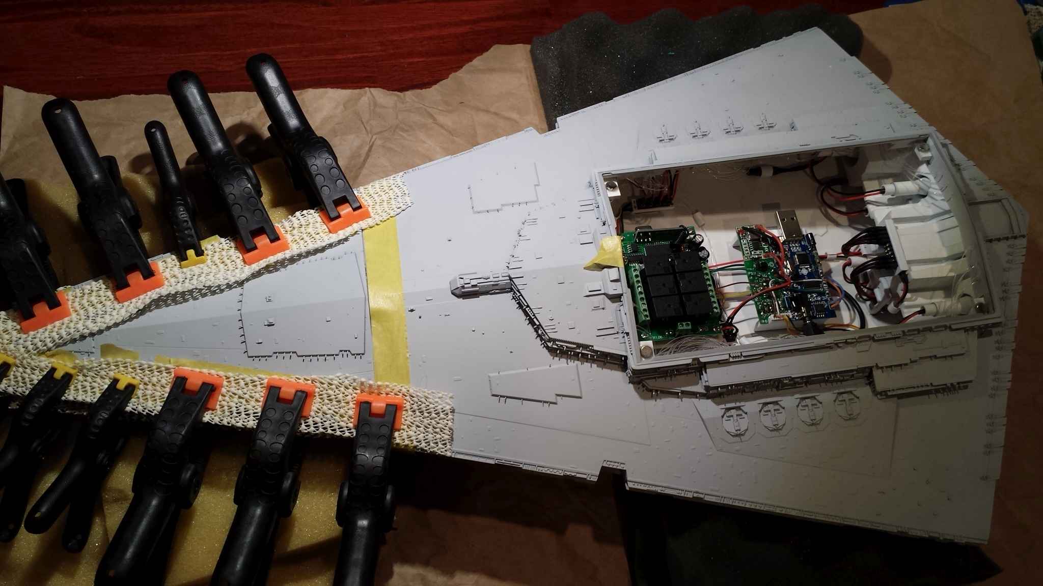

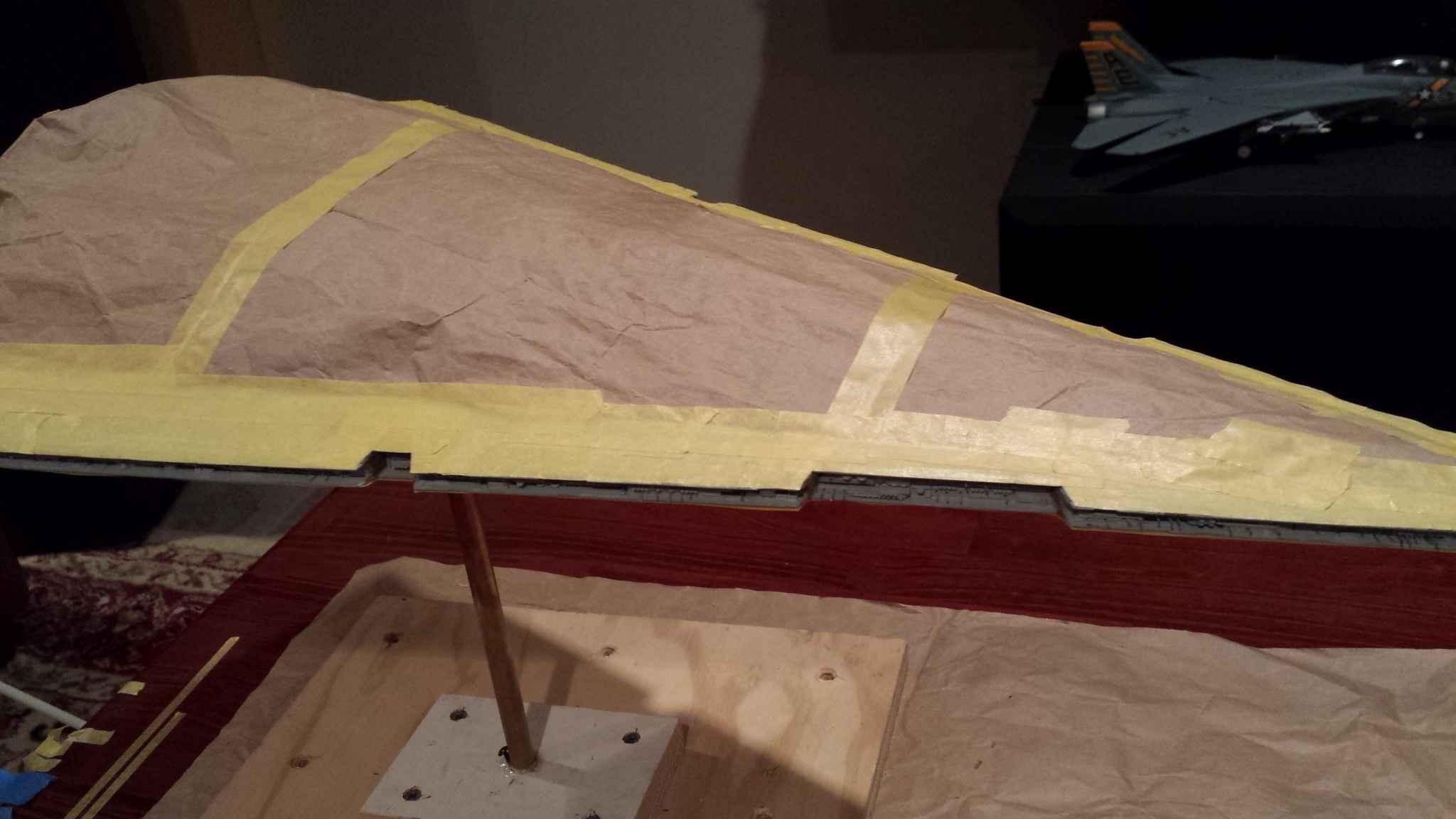

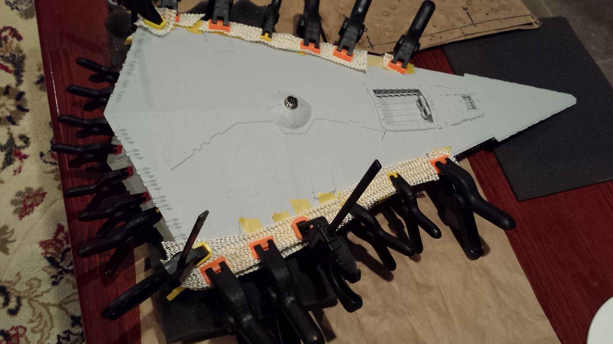

Top and bottom sections joined!! Trench and engine block re-primed and painted. I may do pre-shading in the trench area and engine block before the wash. I hope to do the wash next weekend.
Hi Ross, when you applied the wash did it interfere/cover the FO that you had bloomed the ends. Did you also cover with Testors dullcoat and did that have any effect on the FO ...........If it didn't I may cut them prior to those steps

hey there Scott!, Looking incredible! :thumbsup I washed before FO. I brushed and dabbed the trenches after they were attached to the lower. The upper and lower I used the watered down wash in the spray bottle, pieces standing on end, forward end up, and just let it run down, then dabbed with wet Q-tips or wet brushed the areas where there appeared to be too much. Damp Q-tips won't absorb too much and leave less lint. With your FO in already, I'd cut them after. The dabbing will be a bit more tedious with FO sticking out, but you'd hate to have trimmed FO that the wash stuck to too much. then you'd have some brighter than others. just my opinion given your assembly sequence. I think when I do another one I'm going to do a stand like yours, takes away from the ship far less than mine does :thumbsup
