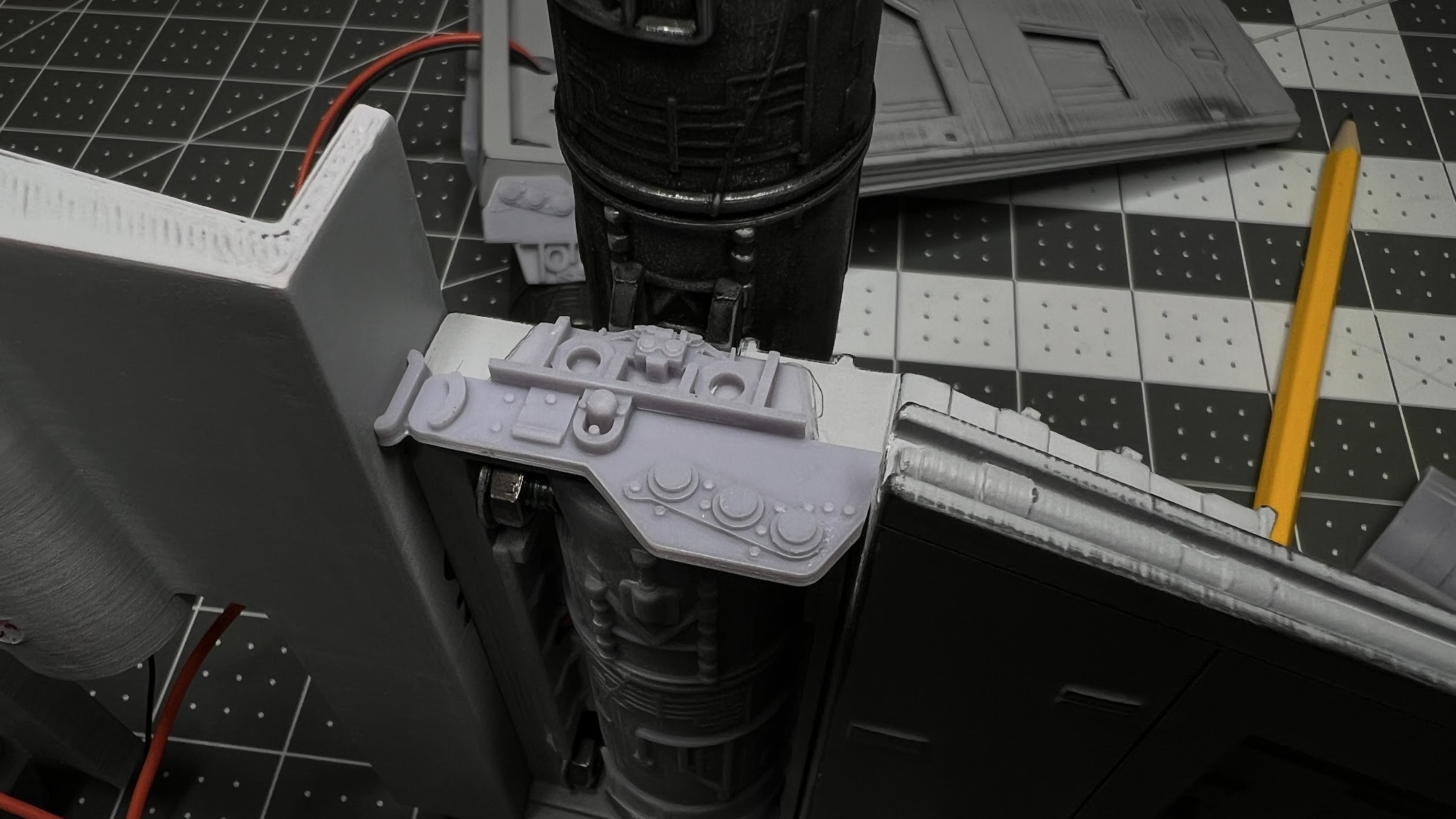

Spent some time on this build yesterday. It may not look like much, but I'm really happy with how things are going. One thing that I've noticed while building/making stuff is that I tend to get into my own head a little too much, almost to the point where I don't want to work on anything because I have a fear of messing it up. Well, yesterday I threw those thoughts out the window and just started gluing parts down! It felt great!
Here is my poor dremel work, meant to add room for the washers and nuts that hold the wings onto the armature. I wasn't too concerned with how it looked underneath because of the Phantom engine insert that would go in later. The screw on the left is 12mm long, and eventually got replaced with a 16mm screw. Just grabbed the wrong one from the bag. This was just a test fit for now.
Next I fit the Phantom engine insert into the wing, seeing where I needed to trim it in order to accommodate the screws and nuts and the wiring from the engine LEDs. I again took to my dremel and carved out a bit too much material.
I test fit the other wing and laid it out on the table after gluing on the Saturn V cans and engines. This thing is huge! (Yes, I know, Jkirkon, it's a baby compared to your 1:18!), but I am so used to working on the itty bitty 1:72 Bandai models. Side note: it feels so good to finally start gluing parts on. For so long I've had these parts just bouncing around in a box, and so it's nice to see them all go where they're supposed to go!
I glued the greebly onto the back of the wings, but I accidentally glued it a bit too high. By the time I realized my mistake, it was too late. I figured that I could live with it. I just shoved it flush with the top of the back of the wing, but it is supposed to be moved down ~3mm or so. Oh well!
Once I was happy with the dry fit, things got serious. I ground down the heads of the M4 screws so that they'd be flush with the inner face of the armature (I'll putty and sand these so that it's like there's nothing there), and mixed up some 5 minute epoxy and slathered it on the mating surfaces of the wing and armature. There's no going back now! But that's okay, because the wings fit nice and tight! Pretty happy with it!
As mentioned briefly above, I dremeled out a bit too much of the Phantom insert for the inner wing. I modeled and printed a SeaLab part (is it an oxygen tank of some sort?), and so I moved it a bit away from the edge where it's supposed to be in order to hide my sins a little :lol:. It doesn't quite hide the screws and nuts all the way, but I think that I'm going to add some more wiring in there to help busy is up a little more. What do you think?
Overall, I'm very happy with my progress yesterday. While still being careful, I was able to get parts glued down and this thing is starting to come together! For a while I was debating about the order of operations: do I mount the wings to the armature first, or do I paint the wings and then mount them? I decided on mounting the wings first, and then thought of how the construction goes for every single X-Wing I've ever built: You end up with two sets of wings like how they're pictured above, and you just paint them how they are. So from here on out I'm just going to treat this like a big Bandai kit! :lol:

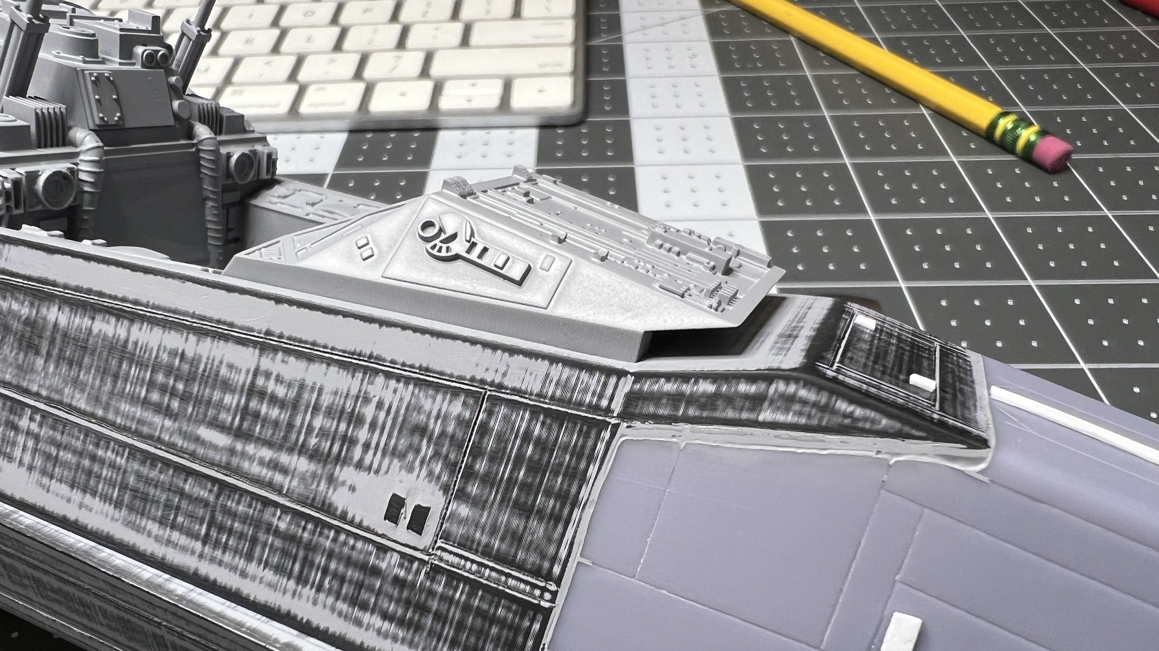

Not much to report today. Since I got the fuselage together, the cockpit didn't fit anymore. So I took it (and Biggs) to the belt sander and took off about 3mm from the bottom of each.
The next thing that I need to do is fix the female plugs that are in the side of the fuselage. I have some 3/32 brass tubing that looks like it'll work, so I'll drill out the holes and glue bits of tubing in there instead. Question though: All of the tube cutters I see online (even the "micro" ones) only go down to 1/8". 3/32" is just smaller than that. Would those cutters not work for something this small?
