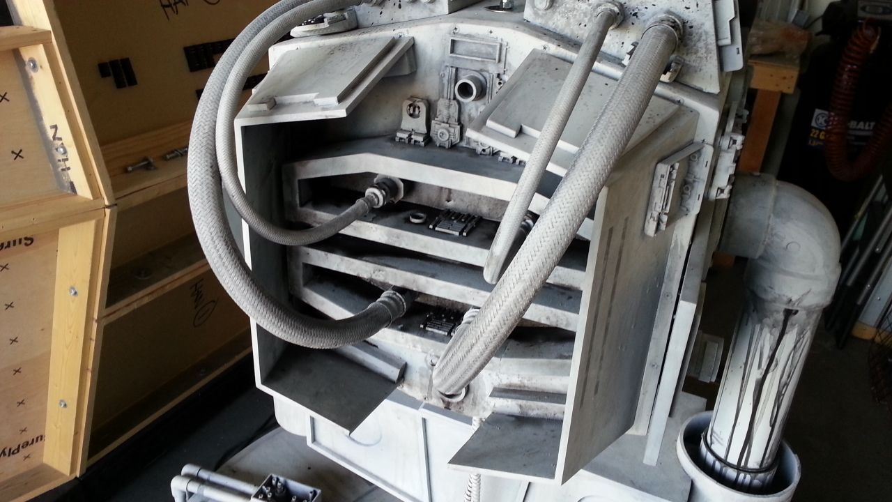

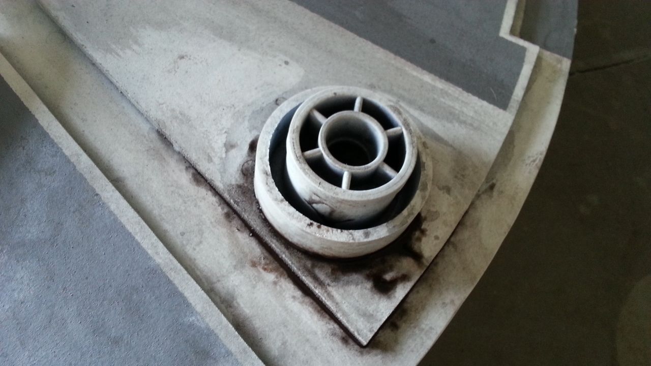

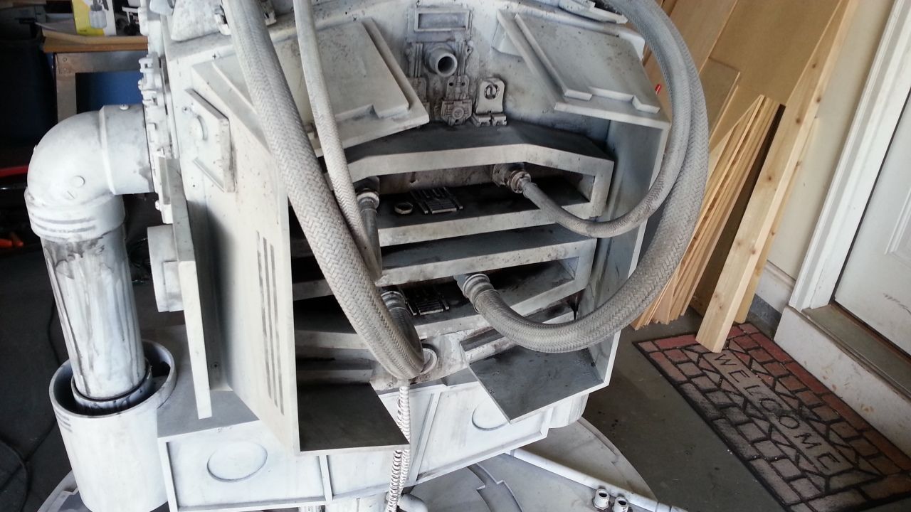

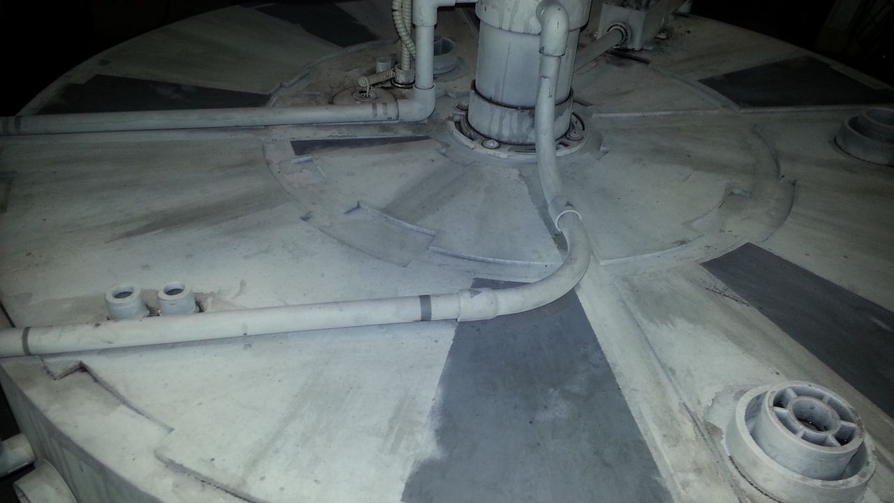

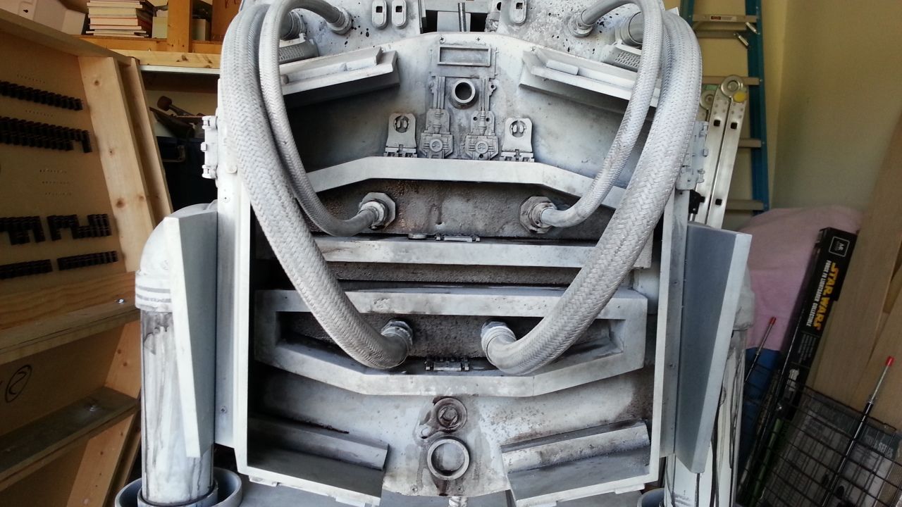

Let's start with some good news... I finished weathering the back of the quad
I added a little more gunk here and there...

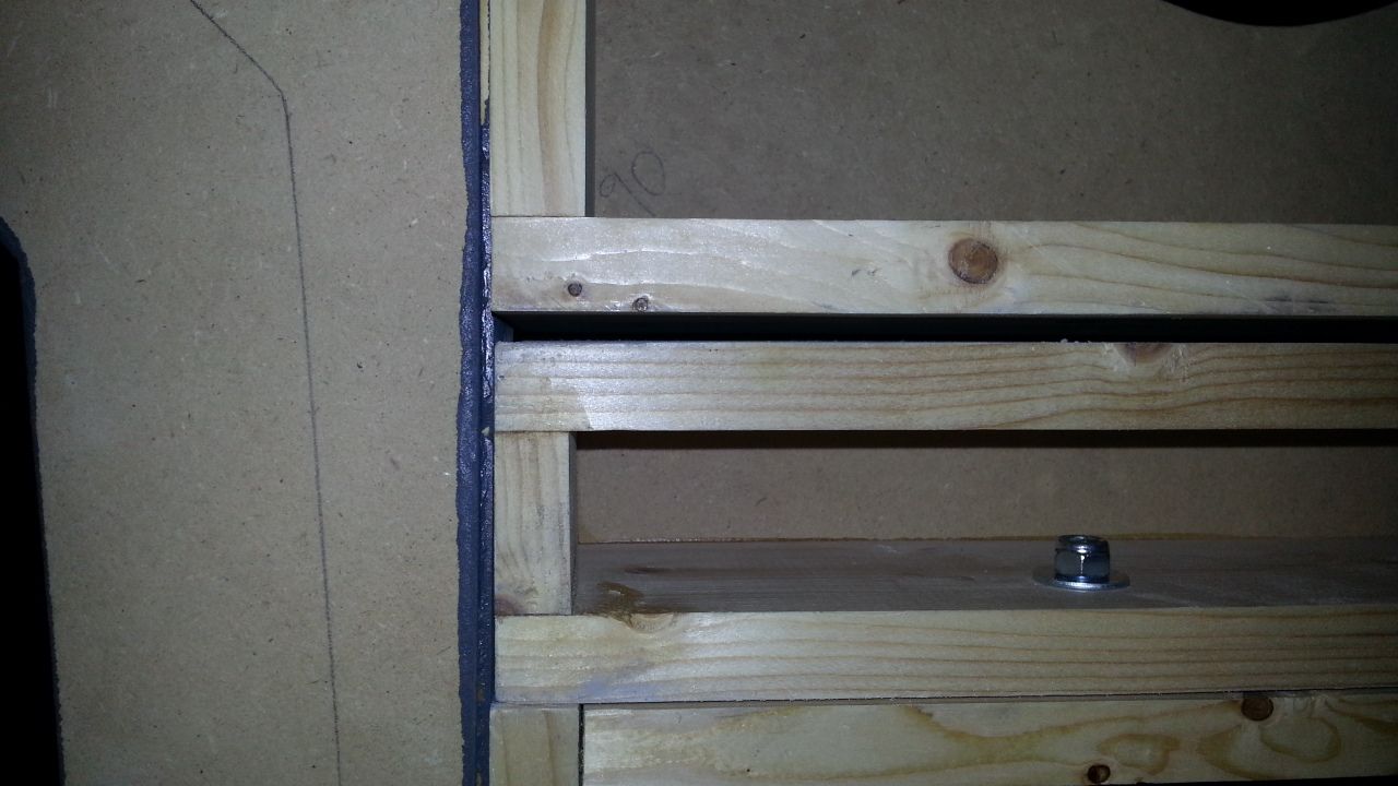

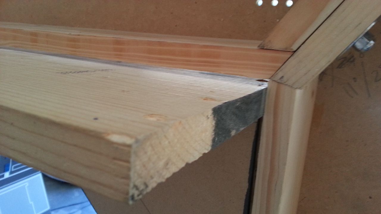

Alone, the panels fit fine until I tried to fit the door frame. I then removed the panels, installed the door frame first and install each panel around the door frame also with no luck...
Note the gap(s)
From the back - even with ALL the panels loosely fitted - there is just too much warping
This is where we are

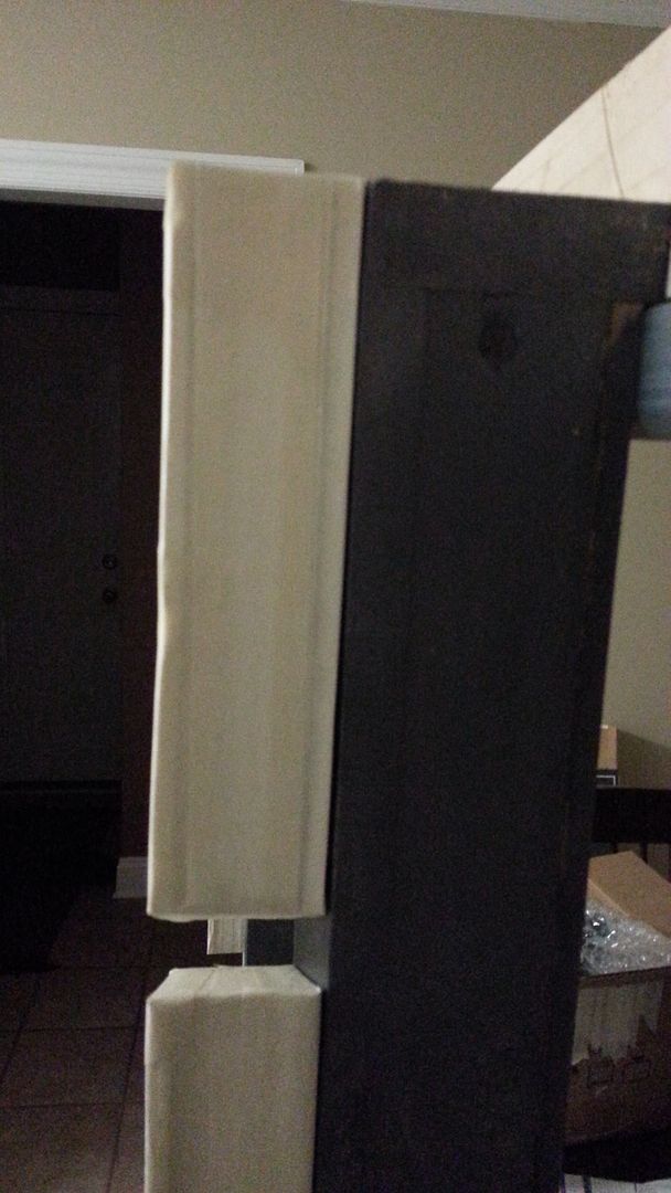

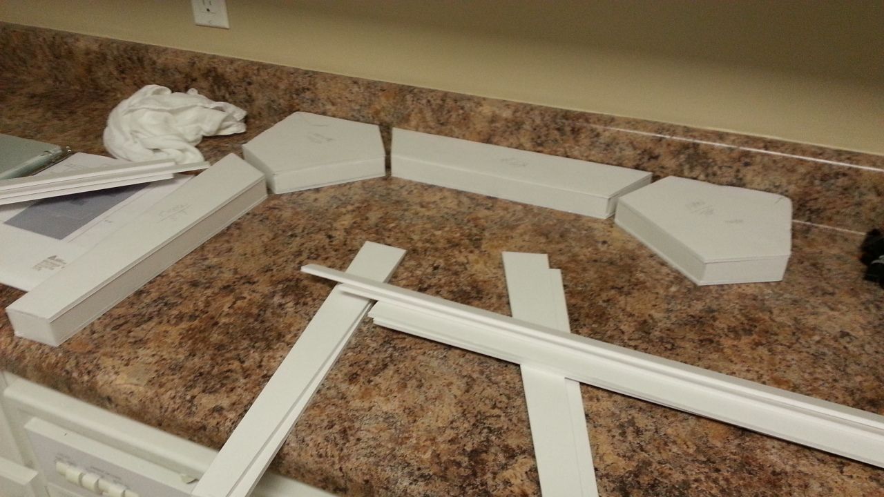

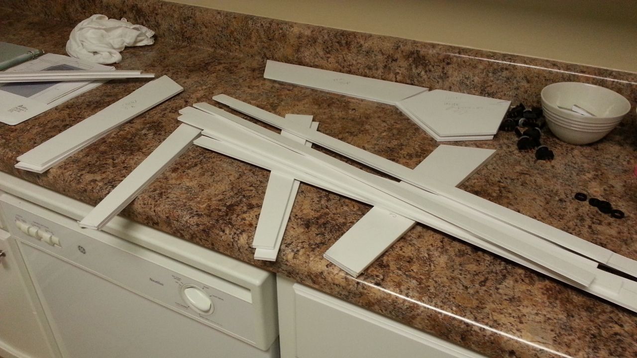

Hi Gang,

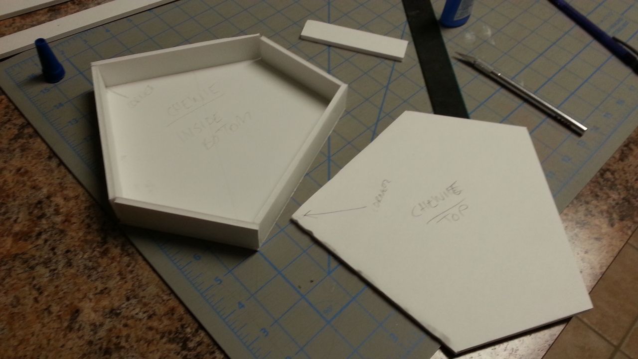

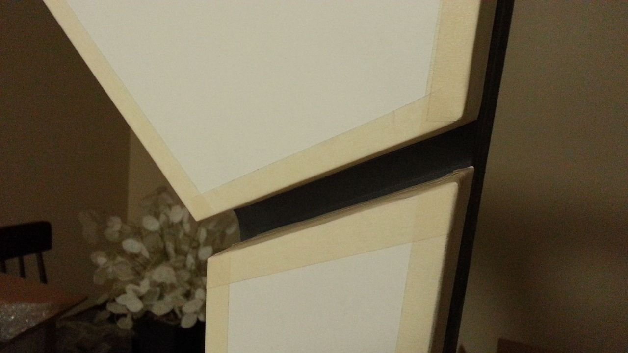

Well... the shapes for the door padding have been created! I'm going to blast them with a coat of the black primer tomorrow morning. I'm hoping the texture will cover the tape and the minor imperfections in the foam core. Then I will paint with a rubber spray paint then a tan spray... then weather... whew...
I cut ALL the padding shapes from foam core
Marked them up and then created boxes
One right after the next
Until they were all finished
I taped up all the edges using simple masking tape. I'm hoping the primer will cover everything
Whew... I'm pooped... Off to bed

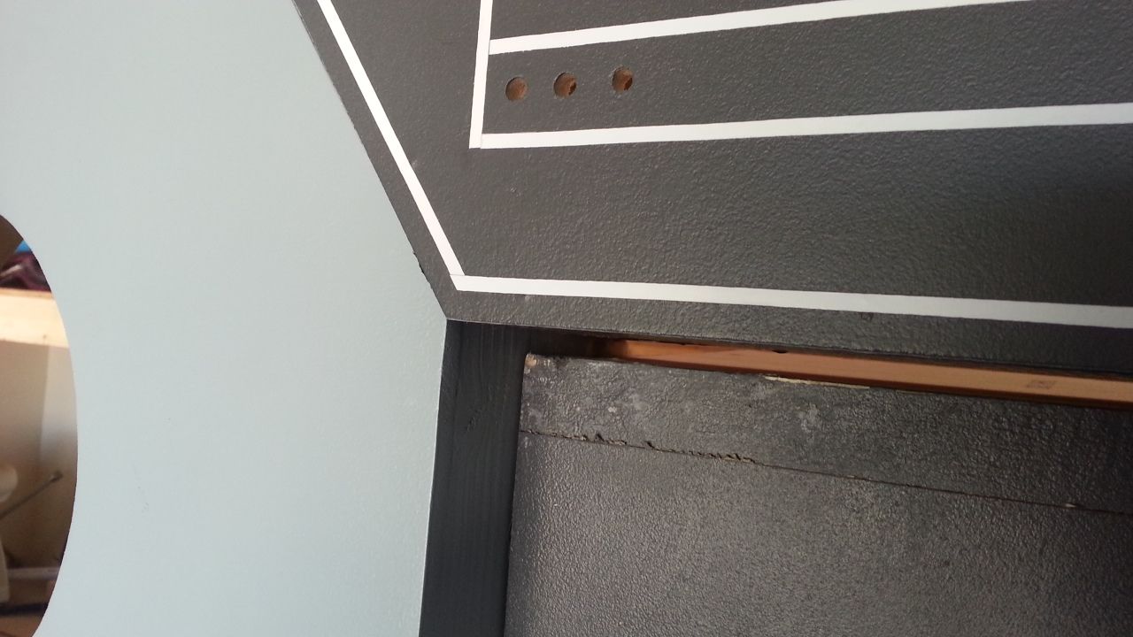

Hi Gang,

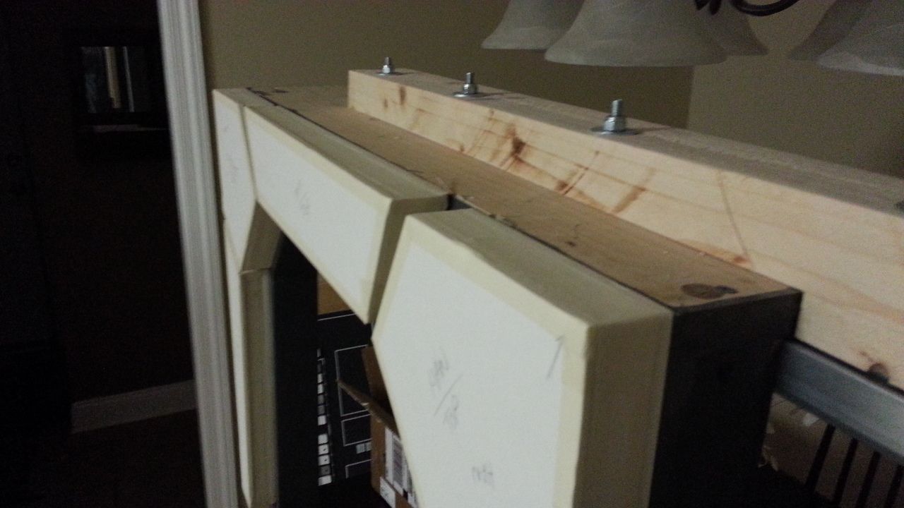

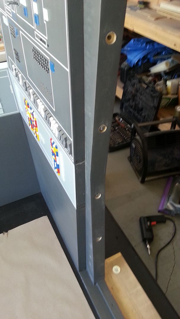

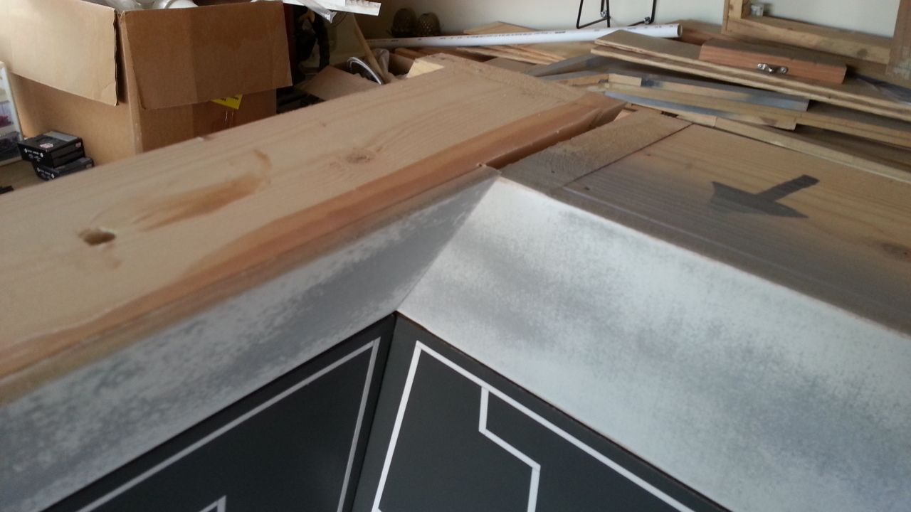

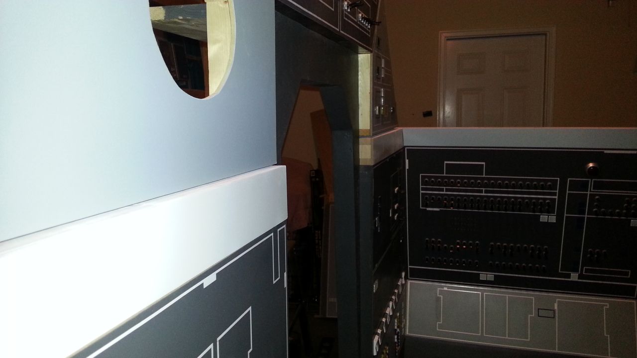

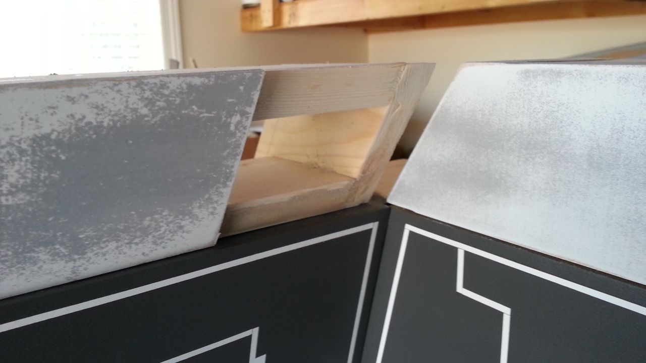

Well... I don't know what happened, how it happened or when it happened but the door frame is just not fitting the way it should/used to... I have no choice to but to cut down the frame and hope for the best... ugh... I should be working on the canopy right now! GRRRRRR ;)

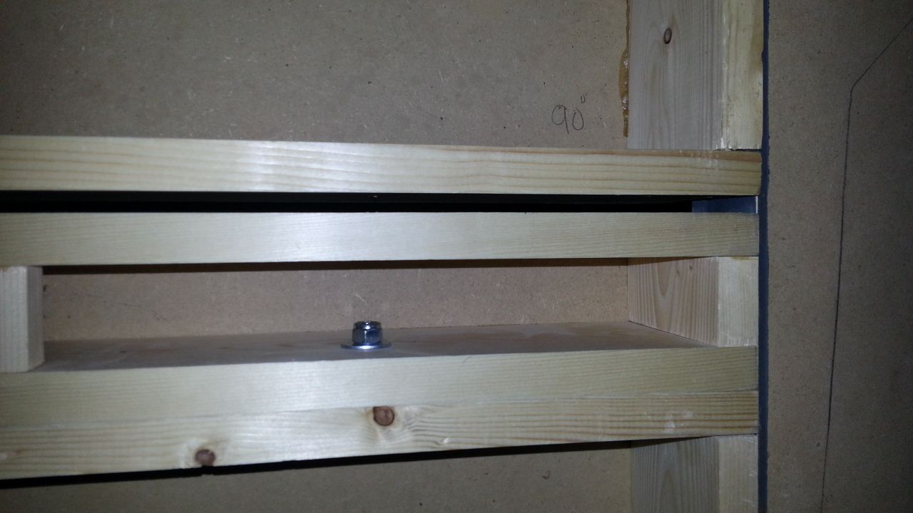

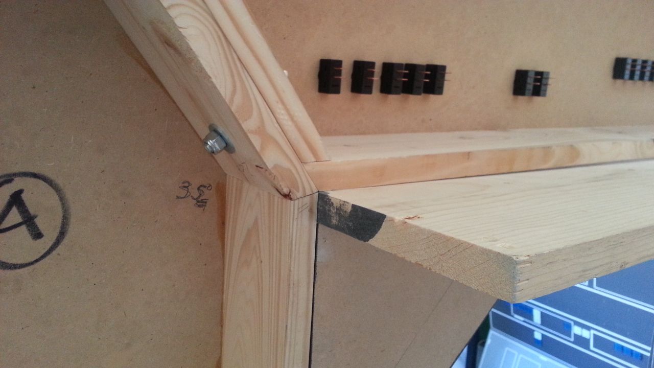

OK... So... Just like the original I drilled and created counter sunk holes to attach the door frame to side the sides of the back panels. I HOPED this would have solved the warping issue. As a result, I wound up having to reinforce ALL the panels with extra screws because the frame had warped SO BAD it was cracking the glue and pulling braids out... But, it does look cool! Trying to stay positive!

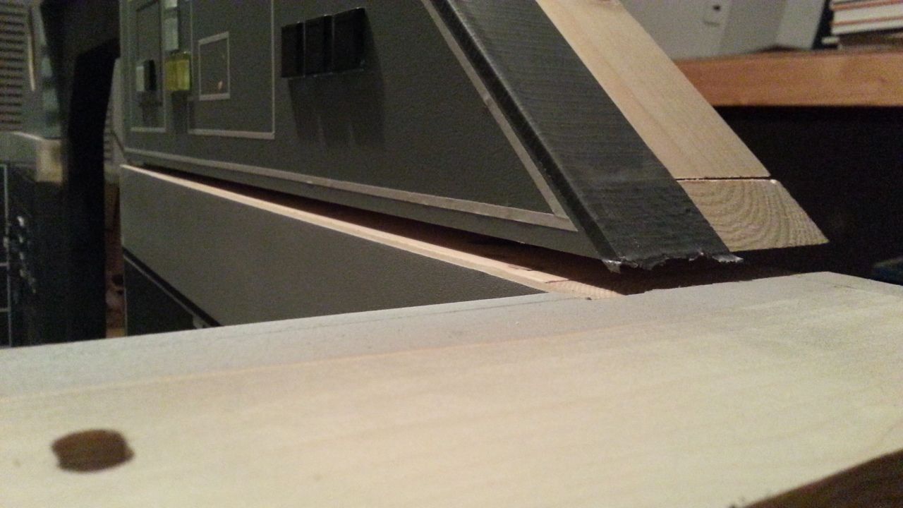

Here are the problem areas. To the right and left of the top of the door frame you can see how off the measurement is. I'm going to take the worst side and just cut off the problem area - let's hope this works!
Han's Side
Chewie Side
They are about 1/8 - 1/4 in off. I'm just going to cut the top off and again... hope for the best.
ALSO... This changes the length of the door itself which means I now have to remove MORE material from the door
Stand By!

Hi Gang,

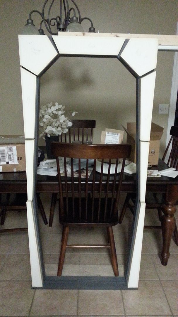

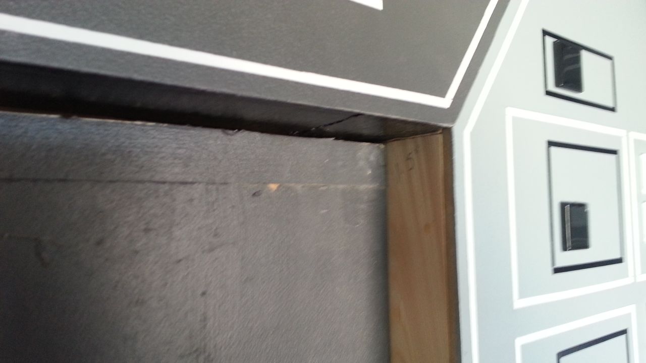

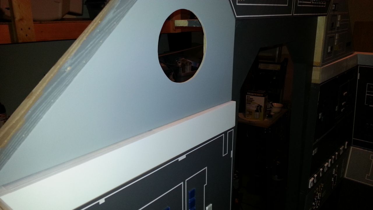

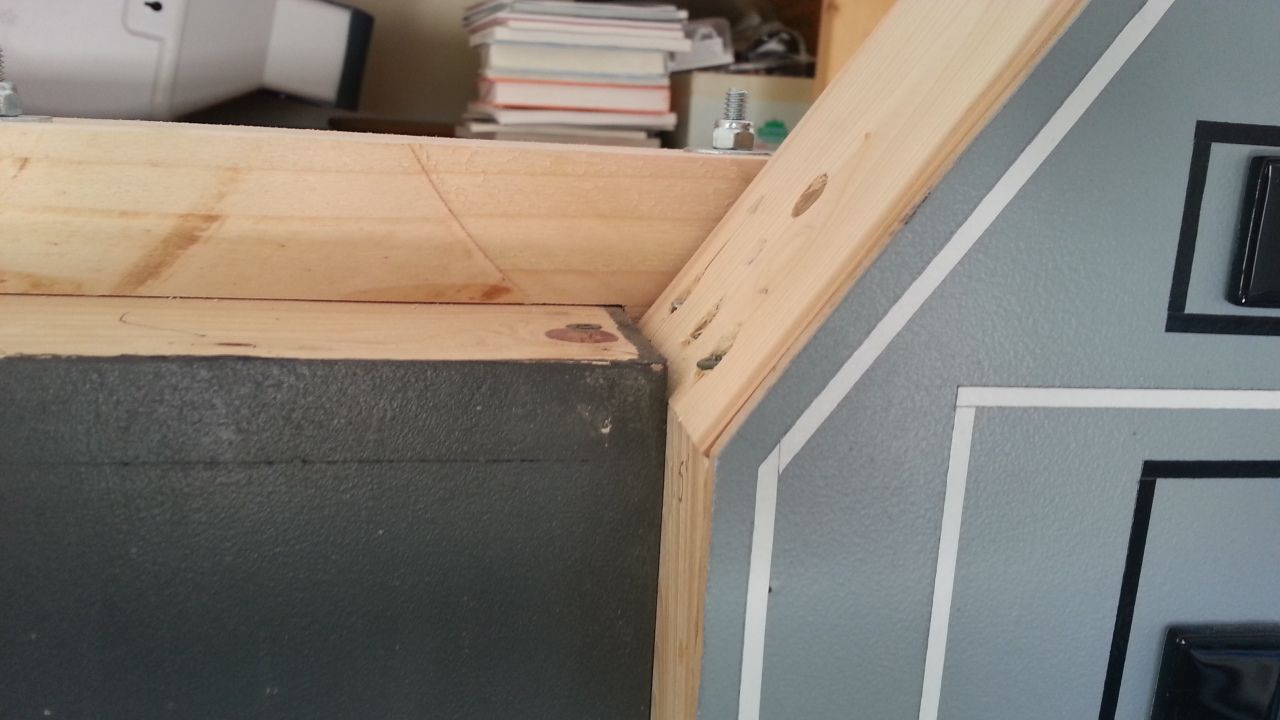

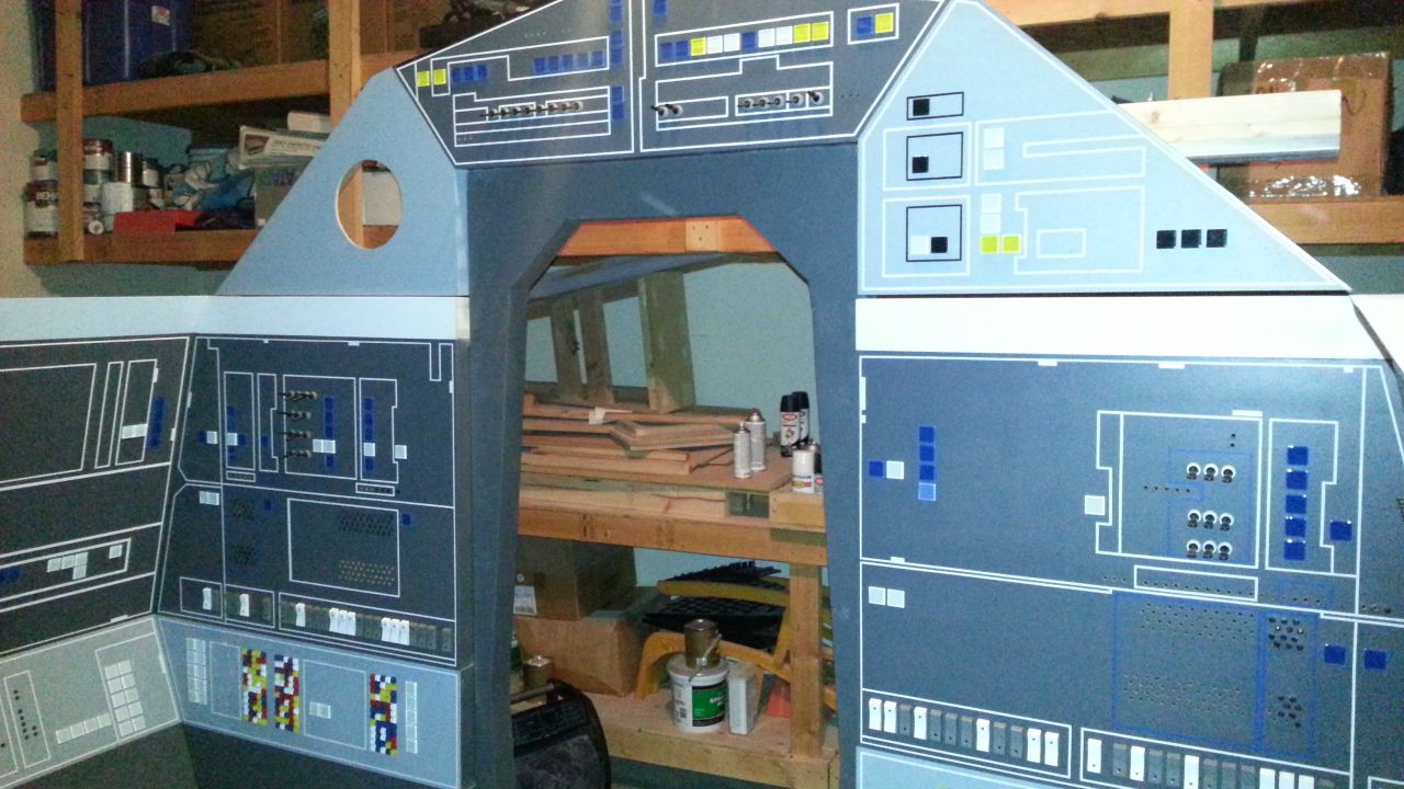

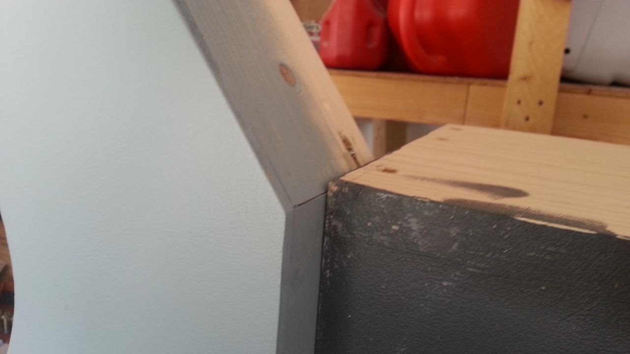

Well... I cut the top of the door frame off and the spacing issue is NOW resolved! YEAH!!!! But there is now a HUGE gap... BOOOO... But I can fill it with foam padding and all will be fine... YEAH!!!! But I have fallen way behind... BOOOOO...
I really don't know what happened and why or which panel(s) warped... The good news, I can FINALLY work on the canopy
Looking from behind at the door frame - Han's side
Chewie's side - note the gap - ugh...
Han's side from the front
Chewie's side from the front - I'll just fill it with black foam tape and the door padding will cover it up so all is well

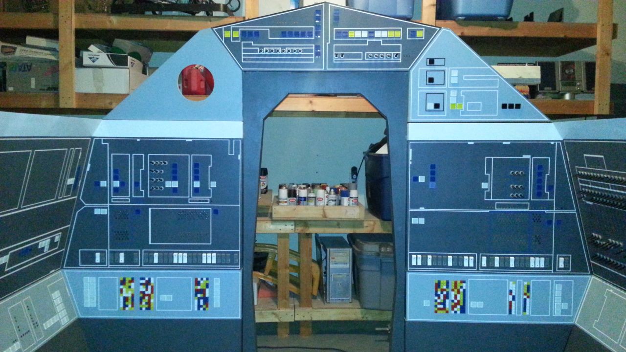

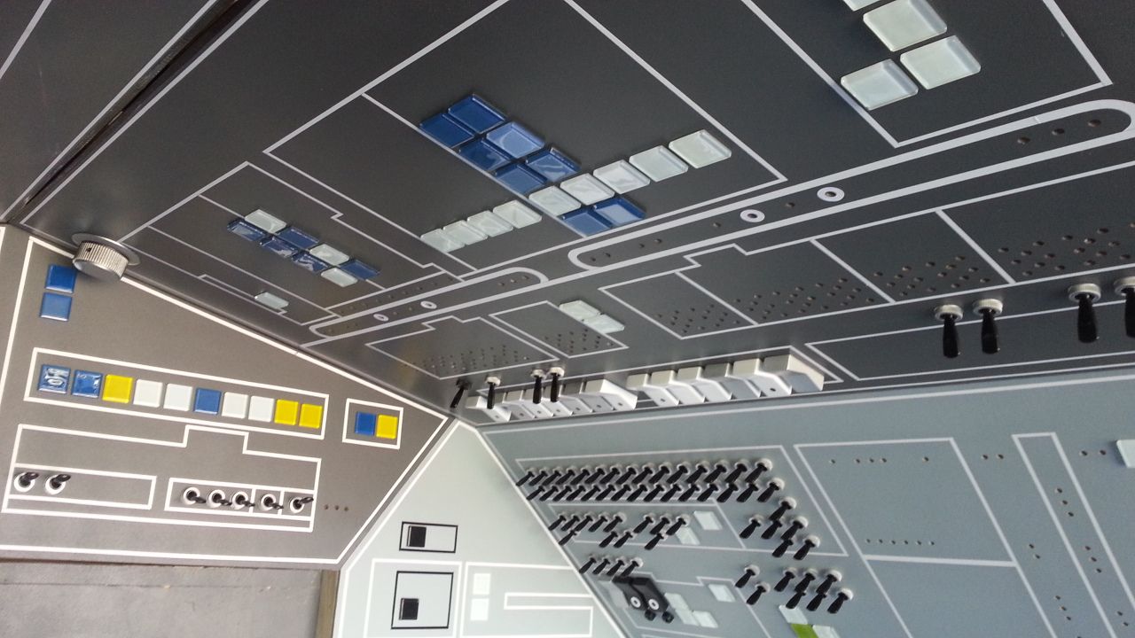

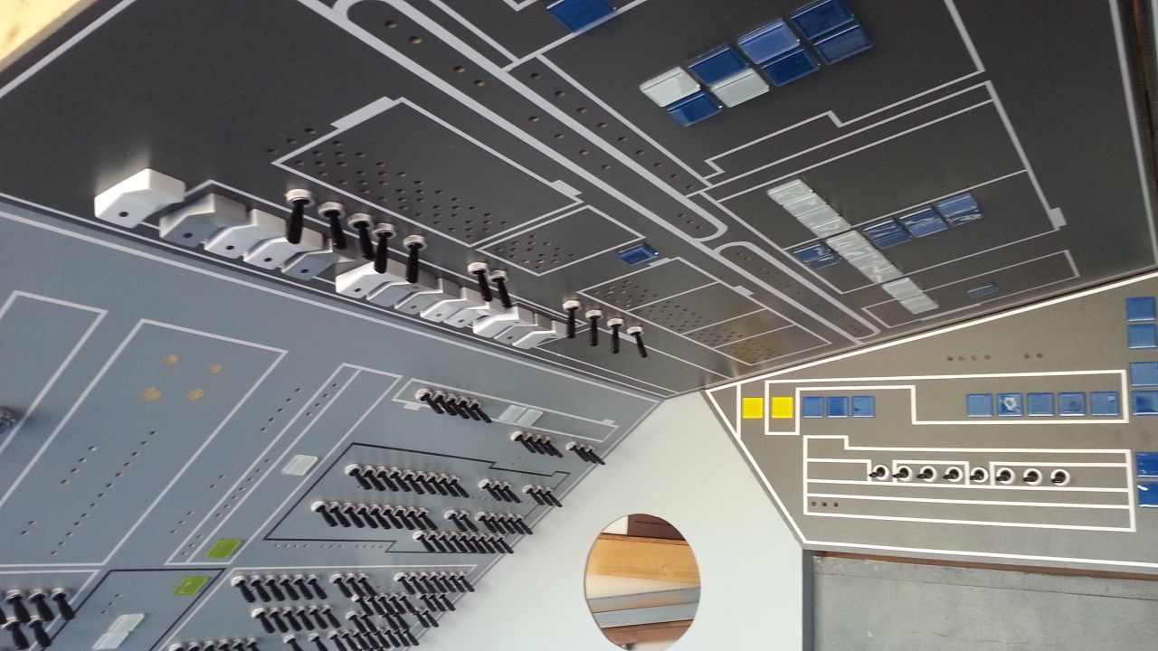

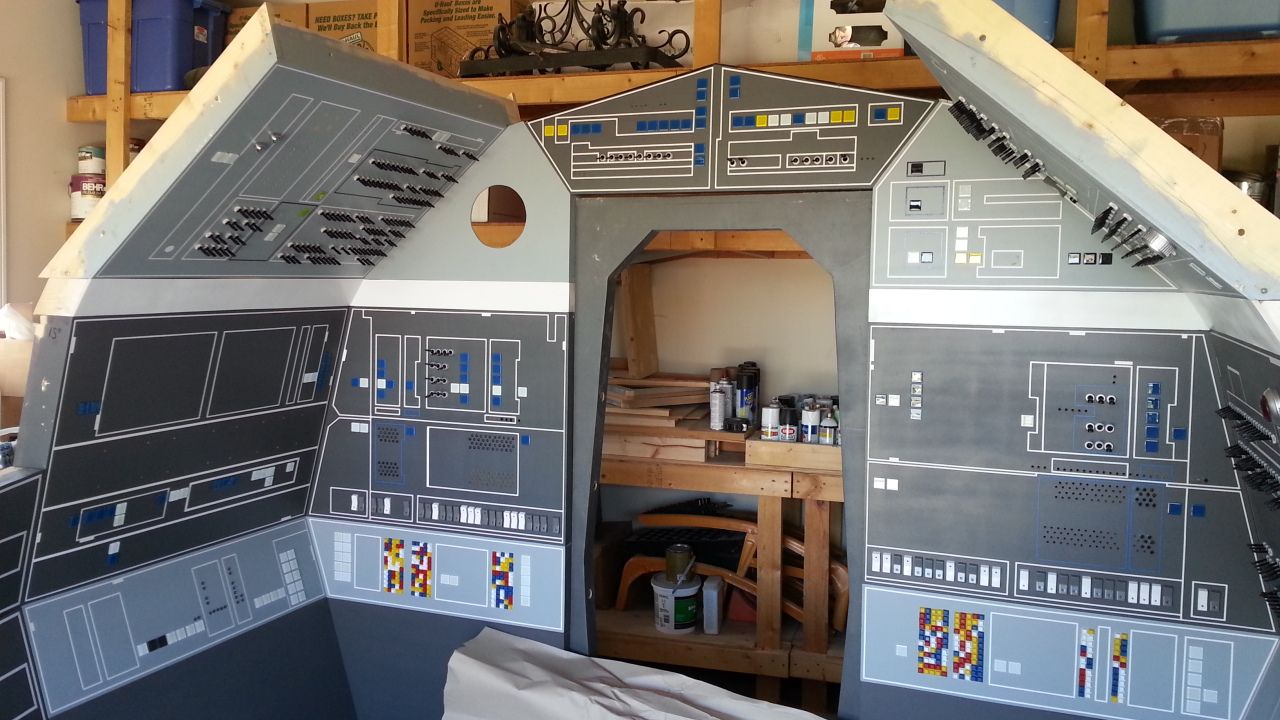

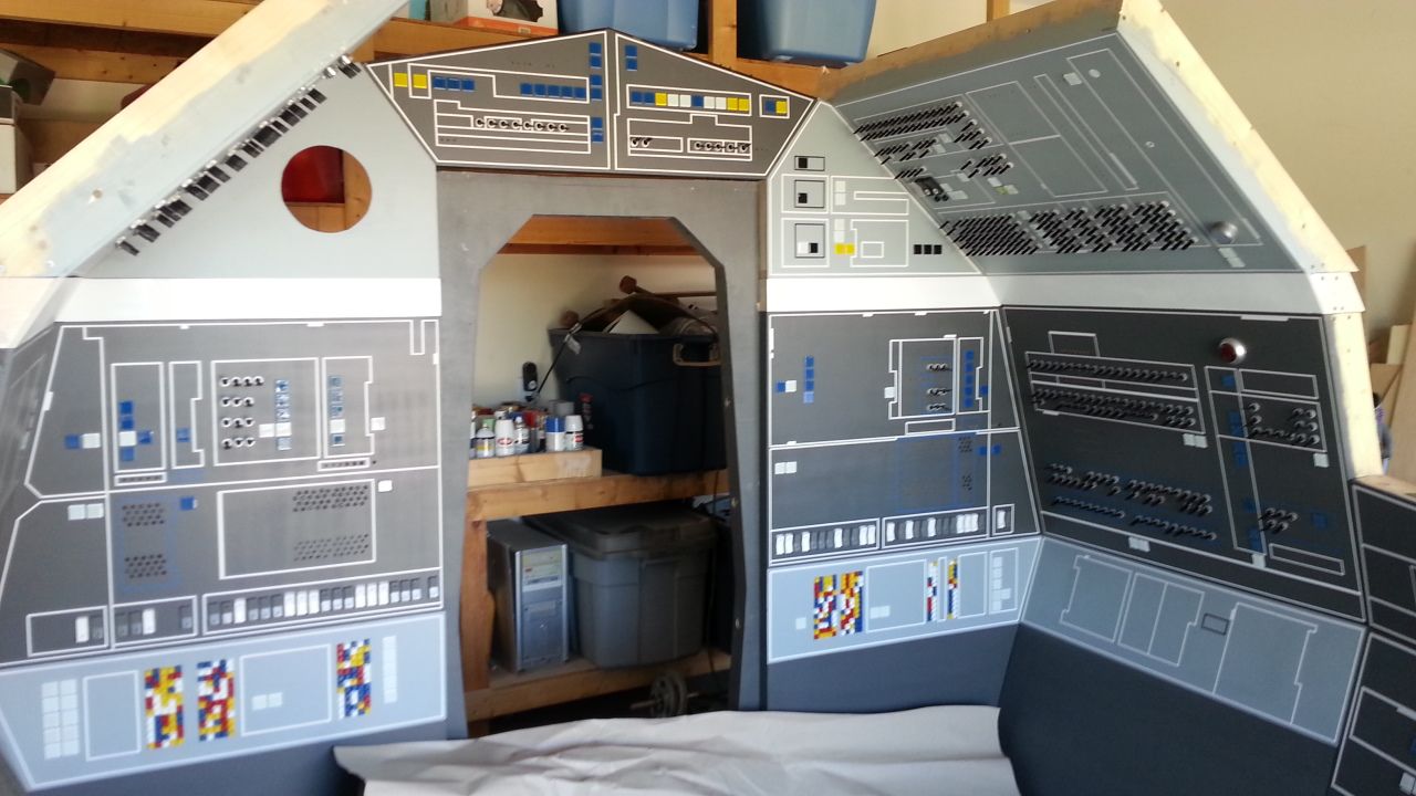

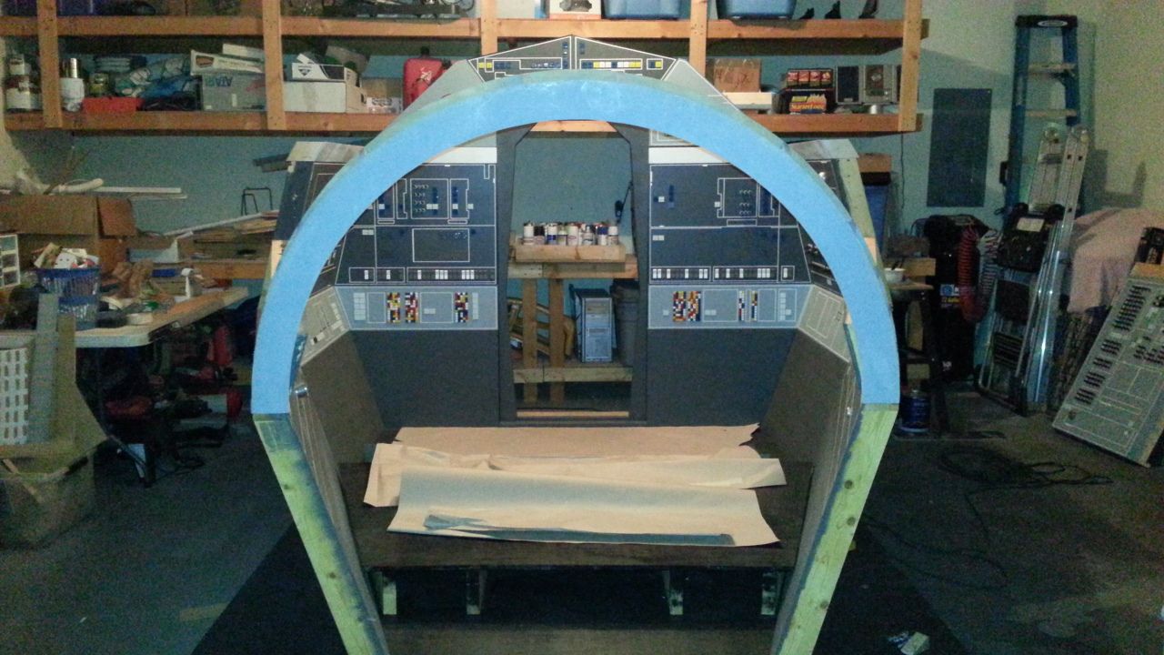

Re: 1:1 Millennium Falcon Console Replica

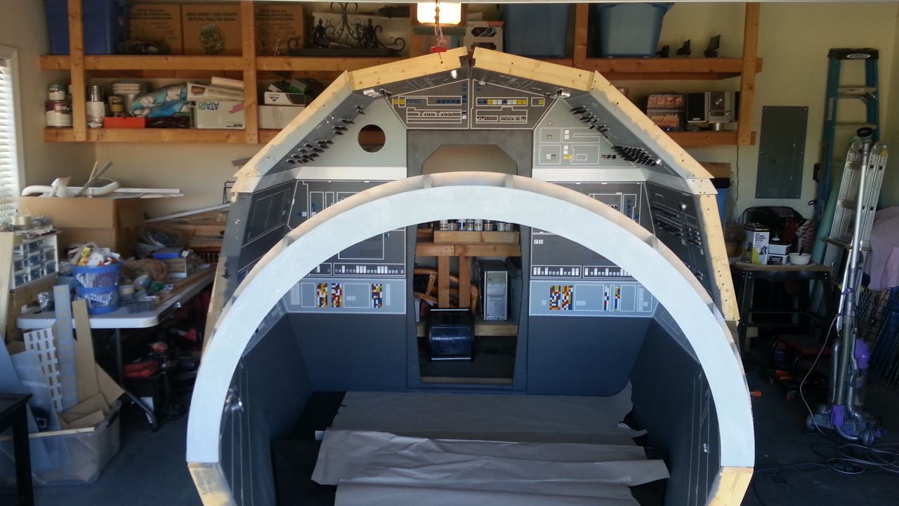

Man... this last panel was a BUGGER!!! But we have a cockpit - now the canopy can begin!
There were SO MANY gaps when I placed the final top two panels I did NOT think everything would finally marry up...
I'm beat... But it's a fantastic day! Sunny, low 80s and low humidity. Doesn't get any better!
More to Follow!

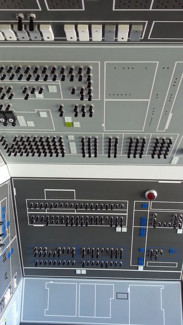

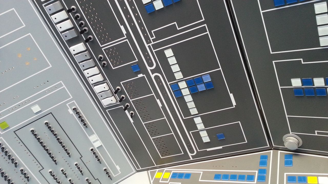

How do you possibly manage to not break off any of those toggles?!?!?! That's amazing in itself.
