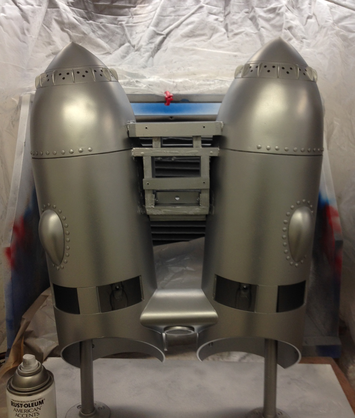

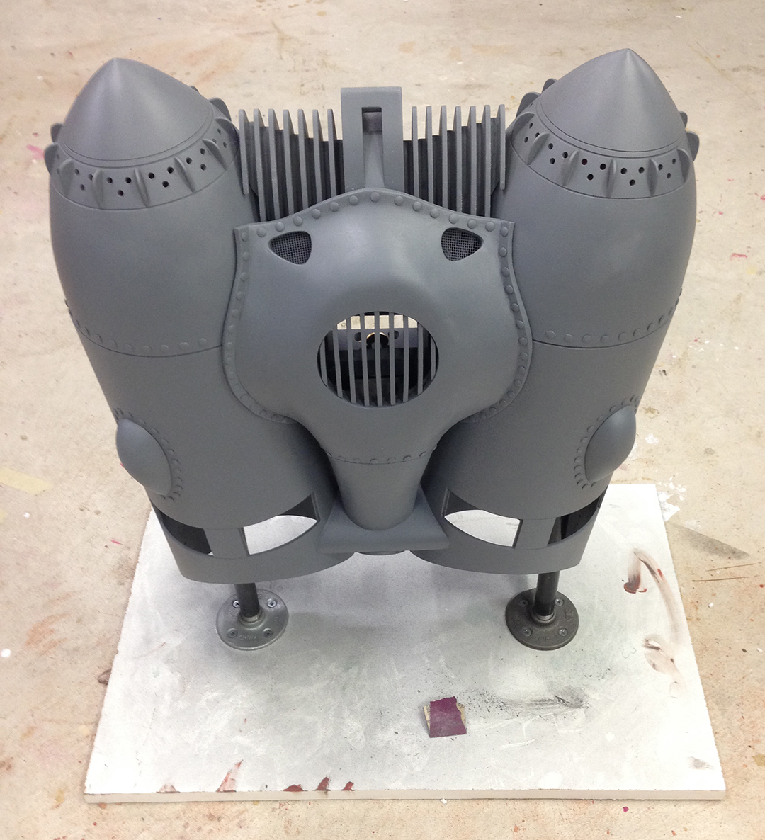

Beginning with a good prime. Also starting to test out some silver rattle cans.
Valor, this might be a stupid question, but how did/do you ensure adequate coverage with the primer in all those vents/slats/nooks/crannies, while avoiding getting it too thick and/or drippy on the more accessible areas?
Thnx. :thumbsup :cool
It wasn't too hard. And what you see in that shot are three pieces that I primed separately –*The front piece, the top radiator and the body. It's really about moving all around it and shooting from different angles. And spraying light coats.

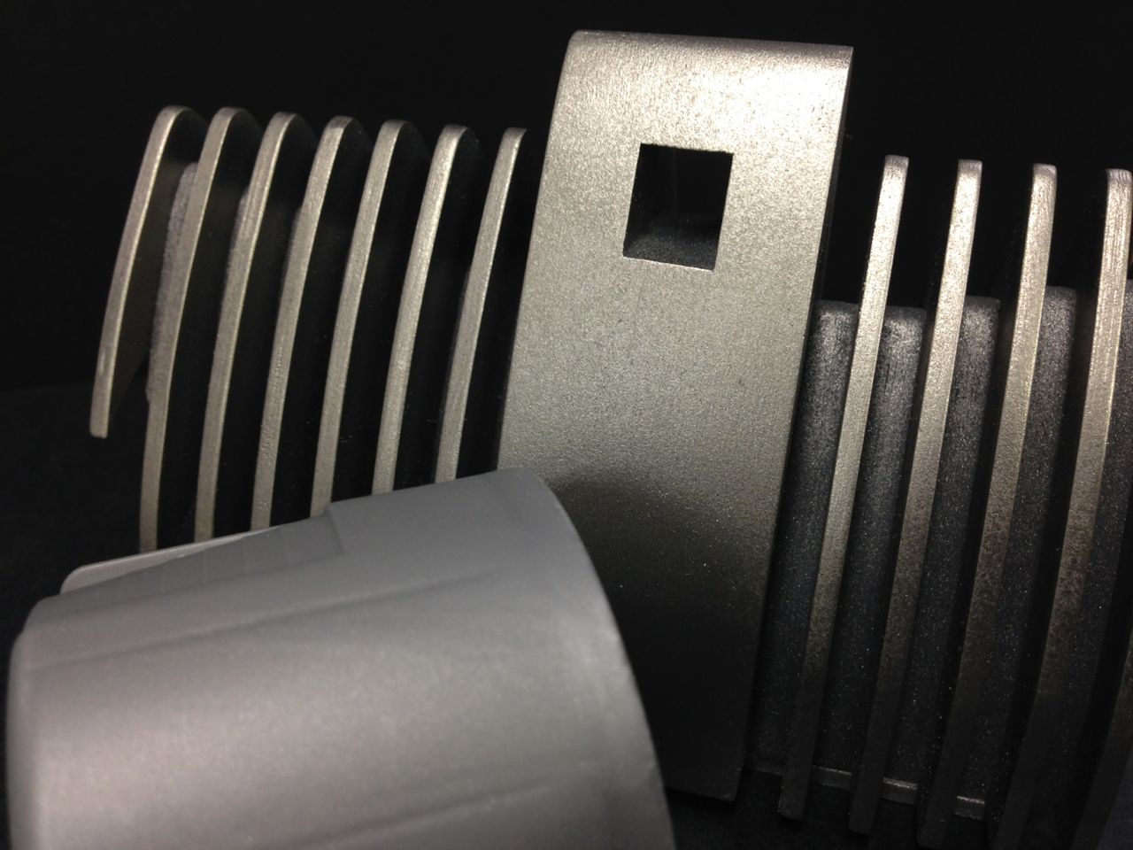

Funny you should mention that. :) My goal for the silver is a satin metallic silver. Not chrome and shiney. More vintage.
Here's what I found that I think I love. It's called Champagne Silver from Modern Metals. I found it at Michaels. Its not cheap and comes in small cans, but it performs really well. It dries in minutes and the can promises a tough finish that won't scratch and doesn't need a clearcoat.
Amazon.com: Design Master Modern Metals, Champagne Silver: Arts, Crafts & Sewing

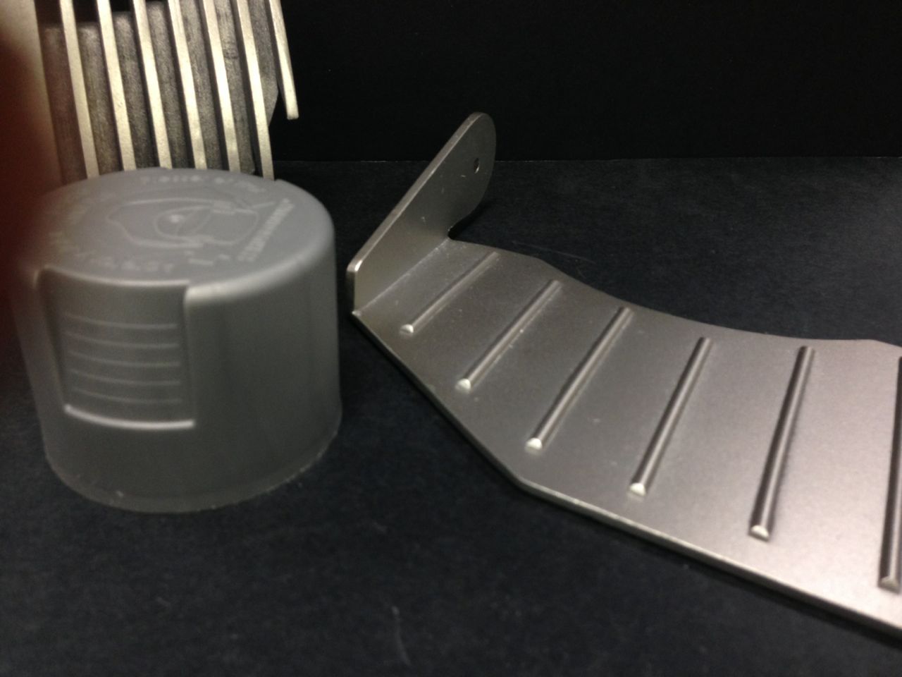

It's not a neutral silver, it has a tiny hint of gold in it. Real subtle, like a warm silver. The photos below show it next to a cap from a Rustoleum silver, and a piece I sprayed sitting on a piece of raw aluminum to show the slight hue.
I love the satin (but metallic) finish. And I think I like the slight warm cast to the color. It feels like a throwback color. Like a 30s-40s color. Or even like the pack has a bit of a vintage patina to it. Something different from the other lacks I've seen. I'm going to live with the couple pieces I've sprayed for a few days. Take them into different lighting, indoors, outdoors. Make damn sure I can live with the color.

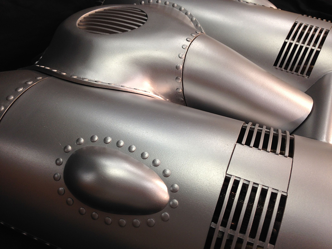

Not sure how fancy. It does spray really clean. And the small can covers quite a bit. The can says "The first coat goes on transparent. The second coat is opaque." And that's what's I've noticed. It really only takes 3-4 light coats to look great.
Well, the "Champagne Silver" didn't sit with me well. Overall I didn't like the gold cast it had. It was beautiful, but not very true to the look of the pack.

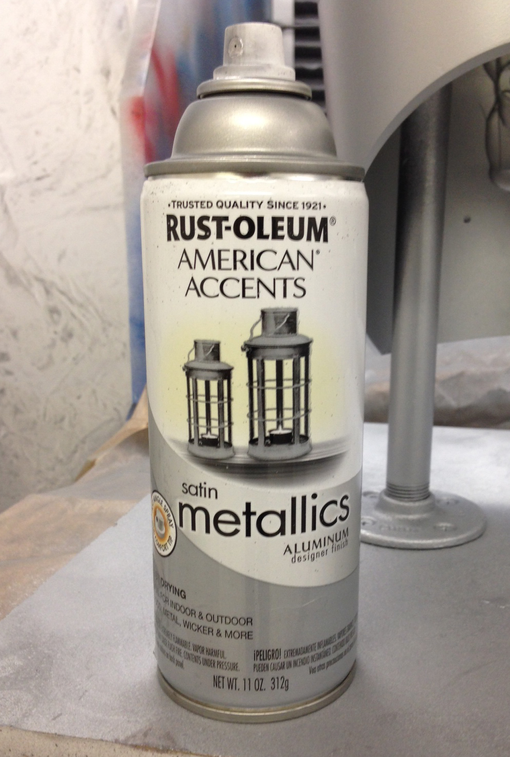

So, ofter trying a bunch of silver/aluminum colors, I settled on this Rustoleum Satin Aluminum. I'm shooting the pack today. Hopefully I can post some assembled pics later this week. And holy crap, does the silver paint ever show the areas I missed with the spot filler :(
I'm still debating how much weathering I put into her.

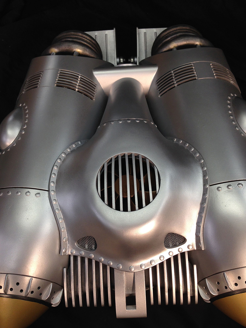

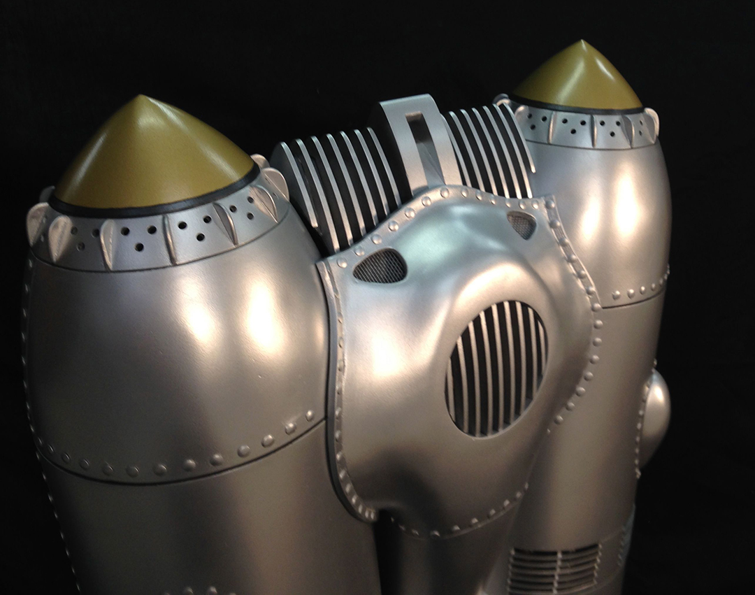

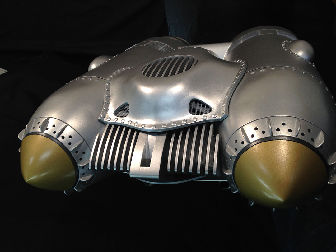

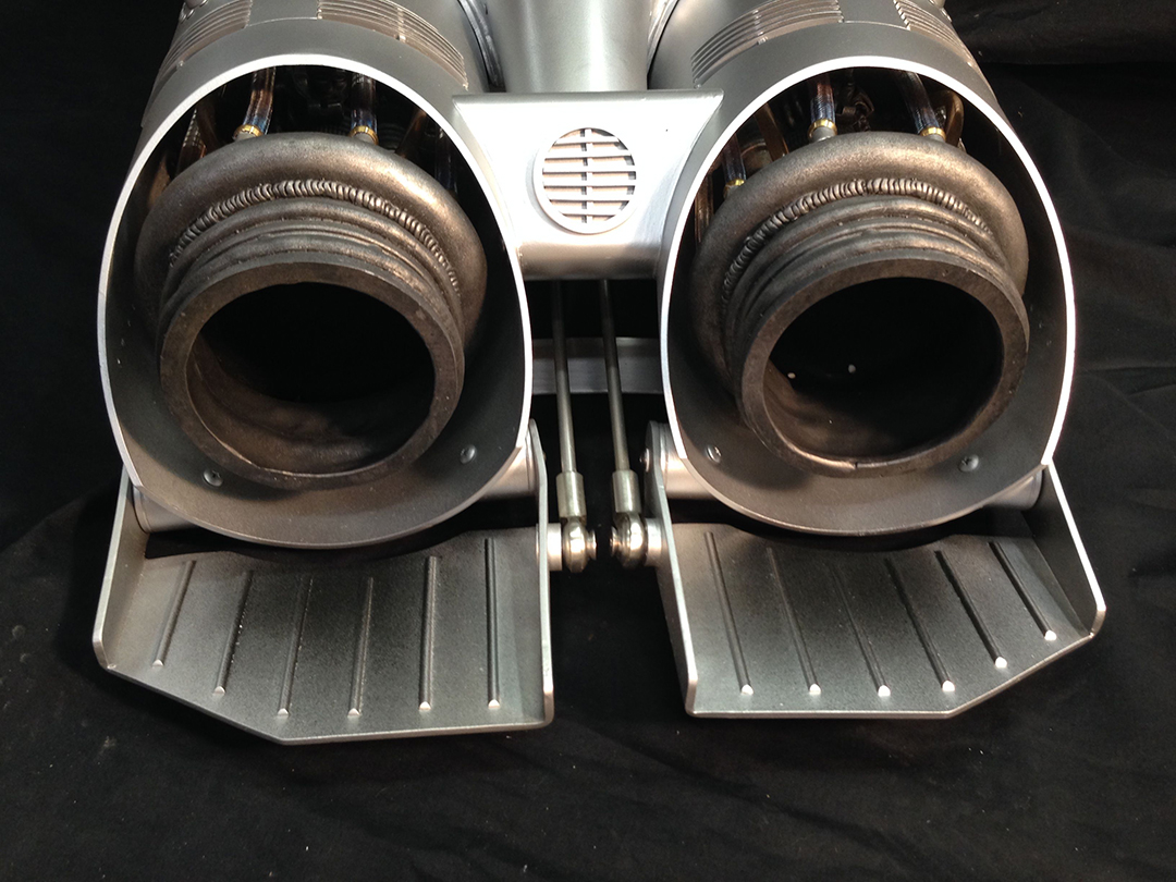

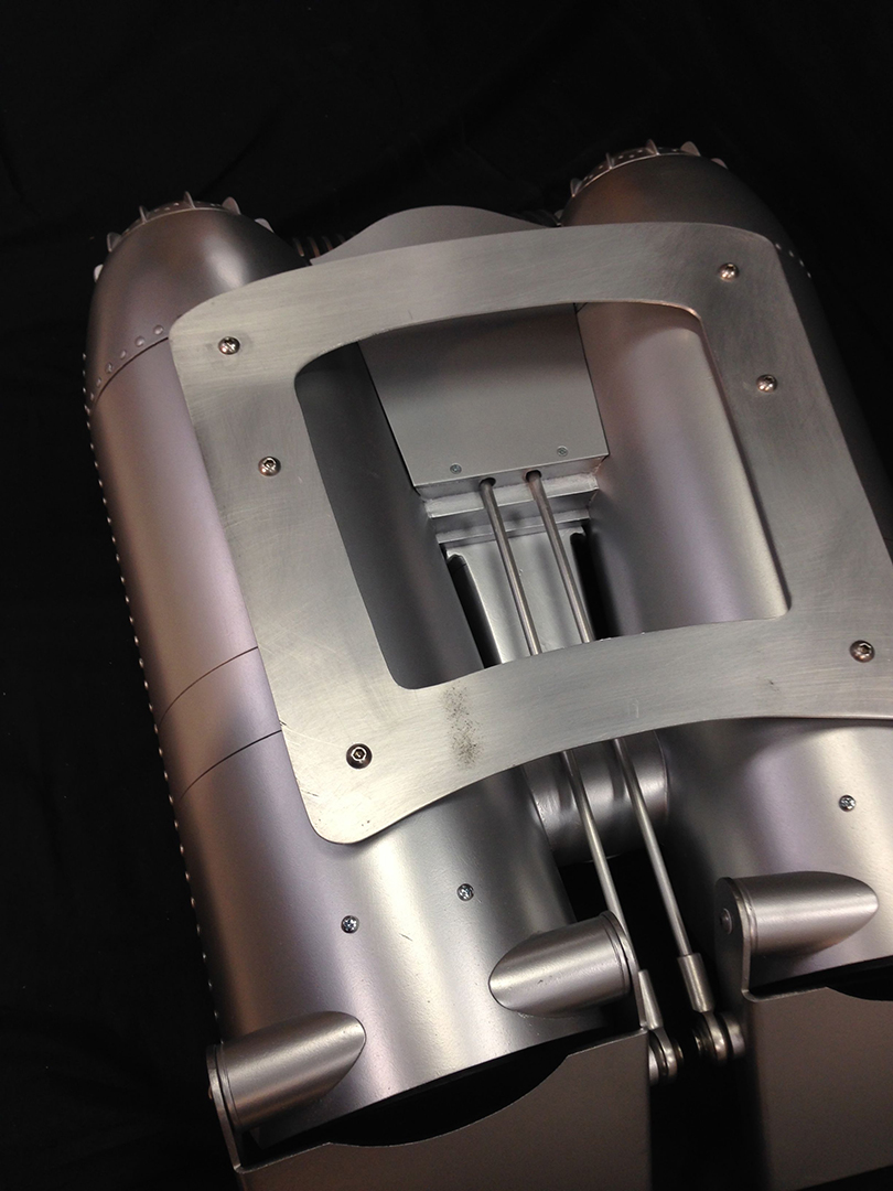

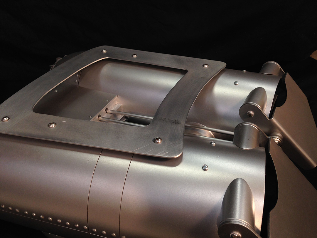

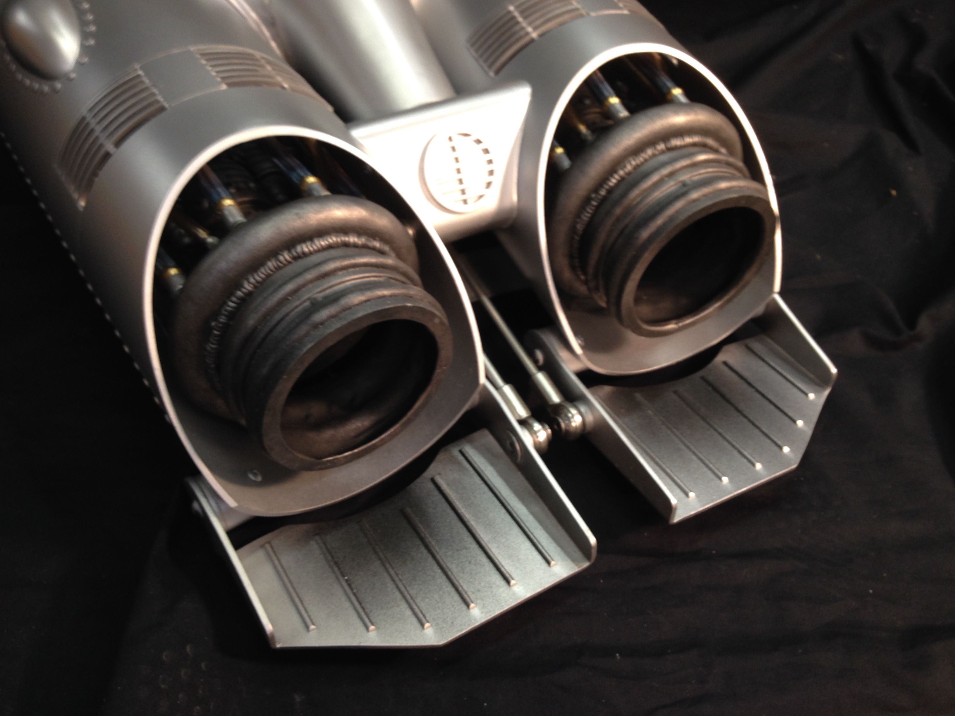

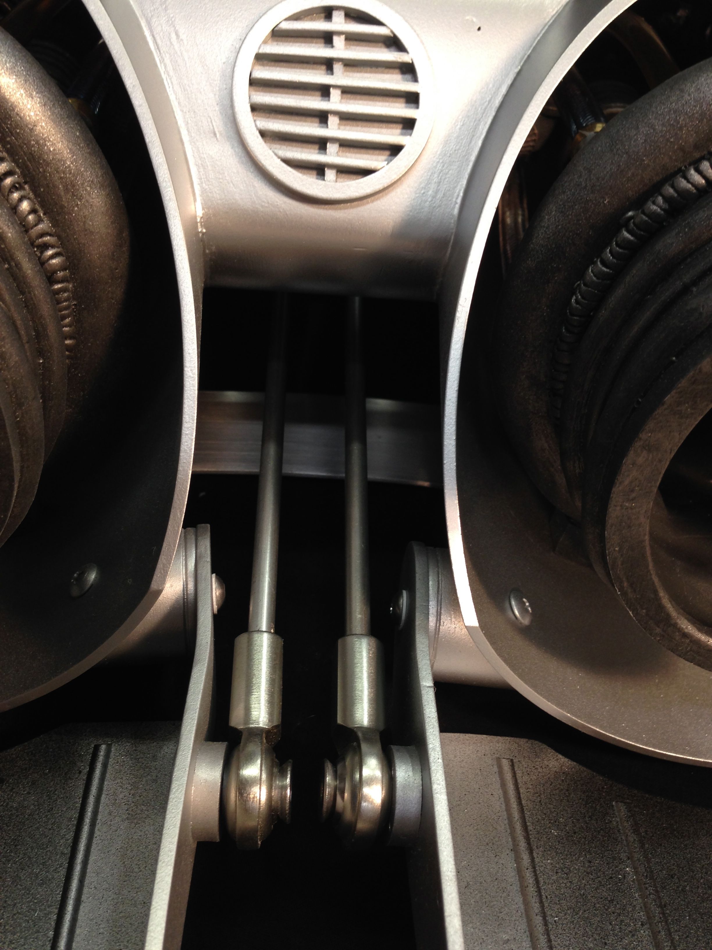

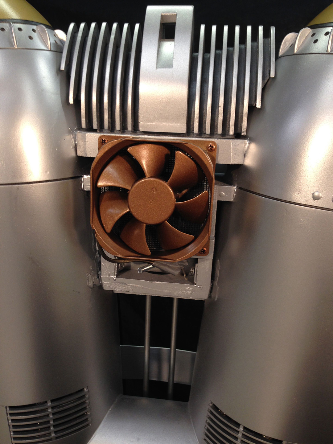

Okay .... drum roll! Here's my complete Cirrus X-3. The build and paint is complete. Still some details to fuss over. Some small imperfections in the finish to address. But ... it's "done".
I love this thing! Build time was about 14 weeks front start to finish. I worked on it almost everyday, even if it was just an hour. Everything is hand made by me ... well, except for the tubes and the control rods on the flaps. I learned a massive amount about molding and casting during the process. This was by far the largest, most time-intensive single build I've ever done.
There are a few things I would have done different if I did it again. But not many. Most things came about pretty successfully. What was really fun about this was the build really consisted of many, many smaller builds. Each with their own challenges. So instead of being intimidated by the overwhelming nature of the project, I could focus on one section, one part at a time. Then move on the the next. The center section of the pack was my biggest challenge and the most rewarding to see come to life.

• Lighting. I bought the LED on adhesive tape asavage recommended. Not sure how to fit it in the rockets. I may try some 12v LED auto fog lights and mount them in each rocket.
• Sound .... Not sure how (or if I want to) to tackle this. I have some advice from people who have done this. But it's an expensive endeavor too. I may live with fan and lights.
