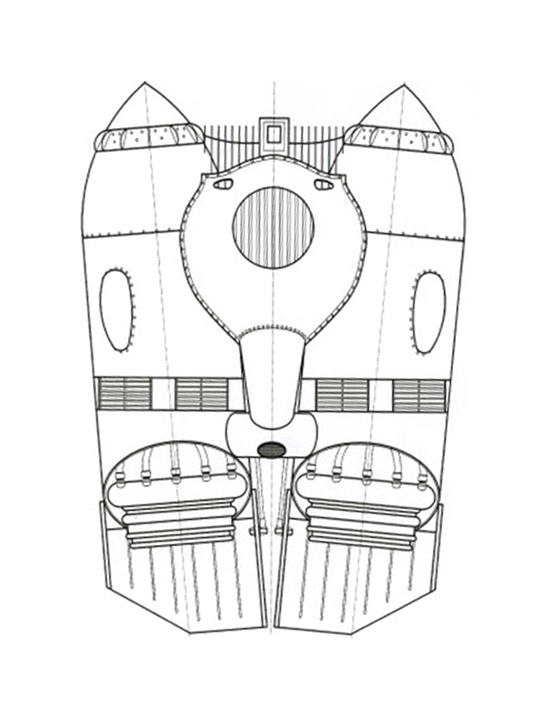

I think I found it here on the RPF. Here's file if you want it.
I'm curious where you got the full size Cirrus X3 diagram from in your first photo on the first page?? is it online?? Thanks for your time!
Thank you!! I've been scouring all over google and here looking for it, I know with Photobucket putting their 3rd party viewing restriction on last year, a ton of the photos in the threads are no longer viewable and really makes for more work trying to find ones uploaded on other host sites

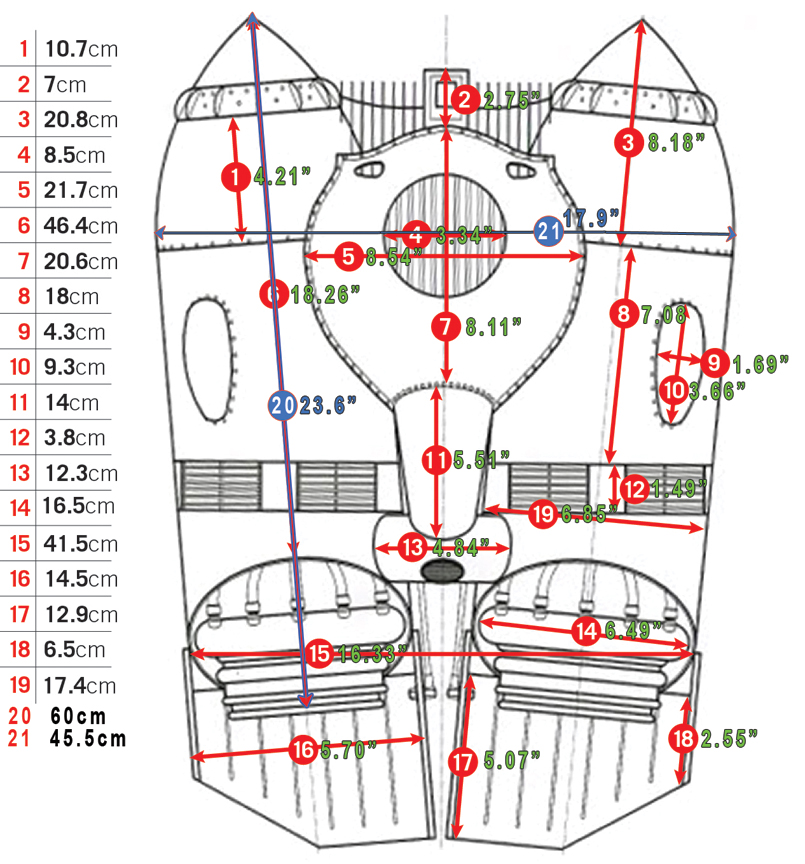

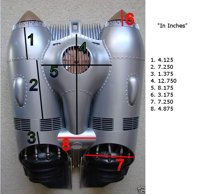

Thank you for displaying and demonstrating all of your hard work. I've tried to build this years ago with disappointing results. It shows that scratch building something out of our dreams is possible. What I had trouble with last time were reference points. Thanks to you and QCWolf we have a set of dimensions to work from. Where did you guys get accurate plans? I thought I read somewhere that you guys had message another RPF member with the full-blown prop and had asked for some "core" dimensions.
A lot of our work comes from extrapolating, figuring out and examining screen captures and eyeballing details when you don't have any other source. I've tried using Adobe Acrobat - Scale measurements - to compare relative dimensions of known parts but that does not work out well. (mostly because of 2D vs 3D perspective difference) What do you recommend to figure out missing dimensions? e.g. bottom length of the backside of the rocket housing. I would guess its about 1" shorter than the engine bell but I have no idea. Or the shape and size of the top radiator fins. Can the PDF be scaled up to the correct proportions?

A couple thought.
One, get every image possible if rocketlacks from every angle. I’m telling you there’s some great reference images out there. And as you said, you do need to extrapolate a few things.
Two, even if you don’t pla in 3D printing your pack a tonifpeople are today. And being able to see those files and spin them around would be helpful.
Three. There’s several Fingead groups in h
Facebook that are very active right now. One is Finheads of Florida. There’s a tone of guys who would help you.
And four. See if there’s someone near you that you could go see their pack in person. Take my word for it, seeing A pack in
Person helps a bunch with some of the geometries.
Good luck.
