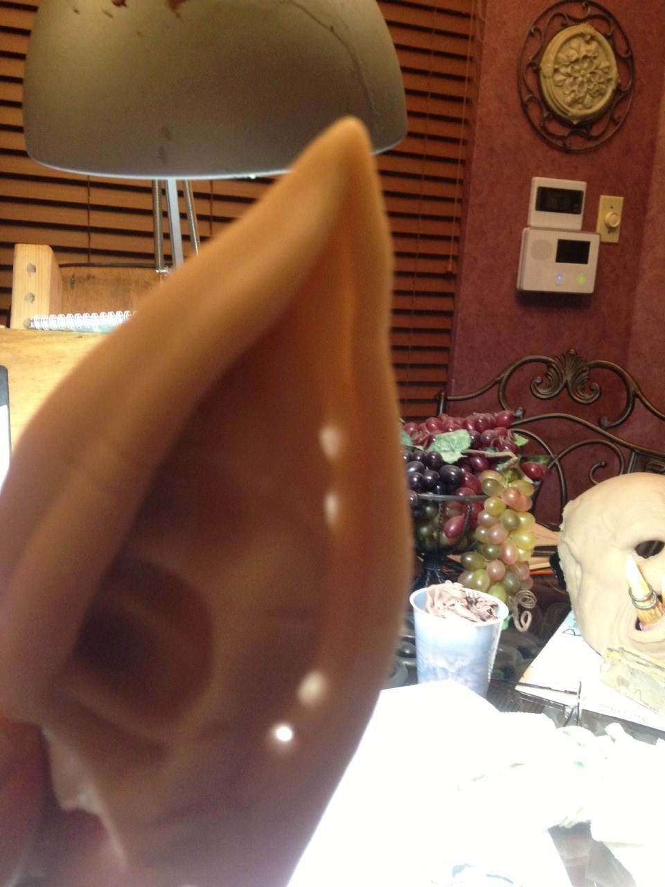

Re: Grommash by Alphatech Last page ear sculpts posted 02/08/2016

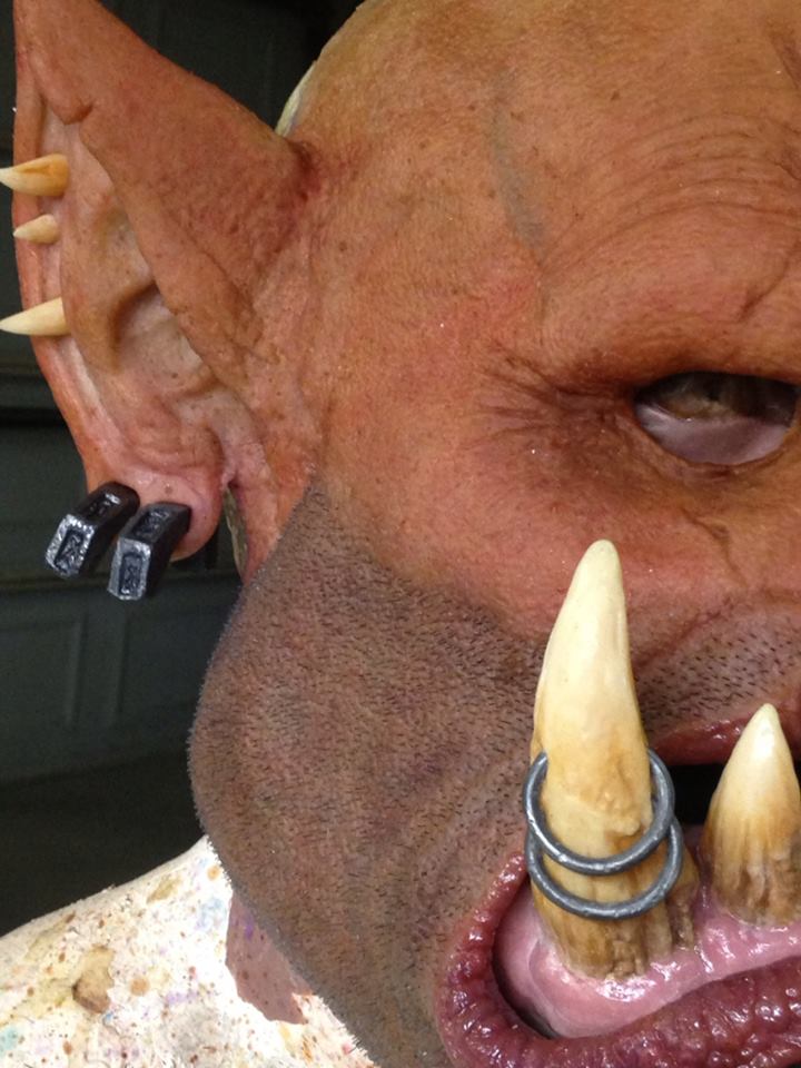

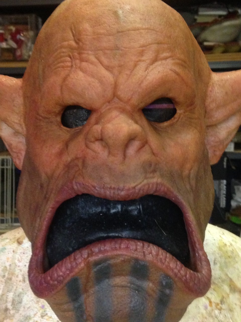

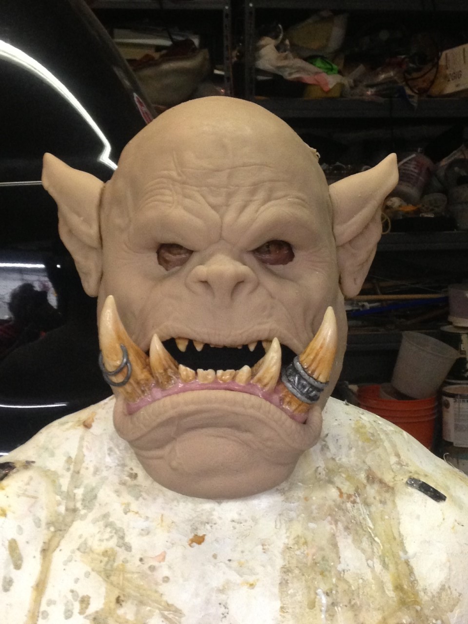

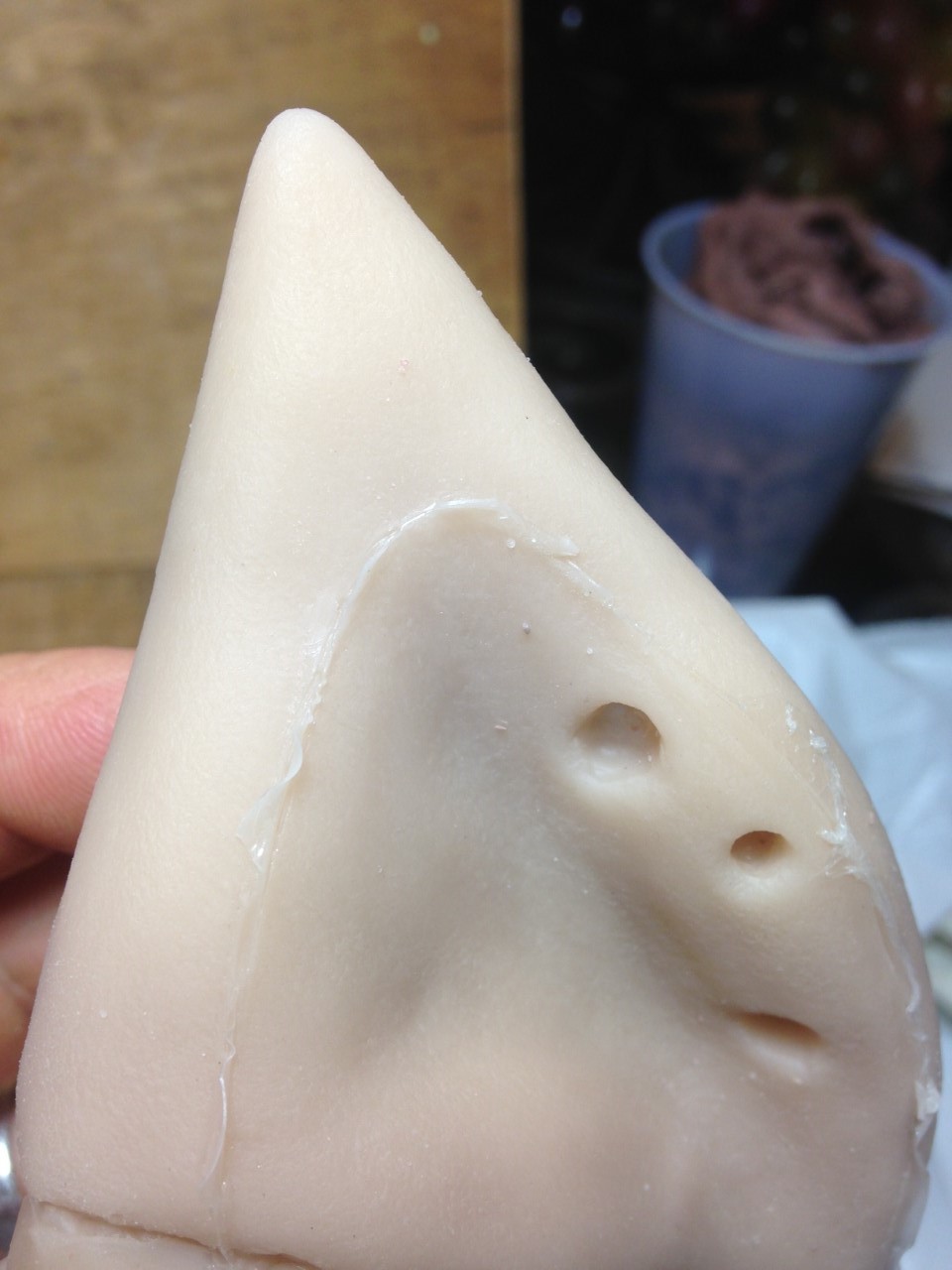

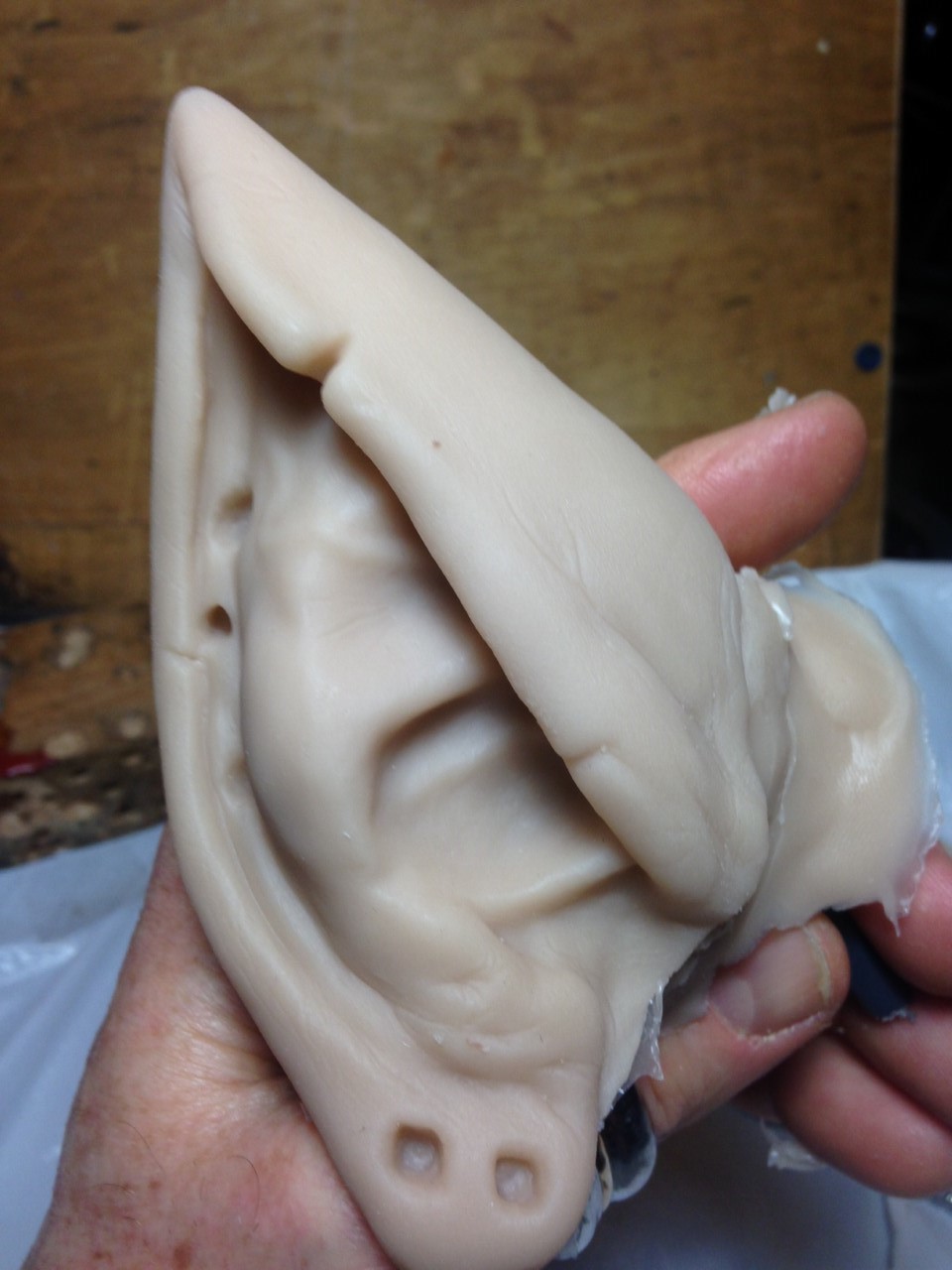

Grommash has ears. I still need to seam them.

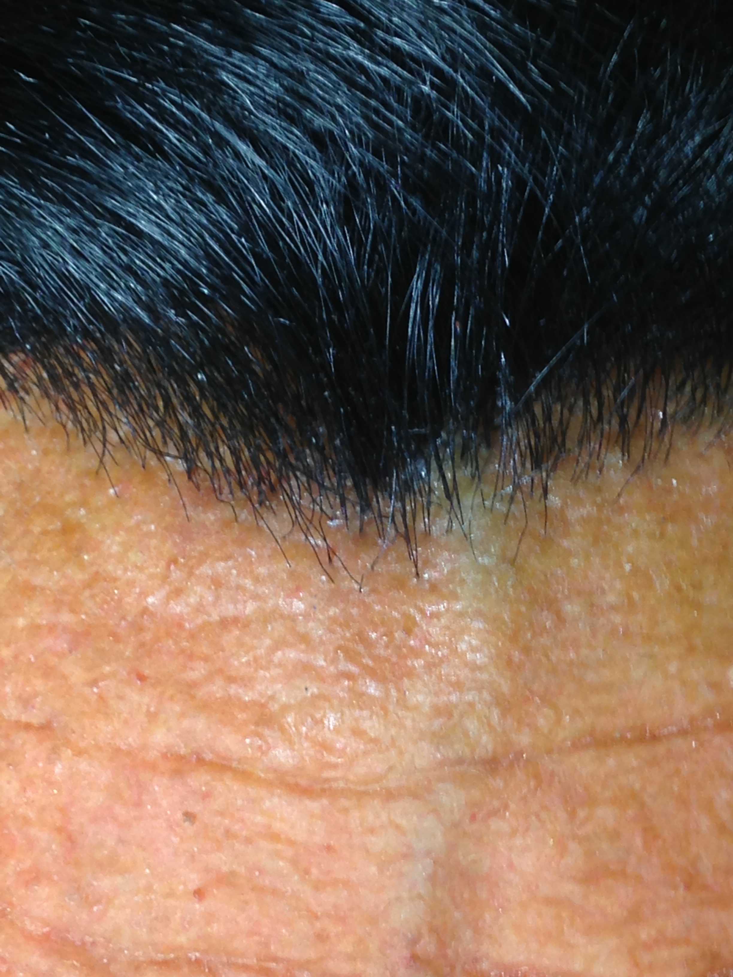

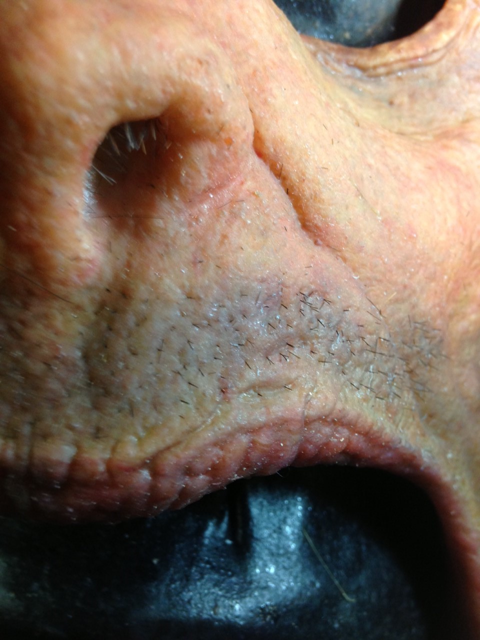

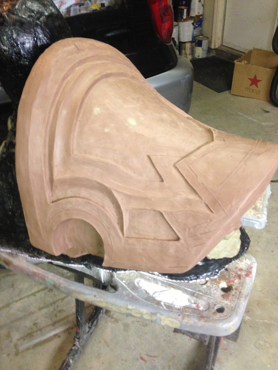

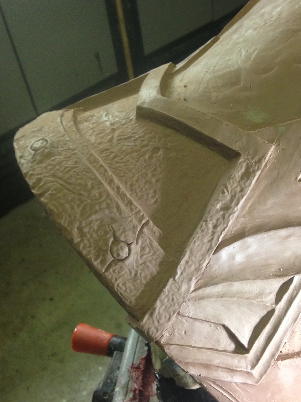

In case anyone was wondering I have not been just sitting around. The last couple of weeks I've been punching hair in that beard. I try to spend a couple hours a day. It is almost done. In the mean time I've been working on the shoulder armor.

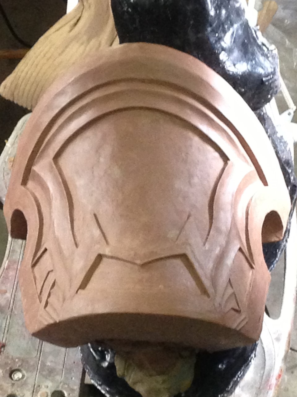

Initially I was working in this direction.
As I was looking around on line for anything Grommash I stumbled across this photo.

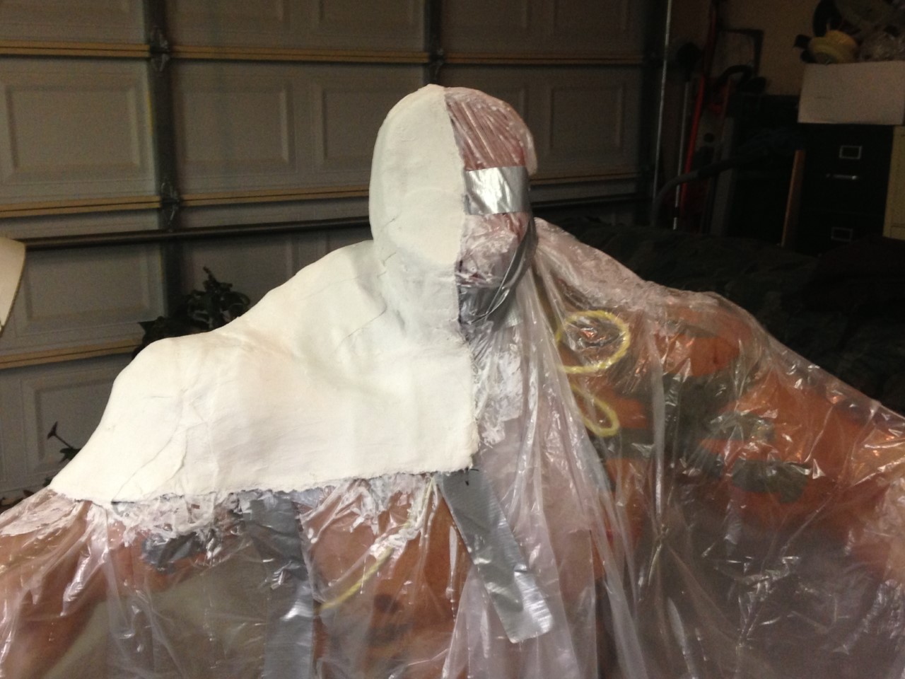

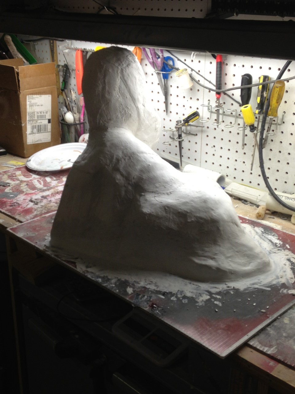

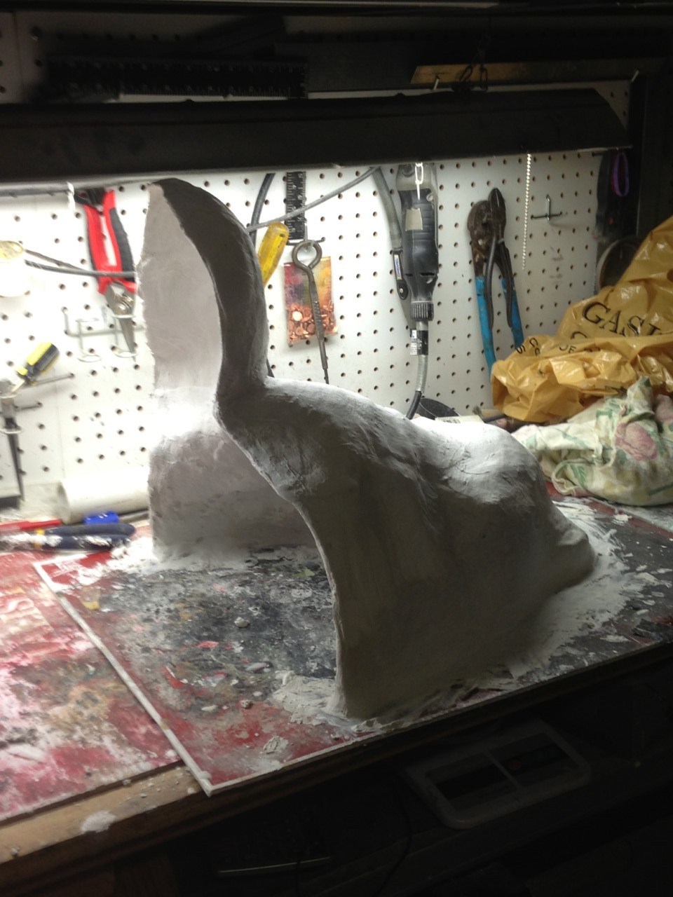

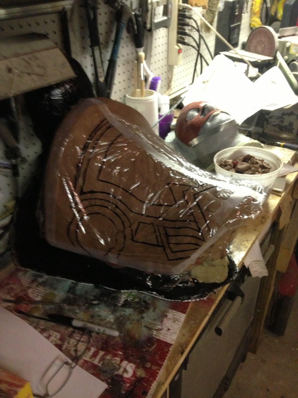

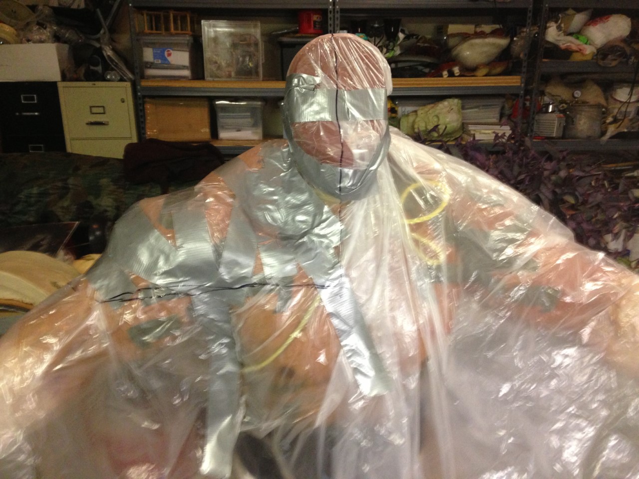

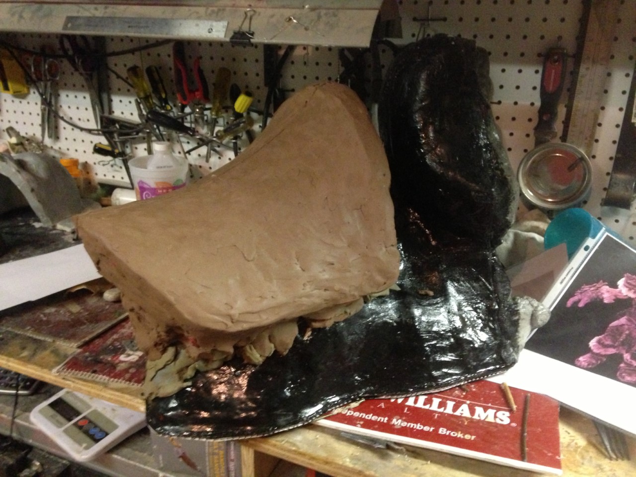

As soon as I saw this I knew this is what I wanted to sculpt. I thank who ever created this. The first thing I needed to do was create something to sculpt on. I covered the torso with plastic and made an armature with plaster bandages. I then filled the plaster shell with rigid foam and painted a couple of layers of enamel on it so it wouldn't soak the oil out of the clay.

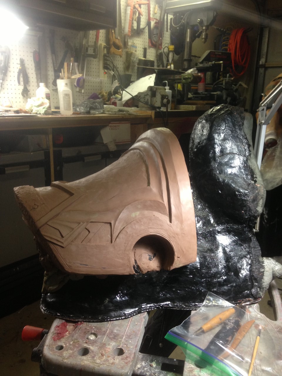

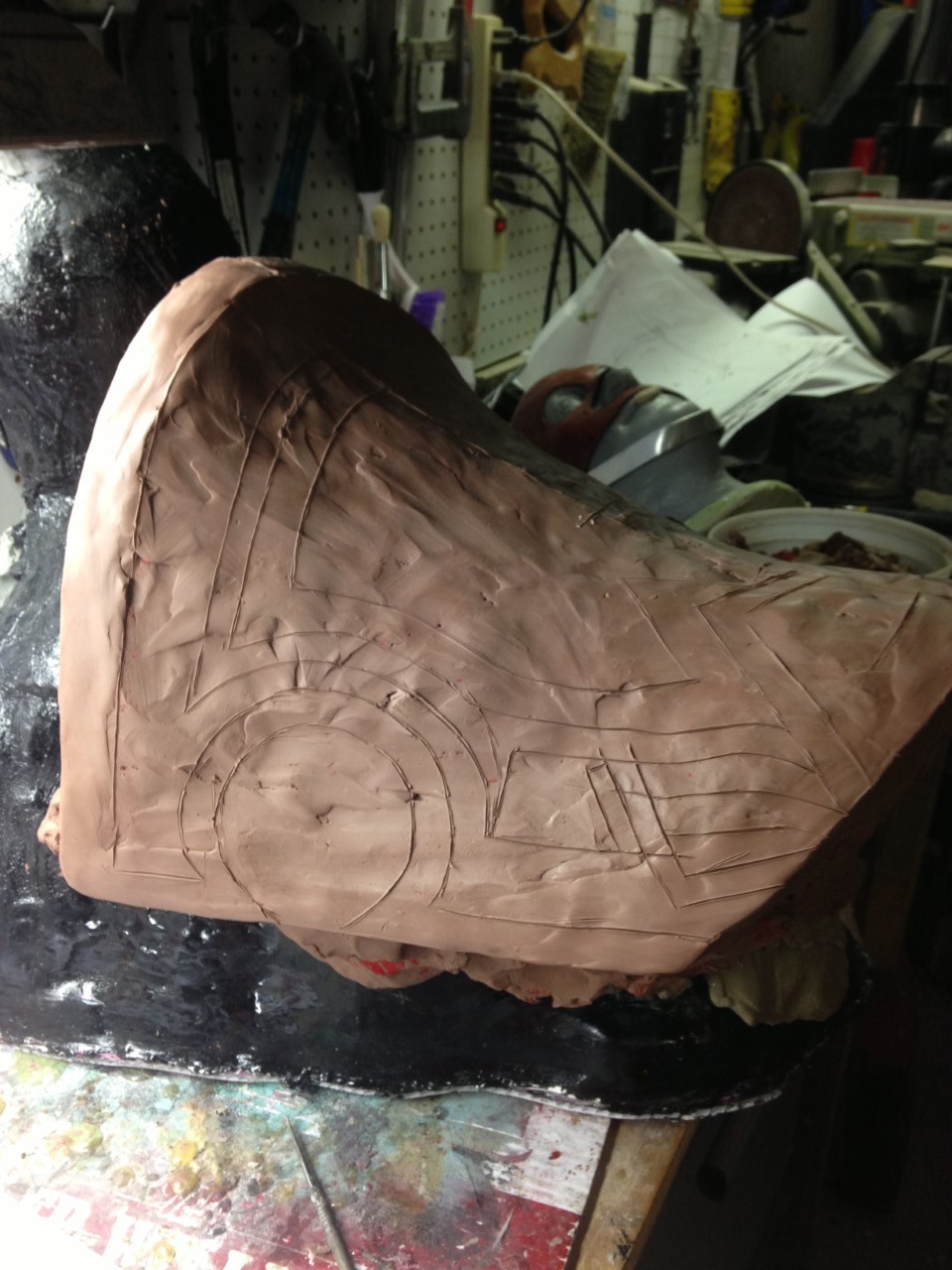

Then I started building up the clay. I wish I could have done it in monster clay but it took an unbelievable amount so I used what I had.
Once I had it in the ball park I drew on the details, traced them on Saran wrap and flipped it and drew on the other side. This helped me to start working on the symmetry.
Here I started carving in the details. This was pretty fun as it was kind of new to me. It was also fun because if I was doing this I wasn't PUNCHING HAIR!
I placed throw the down mask on the armature just to see how the size looked. I am really liking it.

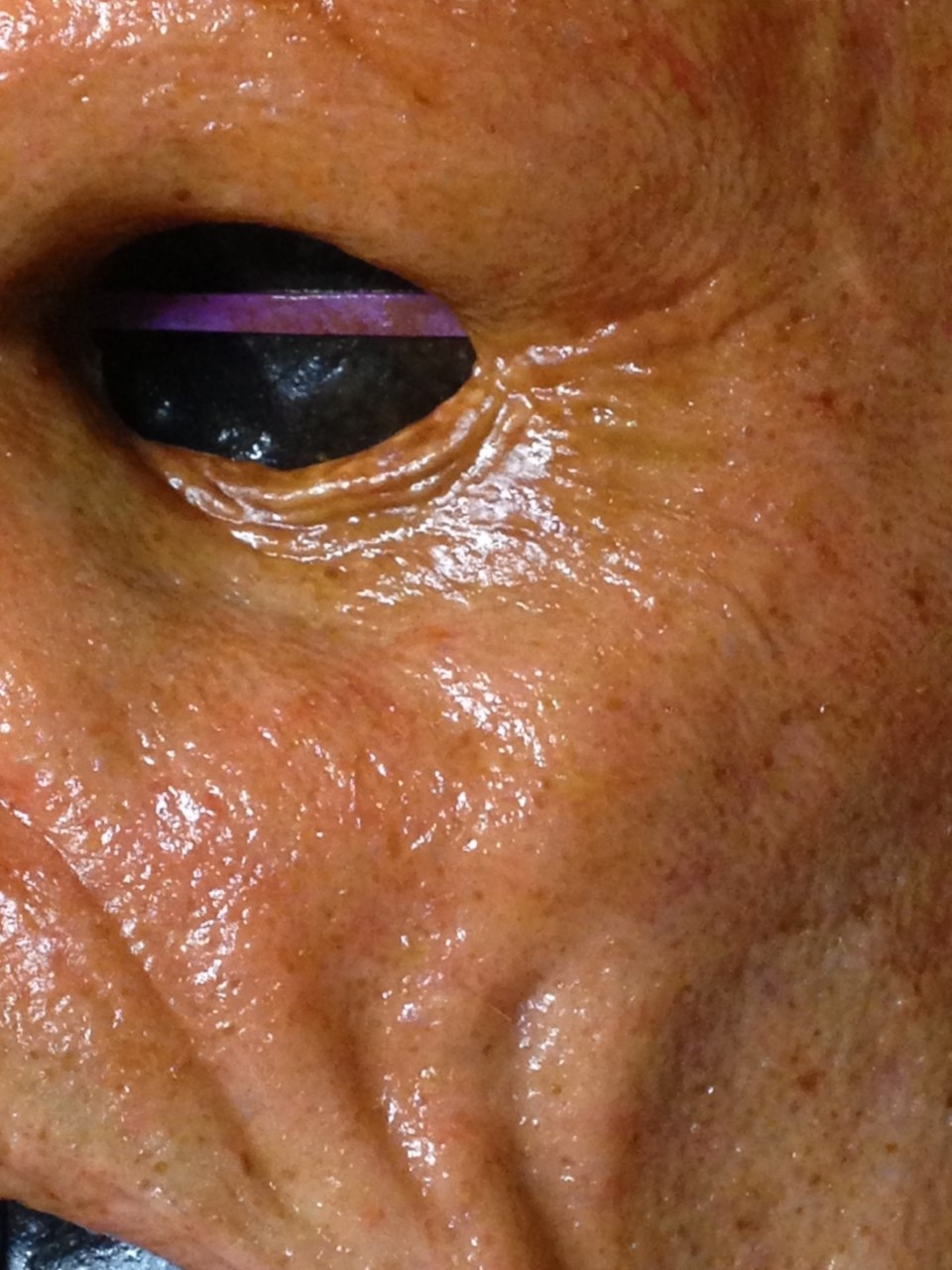

Here are a couple as I'm starting the surface details.
That is where I am right now. I hope to have the head build up soon. I want it finished before I post the entire build. Thanks for looking in.

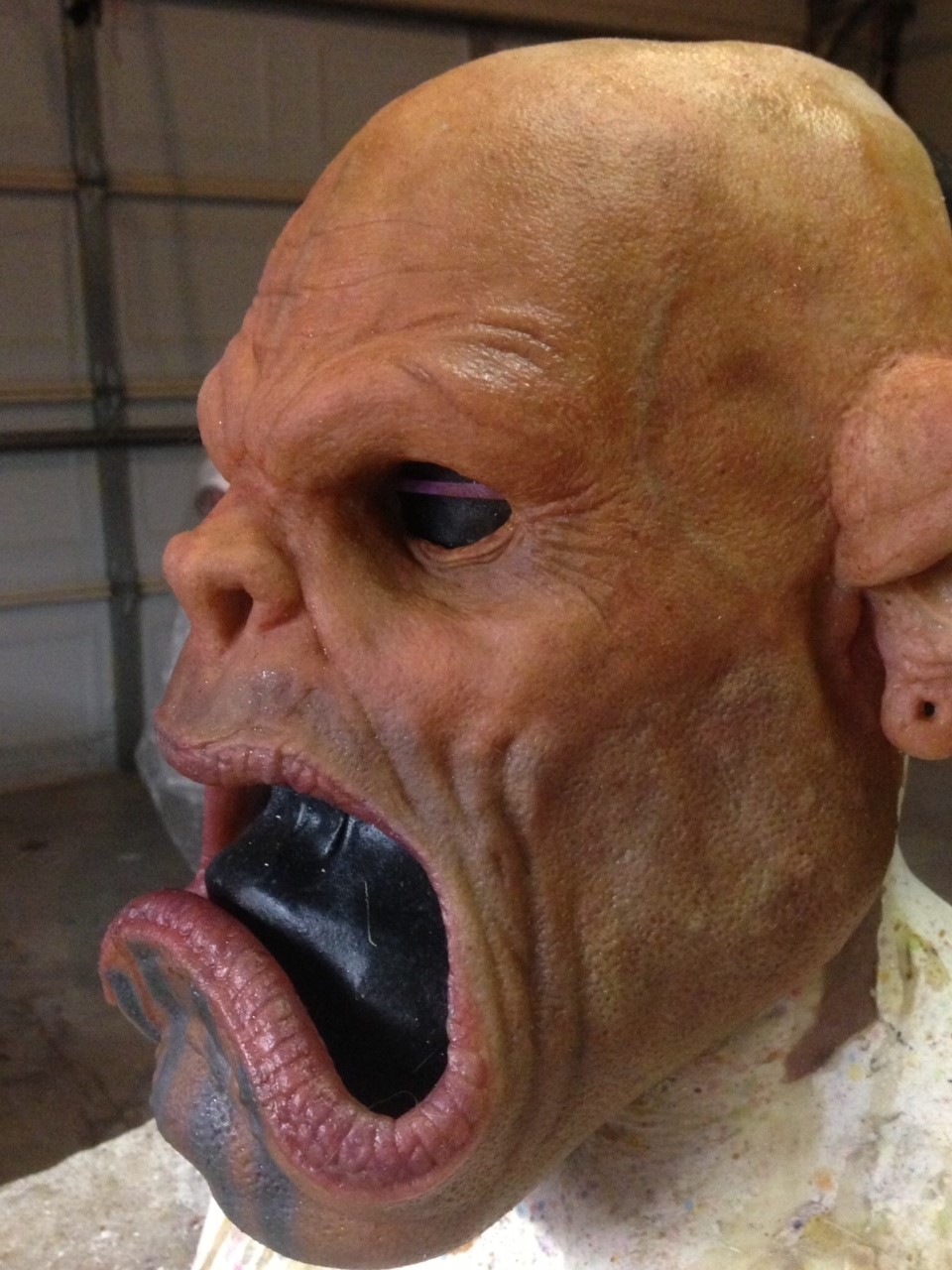

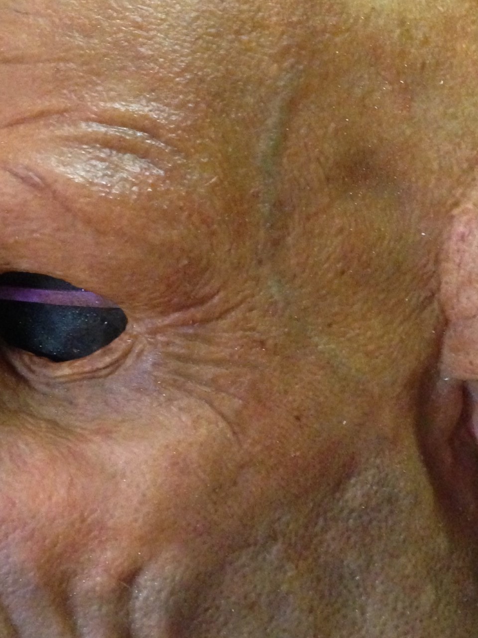

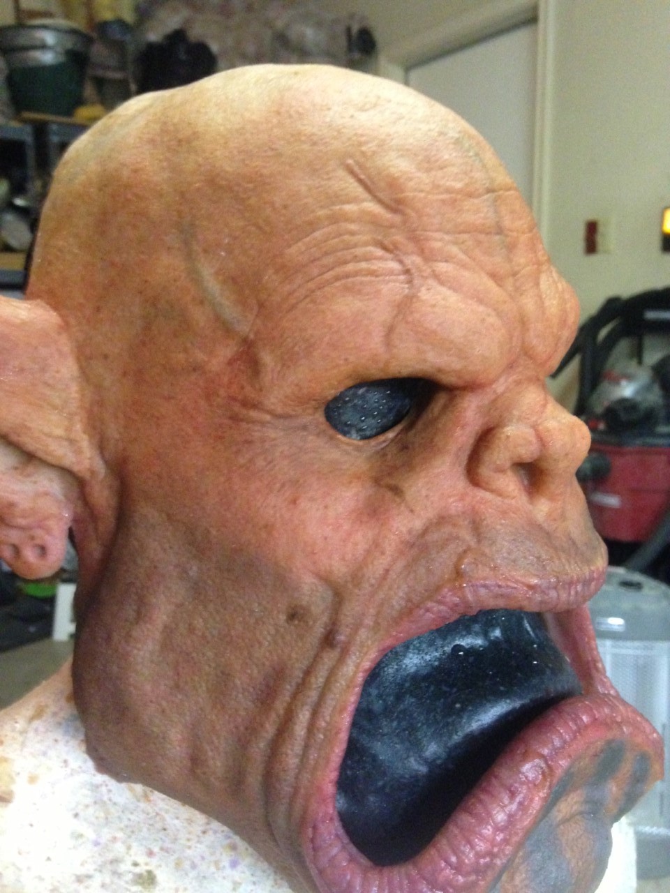

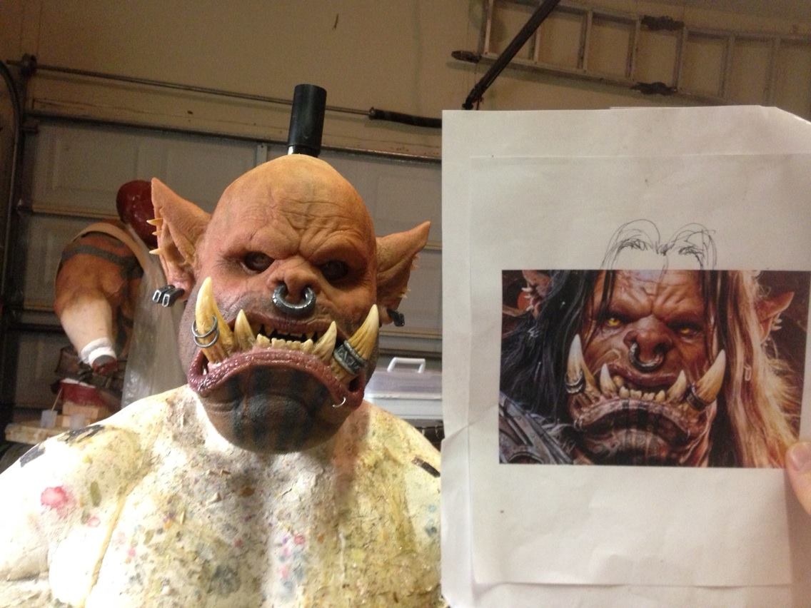

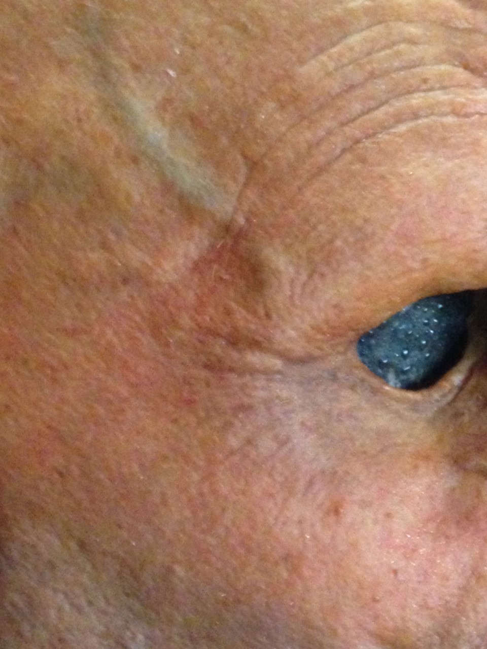

Re: Grommash by Alphatech Last page He's getting closer 04/05/2016

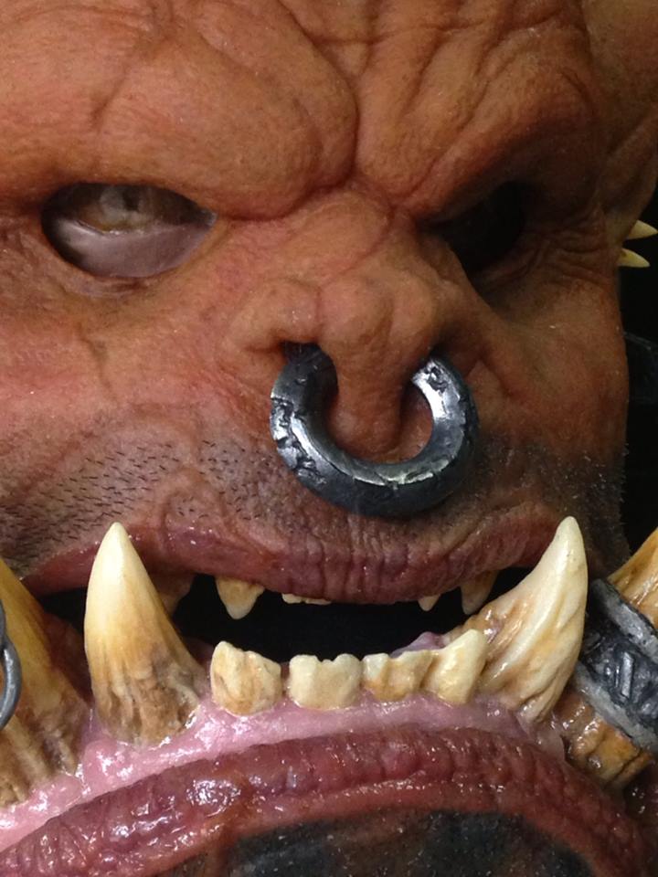

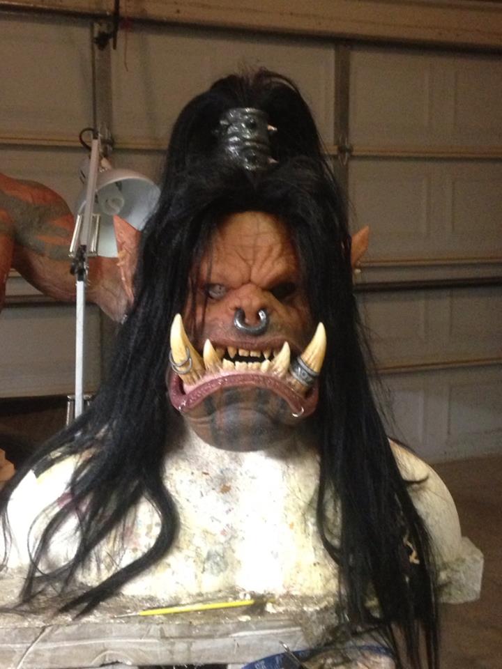

I don't know how close you are trying to get to the pic you have there of him, but it looks like his chin tattoo extends onto his lip as well. Does it do that in your other references too?
I'm still blown away at how amazing this has turned out..

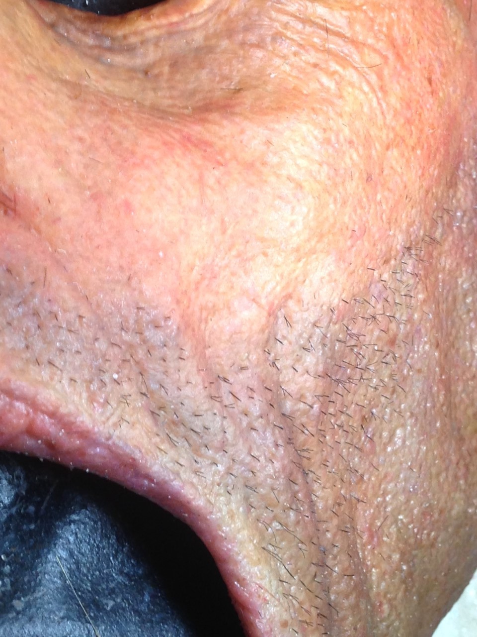

The stubble!!! Holy cow! Every bit of this build is incredible. Your sculpt is a dead ringer for Grommash. "Nice job," is a gross understatement, but nice job, nevertheless.

Hey Escher, I am using a couple of references for the suit. Steve Wang's version does not have the tattoo extend up on the lip. I liked that a little better. I figured I could always add it later if I decided to. Thanks.

Yeah man you look like the captain of something haha! I thought it was Steve Rogers himself for a second! :lol Good advice. Side note, I personally like that you didnt make the tattoos go up the lip, I didnt really like that look. Man. So awesome, love this. Are you going to post a tutorial on how you made the silicone mask? Please?

Yes I will be posting the tutorial on the mask very soon. I wanted to finish first. I'm weird like that. It is a learning experience and as I make mistakes along the way I would rather correct them then explain it all later in the tutorial.

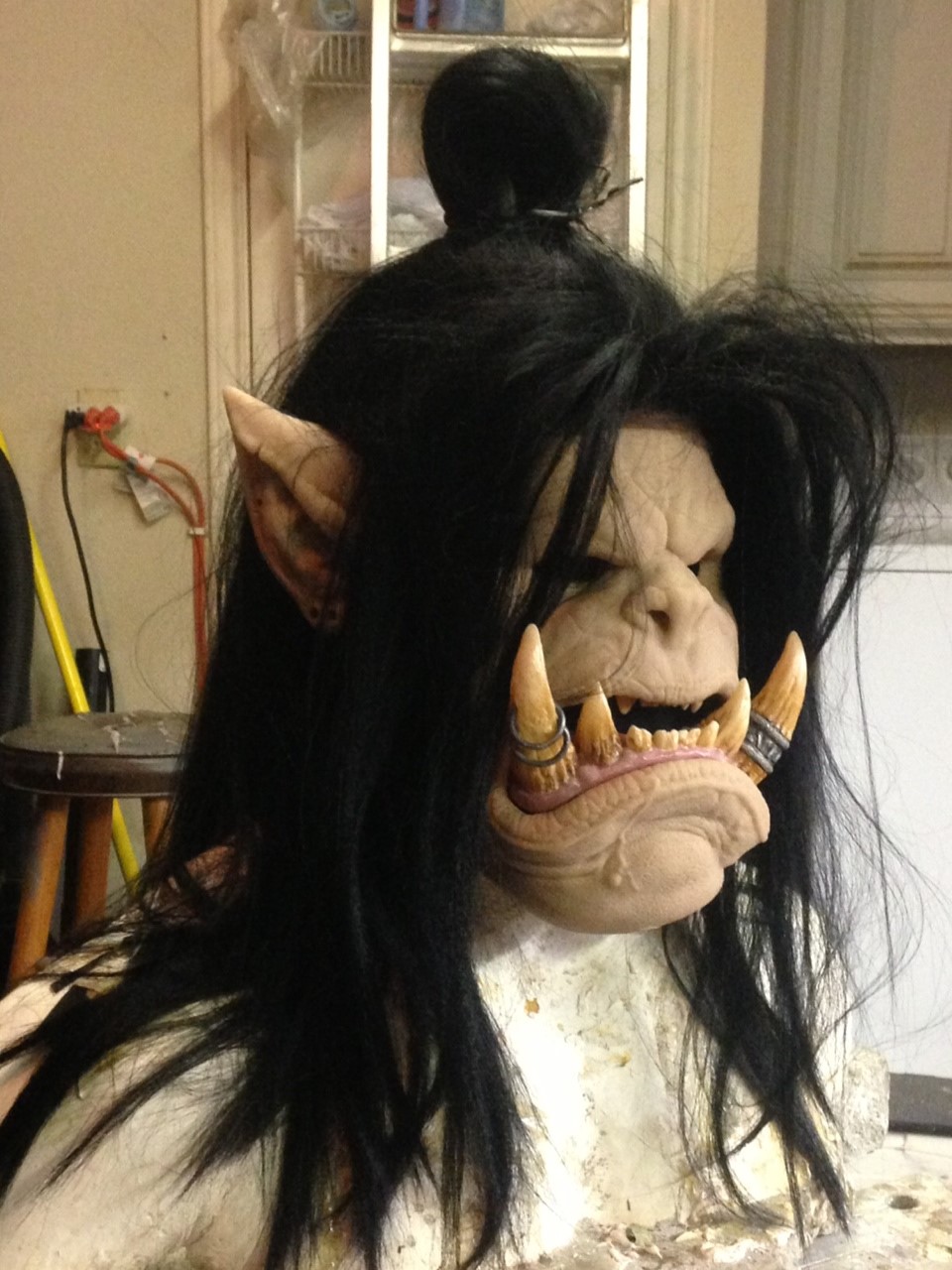

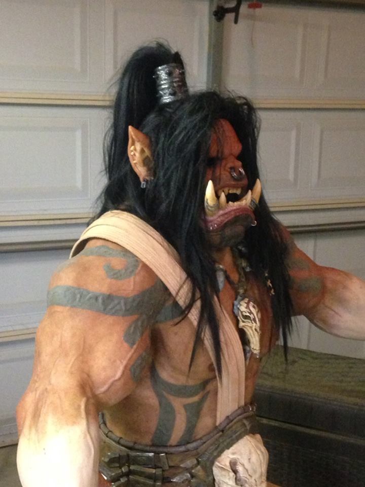

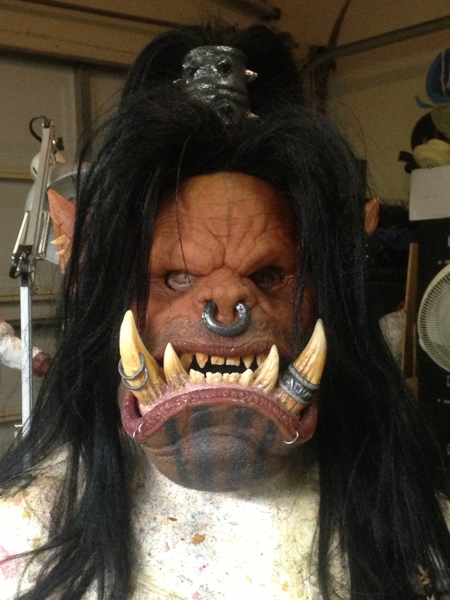

I spent yesterday morning sewing the wig to the mask/underskull. In the afternoon I spent a couple of hours styling his do. I still need to punch some hairies into the hairline in front of the wig.

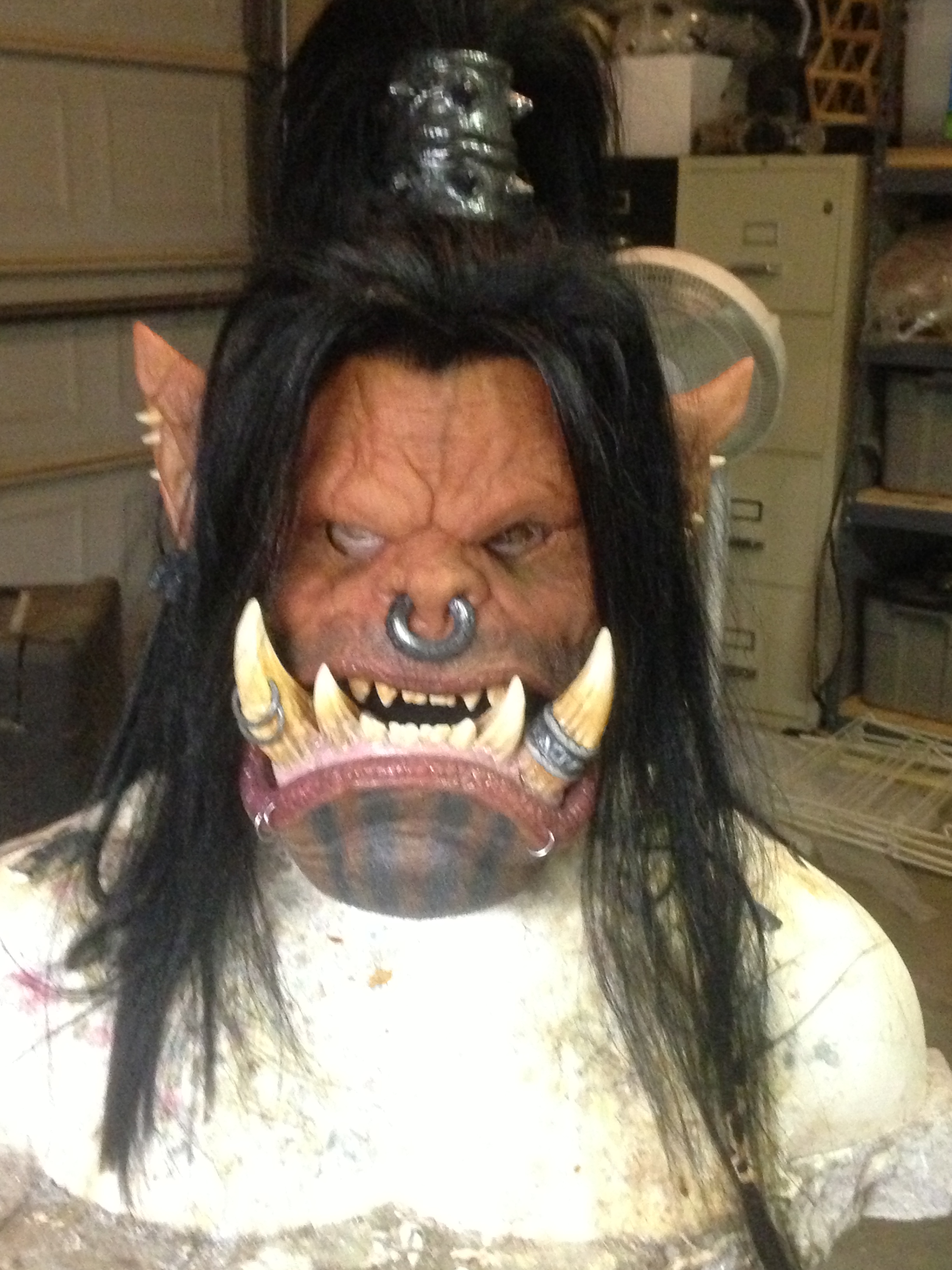

Re: Grommash by Alphatech Last page Grom has a do 04/06/2016
I finished up his hairline yesterday. I am planning on building the tutorial today. Stay tuned.
that is a thing of beauty. Hideously grotesque beauty, but you know what I mean.
