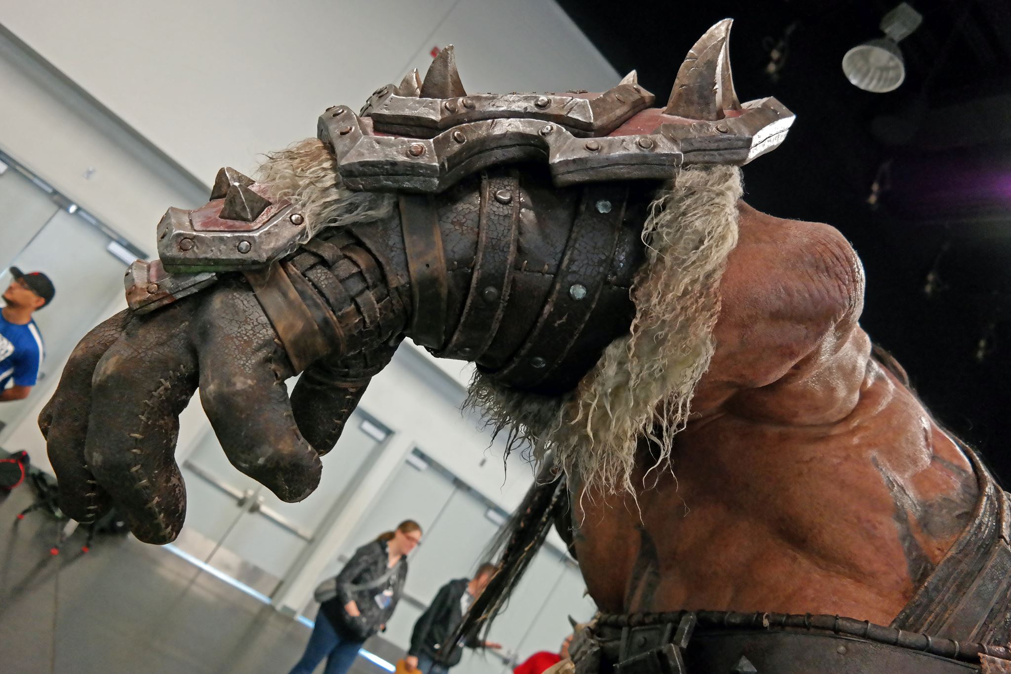

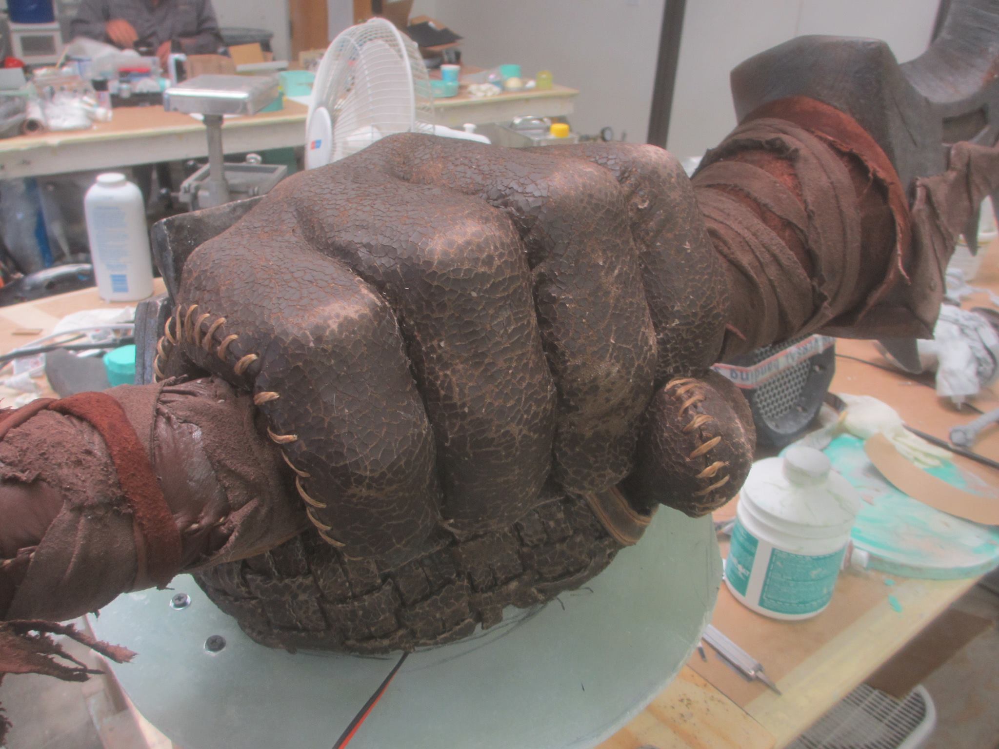

First there is the reference photos from Steve Wang's build.

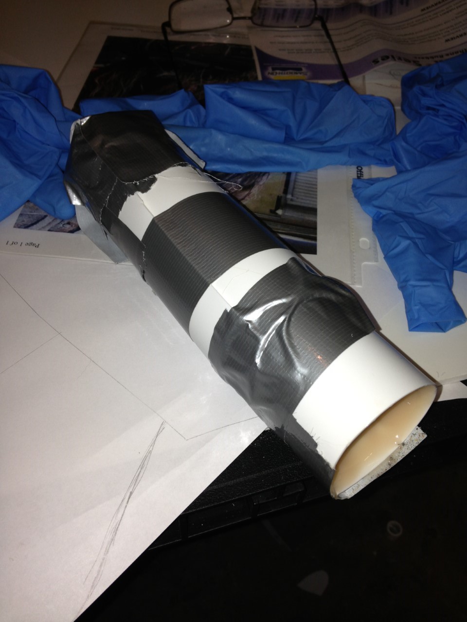

First I had to do some experimenting with silicones to decide if I was going to go that route for the fingers. The problem was the back side of the fingers increase in length as the finger bends. I wanted to do them in leather but I just could not bend a finger with a tube of leather wrapped around it. I made a tube and slush cast Dragonskin Pro Fx and placed it on the finger. Not flexible enough. Then I tried EchFlex 20.

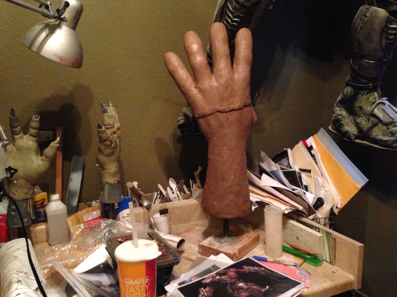

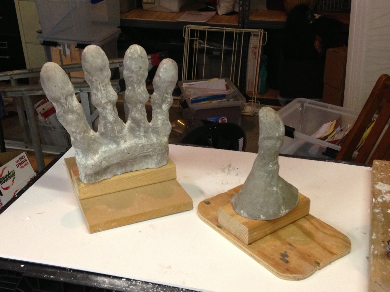

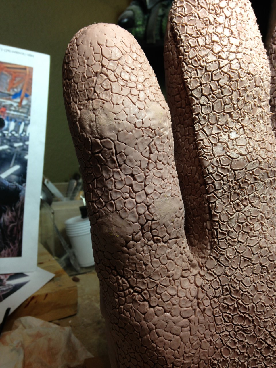

Once I decided on the silicone route I started to sculpt. I initially started on the hand that I did the palm cast off of. I abandon that idea pretty quickly. I decided I need to sculpt directly on the hand or something close to it. So I molded the hand.
The abandon sculpt

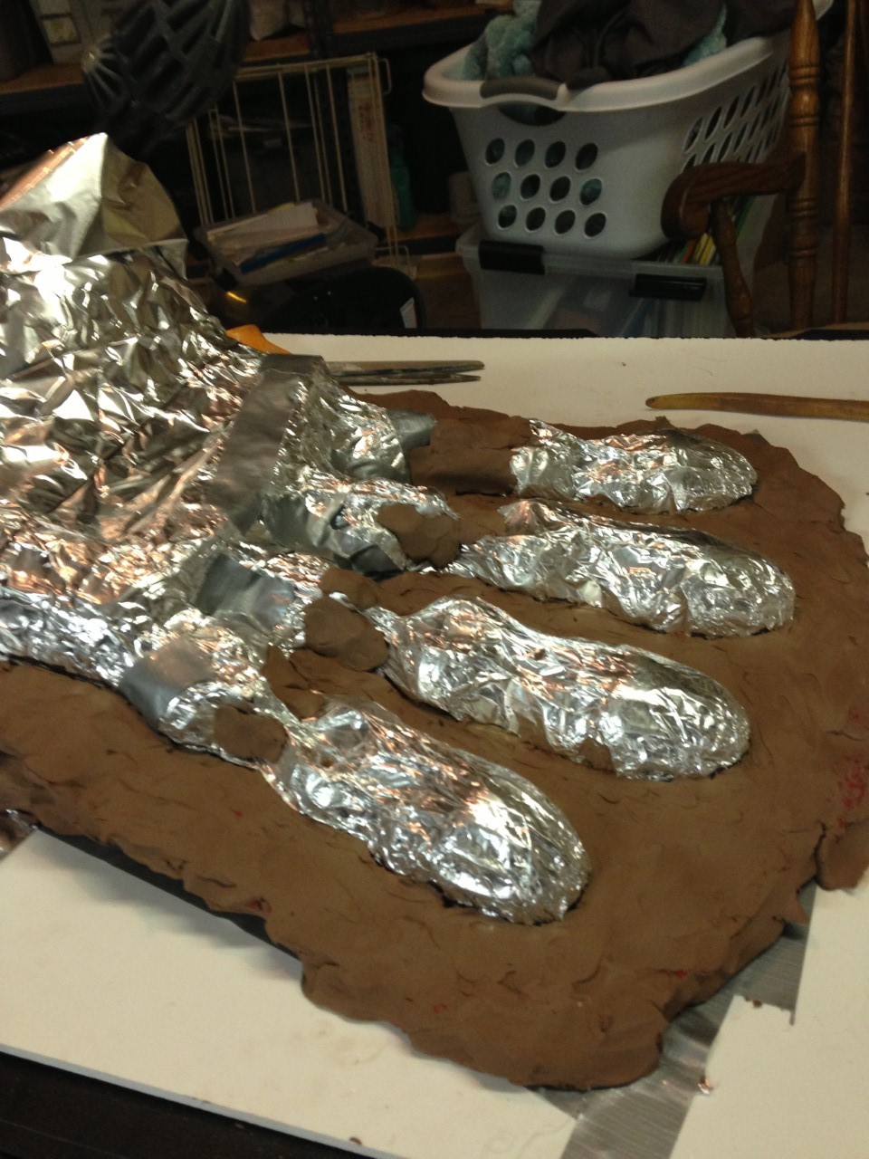

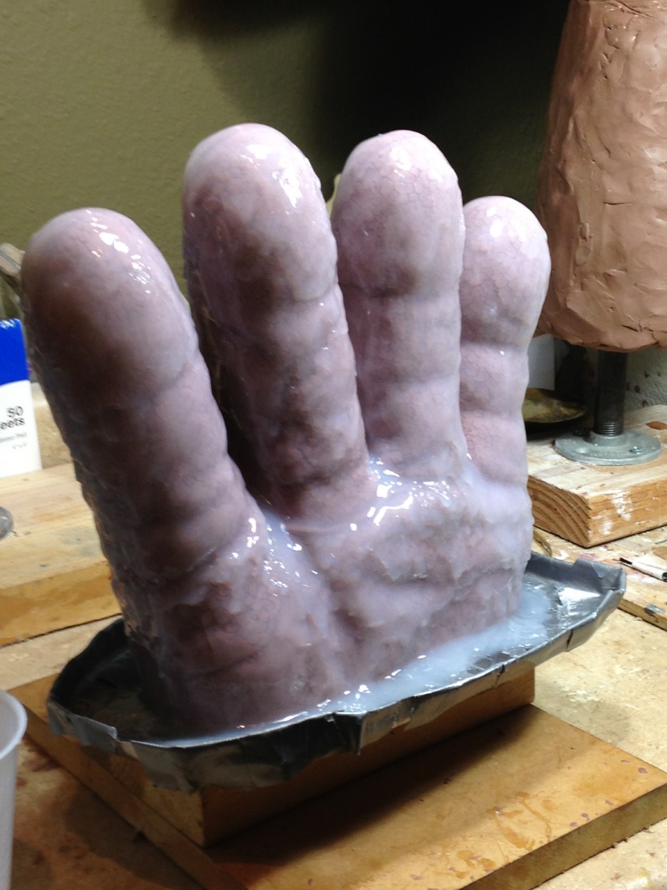

Molding the hand to create armatures to sculpt on.

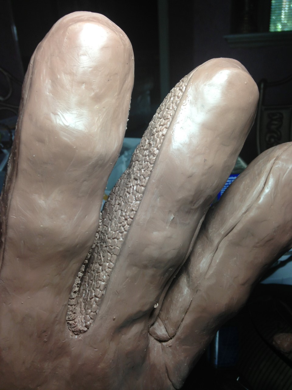

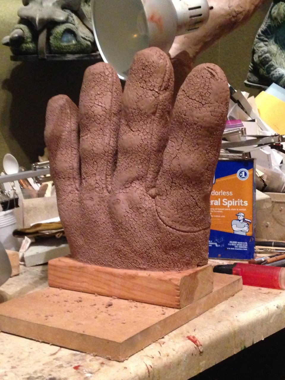

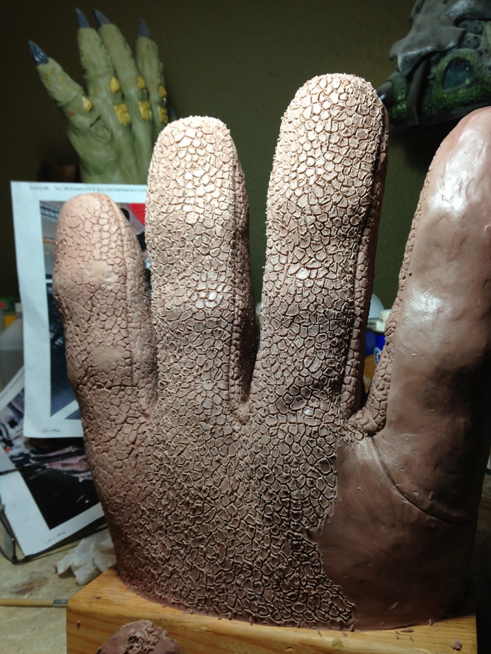

On to sculpting. Monster clay.

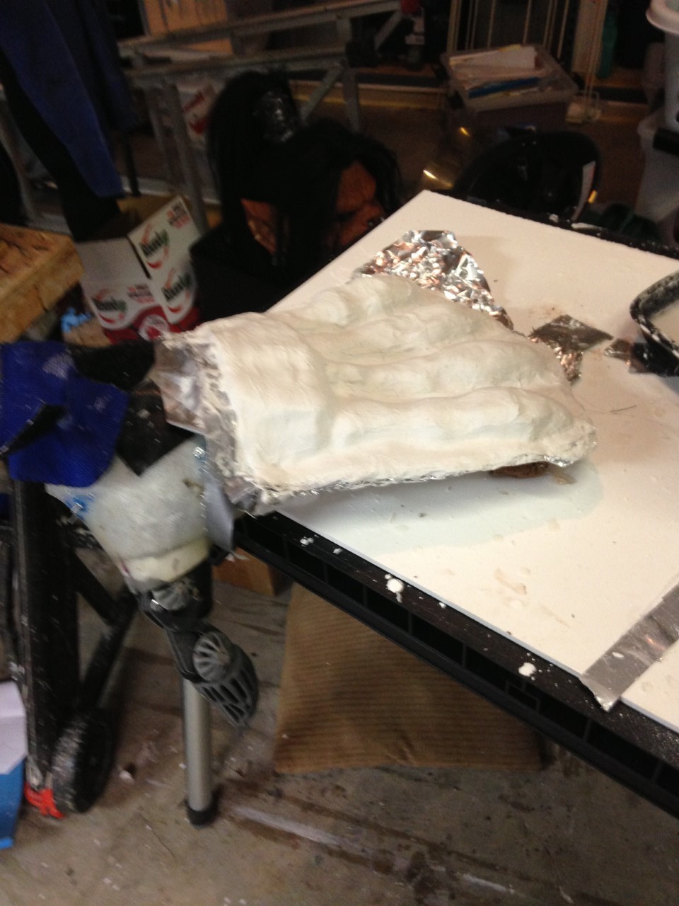

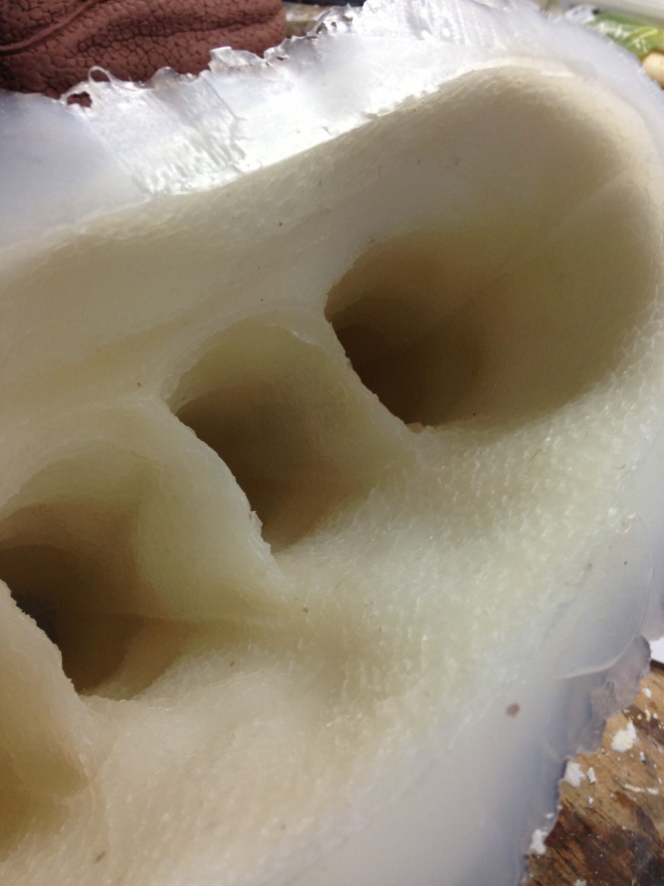

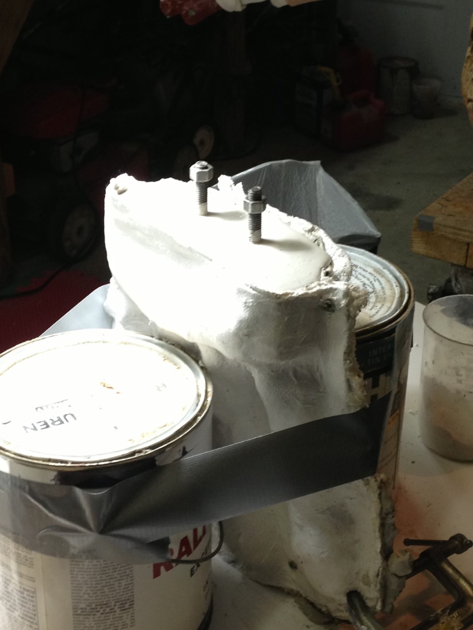

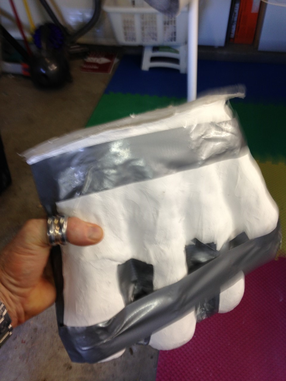

Next I wanted to try making a seamless mold. I used DragonSkin Pro Fx as the mold. Then I did a simple plaster bandage mother mold.

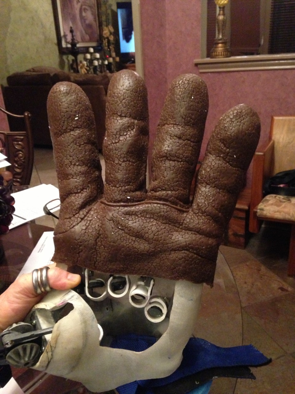

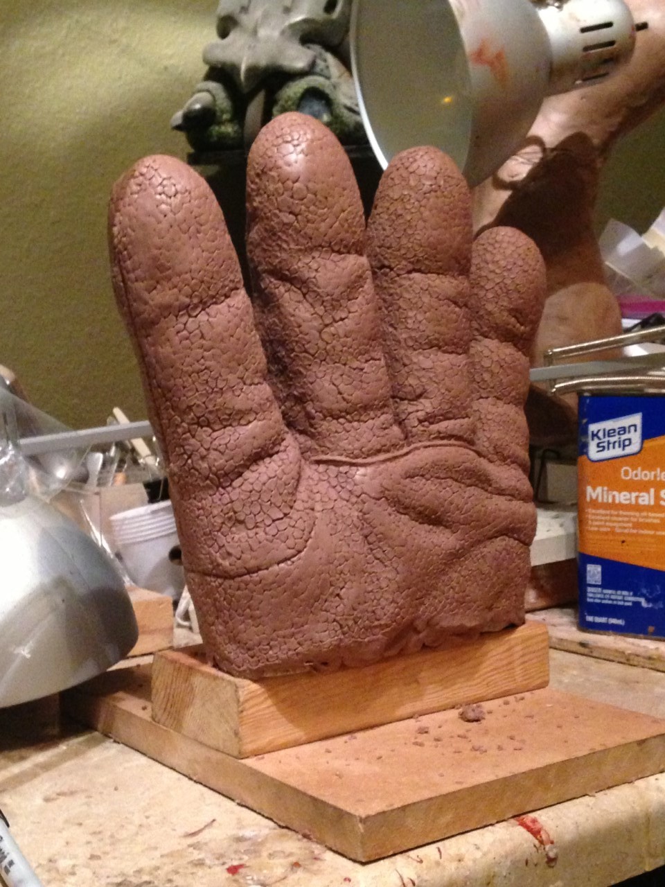

Now understand this part was all experimental. I used Ease Release 205 on the mold and spread in a couple of layers of EchoFlex 20 tinted dark brown.

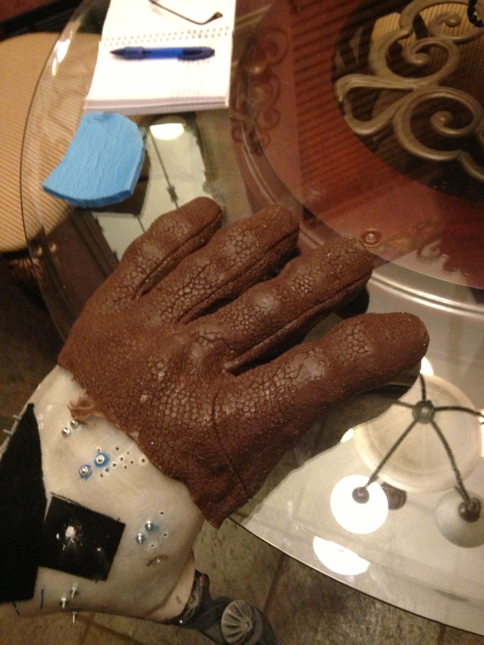

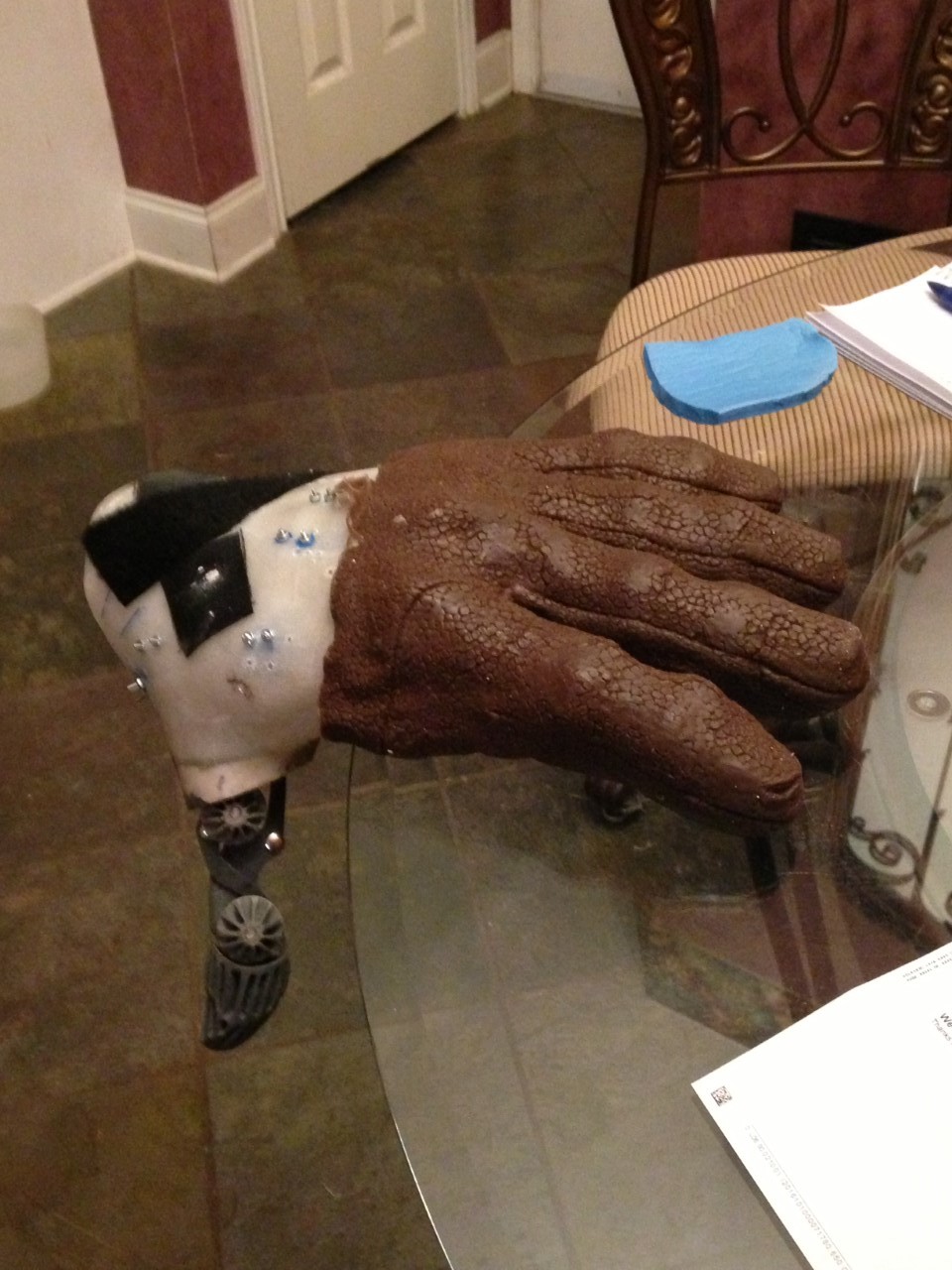

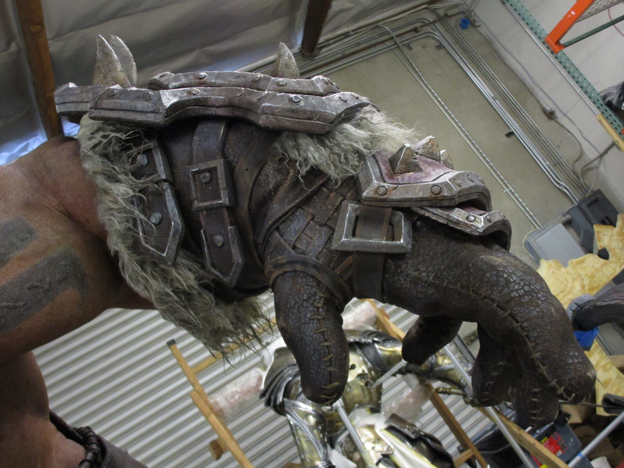

Here is the fresh pull. It looked great and felt great.
So after all of that all seems great. WRONG. I decided it was just to heavy and cumbersome to be used. In my next post I will show you what was next. No wonder this takes so long.
