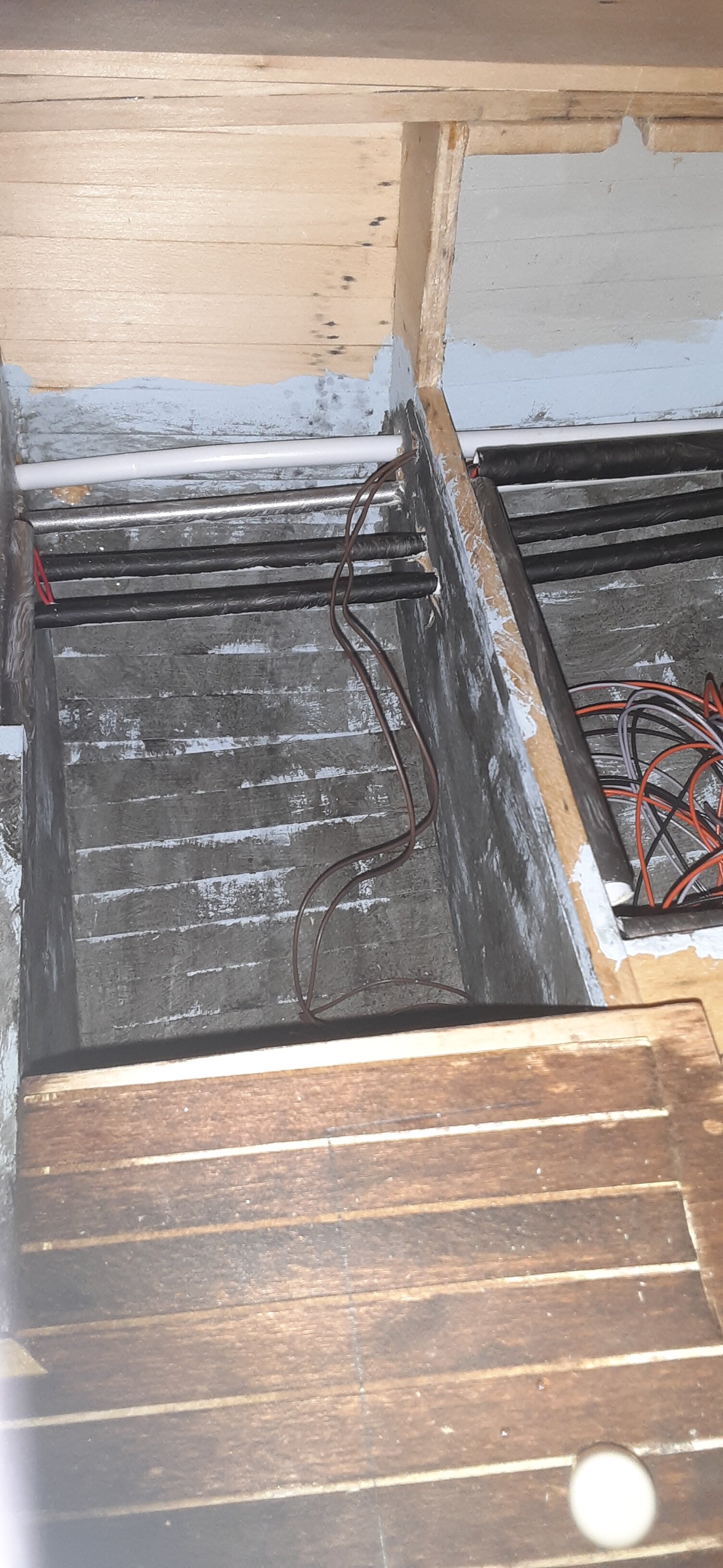

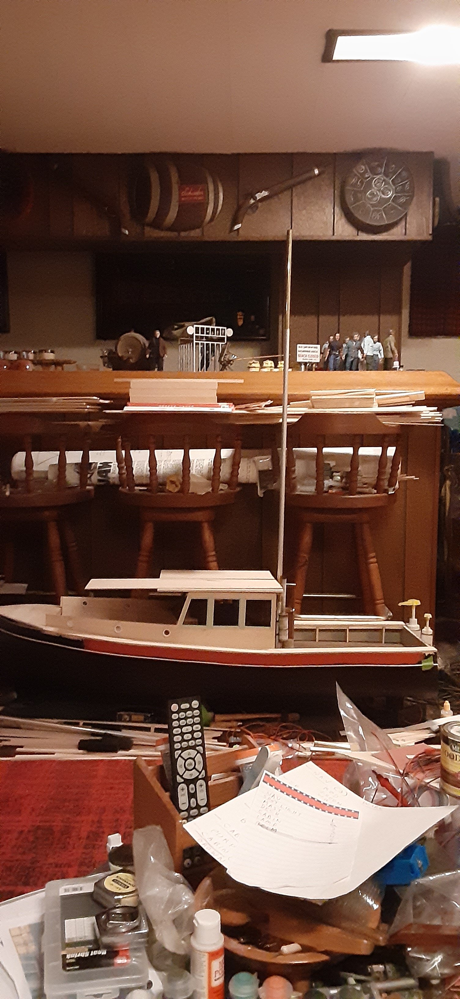

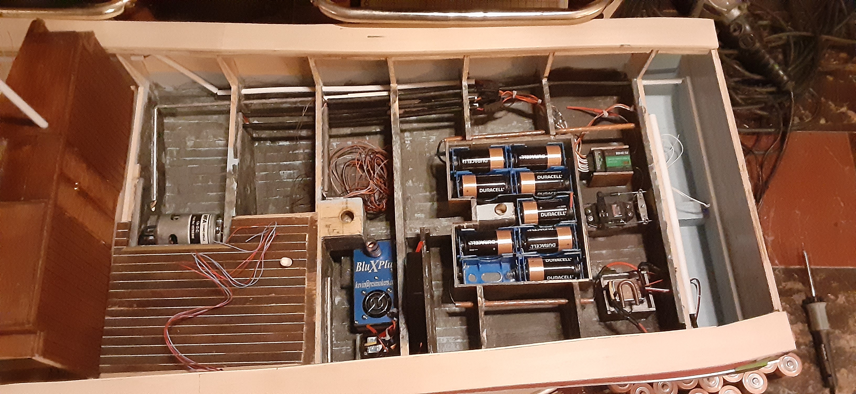

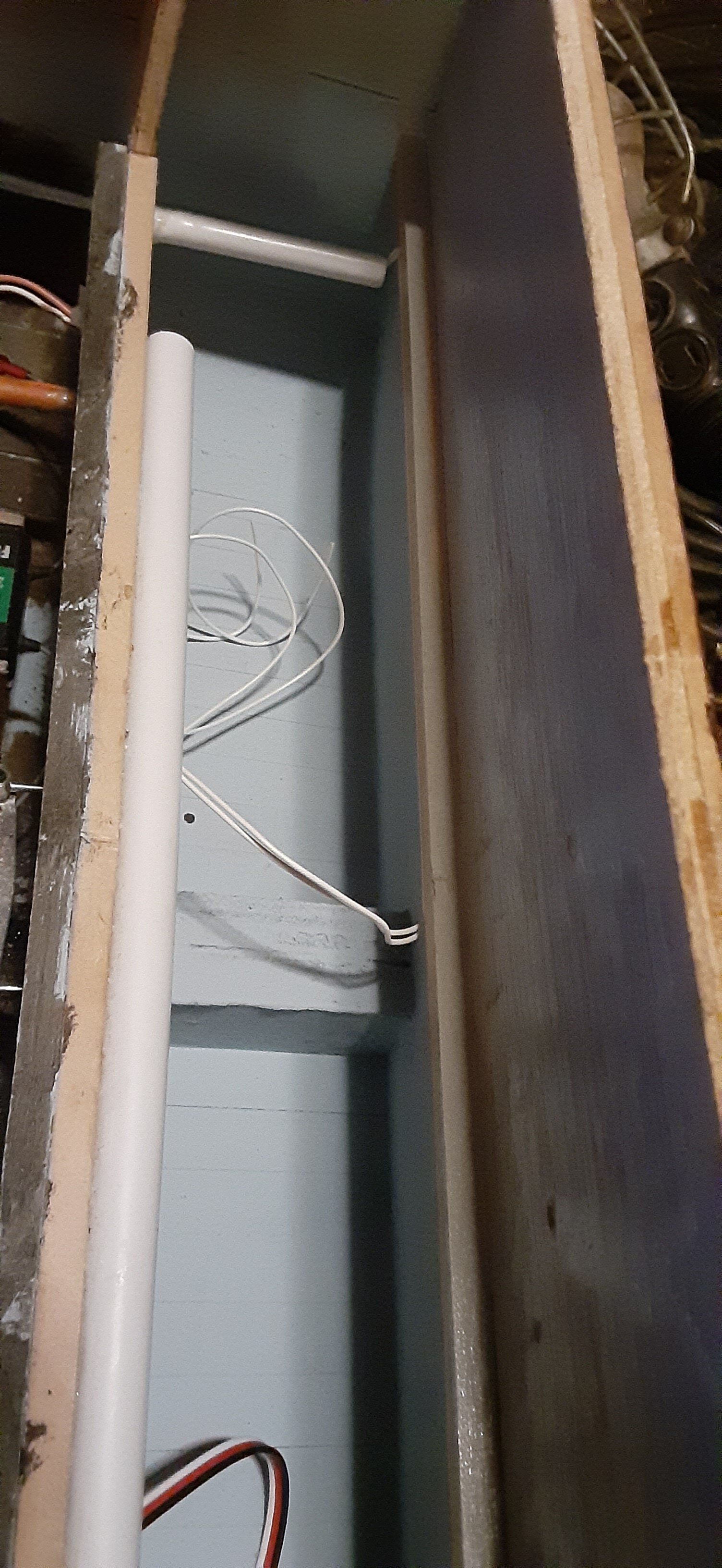

In order to get all the wiring under the deck hooked up and finished I have to build and mock up everything,...like the Mast! The mast hole is drilled and I can now run wiring to it. 3 lights in the mast (Not 4). That black dome thing is radar, well it's supposed to be. It's Not a deck light. From the deck to the platform that Quint stands on (where 2 of the deck lights are) is 33 and a half inches tall. I'm figuring 16 to 20 inches more (53") will be the full height of the mast
After I finish the mast wiring, I can move on to the navigation and spot light wiring.

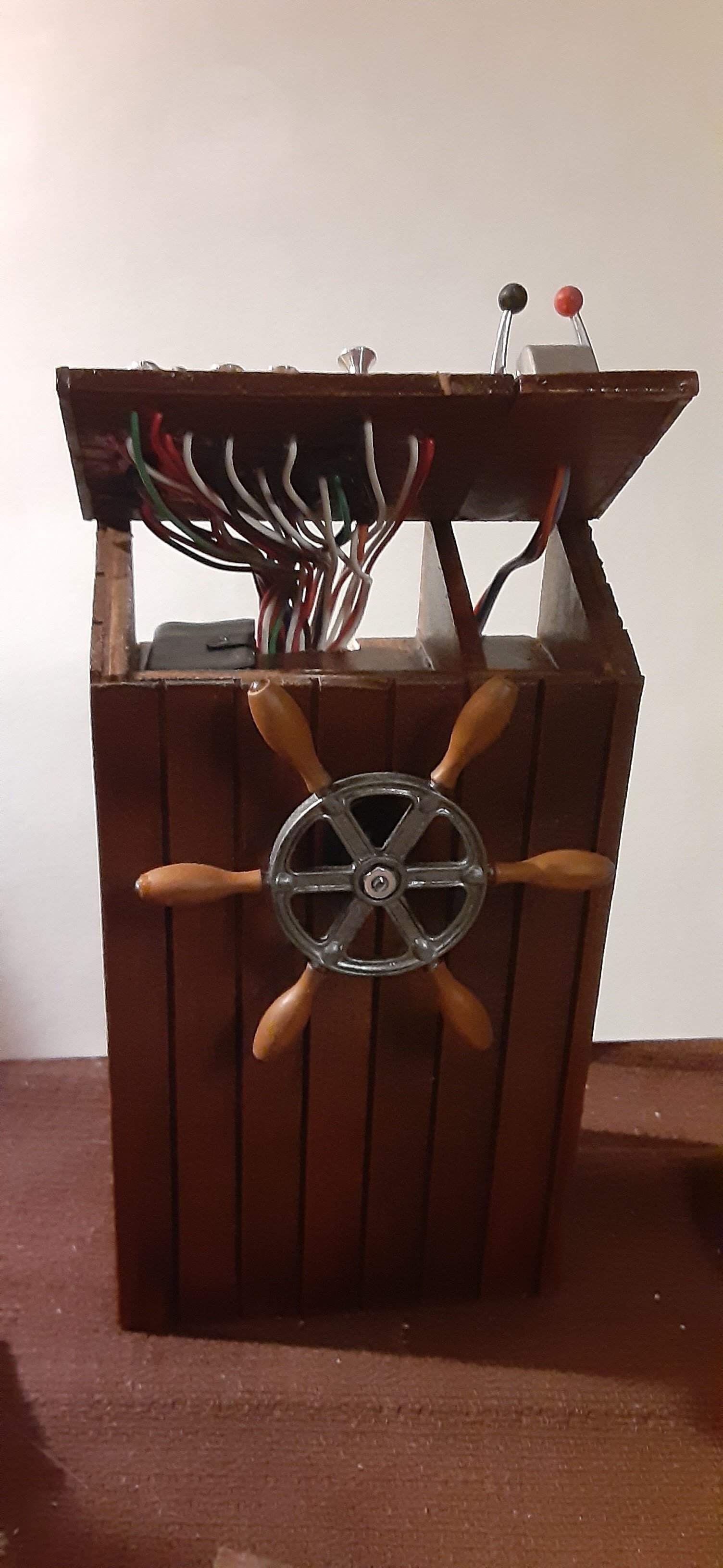

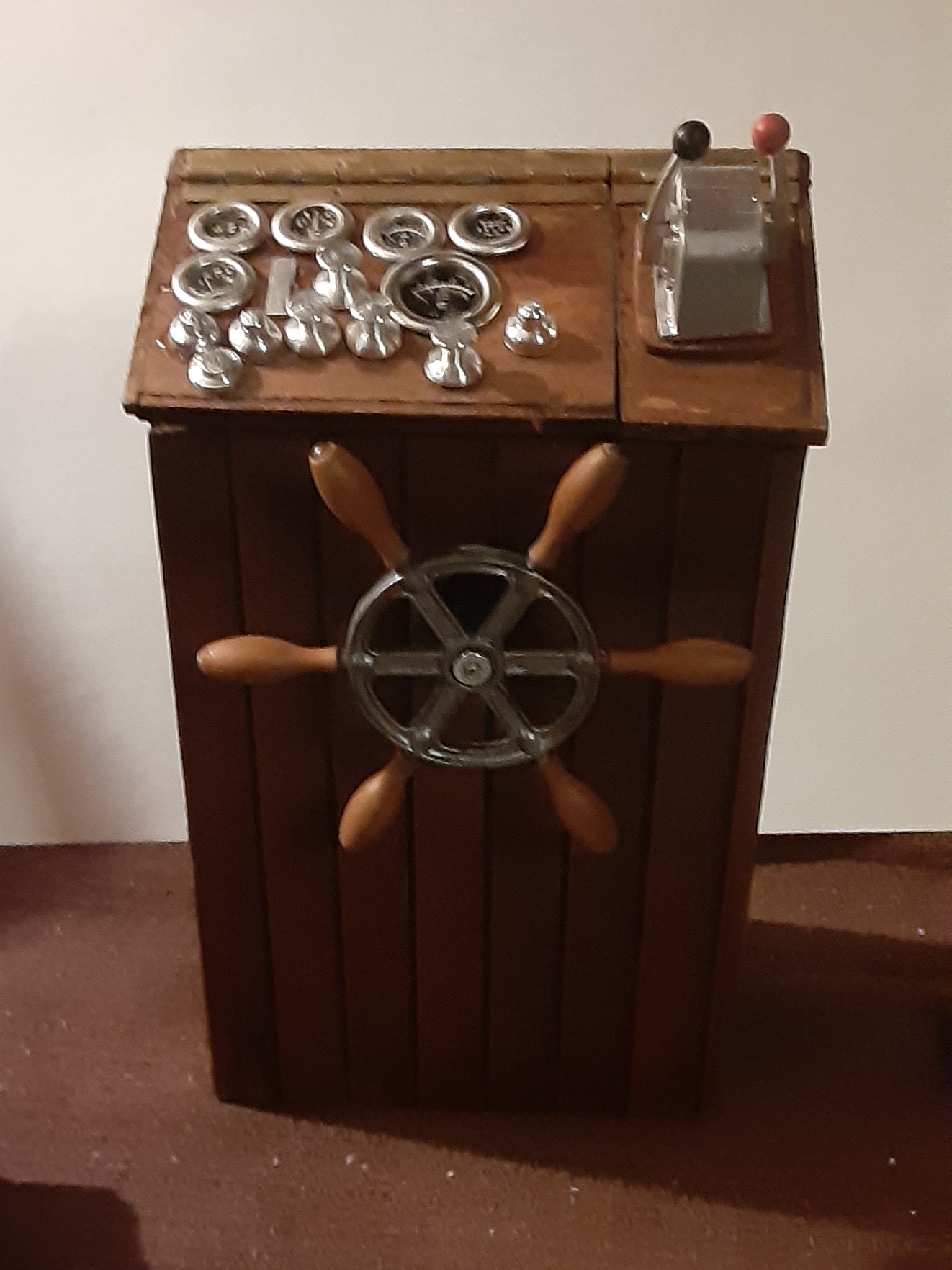

Some evening work on the helm after spending the day with the wife at the doctor's and therapy.
Yes, that's wiring to all the guages and buttons. No one will probably ever see it, but I know it's there. Oh, I also put the Orca's log book in there. Quint was Navy, I'm sure he kept a log. I might add a hidden bottle of whiskey, Quint would do something like that.
That's the whole nature of model building (for yourself), isn't it? "Nobody else is gonna notice this but I want it right . . . "
I'm picturing that log book.

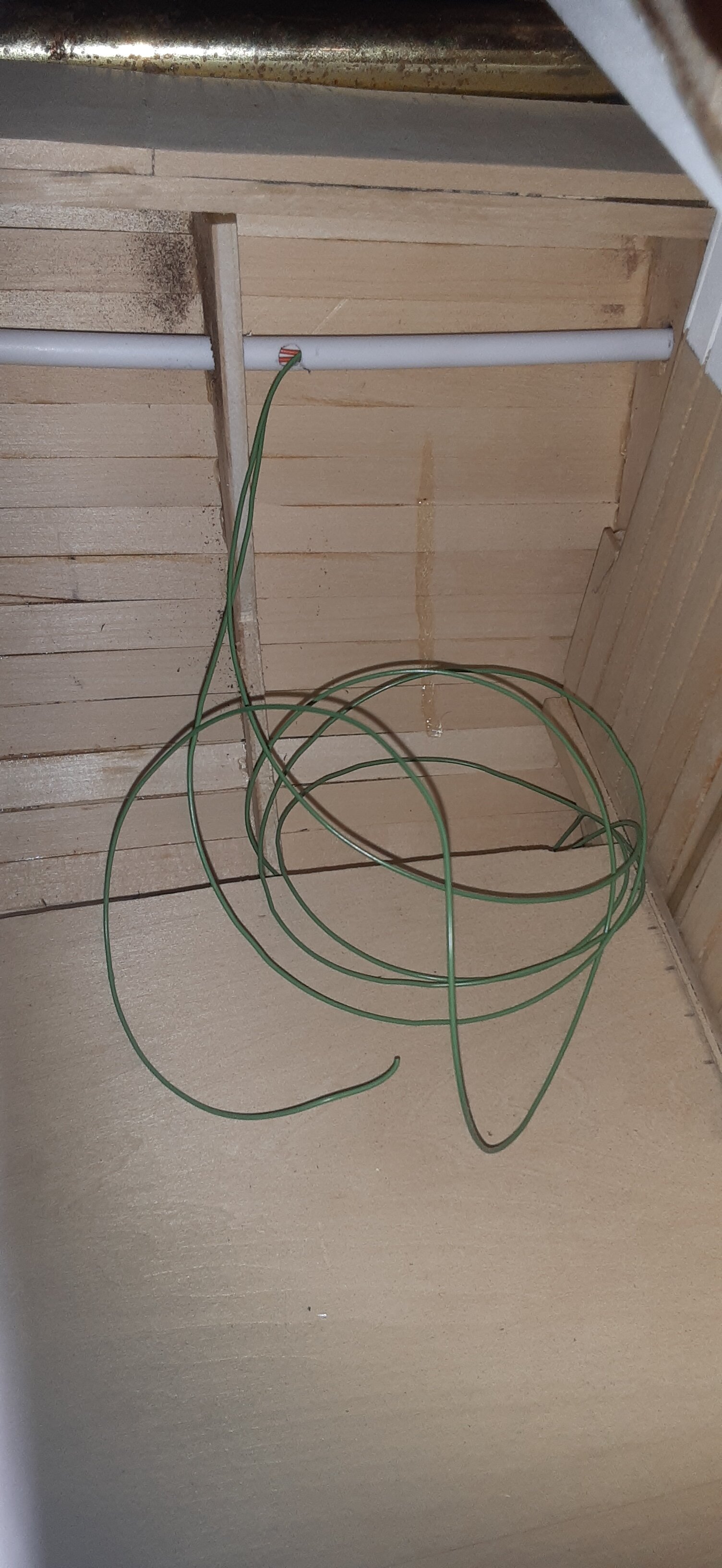

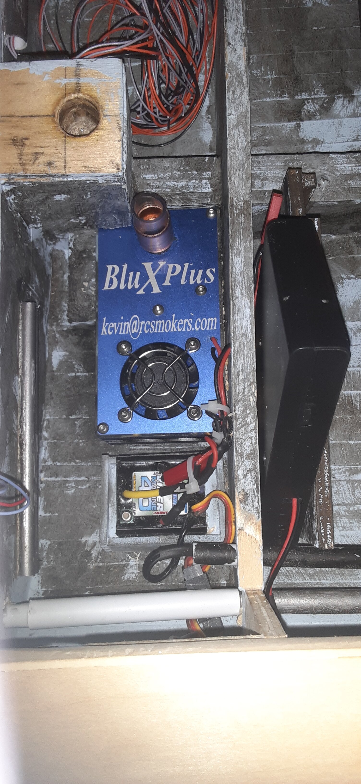

ALL the Wiring IS DONE, including the Smoke Generator! (Flimzy, wait till you see the Smoke volume from this thing) My next post when the deck and cabin walls are glued in, I'll make a video of the Smoke generator working.
Ok the Wiring, from the radio receiver I have 6 switches setup on the aux channels 5 through 10. They will turn on and off all the different lights. Channel 4 is the Smoke generator, which has variable smoke forward and reverse. I thought about Y connecting the generator to the throttle channel, but decided against it.

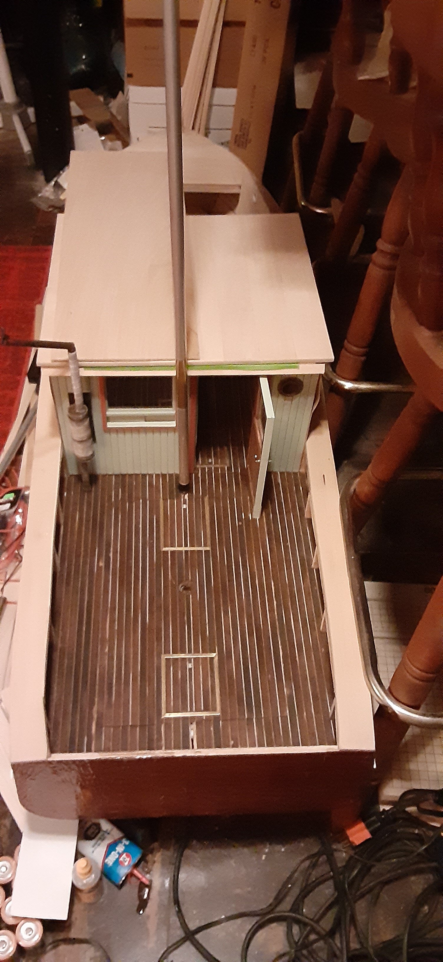

Gluing the deck and cabin walls in permanently is next! THANK GOD!!!! Let's get to the good stuff.
Wow...how's the weight of it all so far? Lots of components inside that hull:eek::eek::cool::cool:
When I floated her last September, I had 19pds in her. Most of the weight was forward. So equal weight of 6pds is now spoken for in the stern. lets see how much weight i'll need in the bow. Believe me when I say Jo, Things go through my head so far in advance of the actual building. Then I second guess myself and say, ok where did I F up. lol

I've never be satisfied with smoke generators...always looks off. Not to criticize your work, far from it, but I would try other ways to generate that smoke:unsure::( more in tune with a miniature smoke bomb.
Naw, I'm sticking with this one. Yes it's oil based and stinks in an enclosed area, but it has smoke volume, variable smoke like I've never seen out of any other smoke generator. Remember the video was made a basement with no air movement.
Smoke tends to have a scaling problem. Like water splashes & droplets, fire flames, billowing dust clouds, etc.
I wonder if a more 'pulsed' output would help the realism of a miniature exhaust pipe. Like a rotating prop in the pipe or something that alternates between blocking & opening the airflow.
There's a few YouTube videos on how to make smoke bomb on a small scale...different colors can also be achieved.;)
