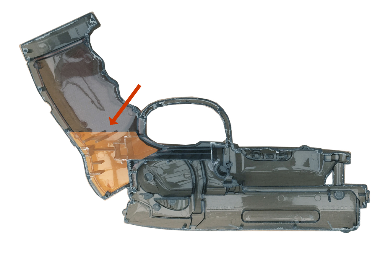

I tried this with amber resin, and I'd be curious to see how other people did it. The problem is that the water reservoir doesn't actually go *all* the way up to the body of the gun--there's a section at the top of the orange grips that cannot be reached from the water-filling hole. I'll live with it, but I wonder what others did when they encountered this issue...

This is how I would recommend filling the grip area fully with resin. I’ve borrowed wayouteast’s sawn-in-half blaster photo to get a better idea what’s going on inside. (thanks wayouteast )
For your first resin pour, you will need to twist and turn the gun around to manipulate the resin into the awkward area. (put your finger over the filling hole while you do this if necessary) Let it cure with the gun facing upside down. This leaves a straightforward area to fill with later pours.

This is how I would recommend filling the grip area fully with resin. I’ve borrowed wayouteast’s sawn-in-half blaster photo to get a better idea what’s going on inside. (thanks @wayouteast )
I think my mistake was doing a lying-flat-on-its-side layer for each grip before trying to fill up the center of the cavity--I probably plugged whatever small connection leads into the awkward area and screwed myself from the get-go.
I had a similar issue with my first attempt. If you don't fill that area that I highlighted first, you will probably block the small connection gap and end up with an air pocket in there.
