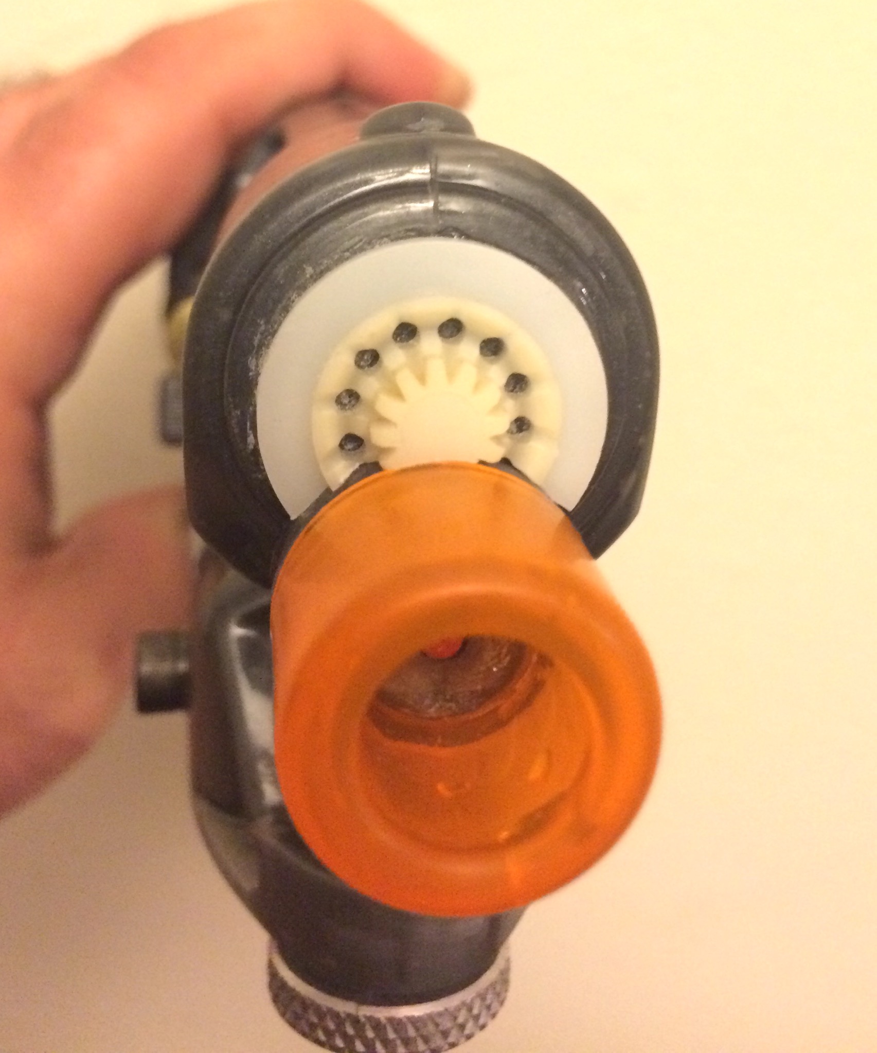

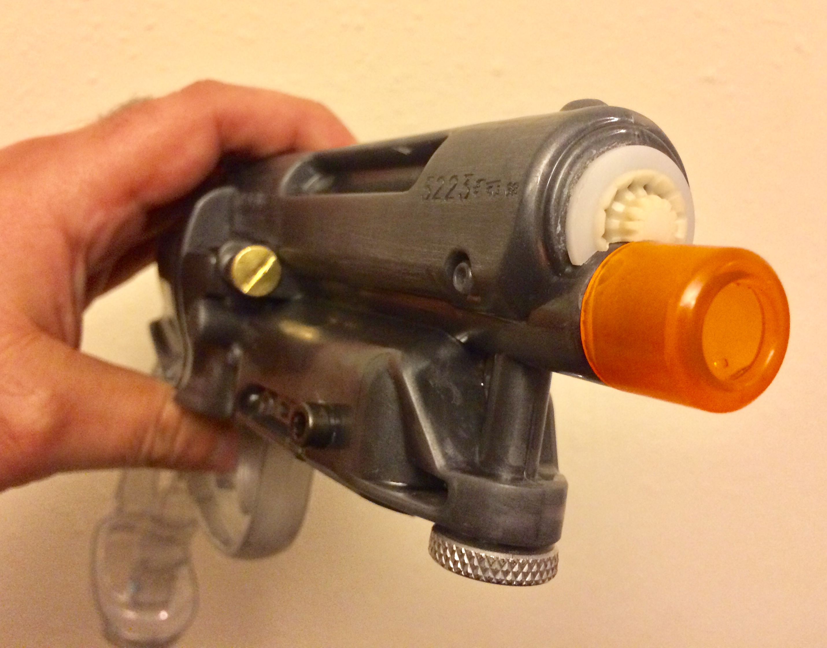

probably mainly black and gunmetal with pearl white grips and ill use the orange cap as a barrel extension.
I used the orange cap for an extension; you'll get a profile like that. The pearl grips, though, THAT I want to see! How were you planning on getting the pearly look?

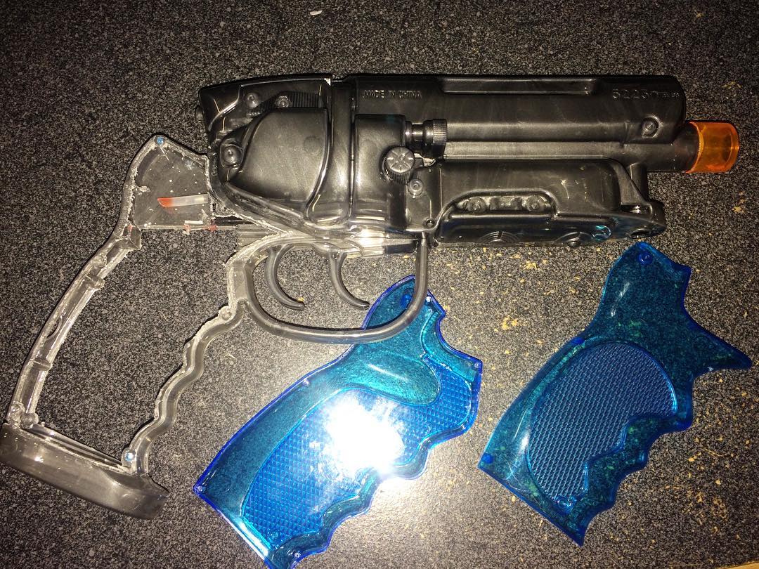

Im sure most people might be saying duh, but Rit dye wont dye this thing. I thought maybe I could darken it up with some black but it didnt do anything. Thanks google...paint it is!
The entire gun or just the grips?
RIT dye needs heat to work but I think that heat would warp this type of plastic. There are several old threads on dyeing plastic with RIT and other brands and I have seen many complaints especially about the black RIT.
Sometimes you could get a better result with a marker but I would like to try slushing paint inside it before I try any marker or paint on the mag well.
The gun minus grips...I went right under boiling, filled it up inside as well with the dye. Might just be the type of plastic, or I needed to go hotter.

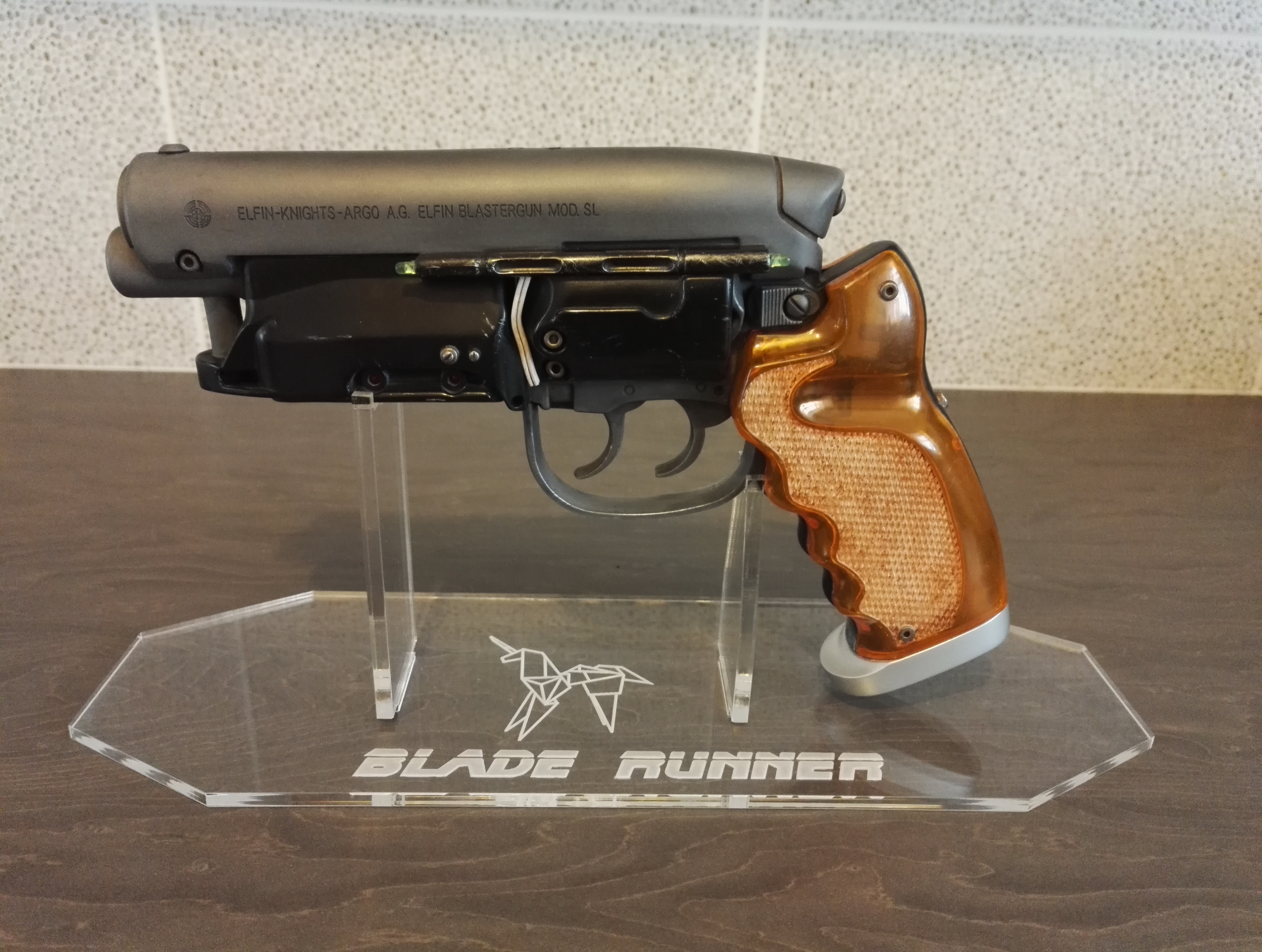

Cool looking display stand TheSonarSuit. I have thought about making one of these for my Tomenosuke blaster (which hasn't arrived yet) but am probably gonna end up buying one of the models from Ebay.

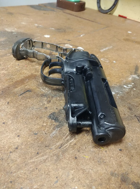

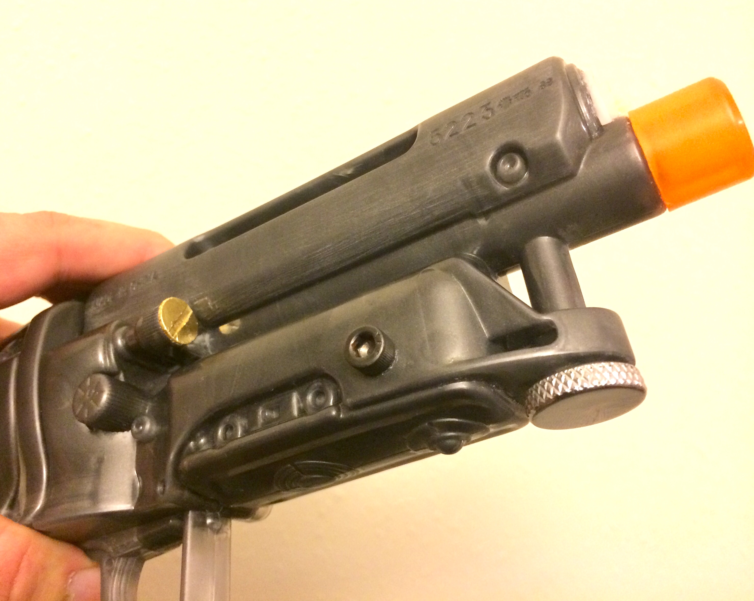

Here is a bit of what I have done to mine. Prepping the grip area for better grips, drilled out the muzzle and "crowned" it. Experimented with sloshing enamel paint inside and really like how it looks..plan to do it over the whole inside one the rest of the gun is finished.

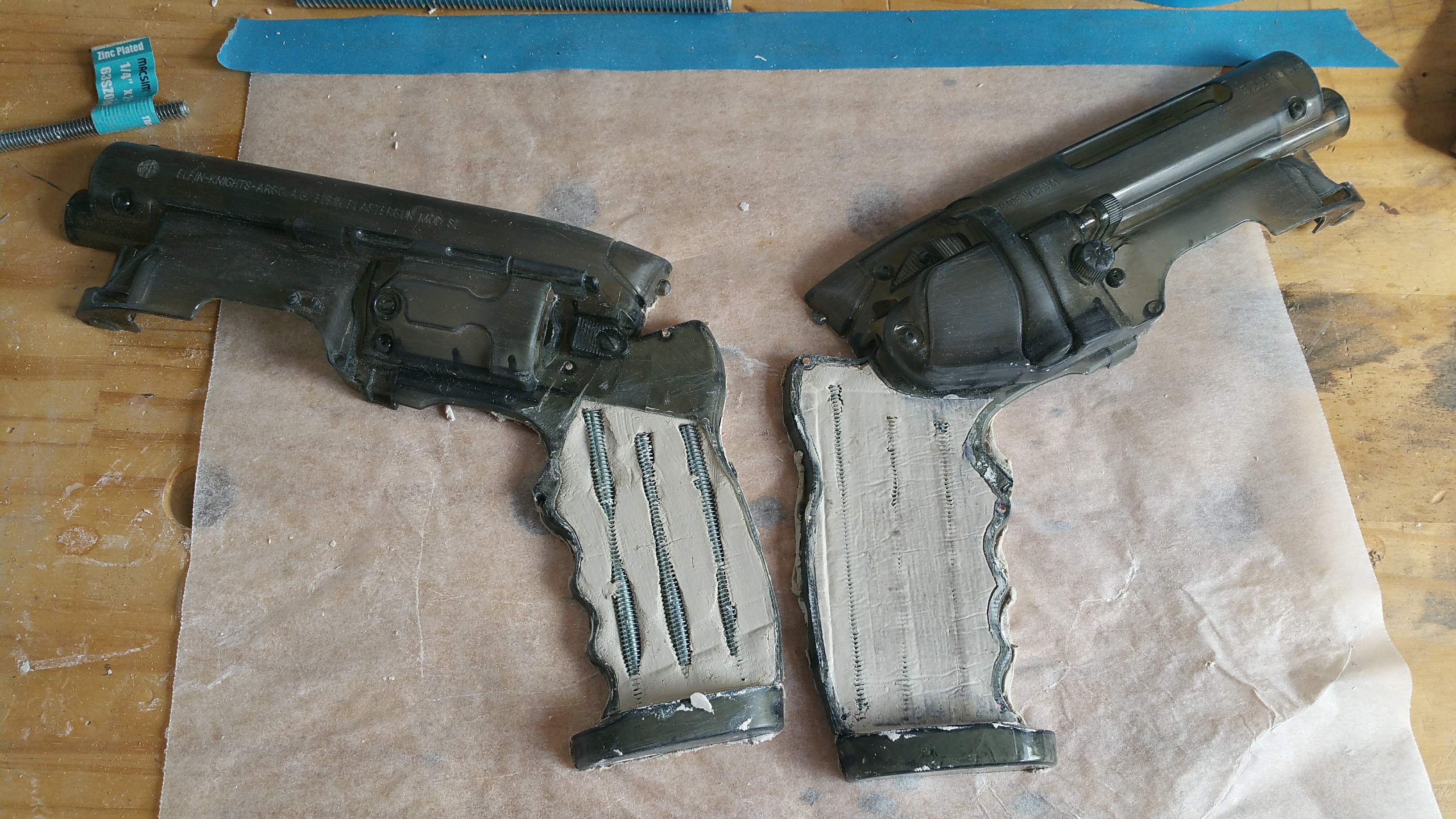

Filled the grip with air-dry clay and some threaded rod for weight.
I'll be adding more clay to the main body and some thicker threaded rod. I should get it up to about 1.2kg by the time I'm done.

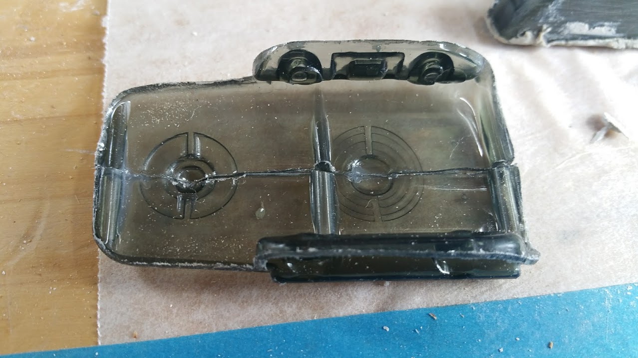

To gain access to the interior without splitting the main body in halves I thought i would just cut out the bottom of the magazine around the switch and LEDs. This will give a good sized opening to add weights inside and make it easier to fit the LEDs and wiring to the part removed.
This way I can keep everything intact.
