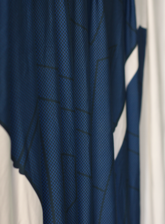

1. Using a slightly darker red lycra for the red sections (darker to emphasize the webs) and plain white (of course with a pattern to be printed onto) for the blue sections.

2. Having a pattern (provided by the ever so talented Timey Wimey) printed onto the fabrics. I did go on to modify his pattern to better fit my body and replaced the brick patterns on the blues and the dotted patterns on the reds.
Screen Shot 2017-03-27 at 7.41.11 PM.pngScreen Shot 2017-03-27 at 7.41.29 PM.png Screen Shot 2017-03-27 at 9.30.56 PM.pngScreen Shot 2017-03-27 at 9.29.56 PM.png

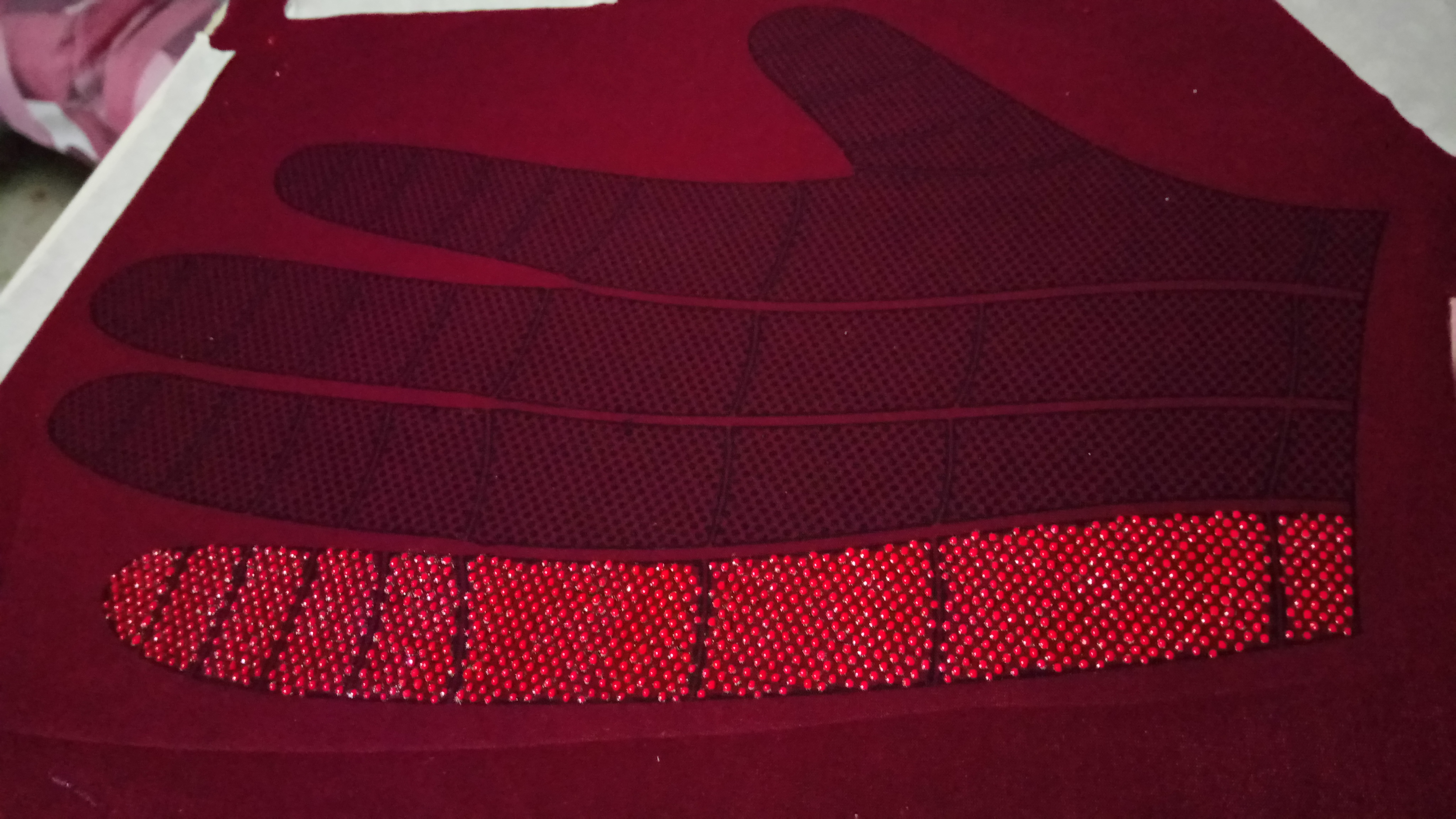

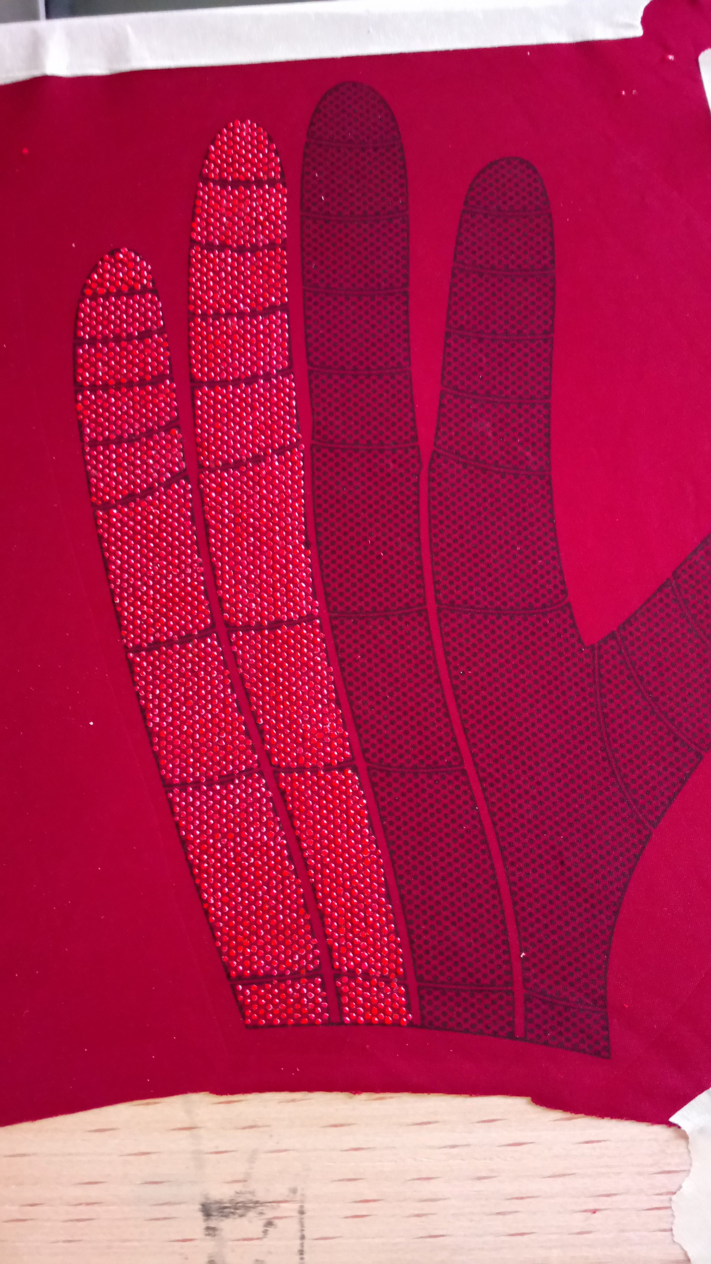

3. Puffy painting the entire suit to add texture. I could just go to local printing shop and have the texture screen printed but I like to think that making the suit with my 100% effort would make it a lot more special to me. As you can see in this image, I've tried out a lot of shades of red puffy paint to use on a test print. Using pure red puffy paint just didn't work out since it turns darker when it dries (bottom center left). I even tried acrylic paint and although it almost got the right enough shade, it was extremely rough against the skin (all at the top of the spider). I found it best to first apply a layer of white dots with white puffy paint, leave it to dry for a few minutes, and go over it with the red puffy paint. This makes the red stand out brighter and more vibrant (bottom center right)
So far, here's what I have. I started out with one side of the glove since it's a small piece and when i screw up, I could just that piece. The first pic best shows the contrast between the dark fabric and the bright puffy paint and the other would give you an idea of what the weblines would look like when it all comes together, and the dark fabric was really a great choice since the webs stand out.

Thanks! Goodluck with your build too. Mine WILL take a lot of time. That last pic with 40% of the glove puffy painted took like three or four hours to do. Imagine how long the rest of the suit will take :D

All in all, one side of the glove took me about 10 hours to do. There's still a looooot of work to do. Next update will probably be when all the sides of the gloves have been painted red, and will be then outlined with the black pinstripes

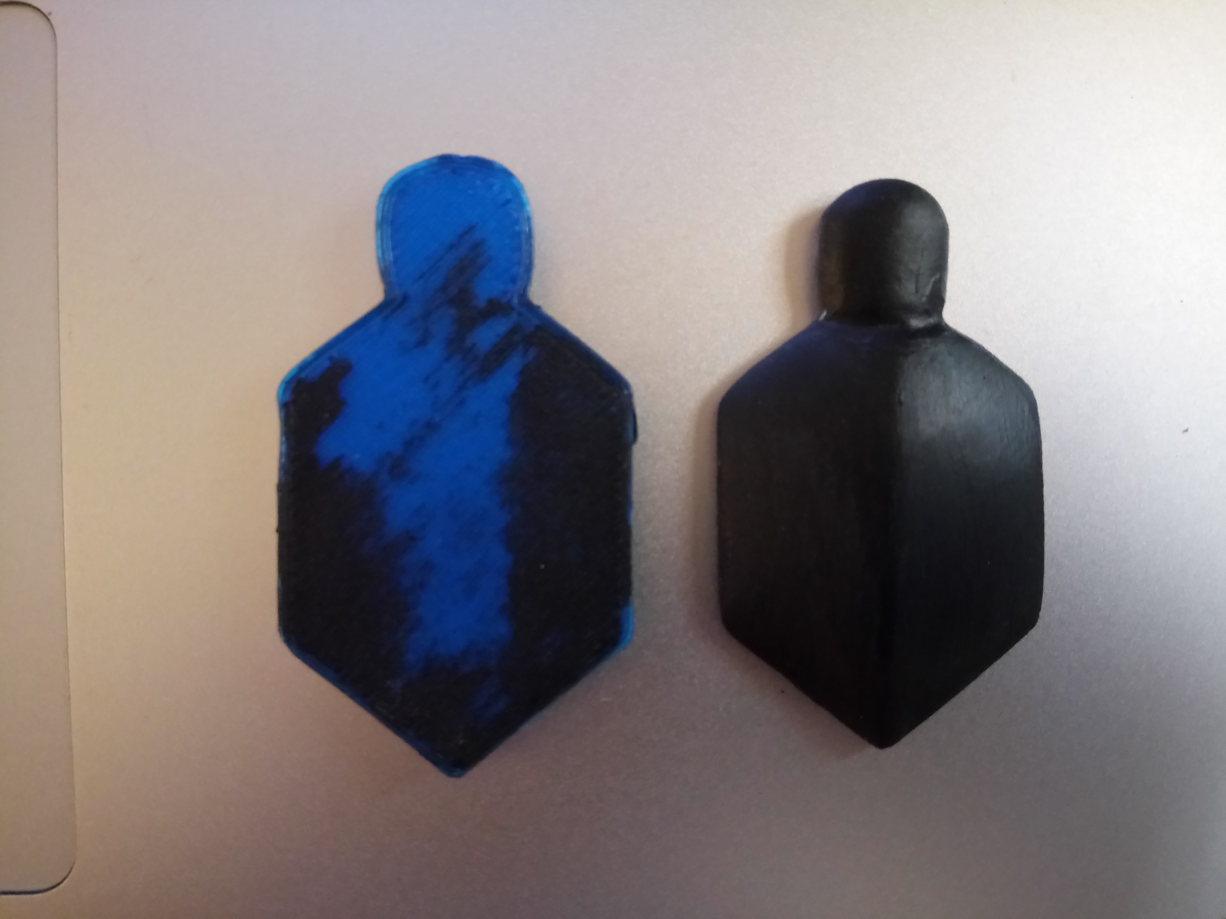

But in the mean time, I had created the basic shape of my own front spider, which I think is the most accurate so far, and had it 3D printed. I'll smooth out the sides and make the edges of the legs more rounded and I'll definitely add the 3d extrusion shape of the body. I'm still thinking about casting it in rubber latex, but I have heard that latex tends to shrink and rot in time (can anybody confirm?). There are no suppliers of urethane rubber anywhere in the Philippines or not that I know of, so liquid latex, puffy paint, or maybe even E6000 are my only options for casting. If anyone from the Philippines could help me out here to find urethane or anybody with advice on what's the best material to use for casting, that'd be great.

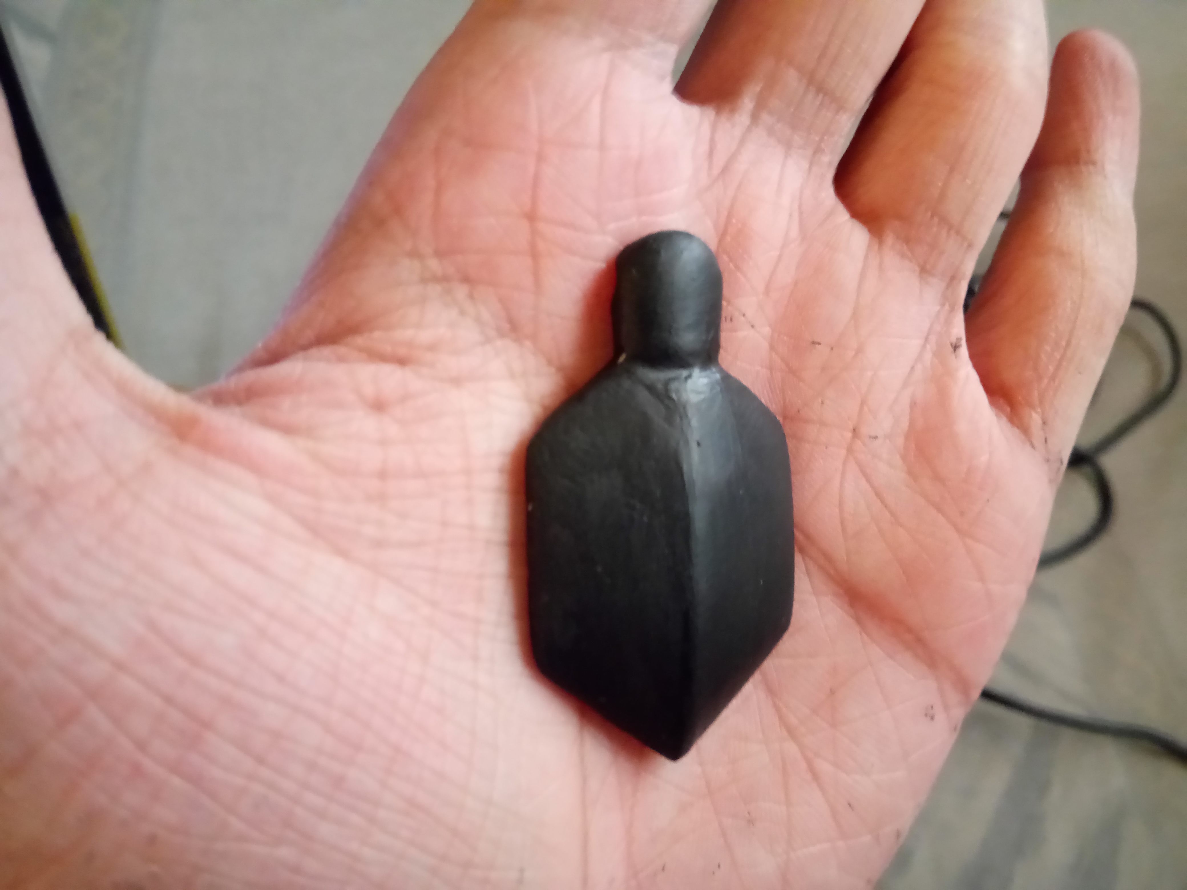

Hey all! Update on the front spider: instead of using the 3d printed spider and sanding it down, I cast the emblem in resin and sanded that down to get the shape right because sanding a 3d printed object takes hella long for me even with a power sander. So far I've got the body done. I'm still making a mold of the legs. But I think I did a pretty good job with the body.
Here's how it looks like on my print compared to the actual suit

Used this as my guide.
I used polyester resin to make my mold as I didn't have access to silicone, brushed the mold with petroleum jelly and poured in some polyester resin for casting
