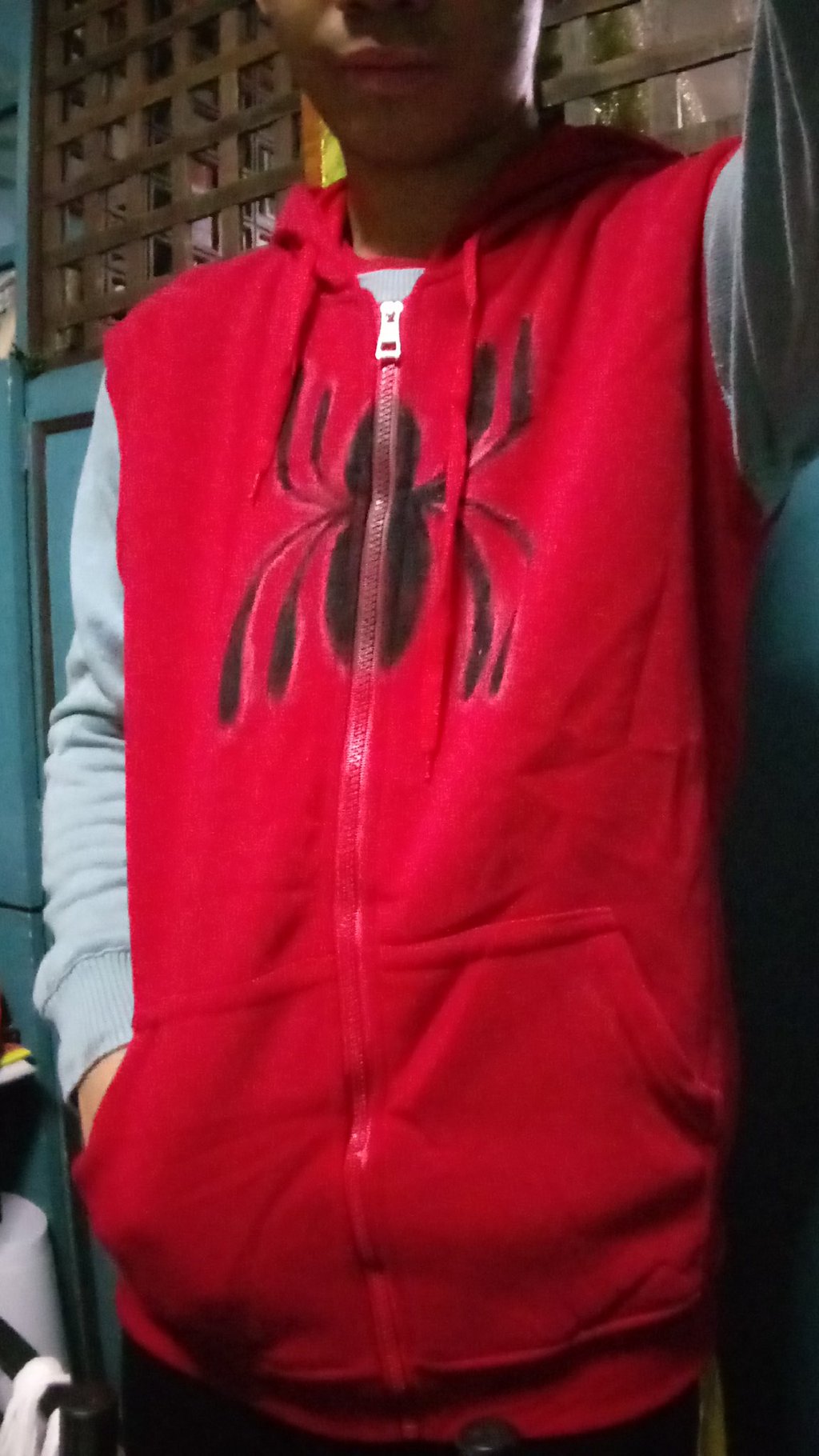

I think it's worth mentioning that I am working on the hoodie suit as well. Drew the spider on with some chalk and painted over it with acrylic paint. I didn't do a perfect job so I could get that homemade look. Here's a pic. (sorry for the real bad lighting)
I'll wash off the chalk with some water when the paint fully dries.

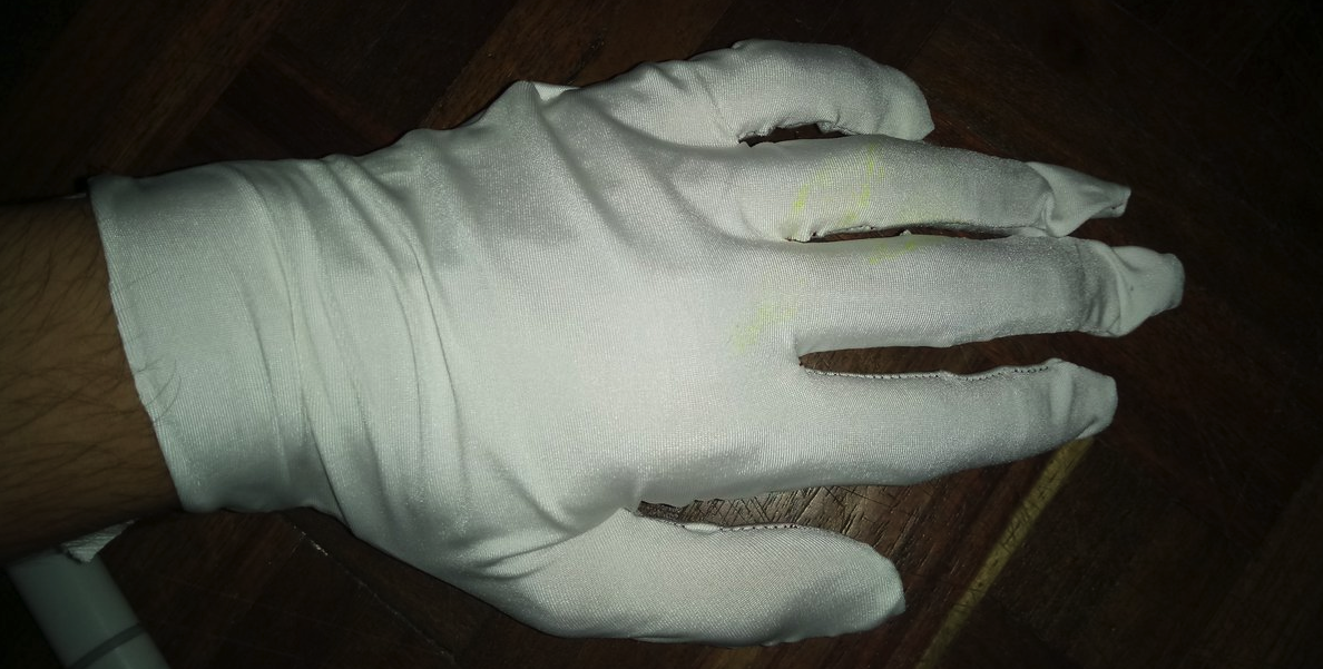

Update!

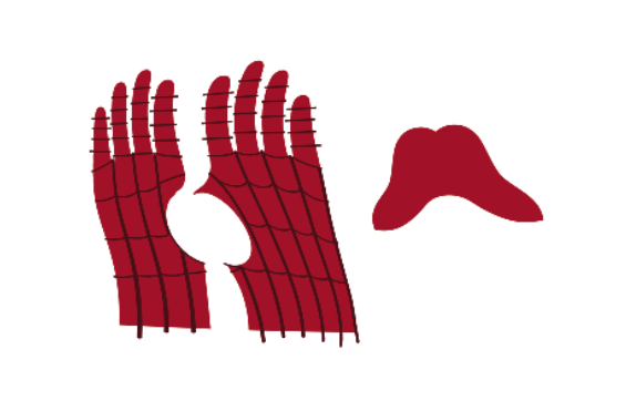

I finished puffy painting two pieces of the gloves which sadly I won't be able to use. They were ready to be sewn and before I did, I tried sewing a test glove with some scrap fabric I had and the middle, ring, and pinky fingers were about half an inch too long plus everything looked pretty loose.
I could adjust the stitching and just sew into the fingers, but I want everything to be screen accurate so I don't want a few missing weblines on the gloves. I sized everything in the pattern to fit my body, but I completely forgot to resize the gloves. So yeah, that's a huge setback.
I also played around with the puffy painted parts and added the black pinstripes and I really love the "indented" look that it's giving.
I'm currently working on the boots while developing a new glove pattern that would be comfortable and have more accurate seams.

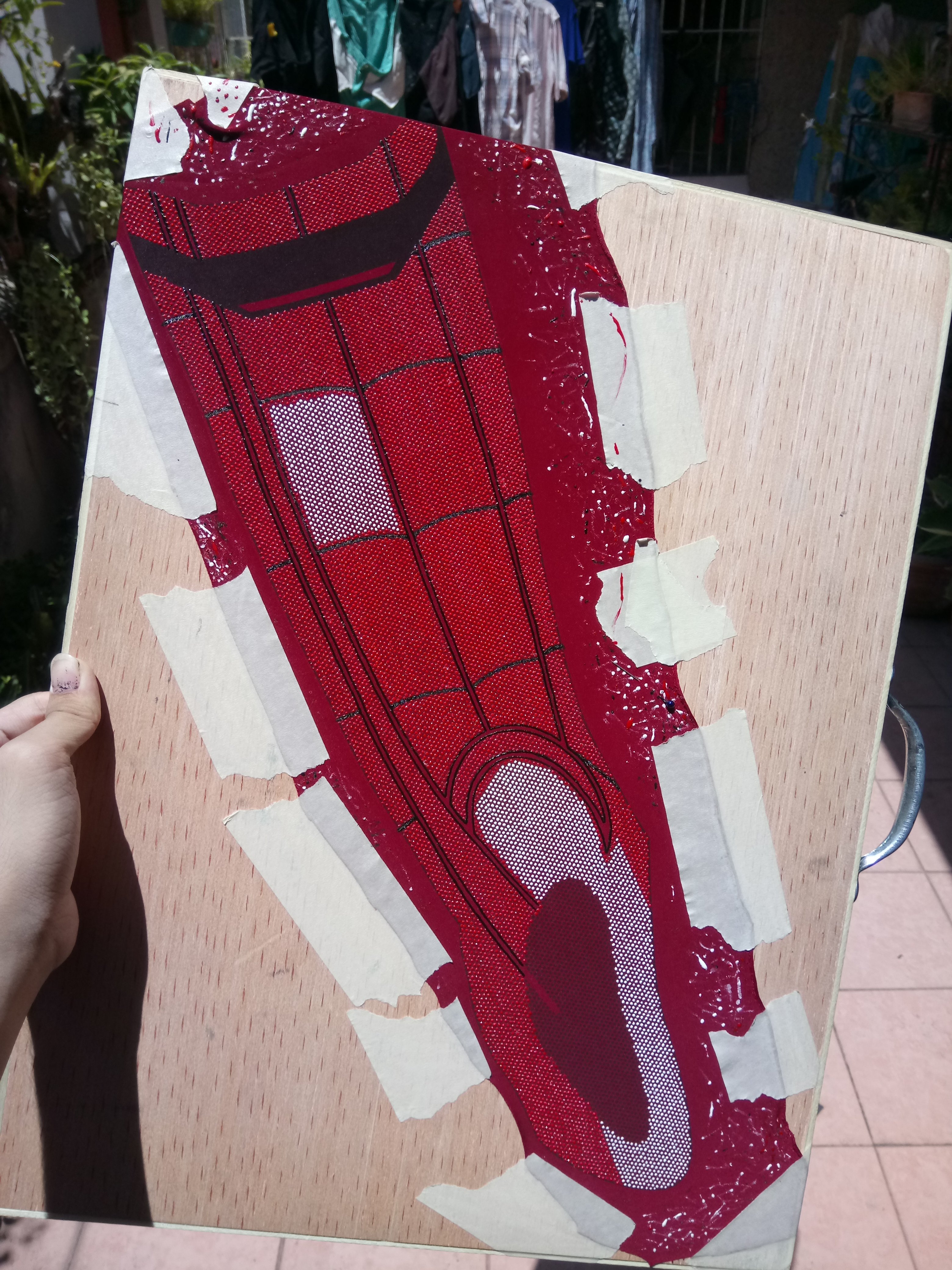

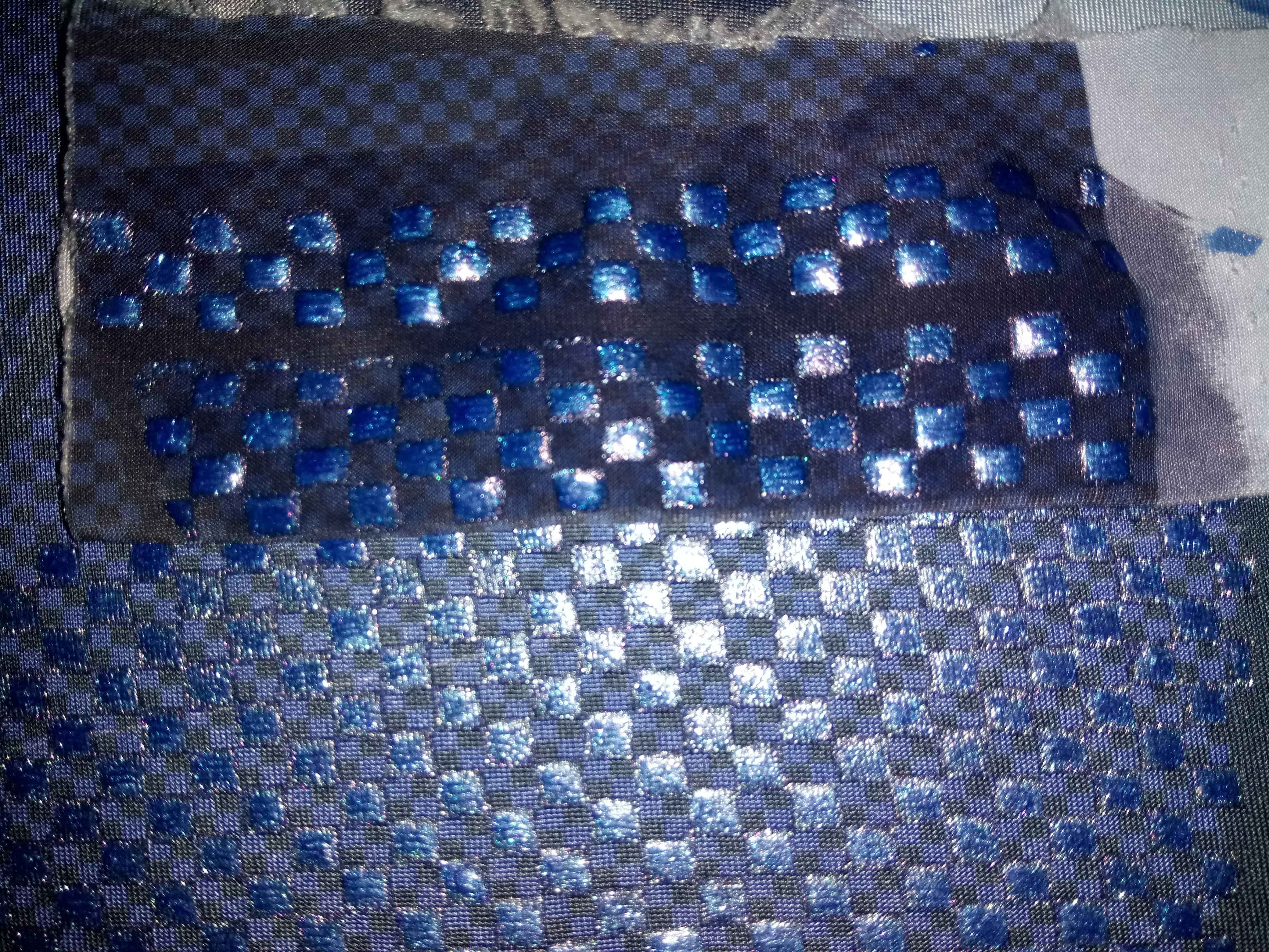

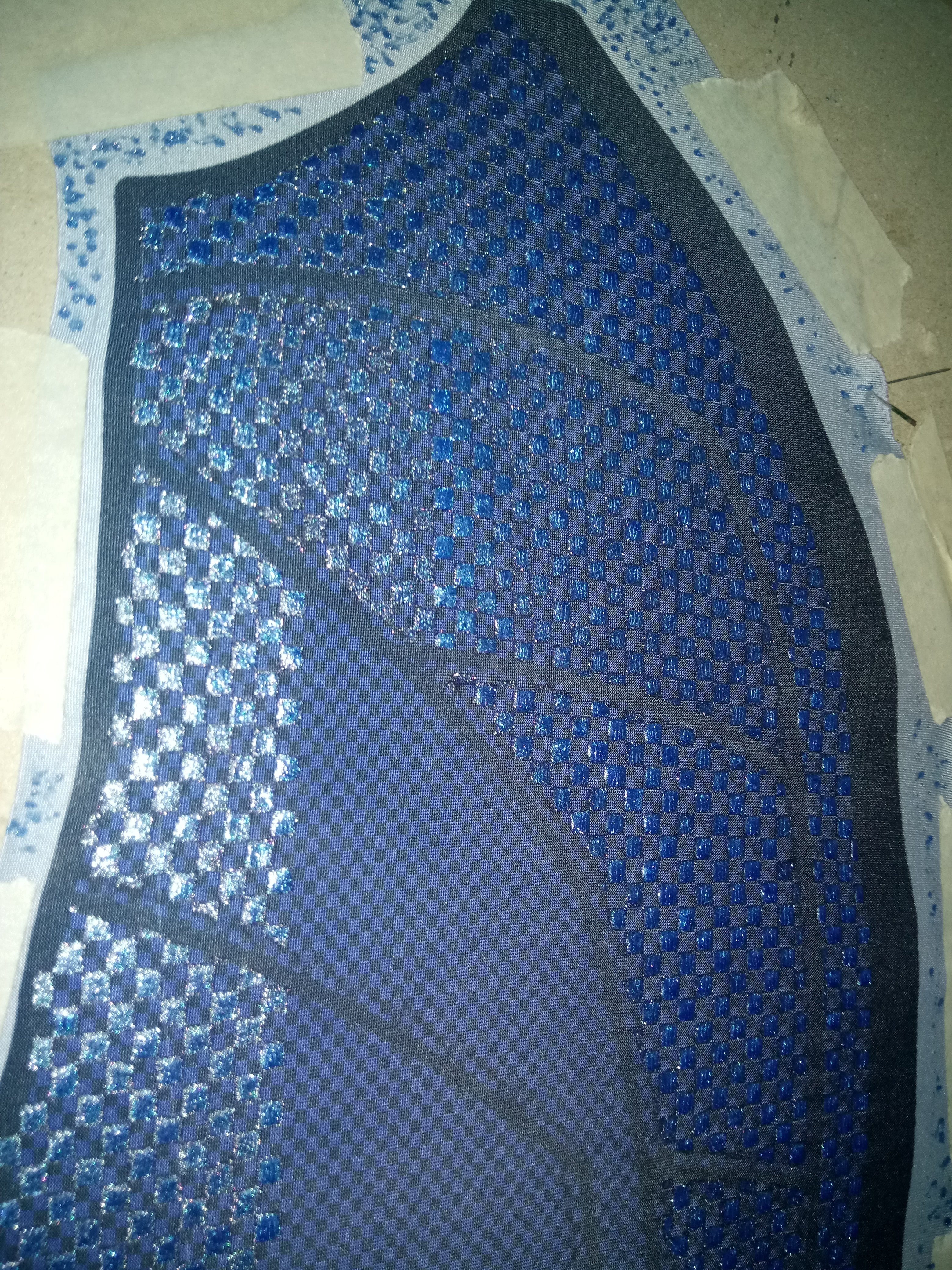

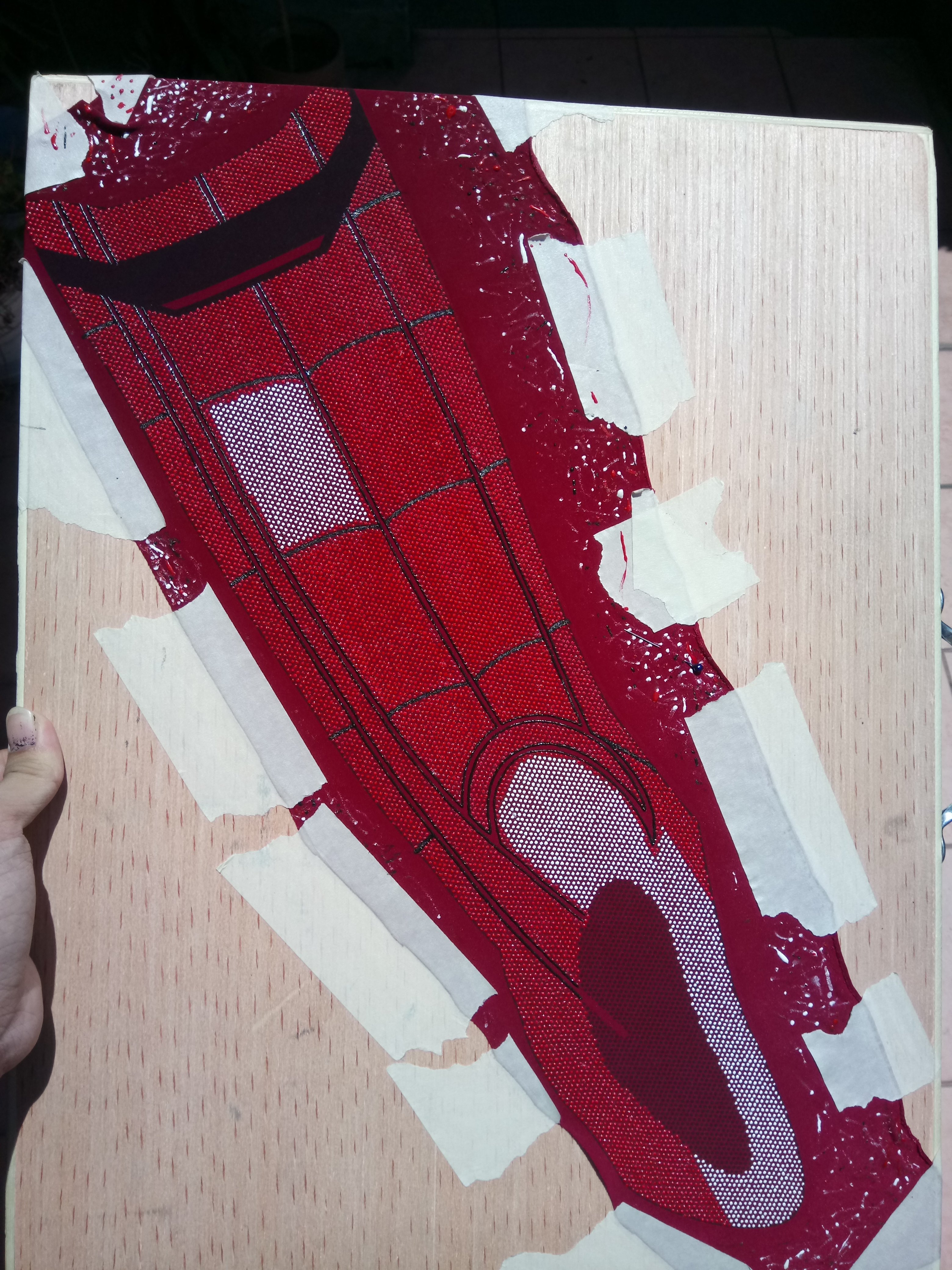

Alrighty! School is officially done so I have some time to work on this! While puffy painting the reds, I started puffying the blues.
I did mess up when I had the file printed, I sent the old version of Timey Wimey's pattern that I modified (which had the checkerboard pattern on the blues way too small) instead of sending the version with the larger pattern. So what I'm doing here is I puff paint 2x2 boxes so that way the pattern would not be a pain to fill up. To hide the smaller boxes, I'll be painting the back of the fabric with some navy blue textile paint which would also give the blue a richer color. Here's a test piece painted with navy blue compared to the unpainted. It's still there, but barely noticeable from a distance.

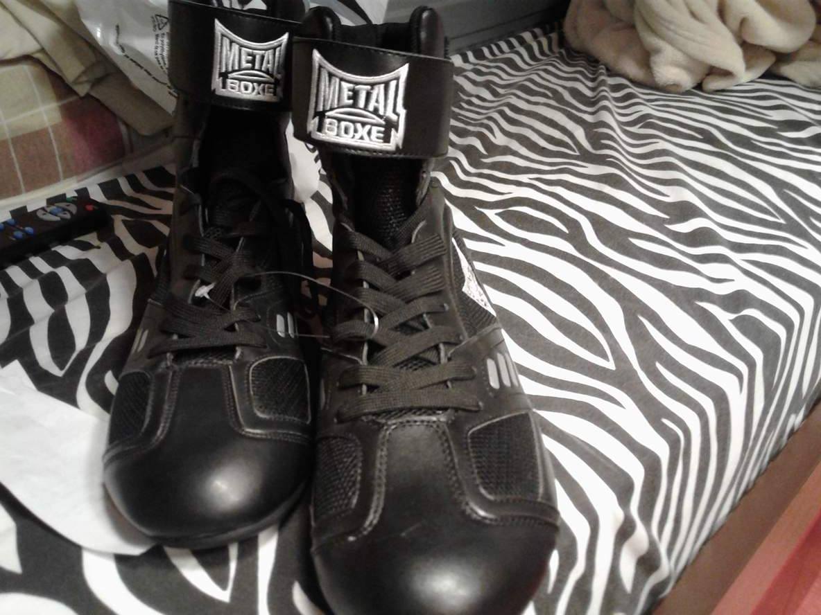

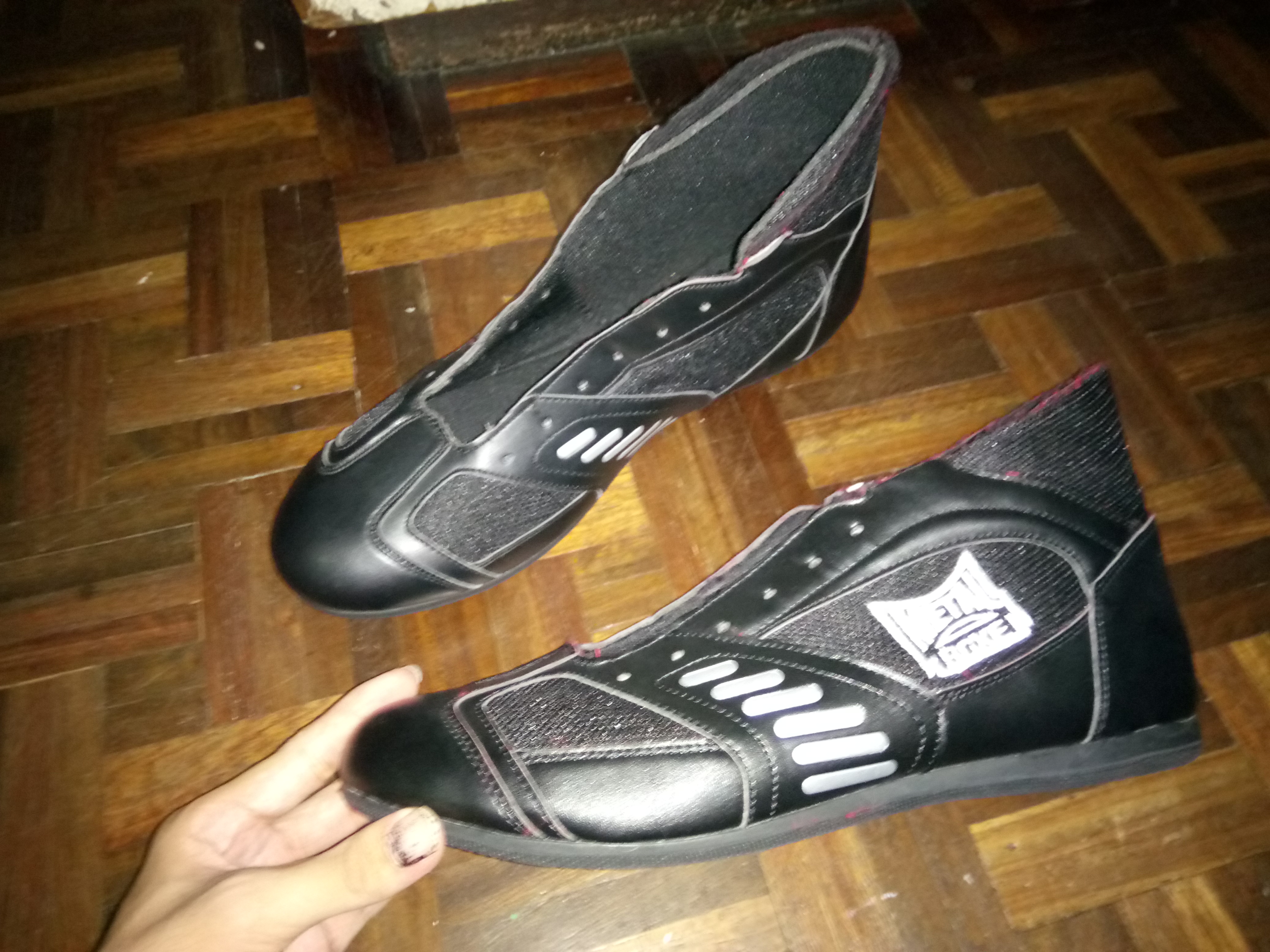

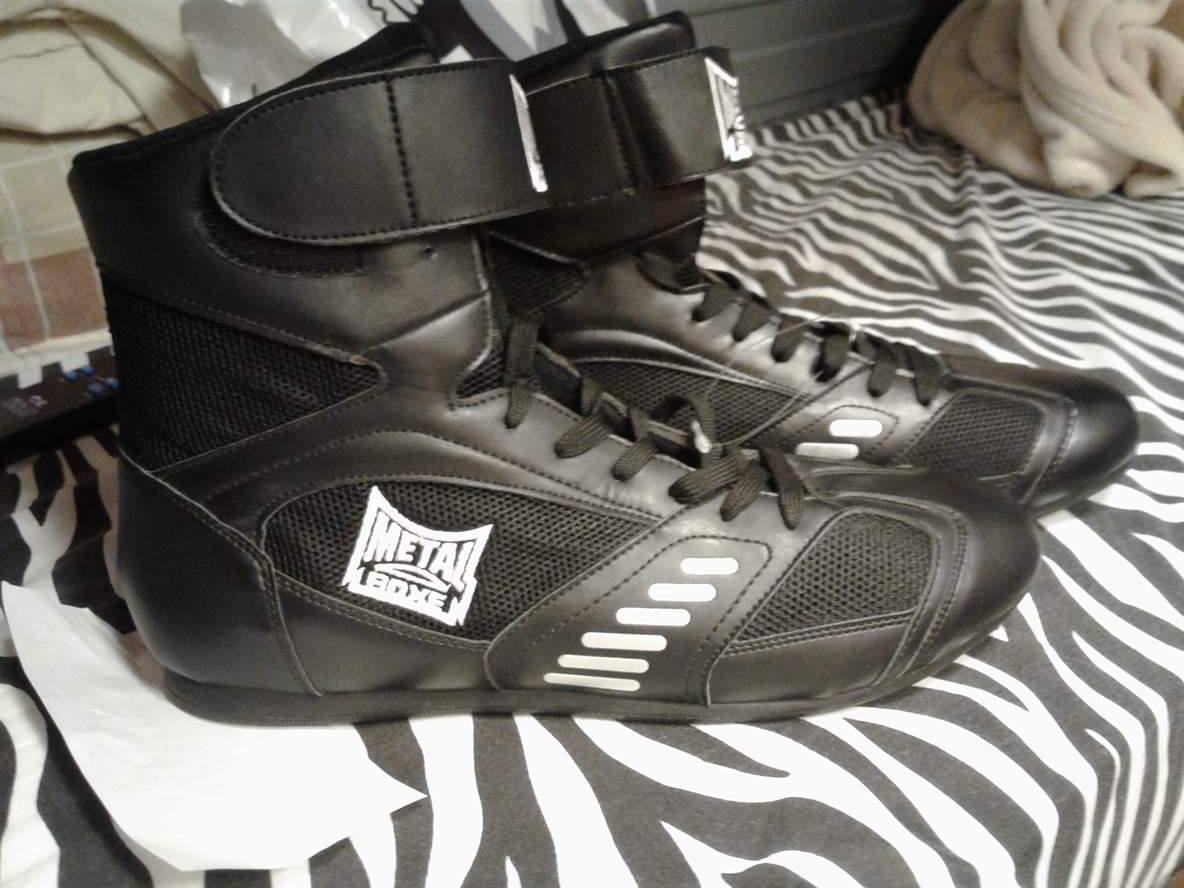

I'm still puffy painting one of the four pieces needed for the boots, but I just got the boxing shoes that I'll be using! My dad bought these for me overseas as I couldn't find the right shoes here in the Philippines. No red variant though, but I don't really think it matters that much when it goes under the suit.
17950065_120300003149920172_583245806_o.jpg 17948612_120300003140378954_318678010_o.jpg
I couldn't wait so I cut off the tops and unstitched the tongue.

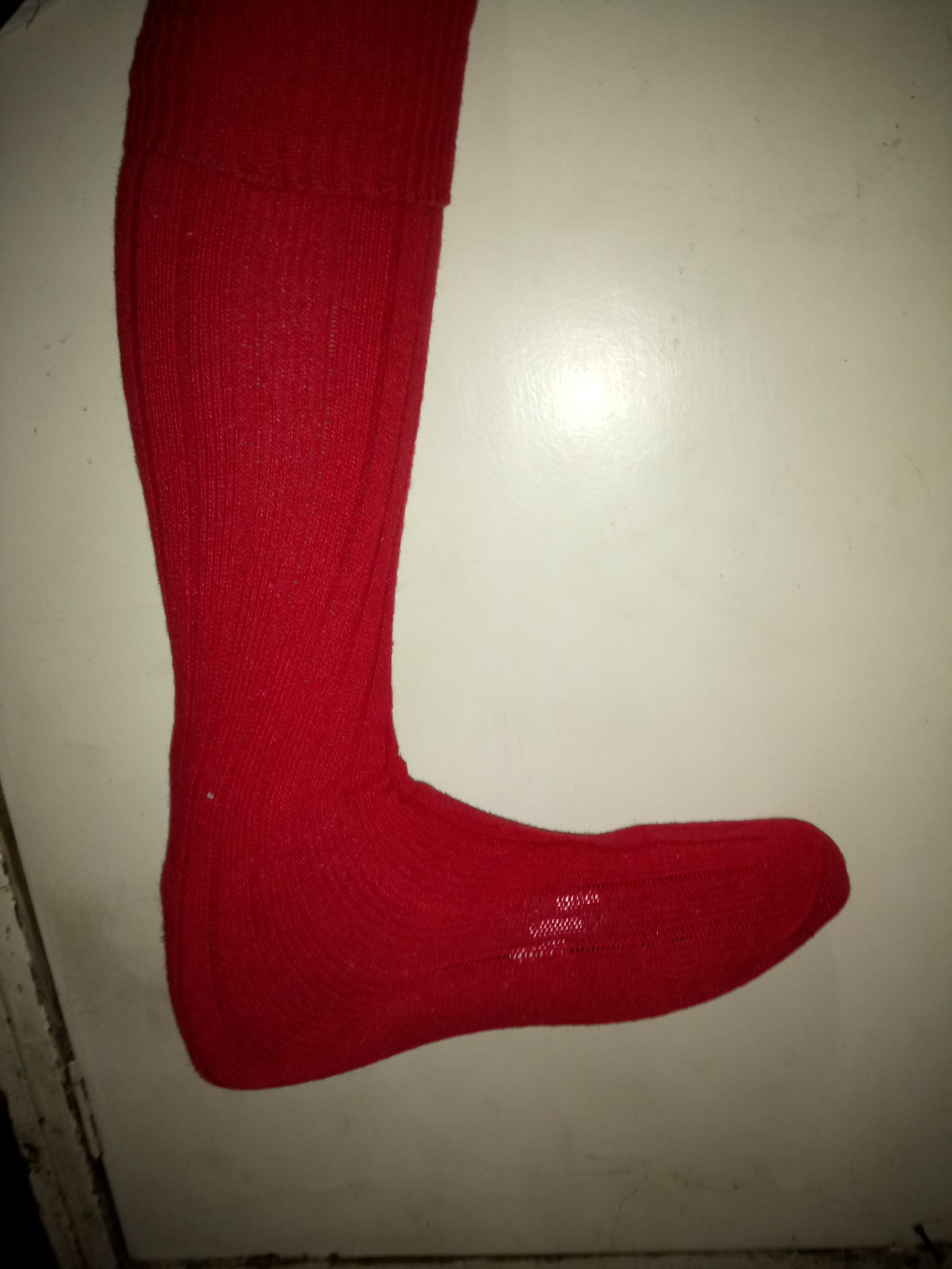

Due to sizing differences, they were probably two sizes larger than my actual foot size (and I'm always comfortable with one size larger) so they were really loose on me when I removed the tongue. I got worried that they would look way too big on the actual suit. But instead of giving up so easily, I slipped them into my homemade suit's red socks and tried them on. They actually fit well, still a bit loose but I think it can be fixed by either adding an extra insole or wearing thicker socks inside. After looking at reference pics of the real thing, I think it actually looks great.
Though I will have to paint the silver linings on the shoe with black so they won't show. But that's not gonna be a problem at all. I'll be posting more updates soon. Thanks for viewing!

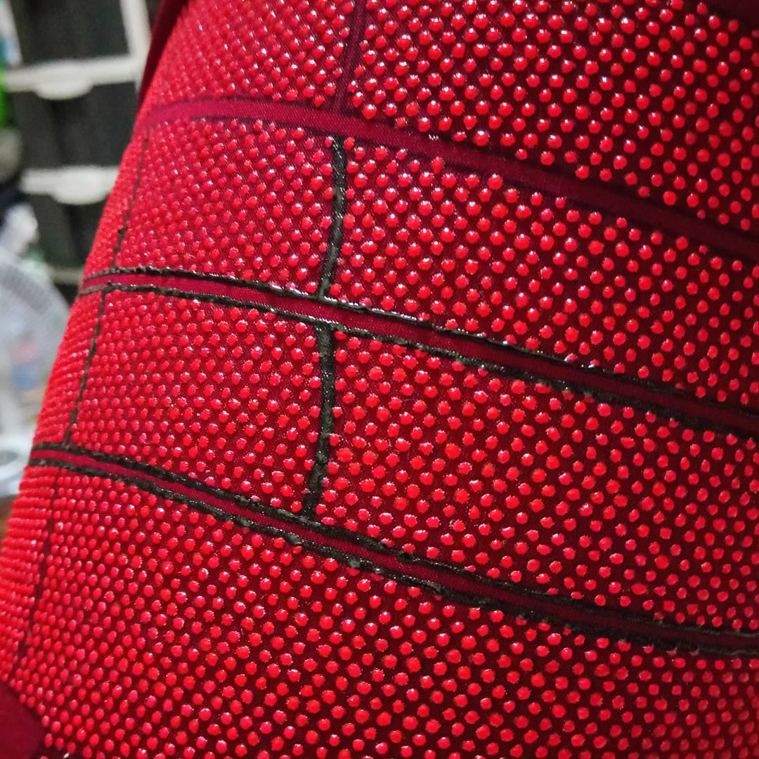

Just something I wanna show off, I took the almost finished puffy painted piece outside and I just love how it's looking! The shiny weblines really do make it look like they're indented.

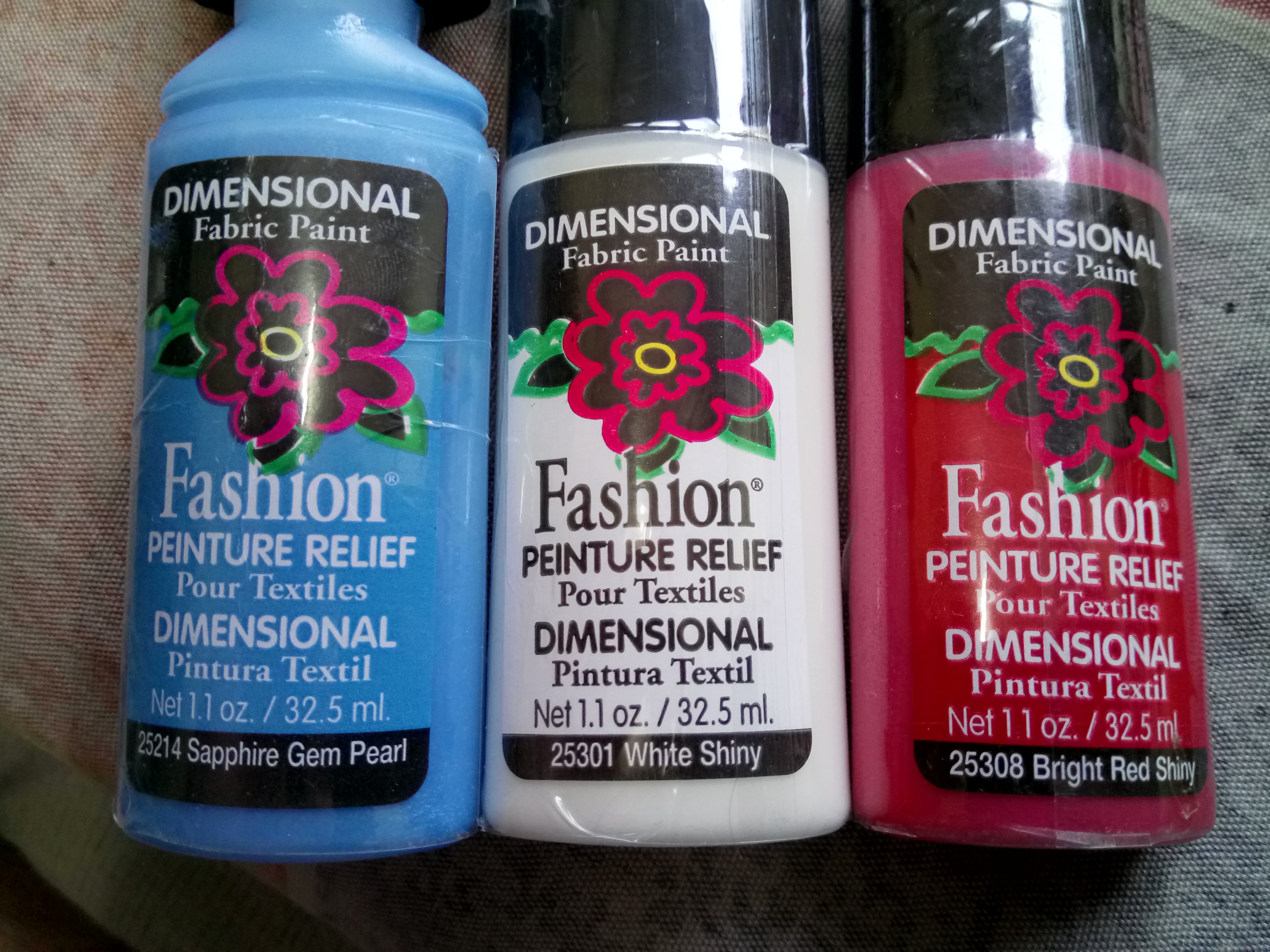

Thanks! I've always had a soft spot for detail and accuracy. And I'm studying at an art school, so that definitely helped me learn and appreciate the beauty of small details and how they contribute a lot to the whole thing.
Well this is the brand of puffy paint that I'm using: Dimensional Fabric Paint by Plaid.
For the white and red dots on the reds of the suit, I don't use any applicator tips or anything, I just use what comes with the bottle.
You can see how I use it in my instagram post here:
[video]https://www.instagram.com/p/BSYYuJdl-AE/?taken-by=maffhewdc[/video]

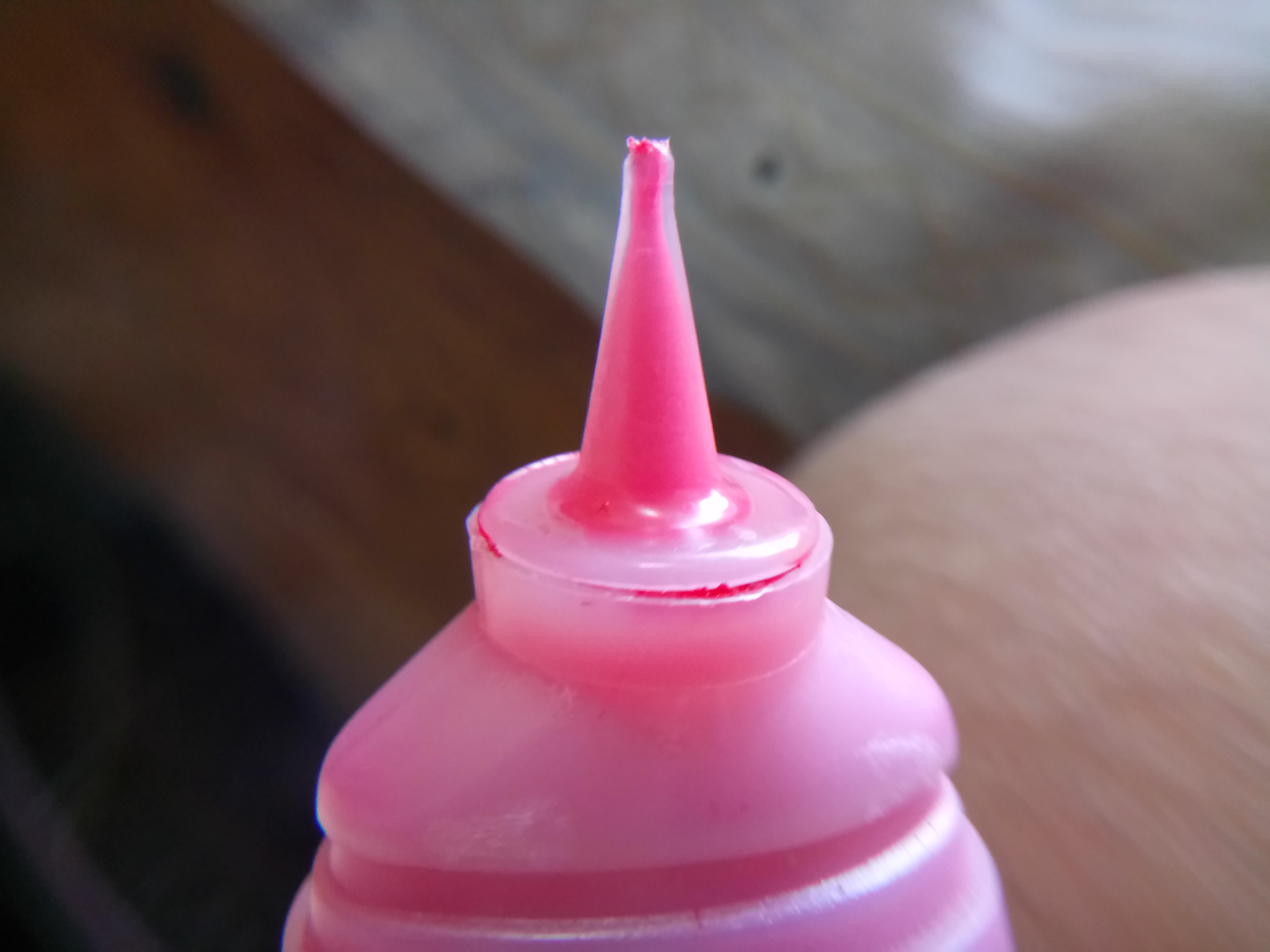

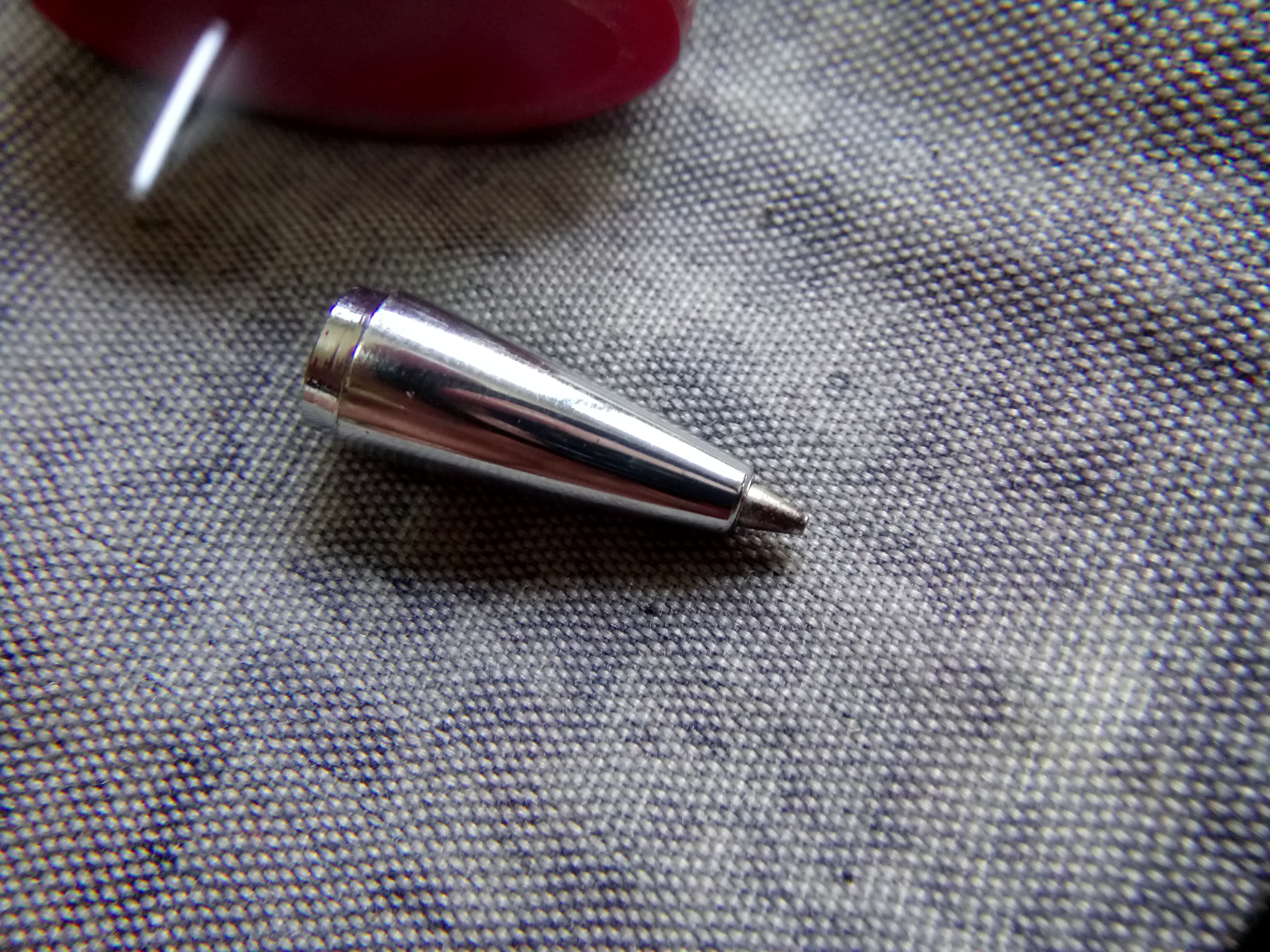

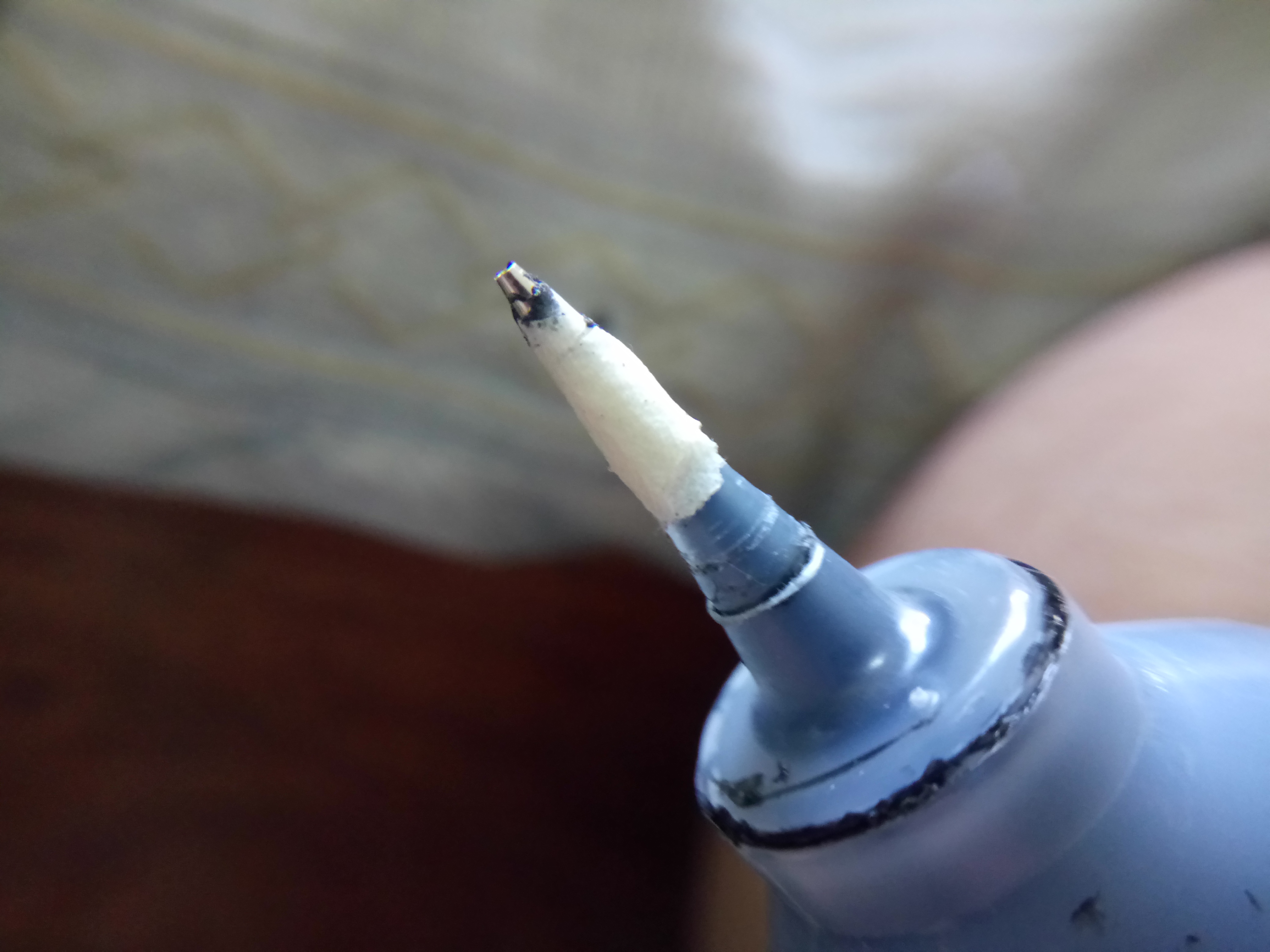

For the blue sections of the suit, I use the tips that you get from mechanical pencils. I took the pointy thing out of the housing and I wedged that into the nozzle of the original bottle's tip and wrapped tape around the nozzle to secure it.
[video]https://www.instagram.com/p/BUsi3mUFItc/?taken-by=maffhewdc[/video]
Basically that's it. I don't use anything too fancy, I tend to look for alternatives around home when doing stuff like this. Good luck on your build!
Re: Matt's Spider-Man: Homecoming Suit build!
to conclude,did you use white puffy paint,and painted them with red acrylic ?Sent from my SM-J7108 using Tapatalk
I first cover the whole thing with one layer of white puffy painted dots. After that, I go over them again with red puffy paint. The purpose of the white is that it reflects light so the red looks brighter.

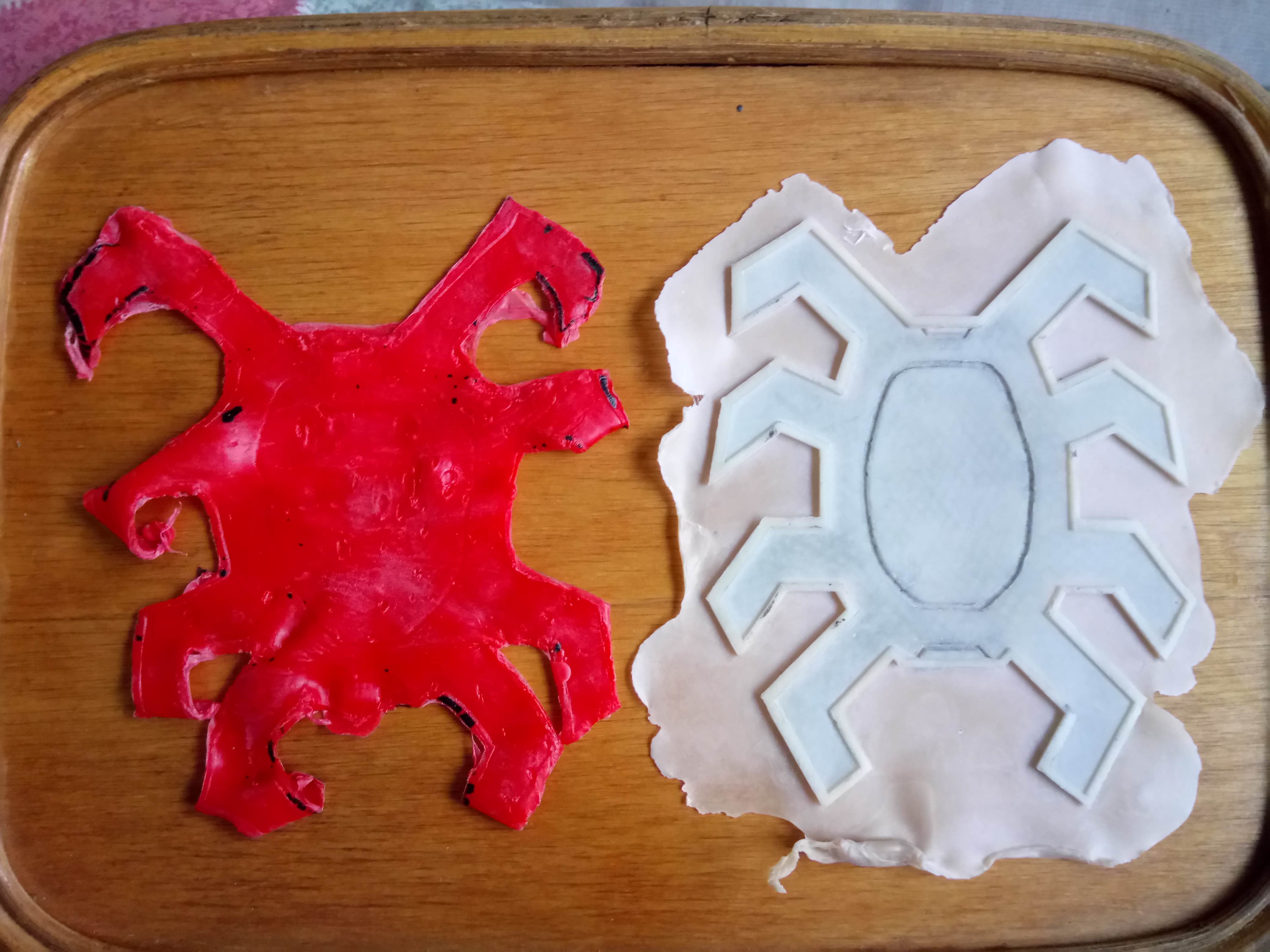

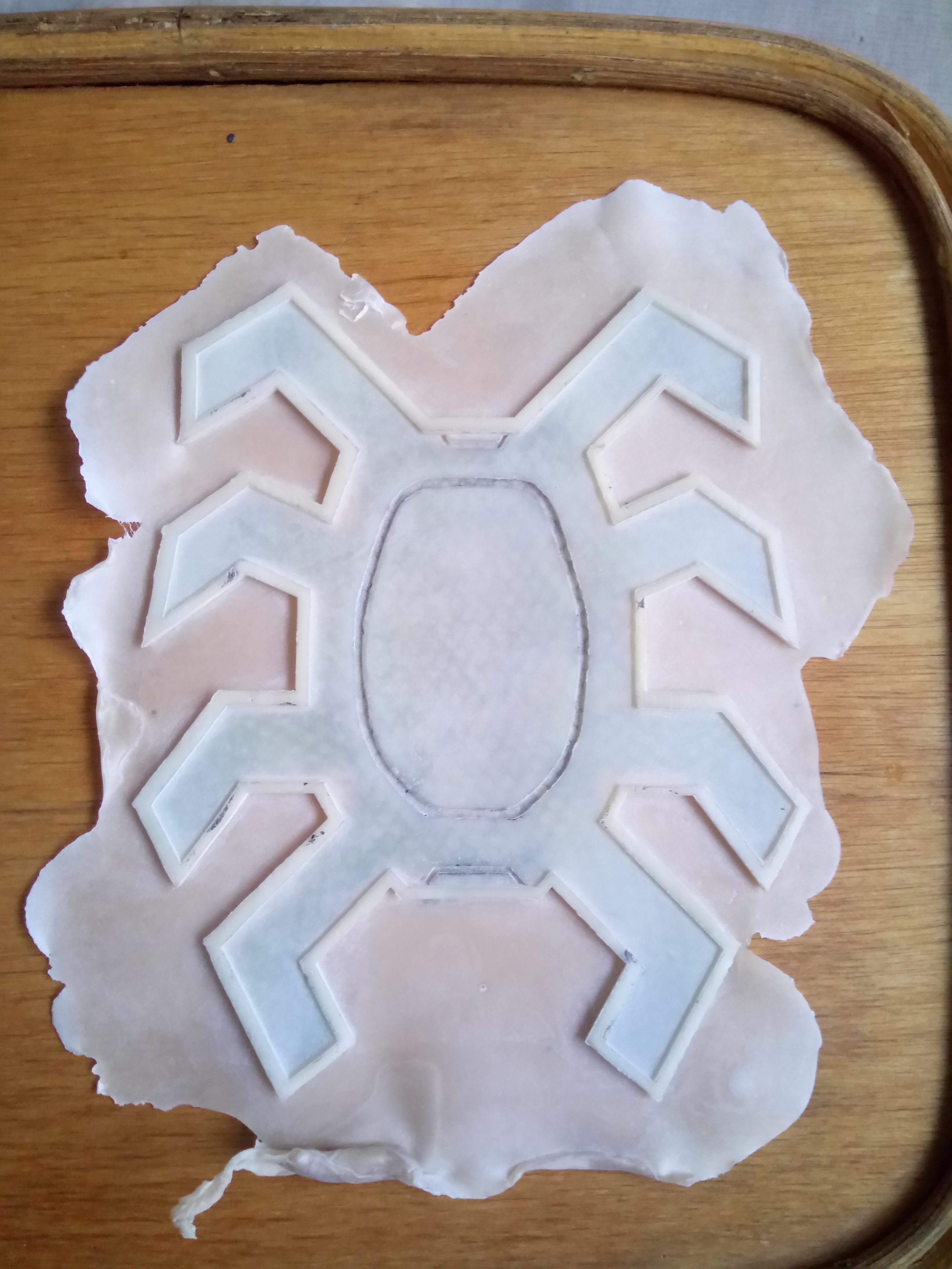

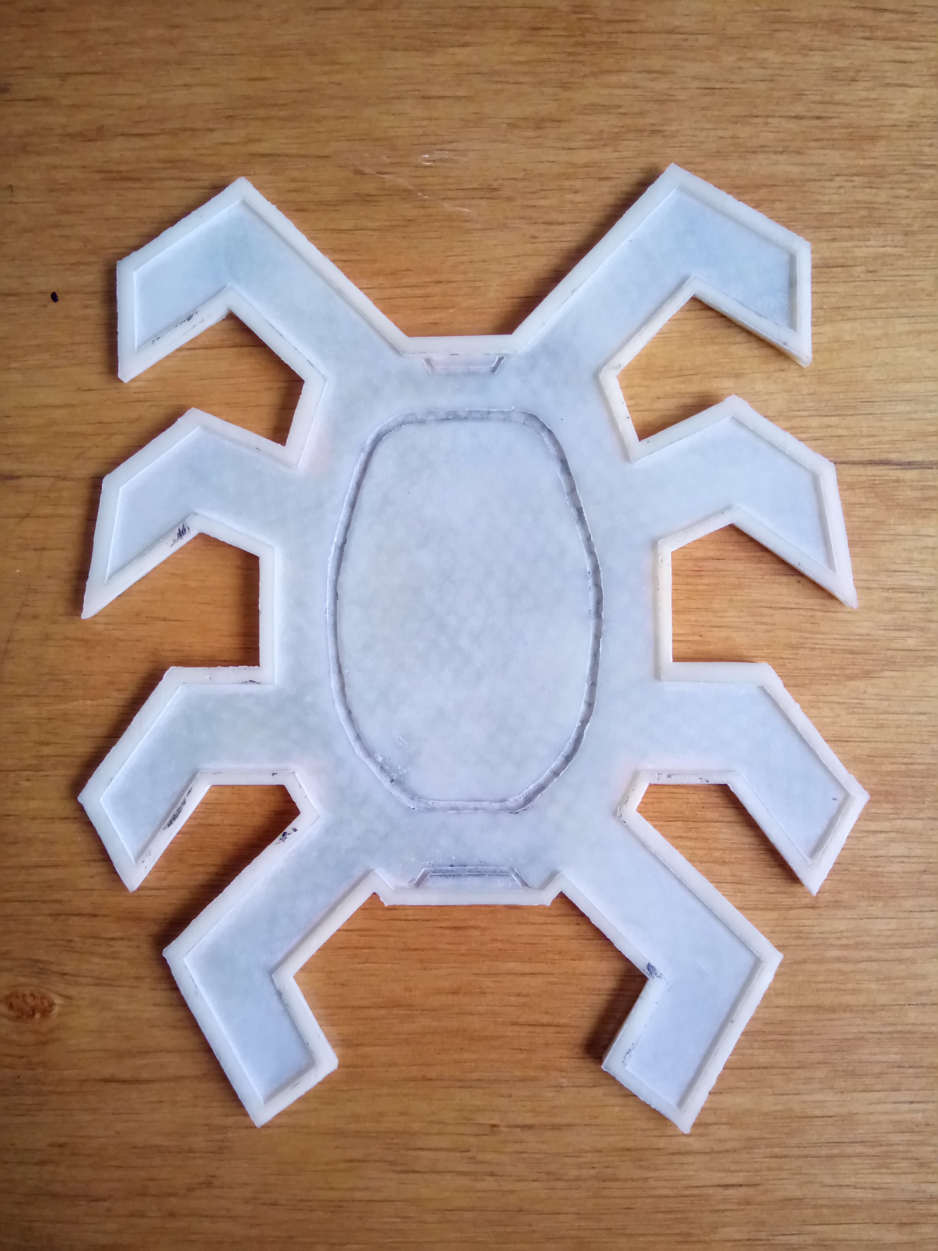

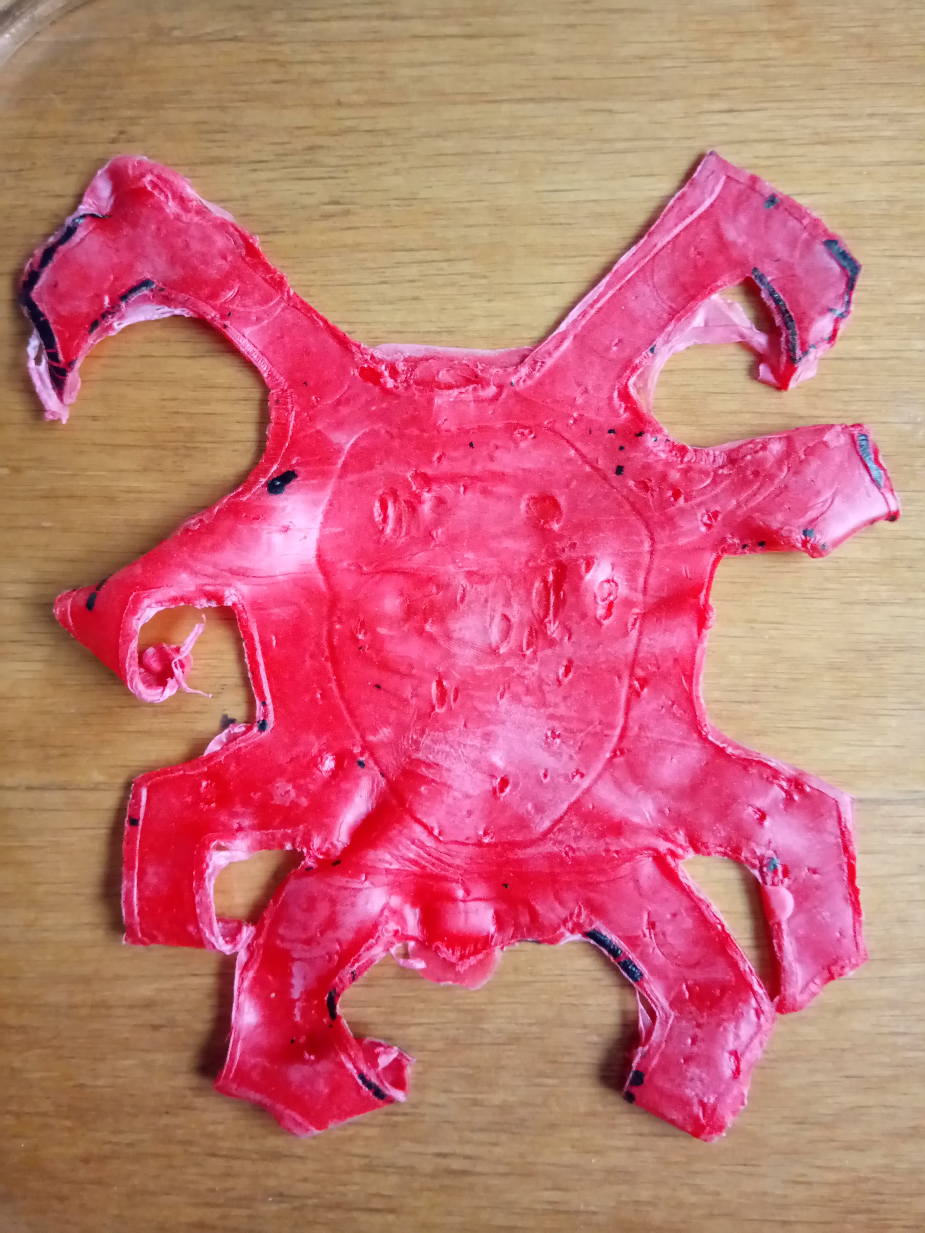

Alright so if you've been following me on instagram and checking out my stories, you'll know that I've started working on the back spider. I created a mold with about seven layers of vellum board and glued those together to get the shape and extrusion that I wanted. I then spray painted that with thick coats of black to smooth out any marks of glue and small imperfections. It's actually my first time playing around with liquid latex, so I was quite excited. In my first attempt, I mixed some red acrylic paint with the liquid latex to get that nice red tint when the latex dries. I left it to dry for about 10 hours. After demolding it, well.... it didn't turn out so good.
The legs got stretched too far out and there were pores everywhere even though I used a squeeze bottle to apply the liquid latex. It looked terrible. But then again, it was my first time with latex. I researched on what I could have done wrong. First of all, the piece got so overstretched because it wasn't dry enough. Second, the pores on the cast piece were due to the acrylic paint and the liquid latex not being mixed well enough. And finally, I learned that one must apply a netted fabric or something similar to avoid it overstretching.

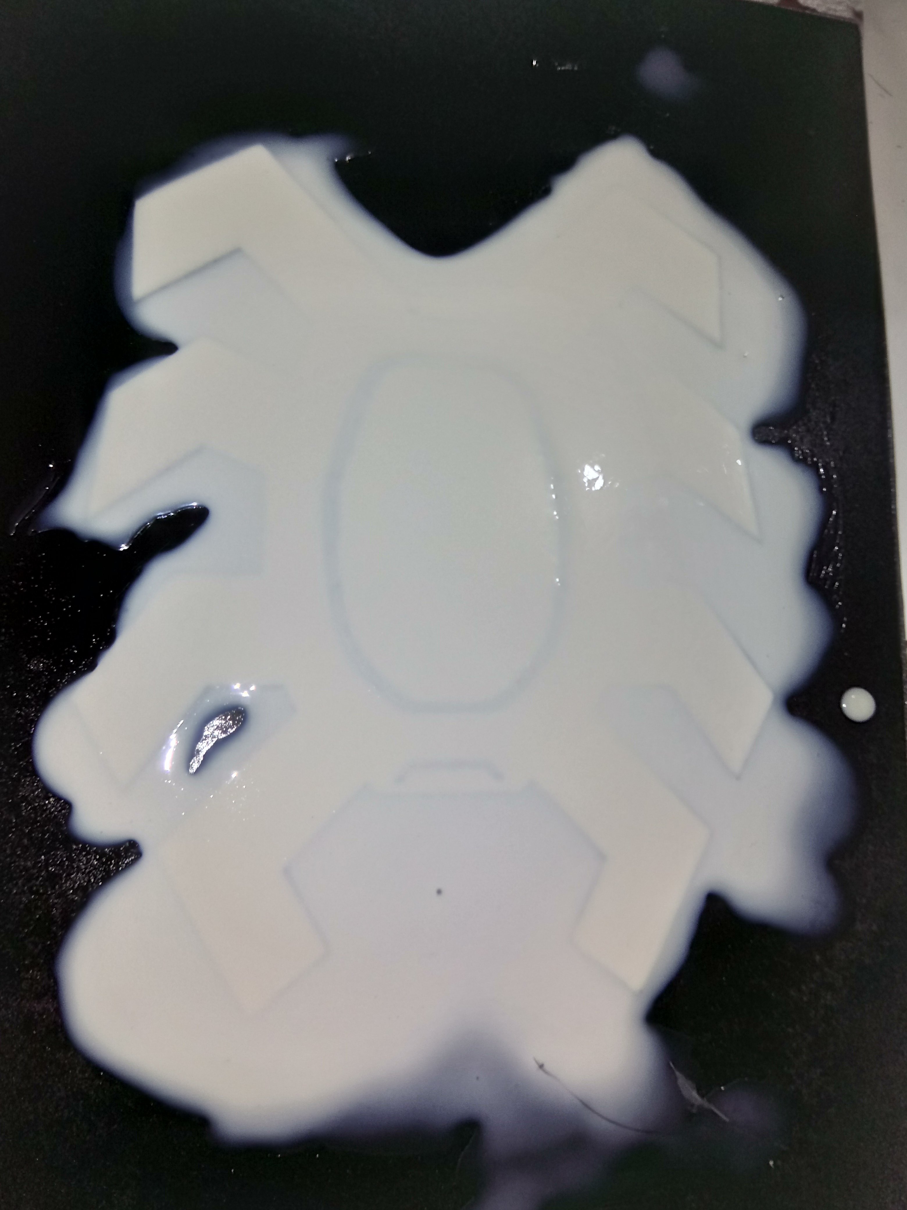

So I cleaned up the mold, refined it to get the engraved lines on the spider a bit deeper and I poured in just the liquid latex without any mix of acrylic paint.
Then I left it to dry overnight before I applied the netted fabric and added another coat of latex. So to avoid my previous mistake, I resisted all urge to touch or remove the latex from the mold. I left that to dry for a whole day before I demolded it today (the morning after I added the fabric). I spread powder all over it to avoid the latex sticking to itself, powdered up my hands as well and pulled out the cast from the mold. And voila!
I love how it turned out! It was well worth the wait and you do learn from your mistakes.
Trimmed.
Here's a before and after pic.
Love how this is coming together. Stay tuned for more updates!

did you make the mold freehand?
If you're asking if I used 3d printed parts to make the mold, no. I glued together 7 sheets of vellum board and used an xacto knife to cut out the shape of the spider and all the layers that I used to make this
