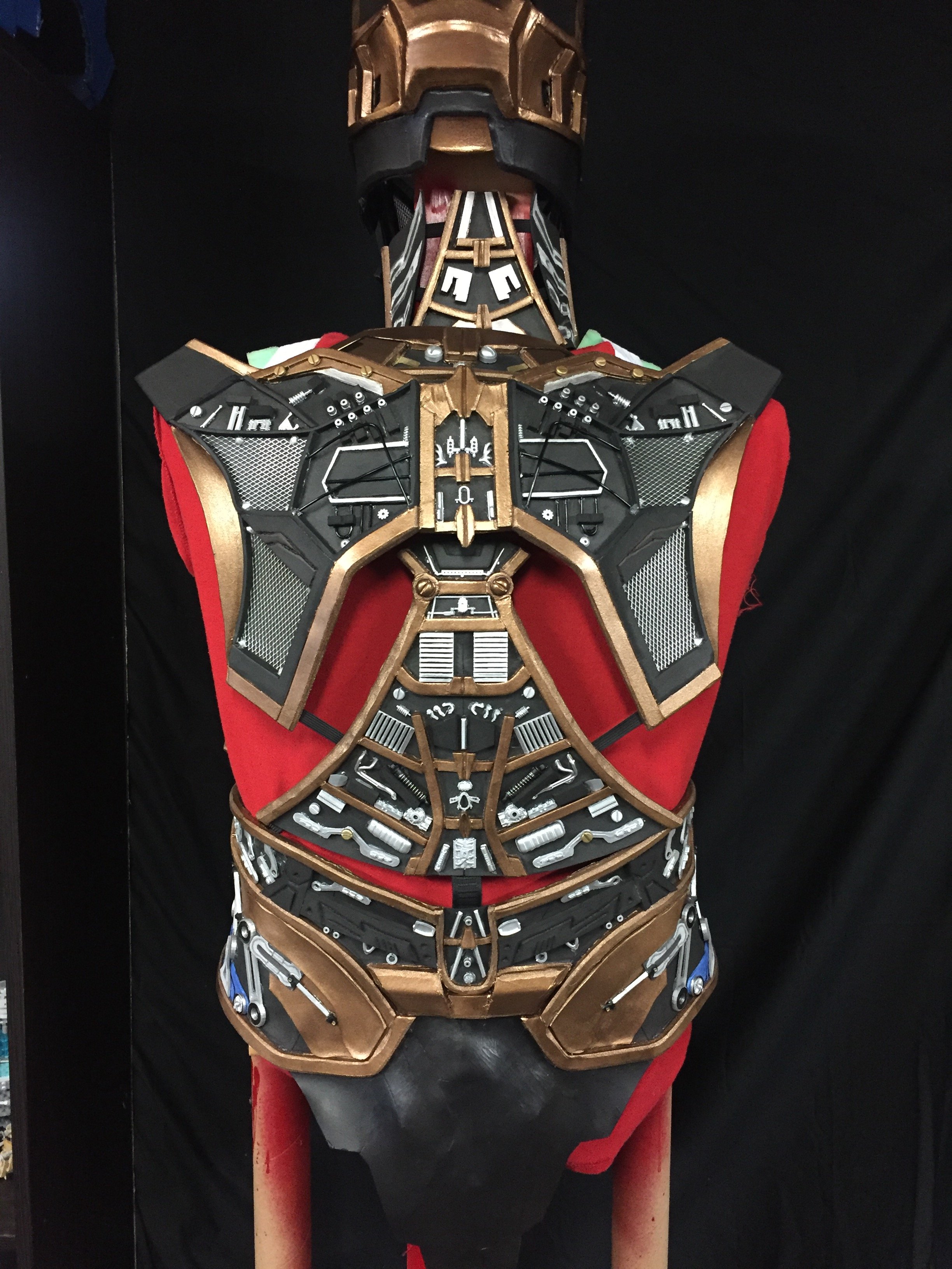

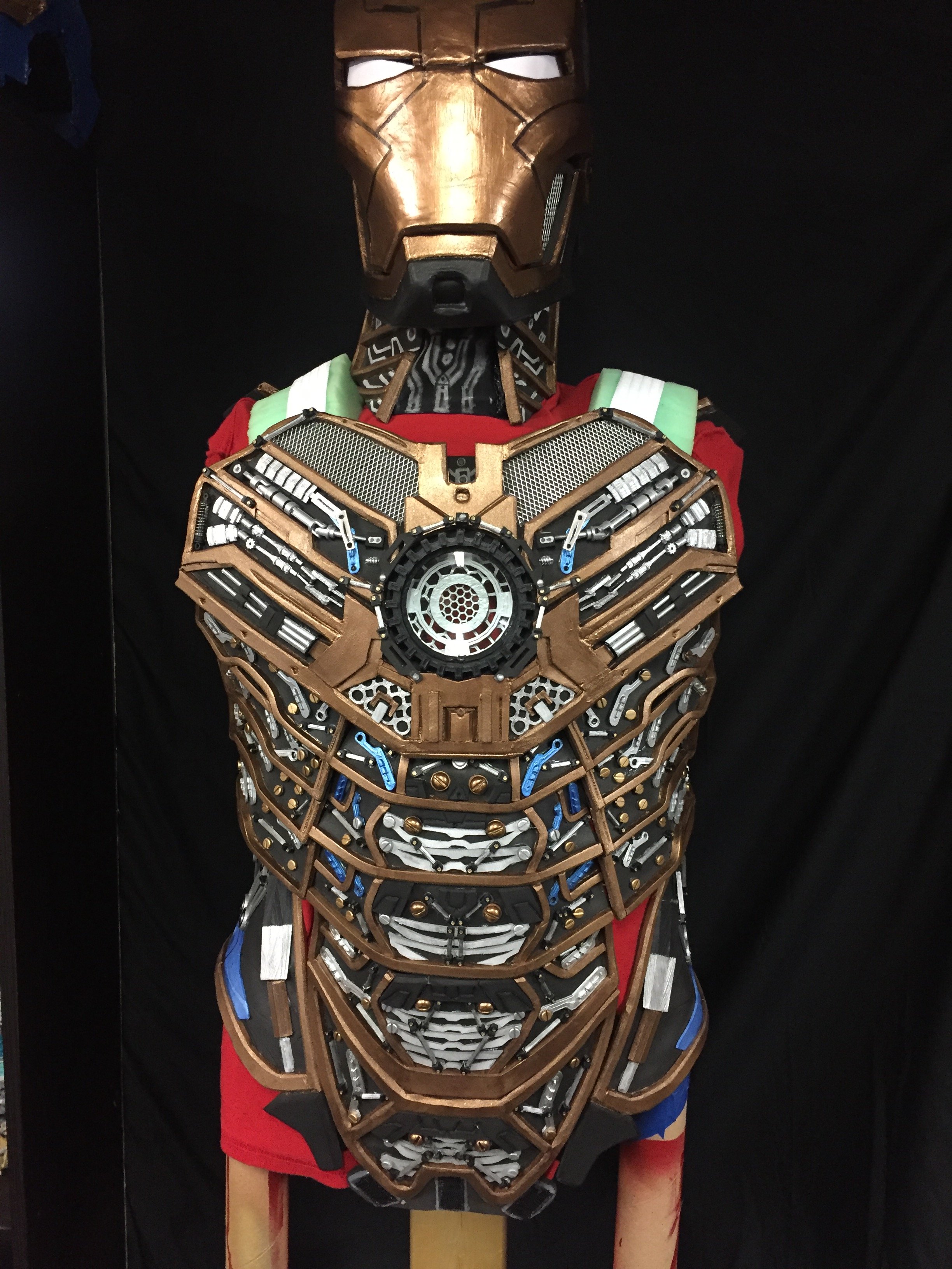

As of last night I have a head to toe completed suit. It is now ready for heat treatment and paint. Here is me talking about it a bit before I continue the project. Enjoy and grab some snacks, this video is 30 min long. Ps: Sorry for turning my face into the mic, my bad.

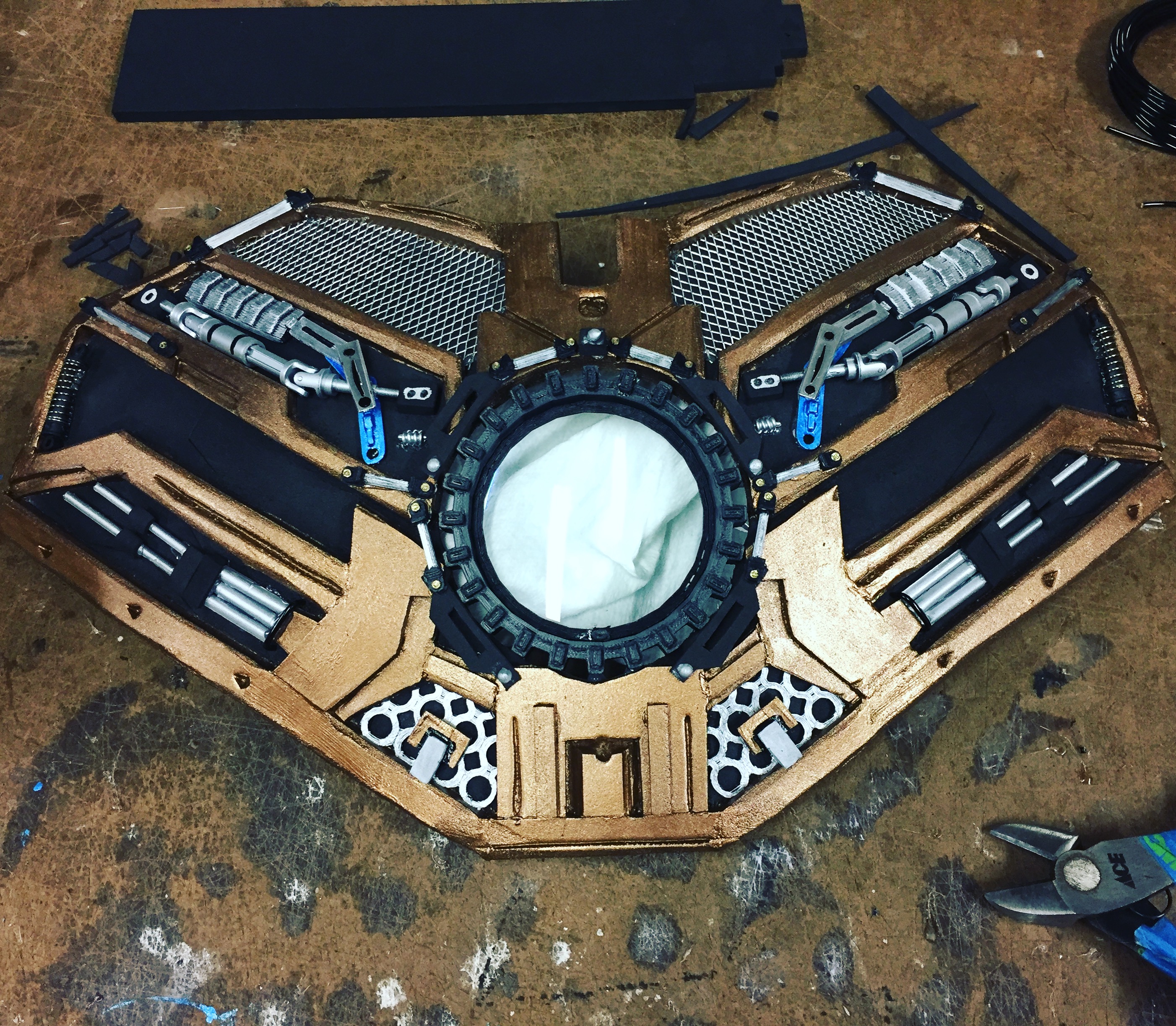

First coat of paint.

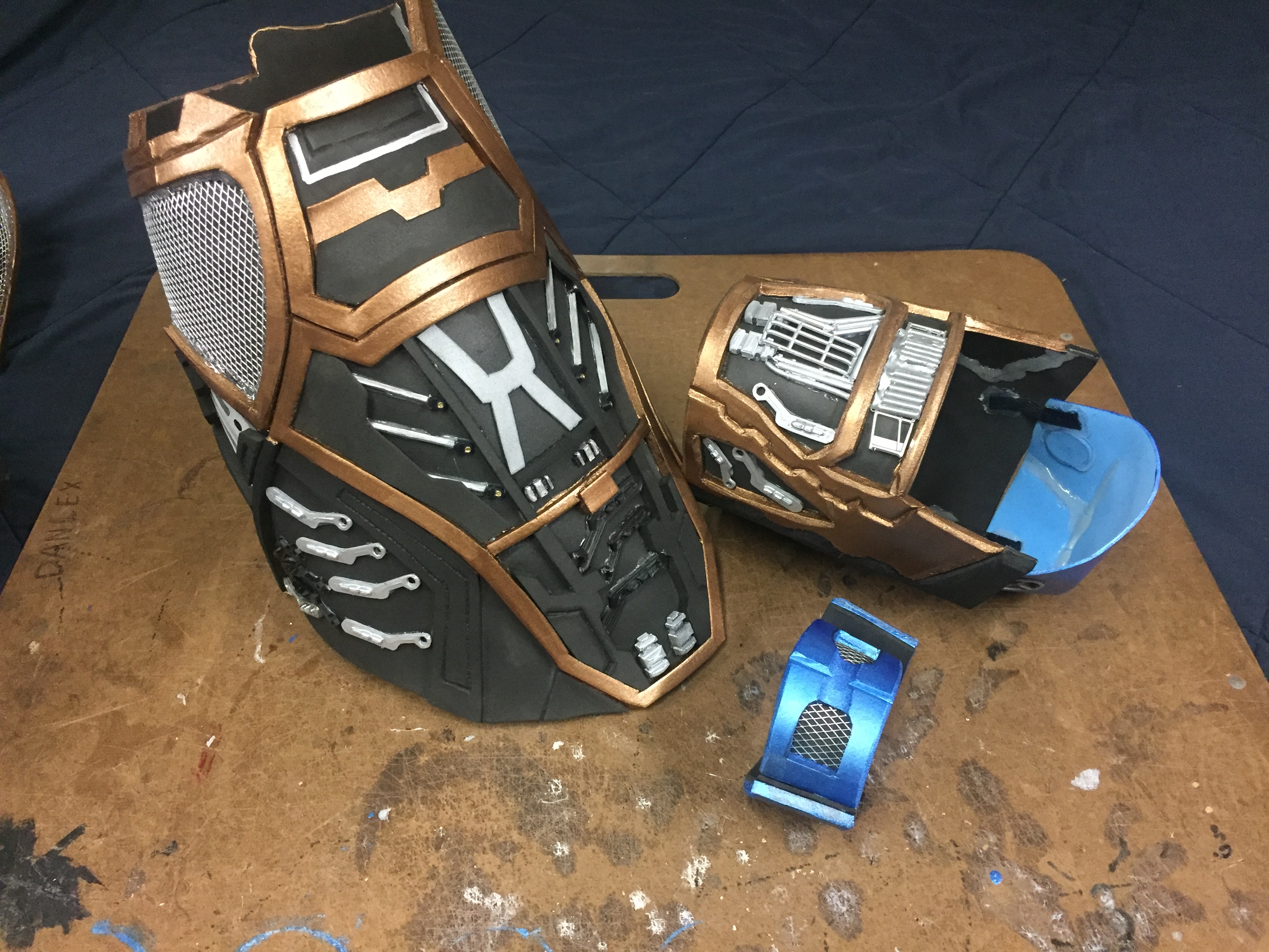

First off, Bones is by far my favorite looking iron man suit! Don't get me wrong Tony Stark does design some pretty nifty iron man suits, but the black and the gold really do it for me. This whole build and your craftsman ship is simply amazing man, seriously! Is this all EVA Foam, I have to start playing with this stuff for my V2 DOTM MEGATON COSTUME! Please forgive me for getting off topic. Back to this FANTASTIC build, seeing the shoulder blade parts I have to say adding the rivets to the foam so that they move is a genius idea! I shall keep this in mind for Megatron. Paint job looks great! If I had a good amount of money I'd buy this costume from you before you could get to wear it! :D I want it so BADD!!!! Again, excellent job and this is one epic build man.

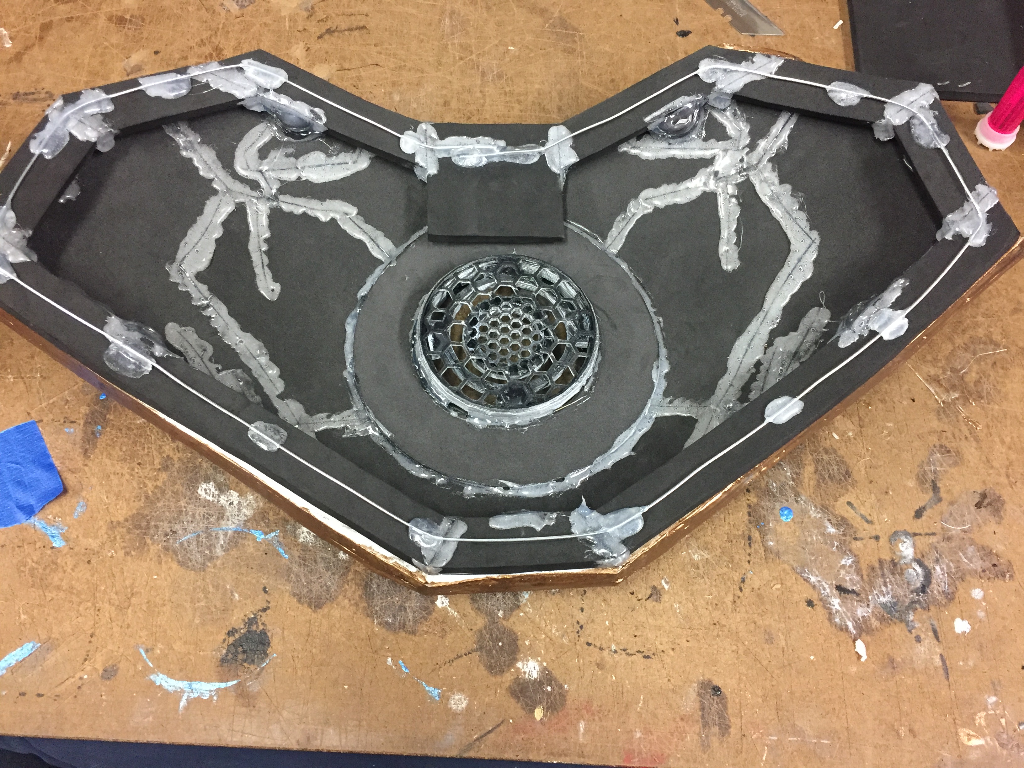

Sorry, haven't post anything in the last few days because I've been prepping the finger parts that I 3D printed for the gloves. I've done 4 or 5 coats of acetone on the ABS prints to smooth them. Doing this by brushing it on because the rice cooker I have for doing acetone vaporizing is too small for all the pieces, I'd only be able to do two fingers at a time and the insides don't really need to be smoothed so brush is working just fine. I should be able to get those painted black today and the first coat of my bronze paint on all the base finger sections. All the other hand parts are ready to go. Pics soon.
