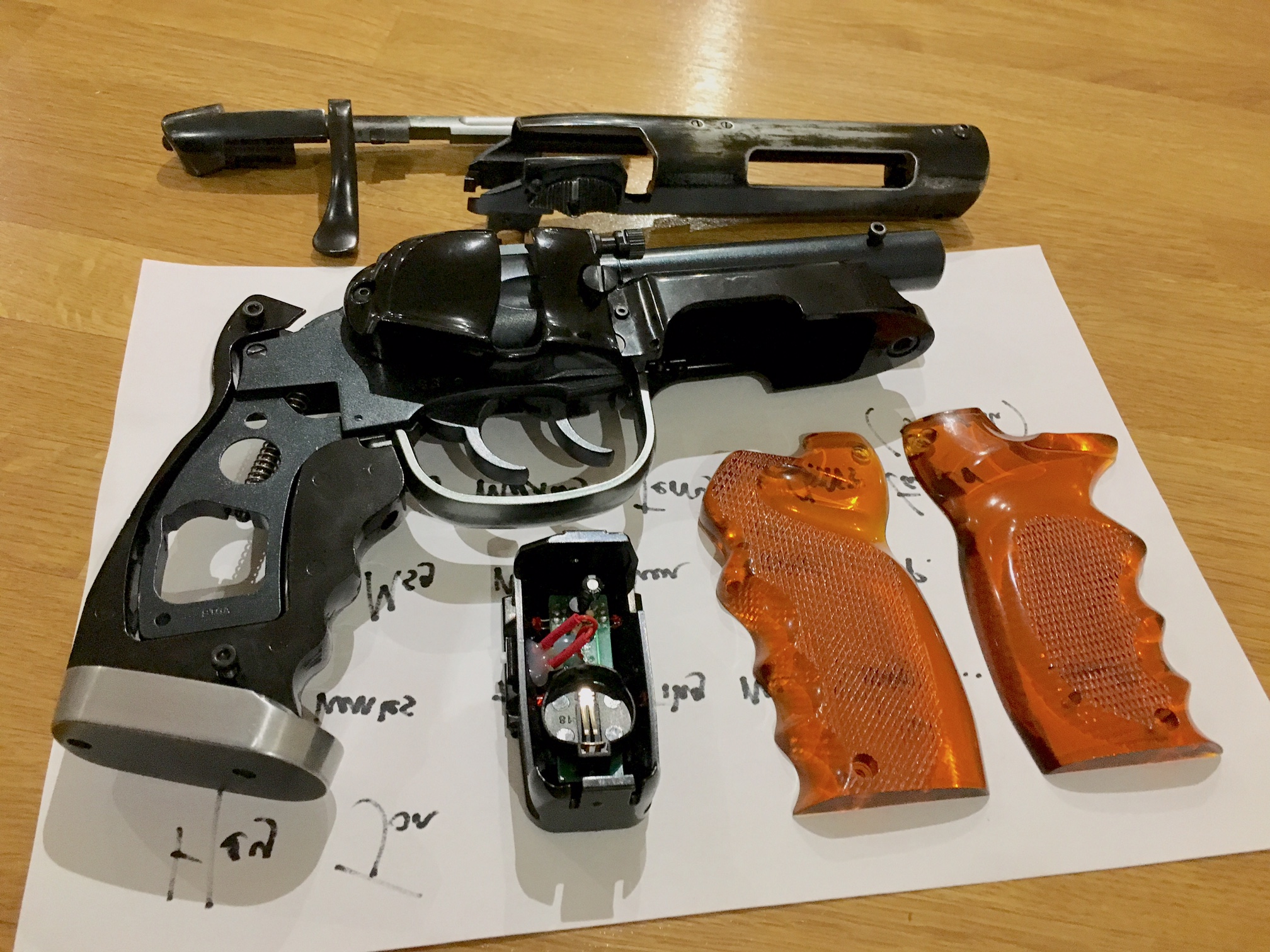

Here it is stripped, some polishing before blueing started here:
Moved on to T-Cut and even toothpaste to see what sort of level of finish I could get on the metal in preparation for bluing it. Under the metallic blue paint on the body I found the metal powder plastic has a pretty pleasing and accurate finish as standard. I'll experiment with the spare barrel to see what can be done with it.
Here it is a bit more polished up:
Already pleased with how the subtle variations in genuine metallic finishes enhance the appearance. Waiting on some tools to dismantle further and progress.

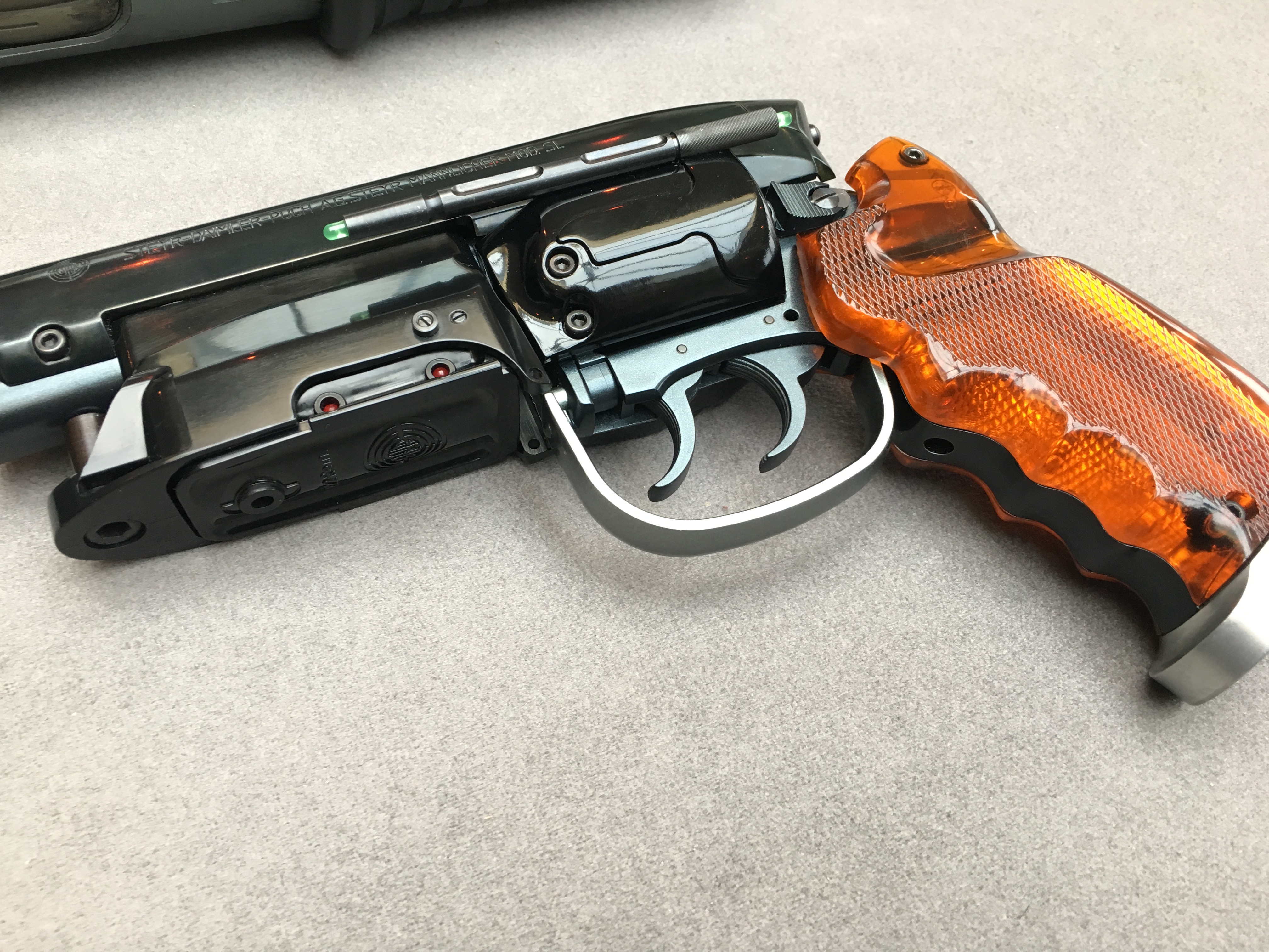

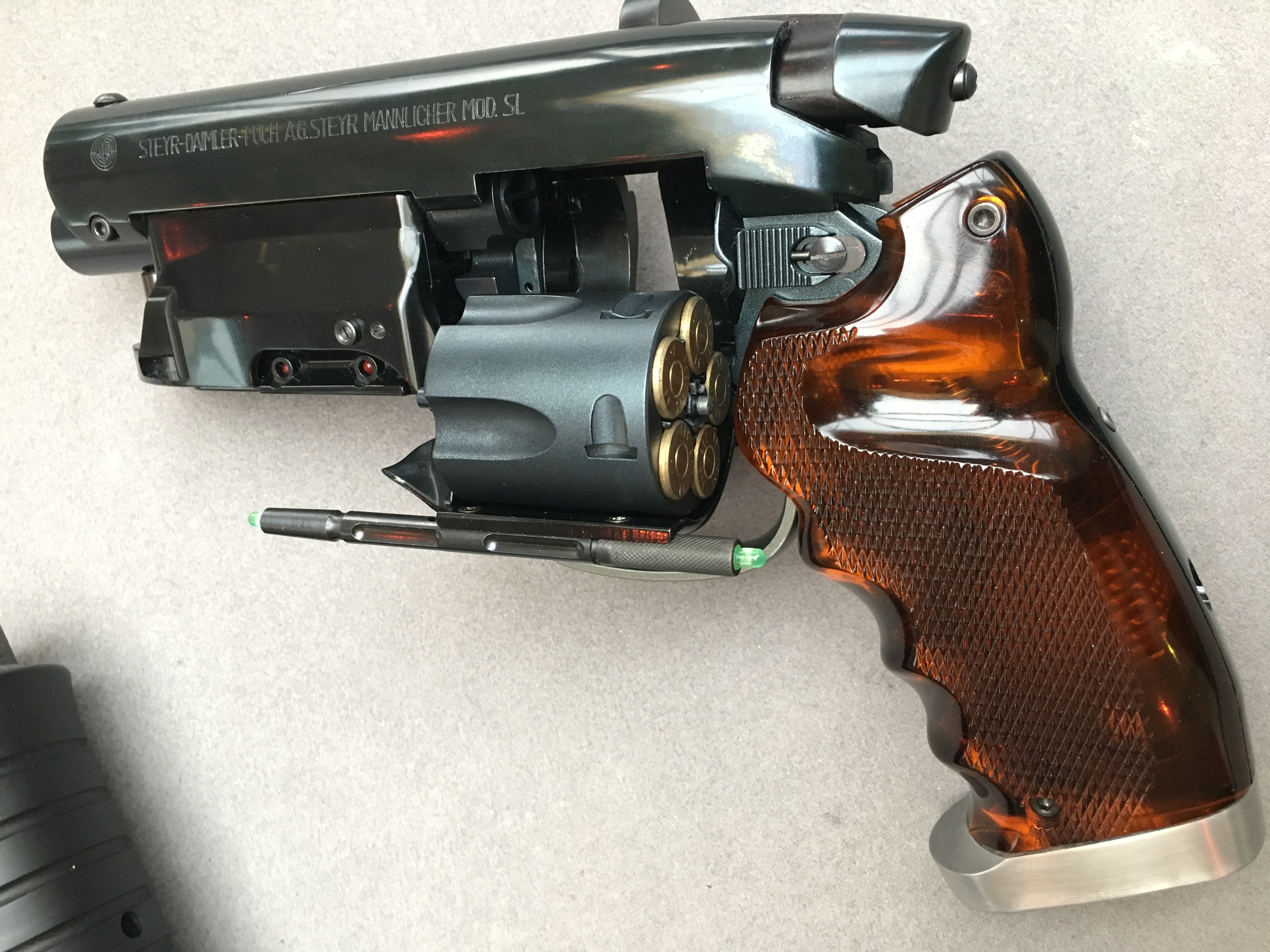

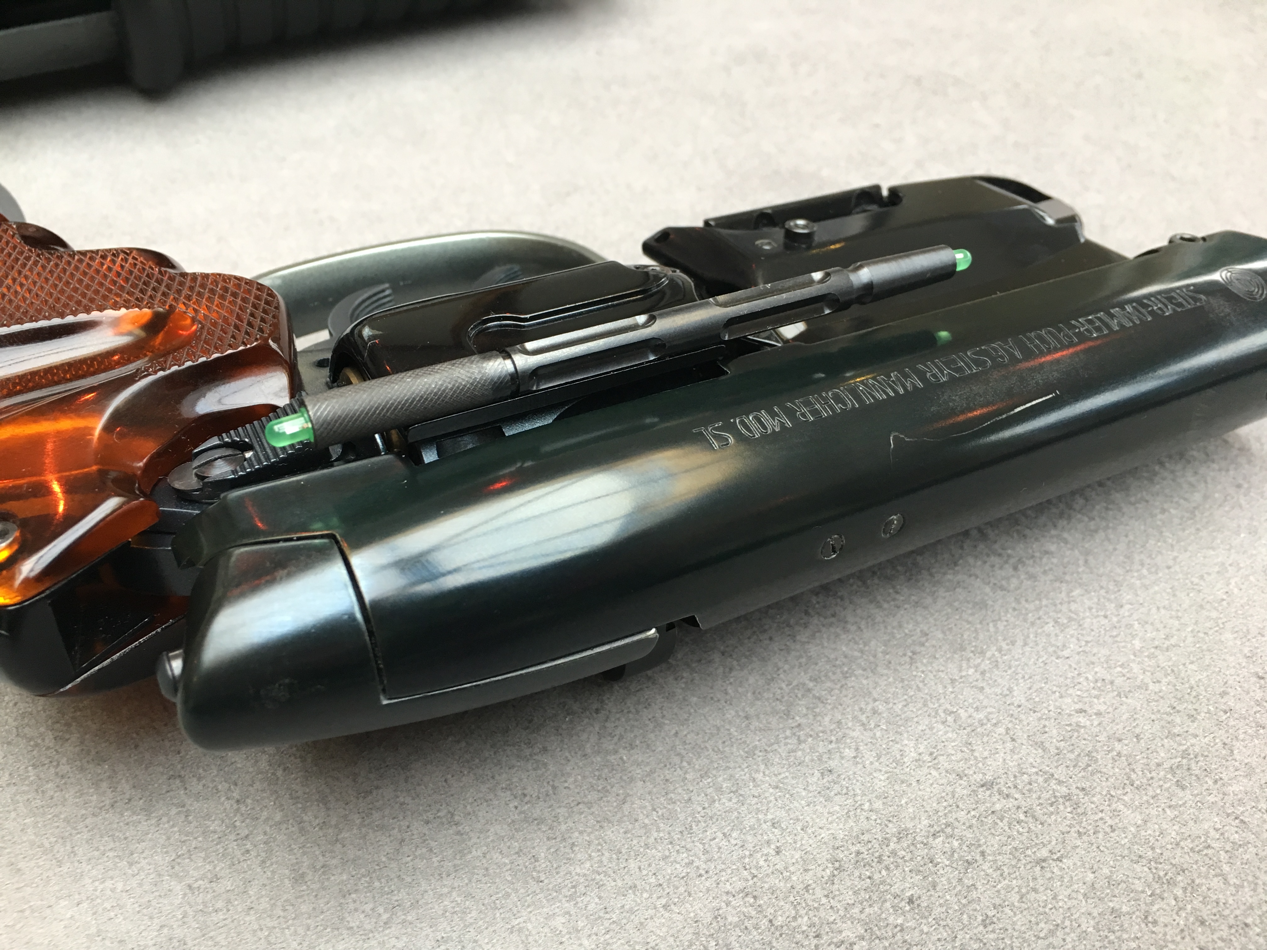

Not fully back together here, more of a test fitting. But here's some more steps completed:
Stripped off metallic blue paint on Bulldog frame / triggers etc
Blued steel barrel
Stripped silver paint from finger guard, lightly blued metal here.
Pleased with how it's coming along.
Still want to polish up the grips, waiting on some Tamiya Fine Finish compound to see if its appropriate.

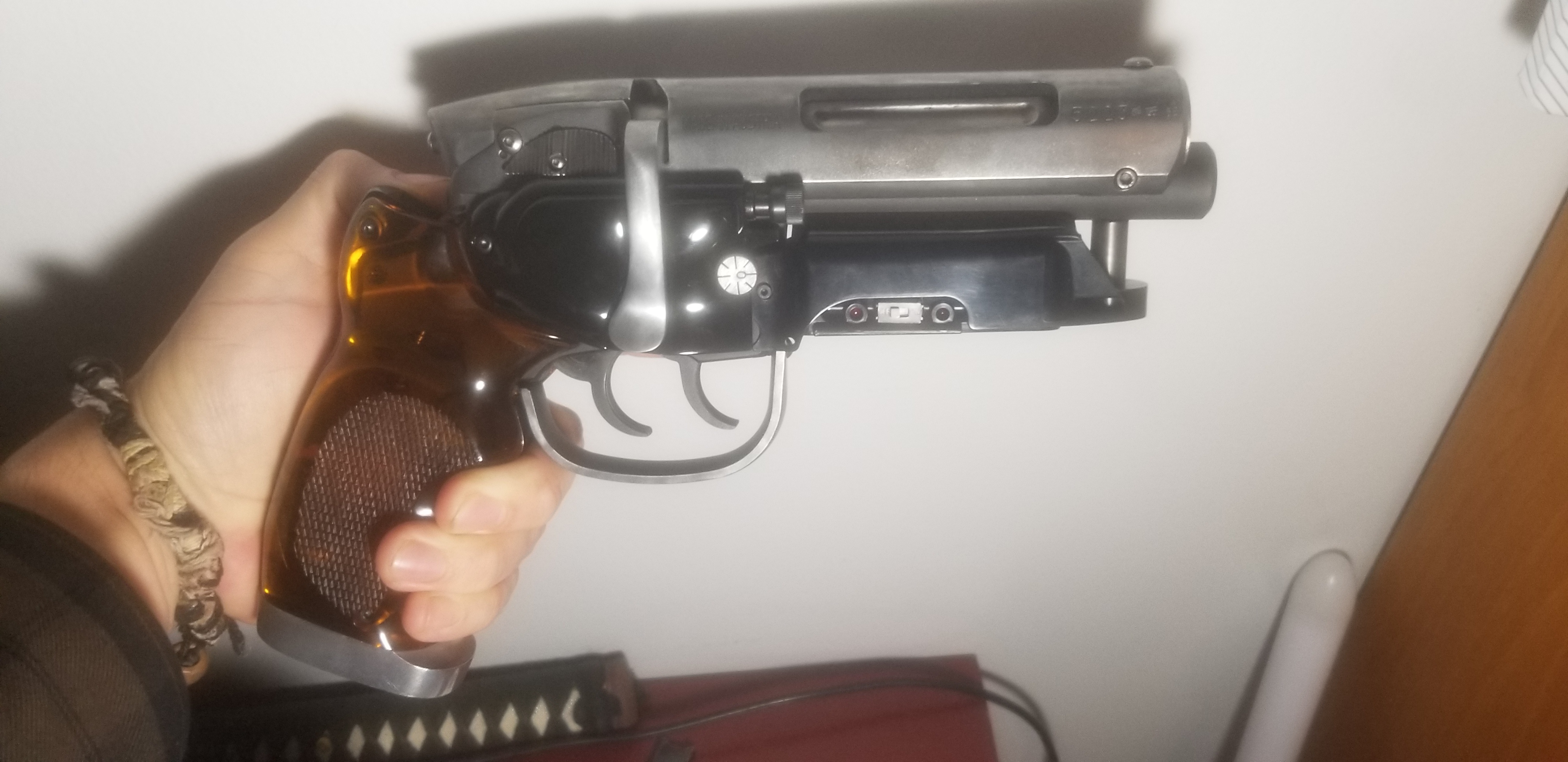

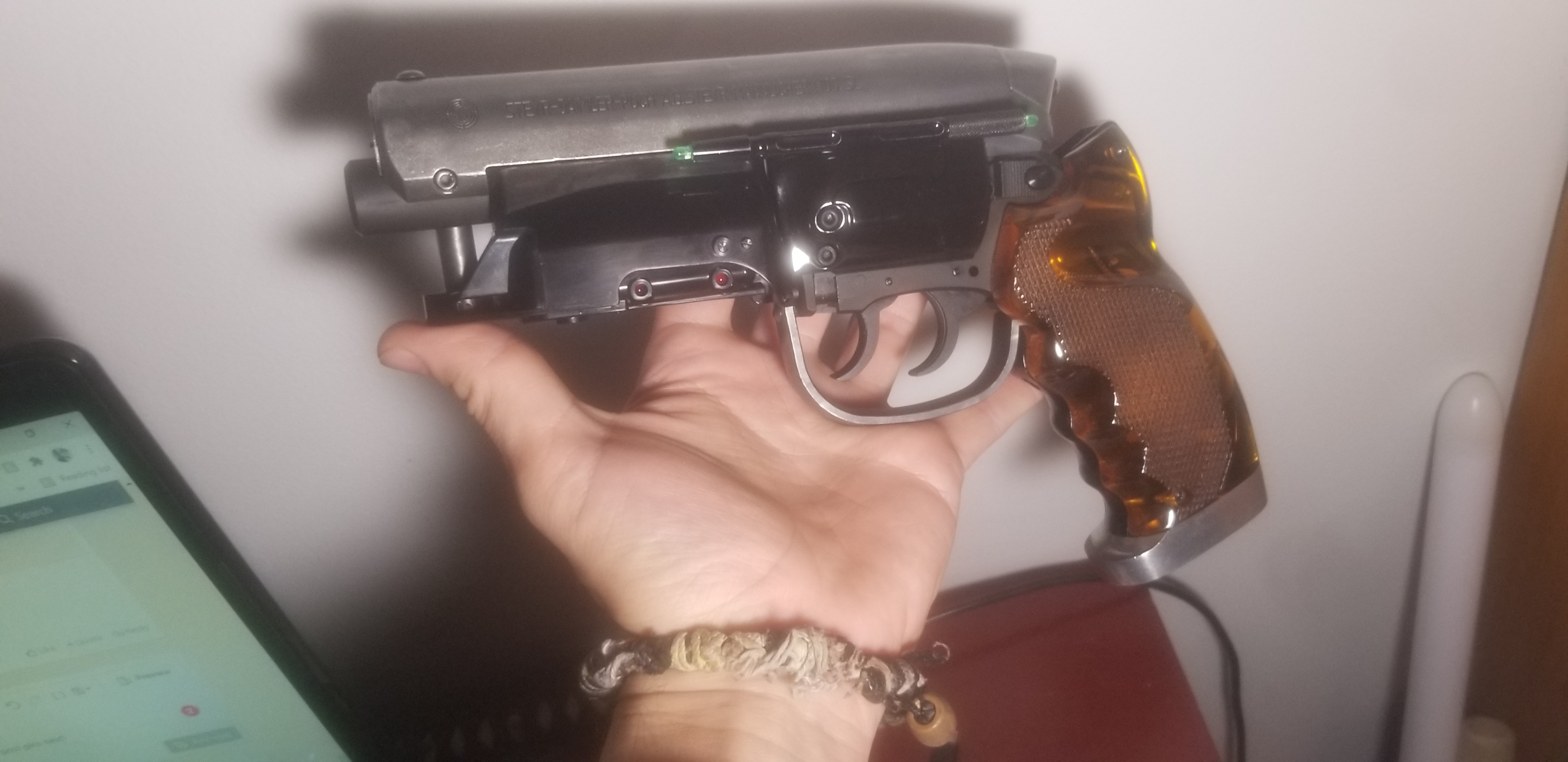

Hey Guys,
Does anyone know if any authentic cylinders will fit into the tomen frame?? I've got a moded tomen, will post pics next!
But if its possible to fit an authentic .44 cylinder in there with a little moding id like to attempt. Thanks! any info would be awesome!!
Here are the pics of my Tomen so far. Steel Barrel in the works. as well as some other ideas. Im wondering if parts like cylinder latch, cylinder can be replaced with charter arms parts...
