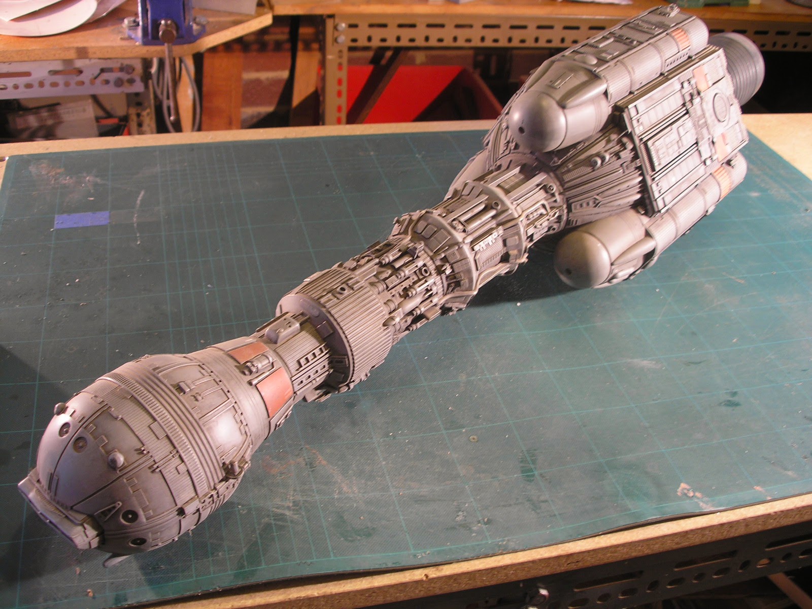

nice sweeping curves can be achieved by creating a skeleton underneath in the shape of the form of the shape you want. like this:
then you can bend the plastic over it and glue it down.
here's a link to my photobucket on that model. i had to pretty much scratch everything on it. and almost the hole ship was a complex curve. there were some times i had to heat the plastic sheet and use a skeleton to get the achieved angles.
http://s1015.photobucket.com/user/raser13/library/probert richter ambassador class?sort=3&page=1
you can also see where i used a picture of the ship to aid in cutting and layering the pieces to make much more complex pieces. plus if you go through the other models there you will see alot more of how i scratch other things and used found stuffs. i have boxes of awesome shapes.
