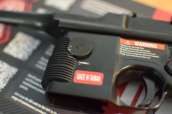

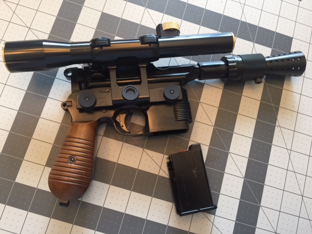

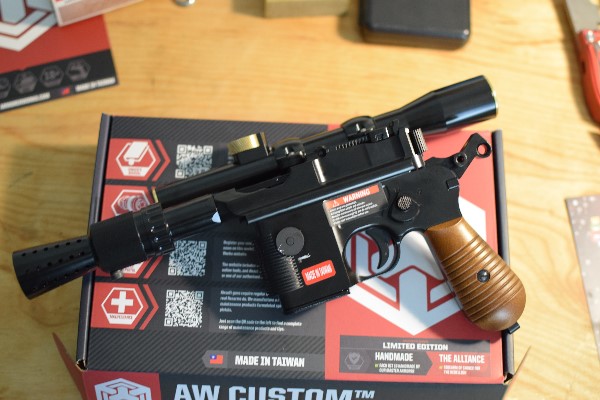

How mine arrived... some weathering already done before it even got here :lol
View attachment 779930View attachment 779919

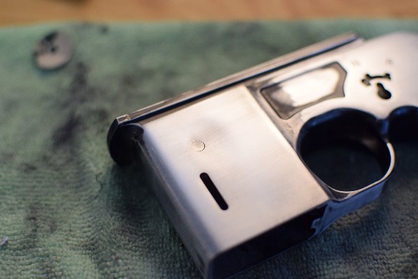

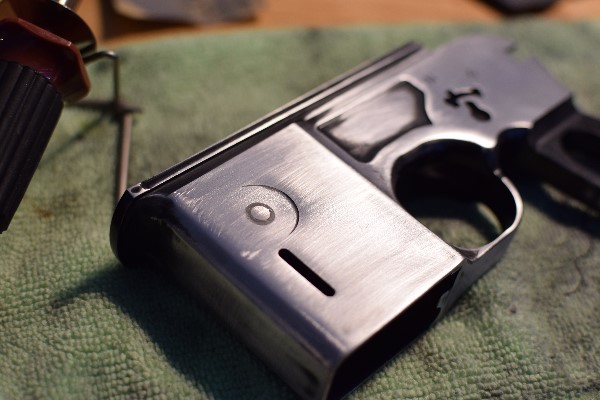

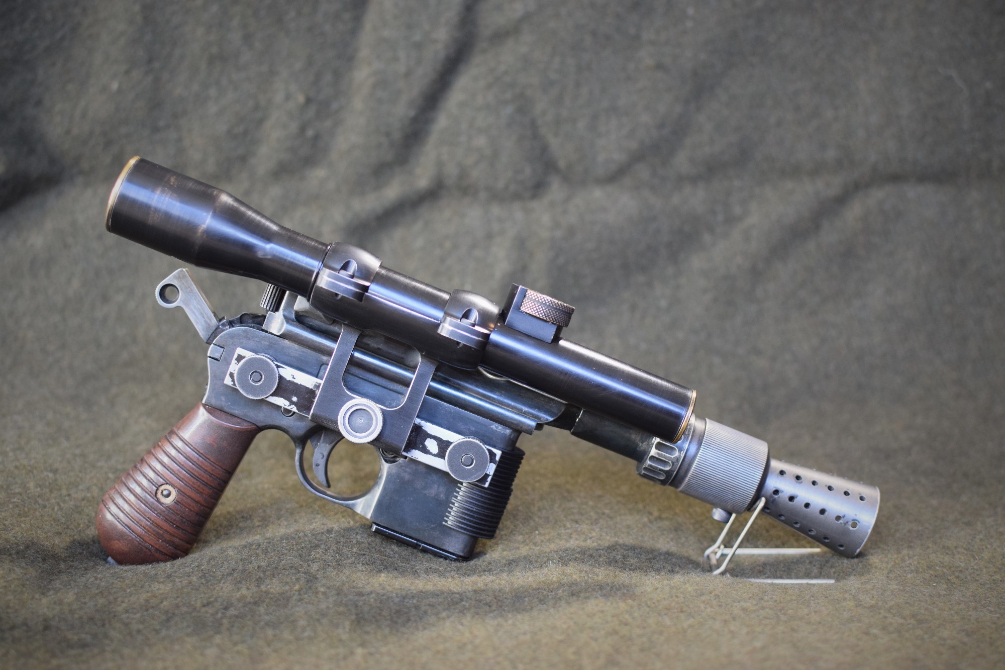

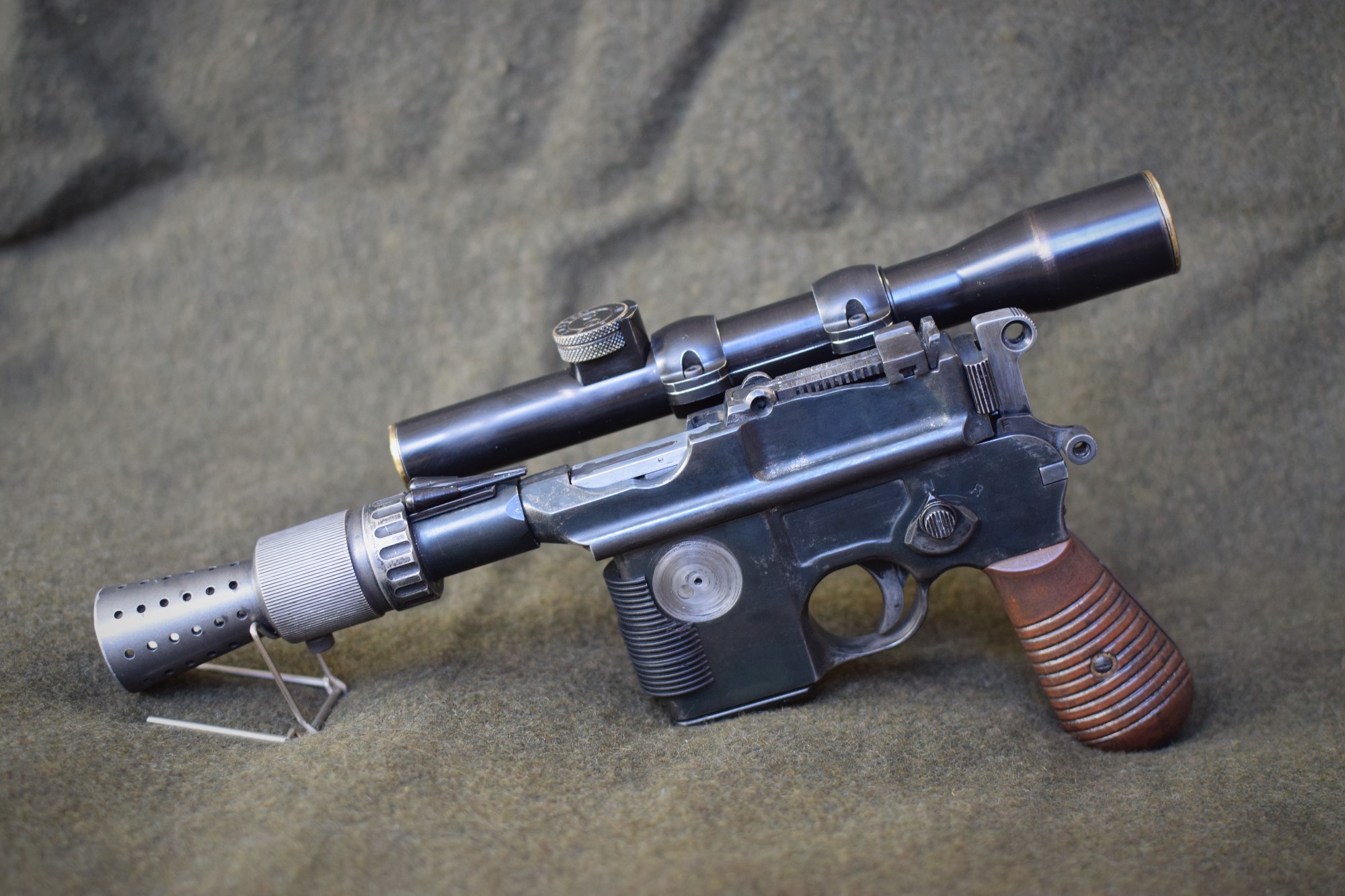

I am determined to have a mystery disk but the hole and nasty gash on the left side of the frame need fixing before that will be possible. I filled the hole with aluminum solder and started sanding.
View attachment 779920View attachment 779921
I have some more work to do to make that plug disappear (hopefully) but it is coming along nicely.

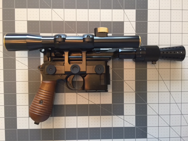

I've also done some weathering to the smaller pieces (hammer, safety, selector switch). I had some Super Blue from prior projects and the small pieces took to it very well. The frame will need Aluminum Black to be blued. Also, the flash hider must be coated in a different manner than the frame as I was able to strip it using aircraft stripper. The aircraft stripper had no effect on the frame.

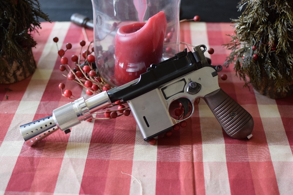

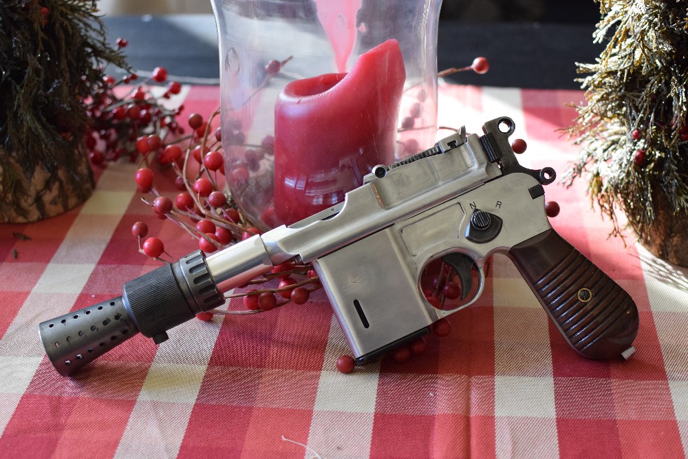

Here is the assembled blaster at various stages of the build (with festive centerpiece)
View attachment 779933View attachment 779934
More work to do but just wanted to share. Again, thanks to everyone for the inspiration.
