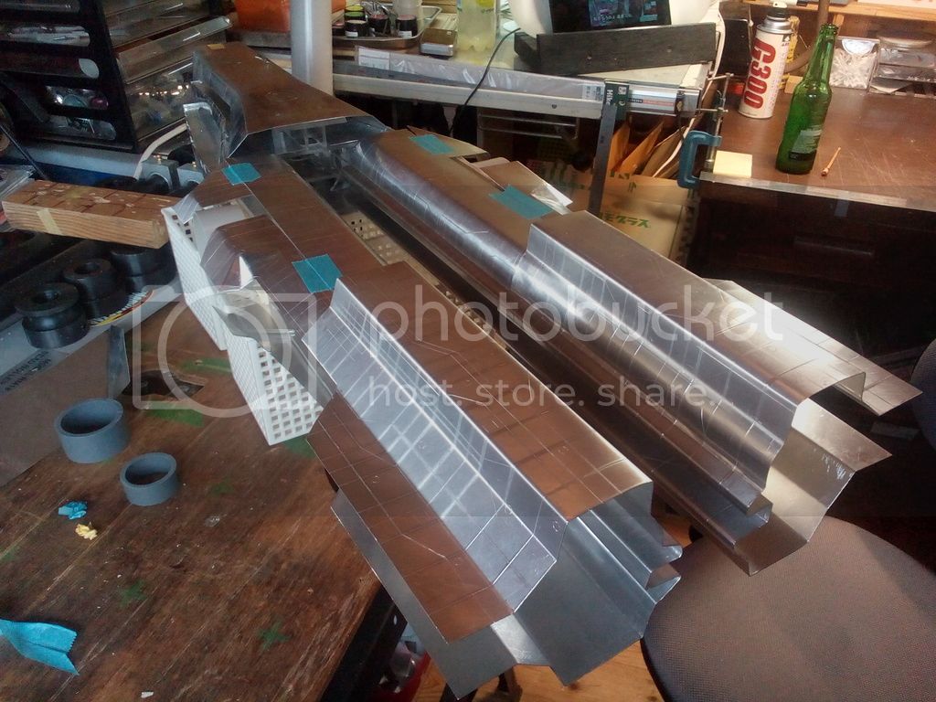

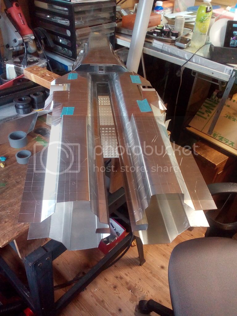

Here is a little progress.
Built the port side aft section.

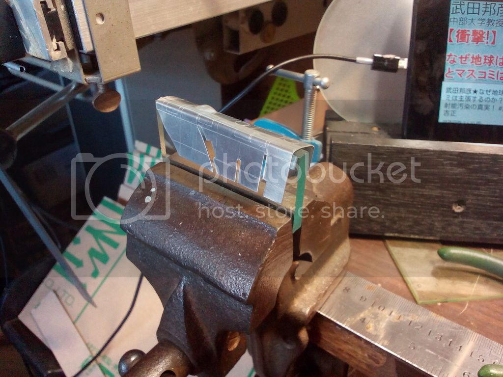

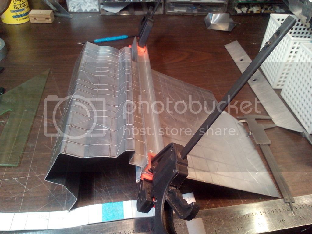

May be I wrote before but here's a little tips to bend an sheet aluminum.
I mainly use the couple of ] [ shape aluminum beams.
As you see the pics below. Set the beams and clamp them together and bend.
If you want a round edge, you should bend with a hand.
And if you need a sharp edge, scribe a shallow groove with Exacto on the inside of the angle and bend. Pretty simple.
Adjust the both aft parts to fit the mid section and glue them together.
OK, here's another tips for gluing the sheet aluminum.
I tried several kinds of glues. Super glue was not good for the aluminum.
Organic solvent based adhesive was merely OK but sometime inconvenience.

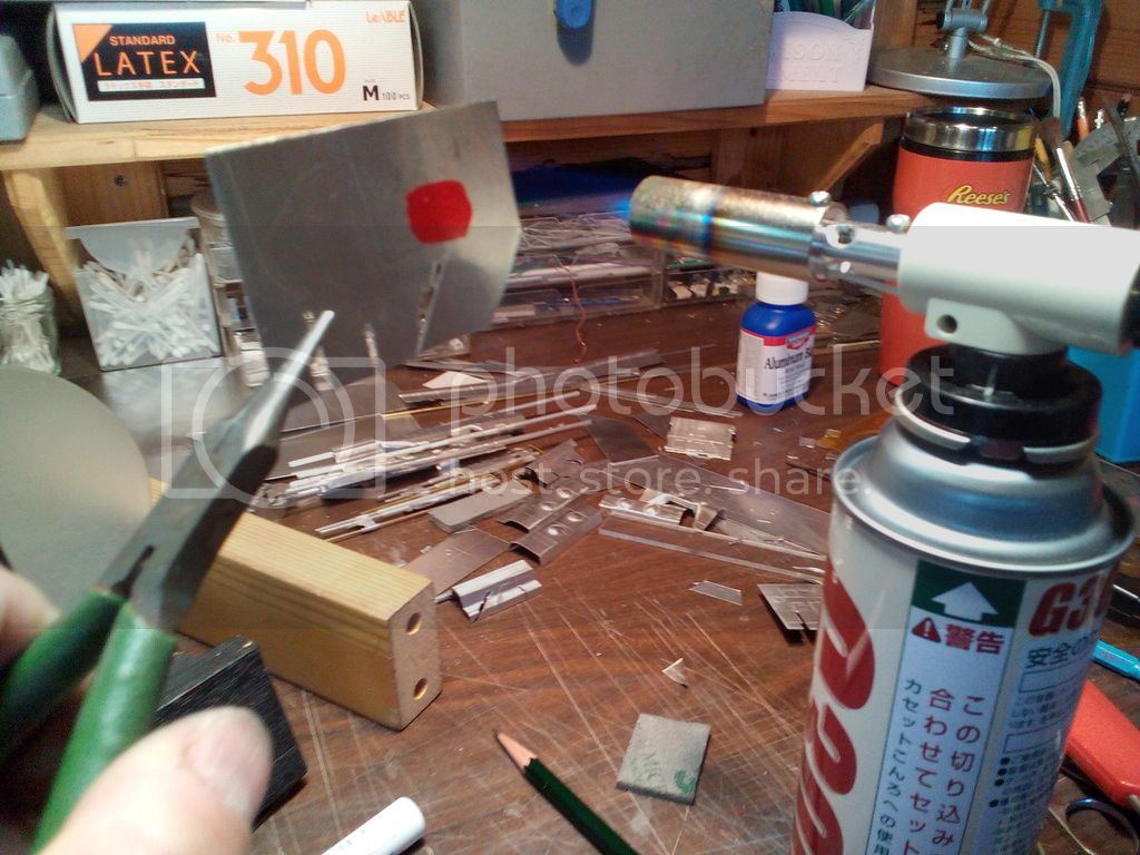

The best choice for me was -you may feel it curious but - hot glue.
It seems there is a specified hot glue for metal things but I use a ordinary one.
Apply the glue on the surface of the sheet aluminum and put then together.
Heat them up with a handy gas burner and press it hard.
Very strongly bonded. If you want to peel them off, just reheat and detach.
You'll find the handy gas burner on the upper right side of the pic below.
Not the green bottle. That's the beer bottle to warm me up.
The can of G300 is the one.
Well, the all over outer shell has been almost done now.
I can proceed for the detailing.
Thanks for looking.

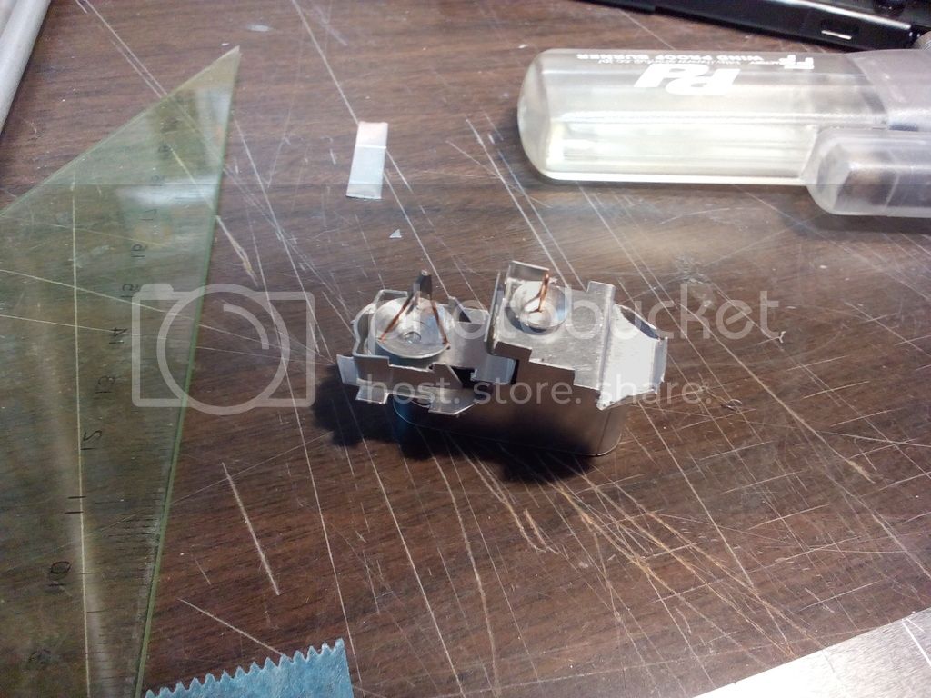

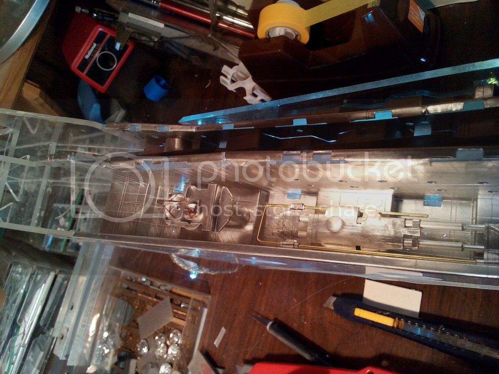

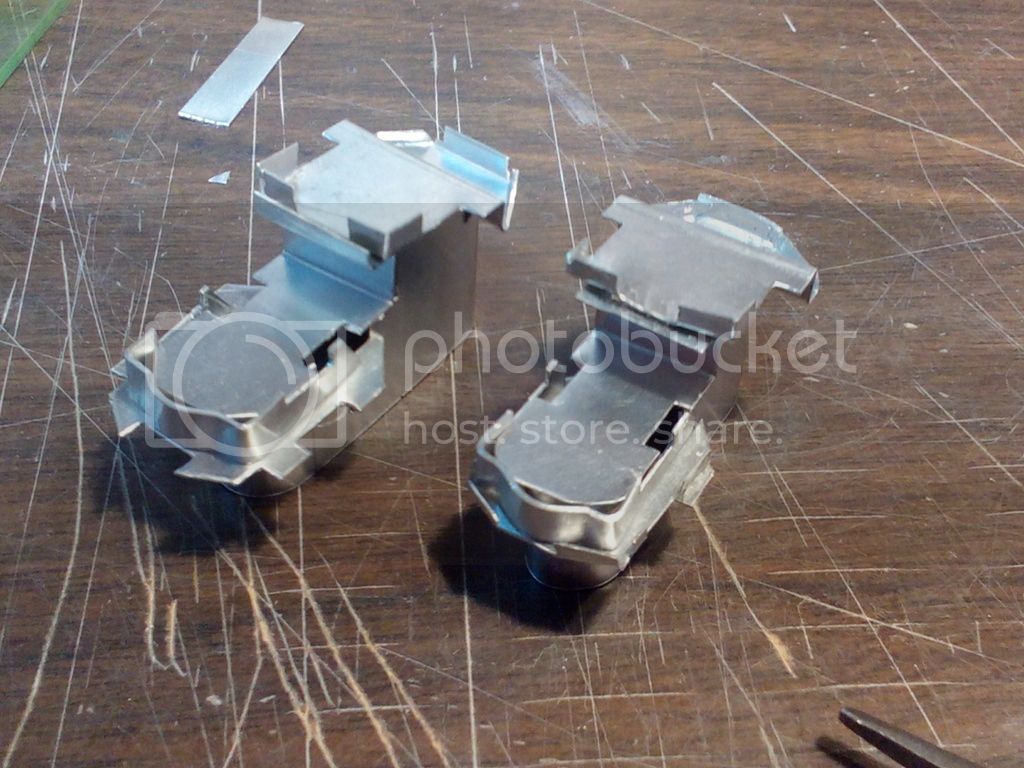

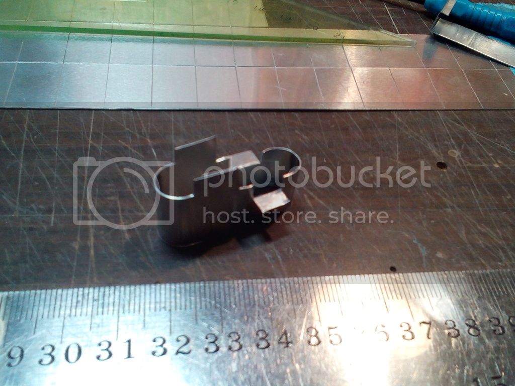

I've stripped all the parts outside and did some wiring for the LEDs. Then I started to build the detailing parts
It took 4 hours to design and make a couple of this.
Maybe it's the same time elapses when I look for the kit parts in the junk parts box.
Looking for the kit parts is the another kind of fun but this was also fun for sure.
This is it.

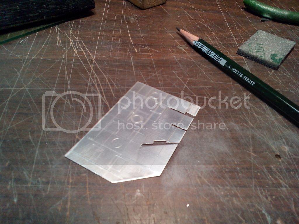

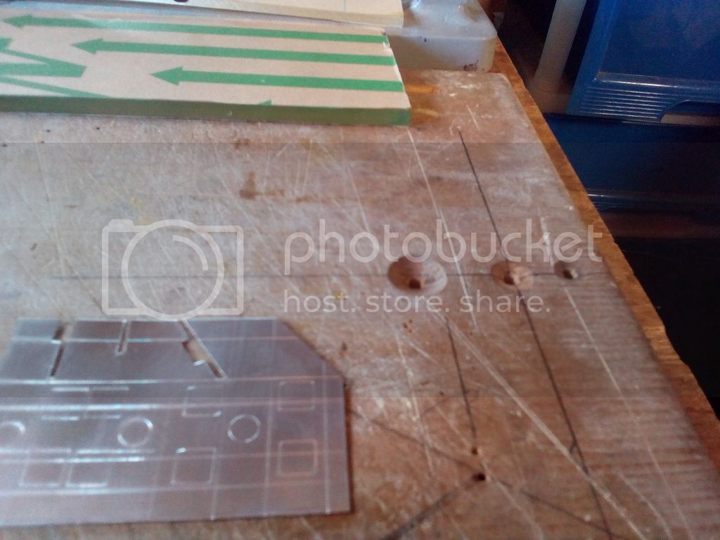

Here's introducing how I make a parts with complicated shape.
When you use a aluminum sheet and to try to make a parts which has some bumps or
complicated curves, it may raise any wrinkle or twisting on the surface.

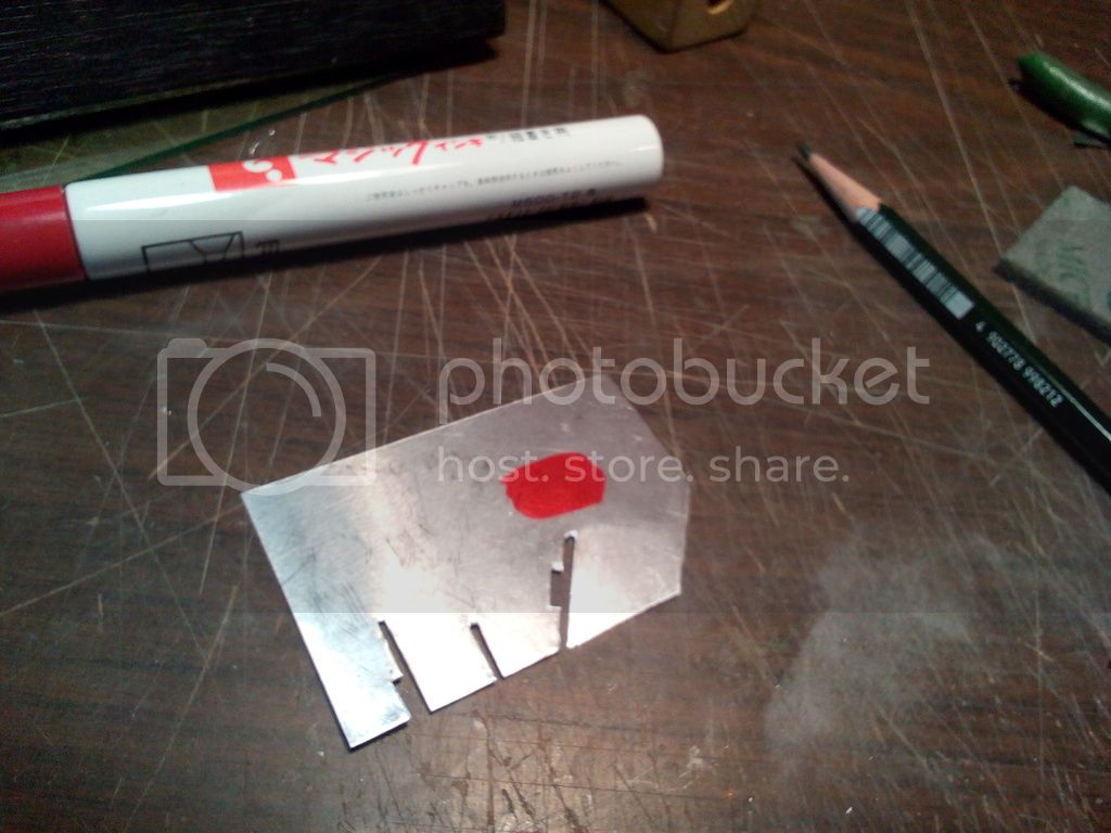

To avoid such trouble, you can use the annealing technique.
The key is the temperature.
Well, how do you know the appropriate temperature?
Here's the most simple way to know it.
-- Do I talk like Martha Stewart?.

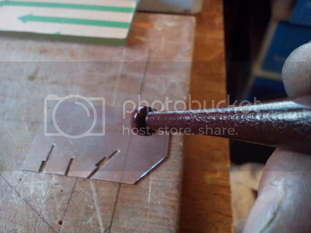

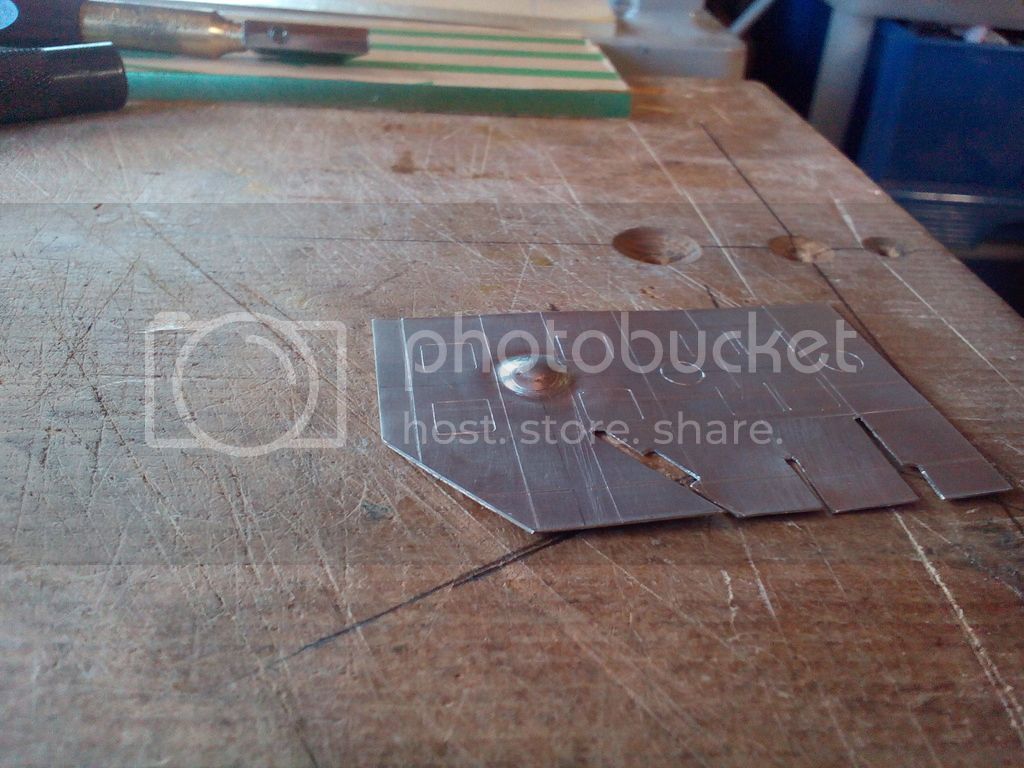

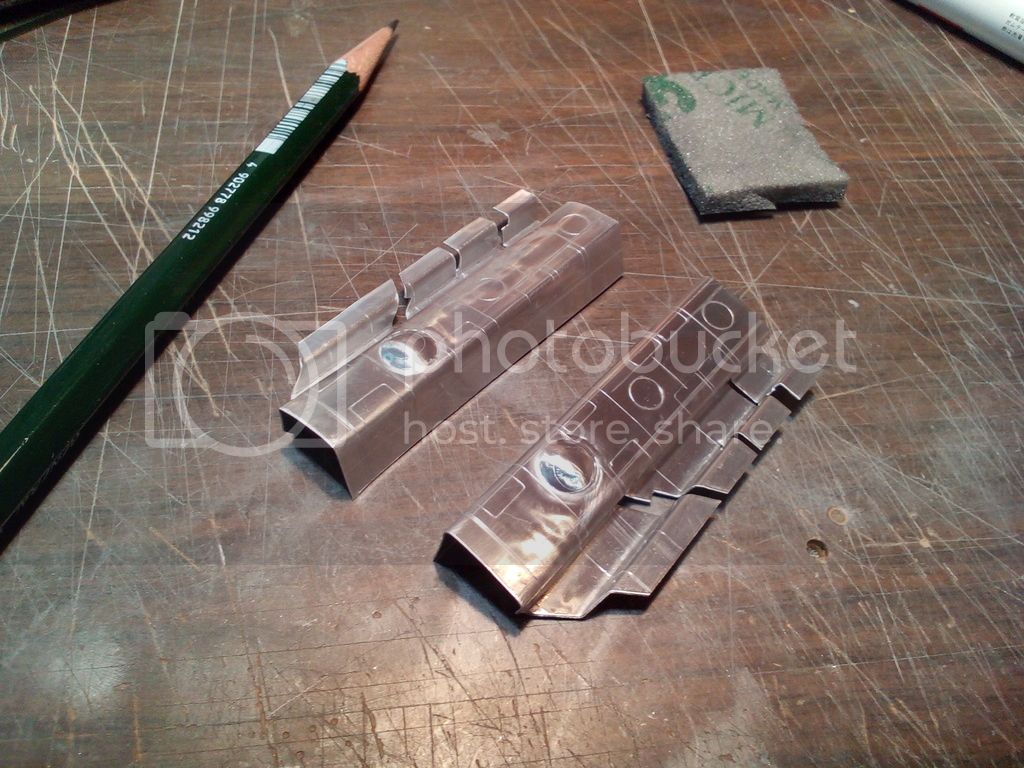

This is a 0.5mm aluminum sheet.
I will make a hump on it.
Mark anything where you want to annealing with magic marker. It doesn't matter if it's a spot or all over the surface.
It depends on what you want to do with it.
This time I like to make a little hump on a small spot on the parts, So I just mark the small dot on it.
Then heat it up with a burner a several seconds.
When it reach the appropriate temperature, the marking is disappeared. Leave it for several seconds to let it cool down. That's it.
When it's cool down, the material turns out to be like a sheet of clay. Still hard but very flexible.

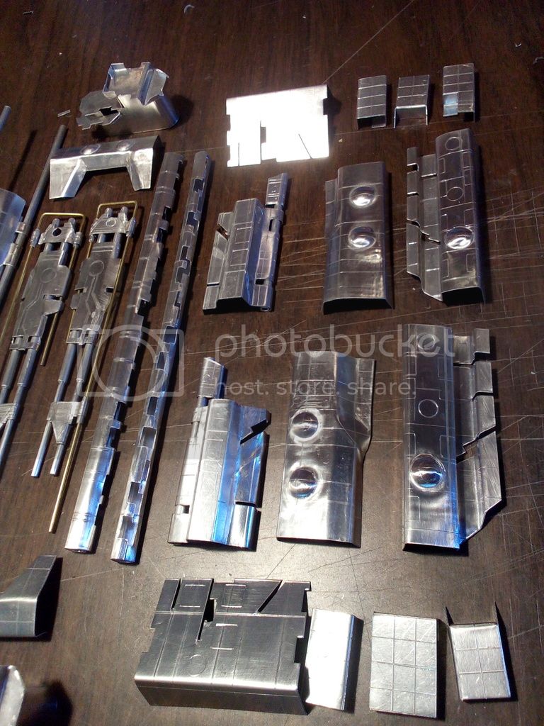

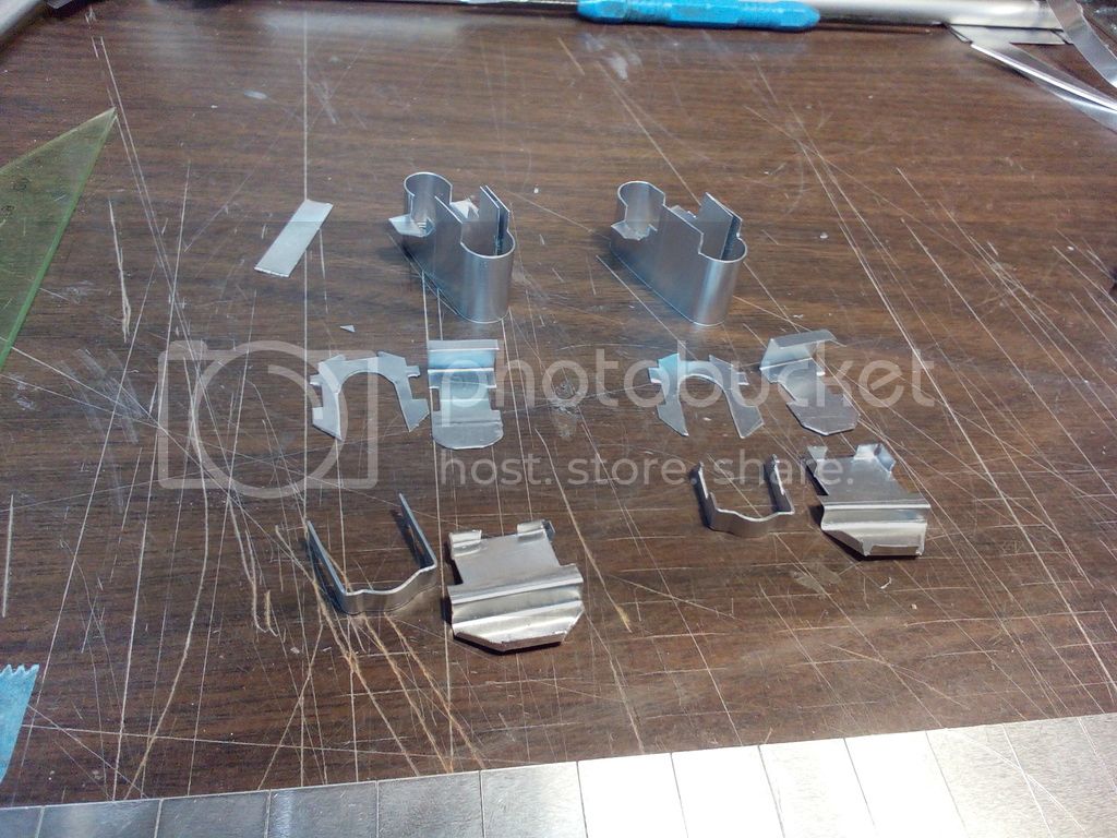

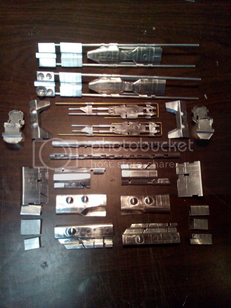

These are just 1/10 of what I need.
I will continue to sketch and build of the detailing parts.
