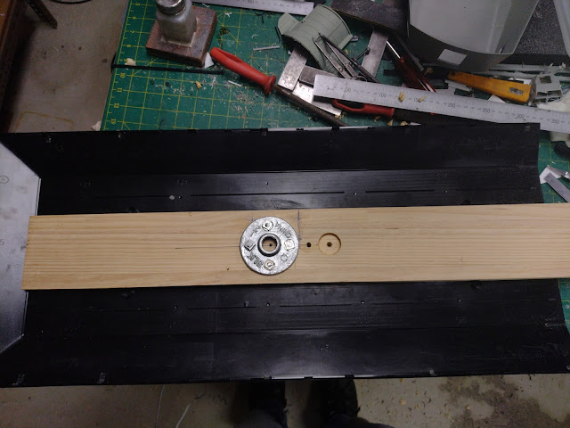

The TV stand casing is made from two panels which measure 765mm long by 330mm wide and 40mm thick.

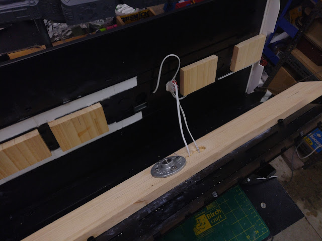

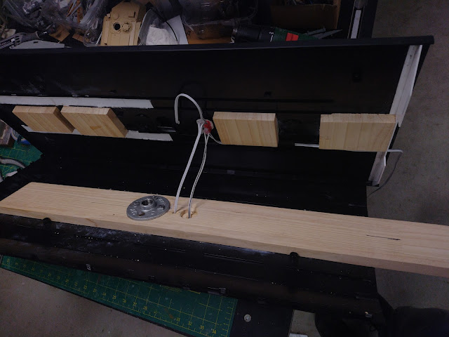

First think to do was add a support structure. As is fairly typical for my spaceship projects I added a length of pine to which I bolted some sturdy galvanised 15mm water pipe flanges.
The pine is superglued to the roughed up (with coarse sandpaper) interior of the top surface of the casing.

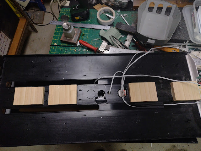

The bottom surface received some further blocks of pine to make up the thickness and a terminal block for the 12 volt electrical wiring inputs and out puts to the future engines and bridge section.
Some slots in the bottom surface were filled with evergreen grooved sheet and a rear wall made from 2mm styrene glued in place before the two halves were assembled with some PVA glue between the two layers of wood.

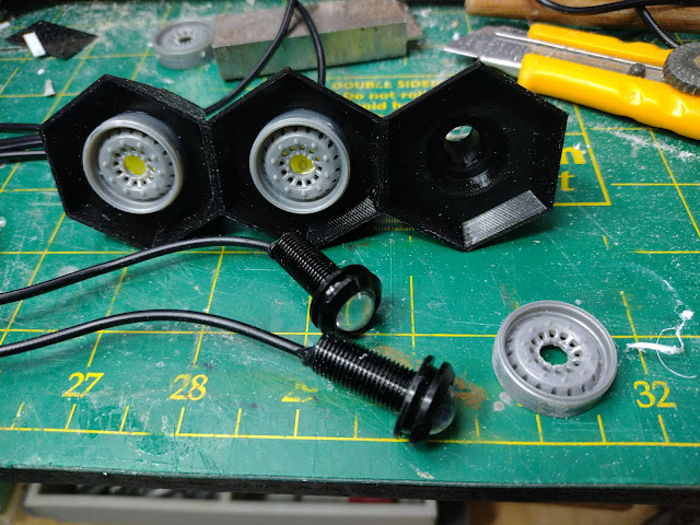

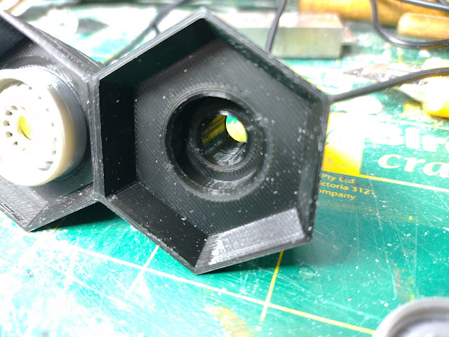

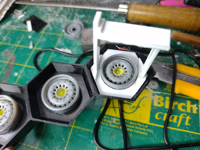

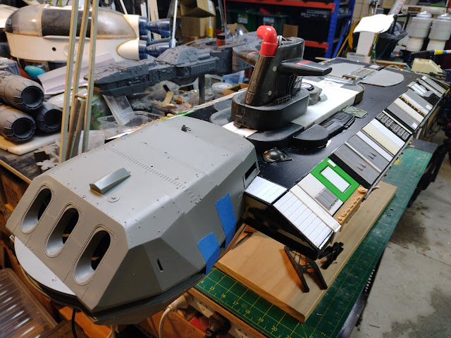

For the engine pod I am using two Takom 1/72 Yamato main gun turrets.
Out of the three holes in each turret where the guns originally poked out will be the engines.
At this stage I didn't have a clear idea of exactly what the engines would comprise.

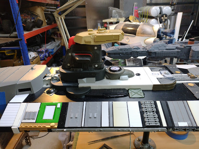

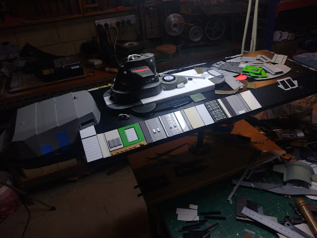

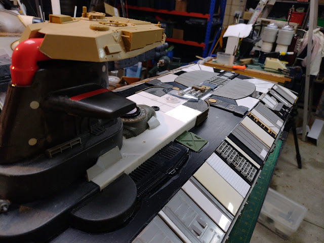

The bridge support section is made from the conning tower of a toy submarine. Ahead of the conning tower is a grey plastic housing from a kitchen timer.
At this point I was planning to add something on top of the conning tower which will become the actual bridge deck.
Again I was not exactly sure what this would be but was confident that a trawl through my parts boxes would yield something suitable.
Worst case scenario is that I would have to knuckle down and scratch build a shape from styrene sheet.

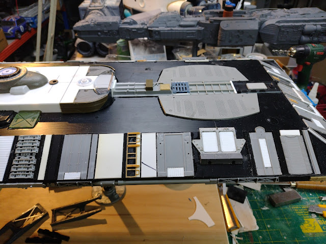

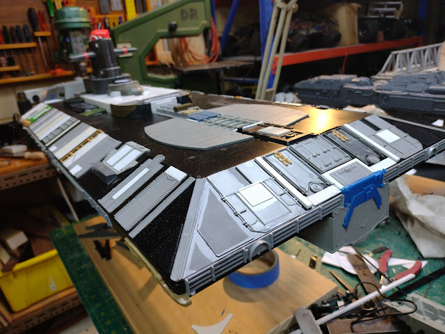

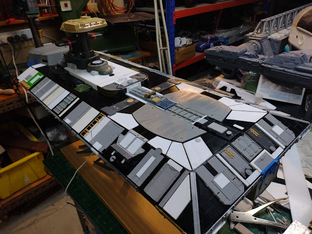

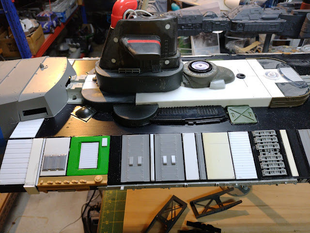

In the picture below I have started to detail the top sloping sides of the TV stand casing.
Among the usual kit parts, styrene sheet and evergreen textured sheet is some green slide mounts I found when moving house a year ago.
They are made from the right sort of plastic and glue with solvent well.
One issue that can cause problems is cementing styrene to ABS.
While they both dissolve with the solvent I use (methylene chloride) the dissolved plastics tend not to intermingle and the styrene parts can fall off over time.
I have found if you rough up the surfaces to be cemented they mix together better and stick well.
In this case for the larger panels after roughing up the surface under the part to be glued I use a couple of drops of super glue in the centre and then use the solvent around the edges.

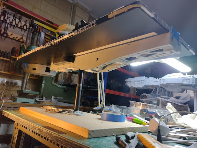

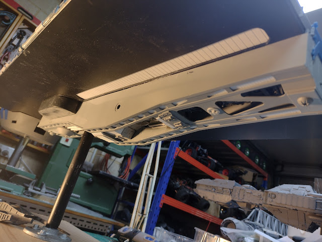

Actually before commencing the detailing on the sides I started by prepping a large 1/35 scale Leopold Gun truss for the underside of the starship.
This is another kit I found cheaply on FB marketplace that I have had for a few years with out coming up with any ideas on how to use it.
Firstly I cut away a section of the sides to give me a flat base to glue to the flat underside of the TV stand hull.
Similarly to the Space Barge project (one of my many incomplete projects) I filled the under side of the truss with detail, except in this case it was twice as large as the two 1/72 scale Leopold trusses I used for the older project.
It was sprayed with primer before gluing in place as the access through the holes would be pretty poor once installed.

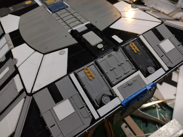

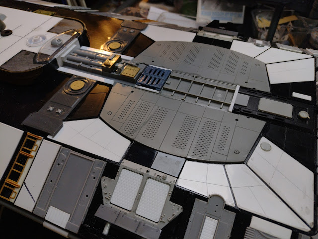

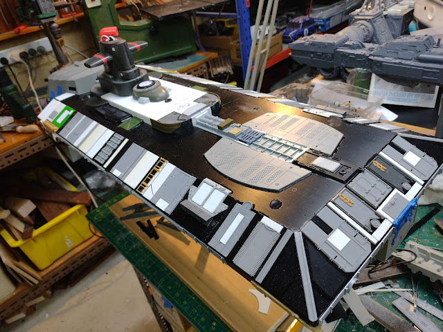

More top surface detailing followed along with the skinny vertical sides.
I also started filling in the top surface plating using 1 and 0.5mm styrene sheet.
